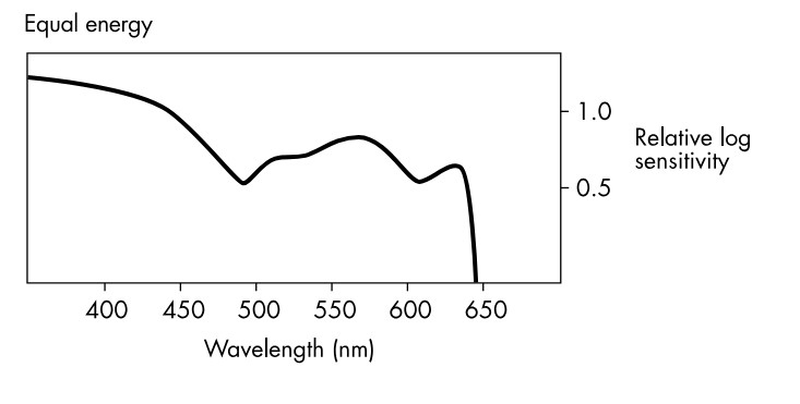

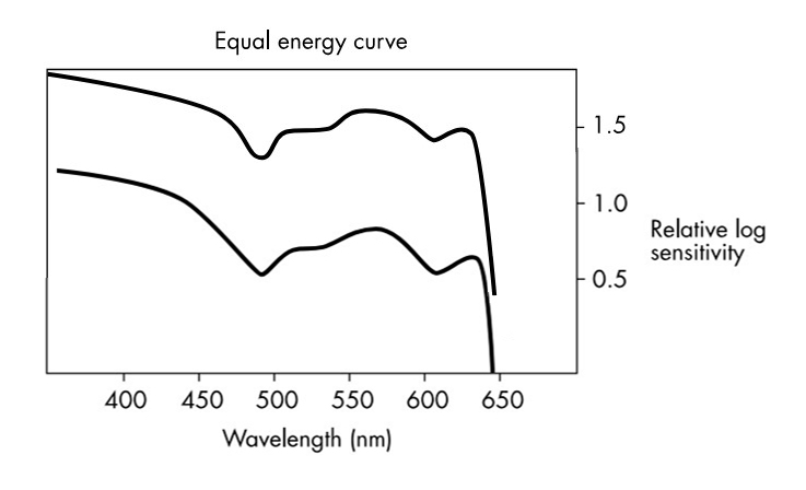

4 pages in, no one seems to have found the Equal Energy Curve for HP5+ that Ilford used to give in the data sheets. I've attached it to this post.
Edited to add: I thought that the FP4+ curve, and a very rough composite of the two might give some more contextual understanding about what was probably a graphic design decision - though I'd place little absolute value on the log sensitivity scale between the two - it's pretty clear that it's explicitly 'relative'.
Ooo, those are interesting! Thank you, Lachlan.
So while the scale on the wedge spectrograms appeared to be scaled relative to highest peak, the scale on these equal energy plots is not - and presumably cannot be, since the maximum is probably off the left hand side of the plot. We don't know what either scale represents unless the Ilford people can enlighten us.
Isn't it a bit strange that the quite striking differences between HP5+ and FP4+ noticeable in the shape of the wedge spectrograms are not obviously apparent in these equal energy plots?

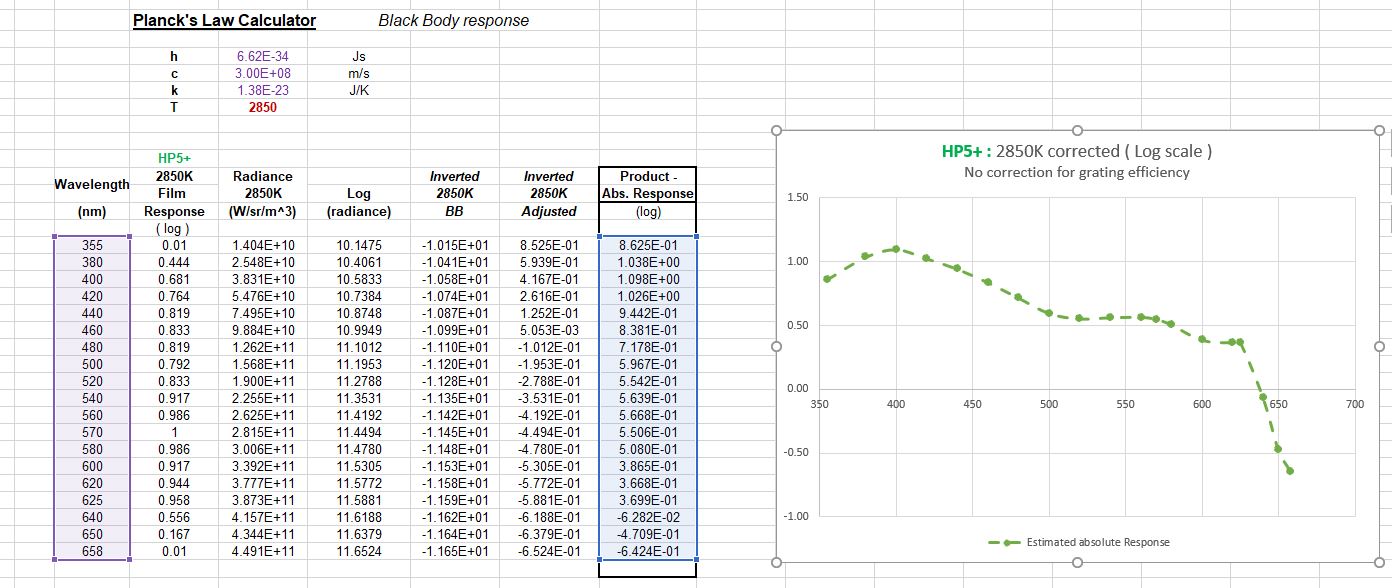

Here is an update of the spreadsheet, for HP5+, recognising that the starting data from Ilford was on a log scale.
Hence the calc was done in 'log space' excepting that the black body curve had to be converted to Log10 values in the middle.
The calc does not ( yet ) include any attempt to allow for grating efficiency across the waveband or any other effects that I haven't had time to understand yet .
Effectively one is done with a tungsten source and one with a nominally daylight balanced one. Even Type C panchromatic films usually have a slightly lower effective speed in tungsten balanced light - and I think the plots demonstrate both this and (more importantly) the cultural practices of the films' intended usage when they were first engineered in non-plus form (about a decade apart). In particular the shift away from predominantly tungsten lighting in studio environments, and a near total dominance of electronic flash as the main artificial light in reportage - and, possibly, the first steps towards understanding what the most optimal sensitising is for representing colour in B&W.
How far back were those published, out of interest ?
They were in the datasheets until the layouts were rejigged somewhere around the turn of the century.
