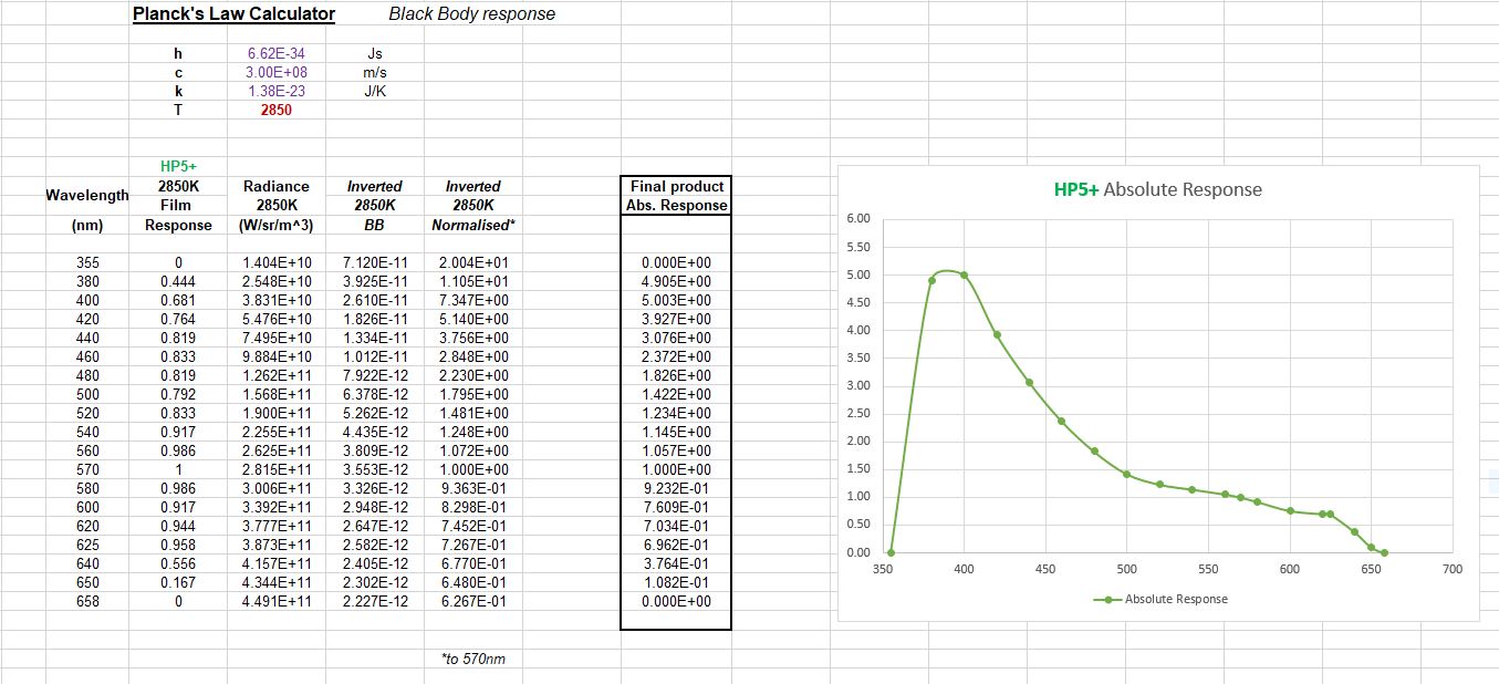

I have worked up the spreadsheet now ( in odd moments in meetings ! )
Here is a first-pass on HP5+
I have just realised that the Kodak sensitivity curves are on a Log plot, so will go back and add an extra column and do another graph later.
It should look a lot less weird and more like the Kodak Tri-X one then. Still, lots of sensitivity in the violet and UV, if you don't have a lens on there....

Thanks for the correction Jonathan, but there are a couple of other points ( eg. a 569nm one ) on the FP4+ table that look to need correcting.

Sorry I've not been able to post, I was at work all day ( where I can't post ) and was very busy.
I have only had a brief chance to read through Bernard's observations, but thank you for taking the time to put that together.
I am going to quiz you in stages on your points, if that's OK ?
"Plus, the enormous peak around 400nm (extreme blue, near-UV) in your plot should set off an orange alarm blinking light: if true (in the sense of being directly comparable to the Kodak plots) that would mean that the Ilford engineers did a poor job of sensitizing to green (ortho) and red (pan) their emulsion."
It hadn't escaped my attention ! No, I was just wanting to complete the FP4+ data to the same stage, and have a think more about this.
Last night I was mulling over the two test methods and thinking about the prism (if used) in the wedge spectrogram. However this doesn't yield an explanation - rather the opposite, because the prism would if anything absorb UV ; so taking out some estimate of the prism effect from the Ilford data would boost the UV even more.
Thanks for the info Jonathan, I will finish off the estimate for FP4+ for what it's worth.

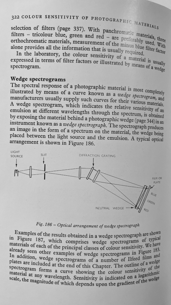

Yes, it's in the Ilford Handbook. They used a diffraction grating and neutral wedge. I'll try to attach a photo of the relevant pages.
Mark J
Mar 23, 2023
438
Denbigh, North Wales UK
Excellent !
Well one error in my understanding that I've picked out already there, is that the Ilford graphs are logarithmic. That's easily accounted for, and will bring down the suspect extra sensitivity in the blue.
Edit : that's an elegant piece of kit actually. The diagram is simplified in that it doesn't attempt to show the wedge filter properly, in that this operates in the cross-wise plane, actually. But the nature of an absorbing filter is that linear changes in thickness produce a transmission variation that is a straight line in Log-space. Crafty !

Kodak definition. Is clearly stated below the sensitivity graph of, e.g. TX400 datasheet:
No need to specify if the photons are coming from a 2800K blackbody, or 5000K, or other light source. At each wavelength, what energy per unit film area is necessary to produce a specified fixed density. If we think of this as a function, or a two-column spreadsheet, we have wavelength in the first column and ergs (or joules) per cm² (or m²) in the second column. Take inverse, because we talk about sensitivity, then log for the usual reason (display a large dynamic range on a graph). So far so good.
Ilford definition. Is undefined. The ordinate is labeled "sensitivity" without any definition. And this mention "tungsten light (2850K)". So, yes, I agree, the first reaction is that this light source is so deficient in blue light that the measurement mis-represents the film's sensitivity at blue wavelengths. And can we correct for that? Dividing by the energy distribution of a 2850K blackbody? But what is on the numerator of that fraction? the "Sensitivity", which is undefined, so... the result is also undefined.
When you correct a raw experimental result, it is because you have identified a feature of the equipment/process that you understand well enough co compute its effect on the raw result, apply a correction, and infer a corrected value. For instance, as I mentioned in my previous post, if the Ilford spectrogram is obtained by dispersing a tungsten filament's light through a prism, depending on the glass used, and the angles, distances, etc, the red light might be more/less dispersed (millimeters along spectrum versus wavelength) than the blue light, leading to an unfair/improper ratio of sensitivities at the two ends of the spectrum. Just an example. Key point is we don't know the measurement process, therefore we cannot correct.
Only a guess. I believe the Ilford engineers have properly corrected for the deficiency of a 2850K blackbody in blue energy. I write "somehow" because there are several equally plausible, but not equivalent, ways of doing that. And that they also corrected for the dispersion law of the prism and other dirty details. And that the mention "Wedge spectrogram to tungsten light (2850K)", while technically correct (that was the source used in the measurement), is misleading, because the specifics of the light source and dispersing aparatus have been corrected for in the displayed result.
A hint (only a hint) that this is the case is the large spike in sensitivity in the corrected curve obtained by Mark.
