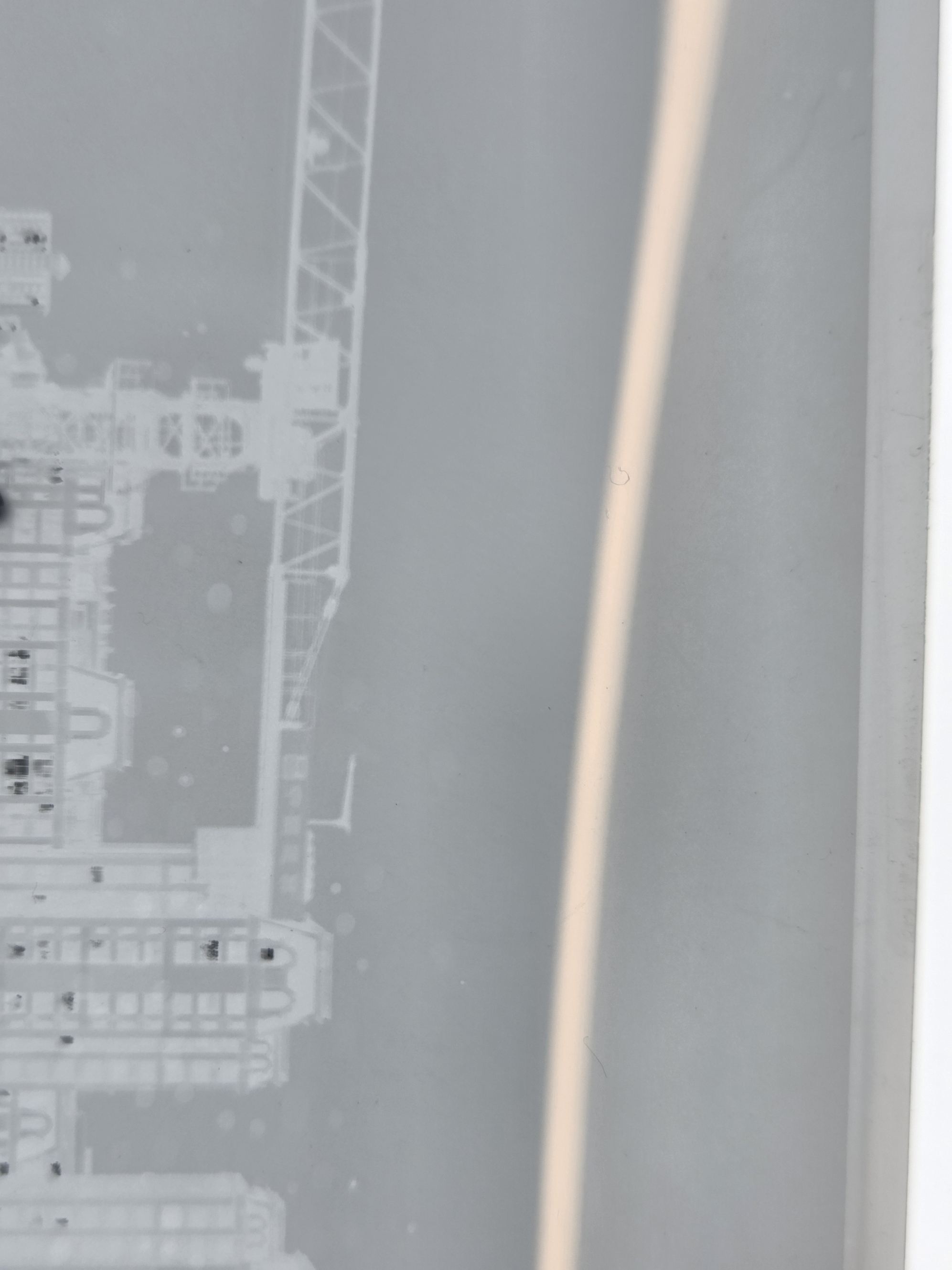

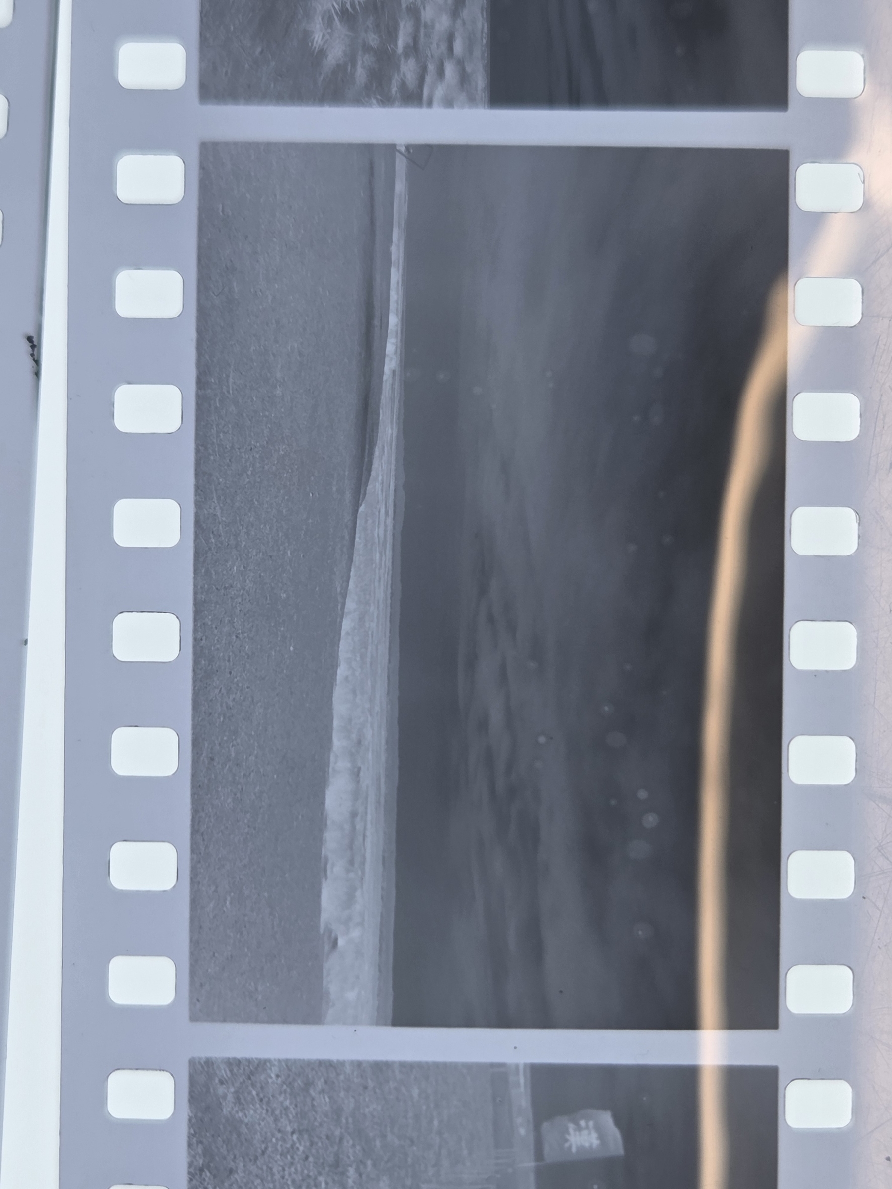

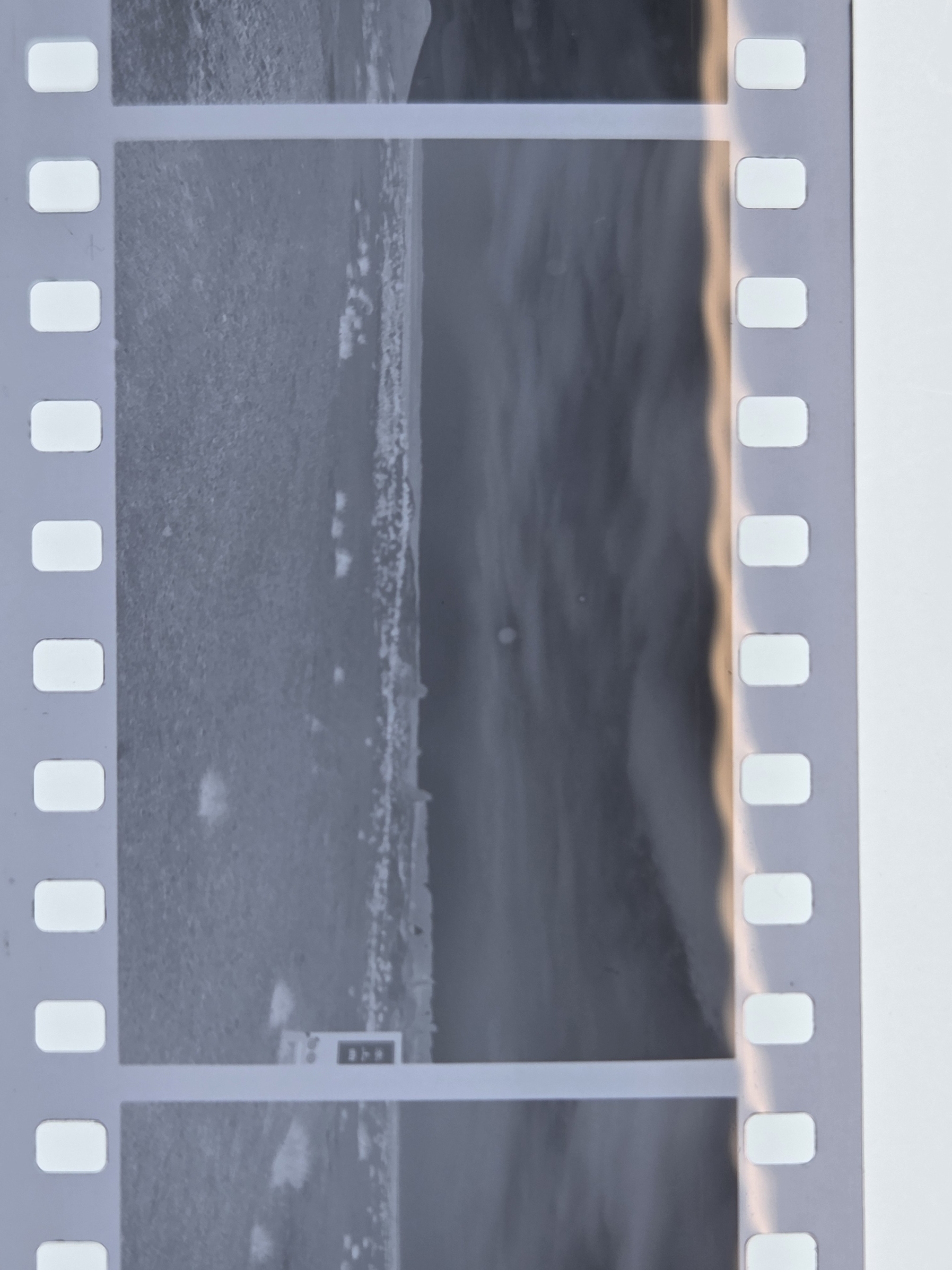

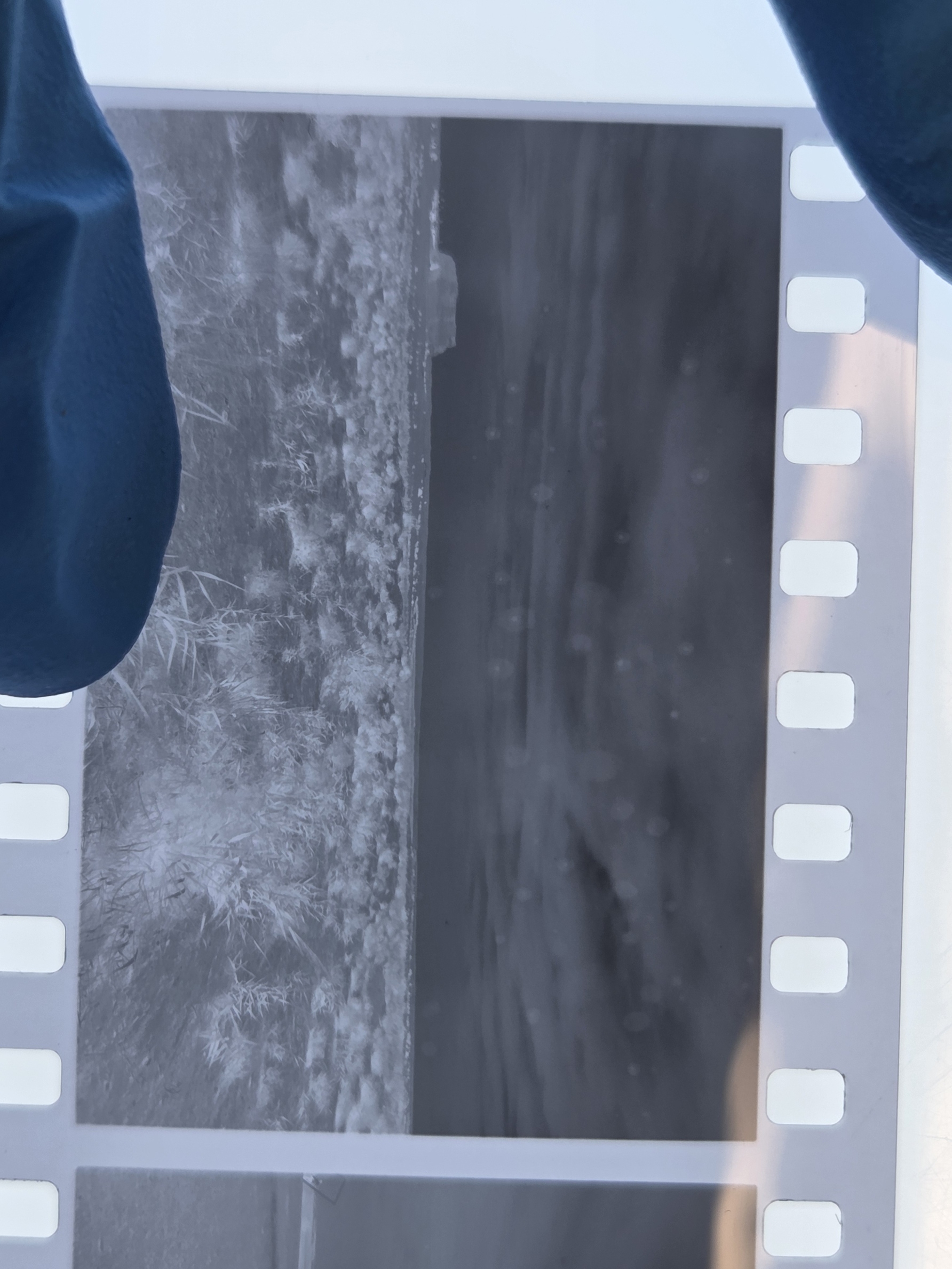

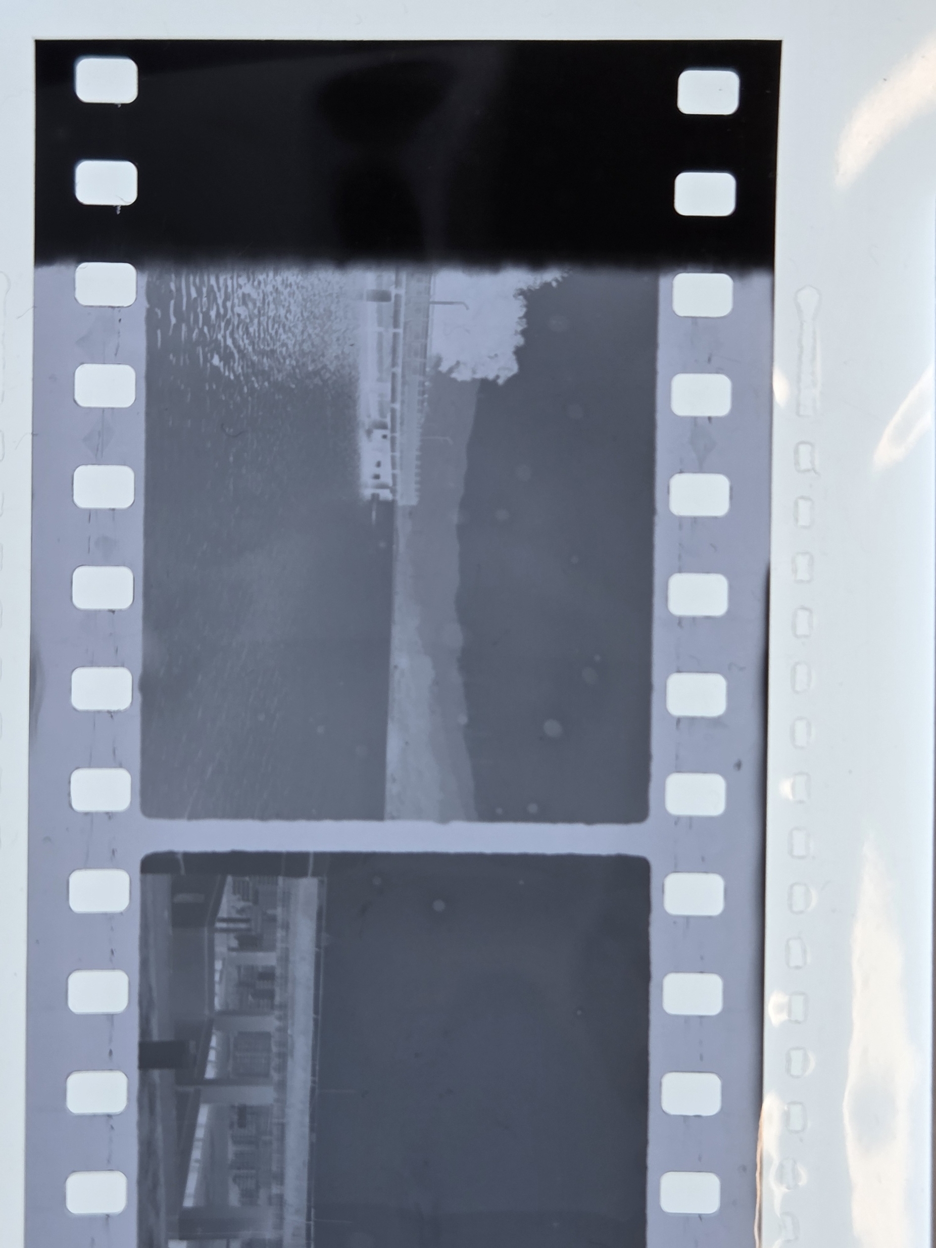

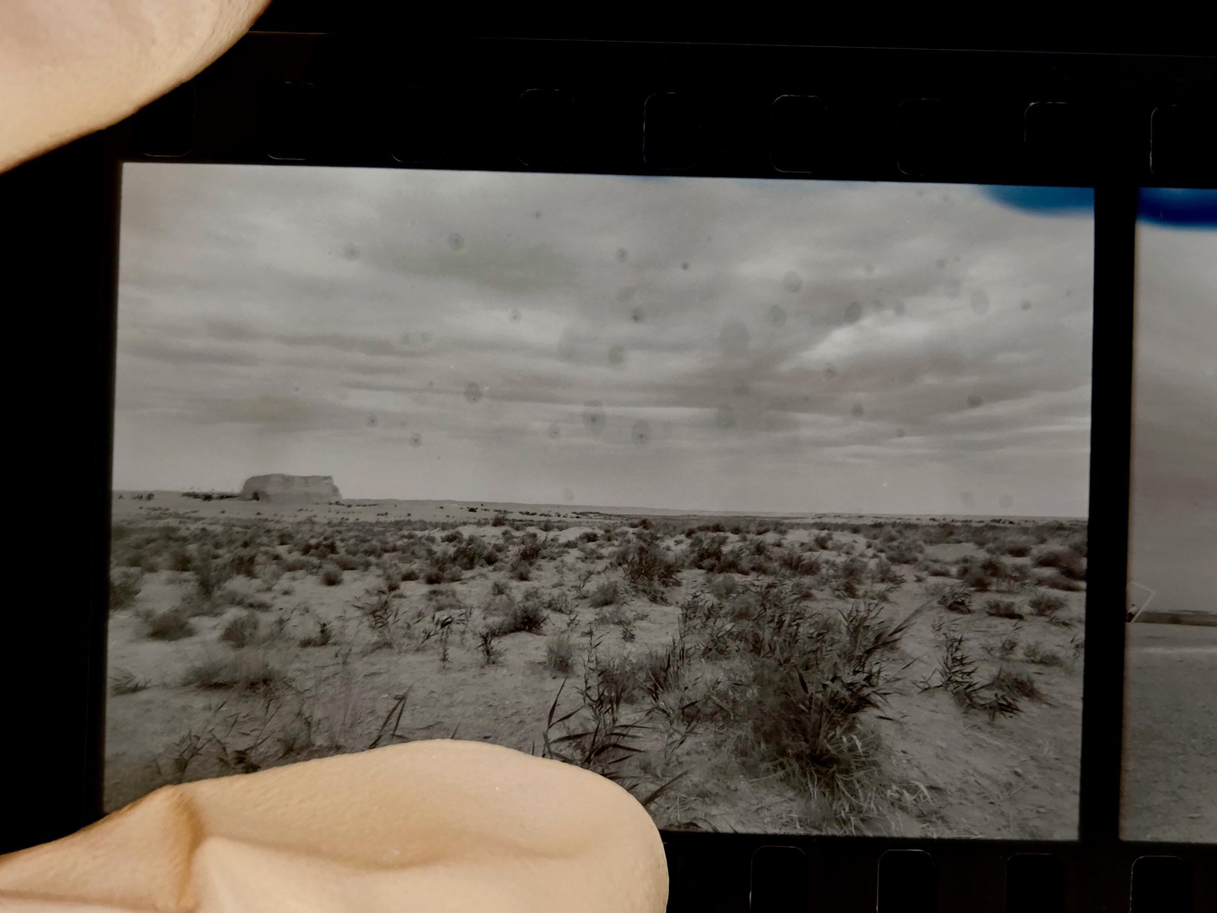

I just switched to PSI version Xtol, and developed two rolls of Foma200 film in a week. Unfortunately, however, some low-density spots randomly spread on images. I use fridge to cool Xtol stock to 20℃ before processing. The first roll was processed with very fresh developer, which I dissolved 10-20 min before developed the film. When saw those awful negs, I doubted that maybe my developer was so fresh that some undissolved particles still exist. So I wait for days and processed another roll, then got the same result.
20250810_224621.jpg20250810_224707.jpg20250810_224733.jpg20250810_224753.jpg20250810_224815.jpg

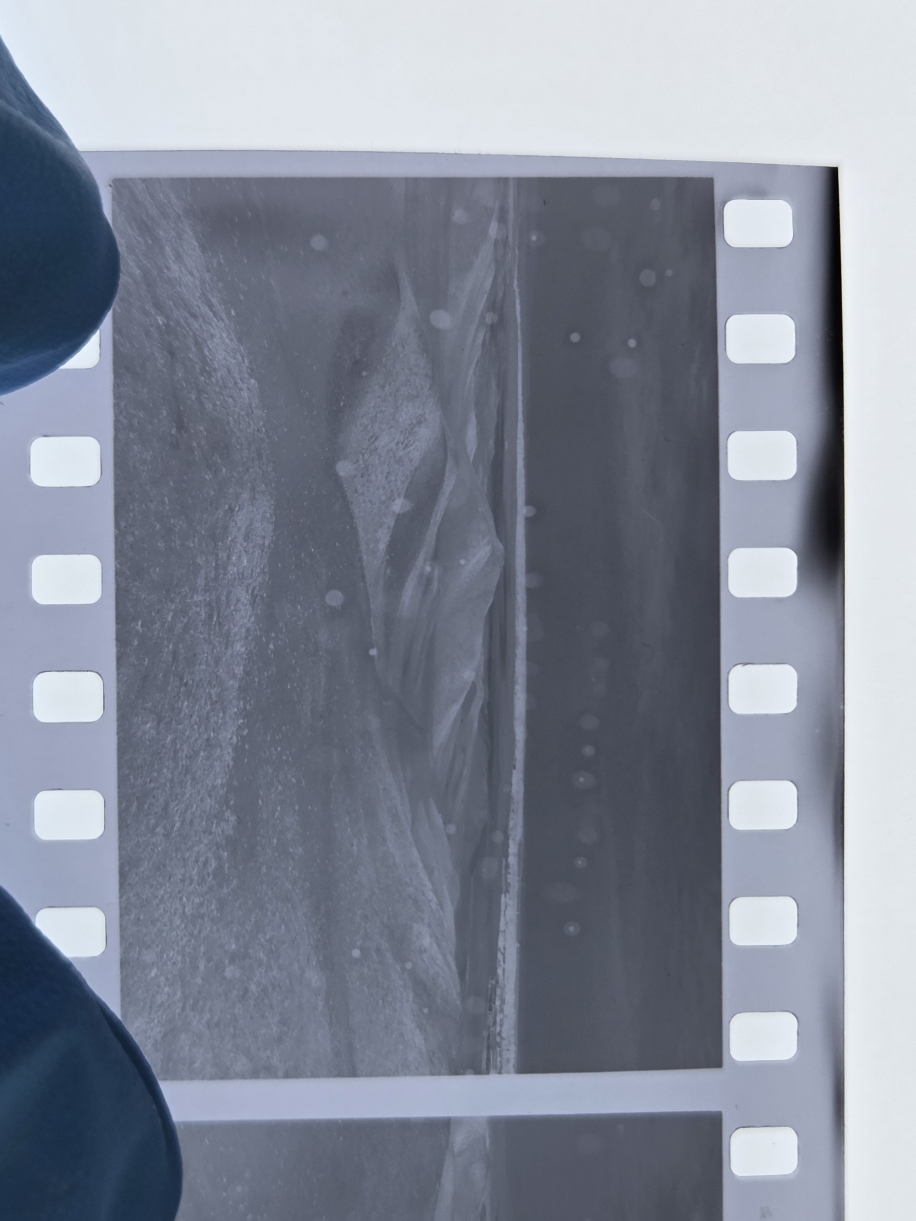

If reverse any image which with spots, dark "cores" can be seen in the center of each spot. Seems like some solid things, for example, KBr, sticked on emulsion and inhibited AgX's reduction.

Those look like air bubbles to me, clinging to the film early on in the development process. More vigorous agitation in the first 30 seconds of development may solve this.
Also few quick hard thumps of the bottom tank will take care of that problem right a the start of processing. I do that on a hard rubber block instead of the counter.
I follow Kodak's guidance, always continually agitate 30s after pour in developer. And hit tank for 4-5 times after agitation. I never see any air bubbles before. And IMO, a typical air bubble would only lead to a simple spot.
If you look at the "spots" on the negatives the OP has posted you'll see a tiny dot in the middle of almost all the lighter density circles. Almost like maybe a teeny-tiny speck of one of the chemicals in the developer lodged itself on the soft emulsion and disrupted development in that area. I know all about Foma 200's reputation for defects and have seen it first hand myself with their 120 film version, but use Foma 200 in bulk 35mm with no problem.
Good catch, I hadn't noticed that before. This doesn't look like air bubbles.

I've had spots like this with a few rolls of CMS20, a halo surrounding a dark spot, and they only ever appeared in the first three or four frames, and usually only in areas of even tone such as the sky. But it's a very different film from Foma 200 and I was using Adotech developer, so there's no correlation. Never found out what caused it but definitely not a lack of agitation or not filling the tank properly. My only theory is some sort of contamination during the manufacturing process given the rest of a 36 exposure roll would be fine, but why did they only appear in the sky?

There's a distinct possibility it is a user technique problem as well. Those marks look suspiciously like air bells (but maybe not).
I recognize that not everyone has had problems with Fomapan 200, but it seems to be enough of an issue that Blue Moon Camera has issued a warning to buyers that it needs an extended presoak to reduce faults on their negatives.
Air bells was my first thought; see above. But the darker spot in the center of these defects and their overall geometry upon closer observation doesn't seem to support this.

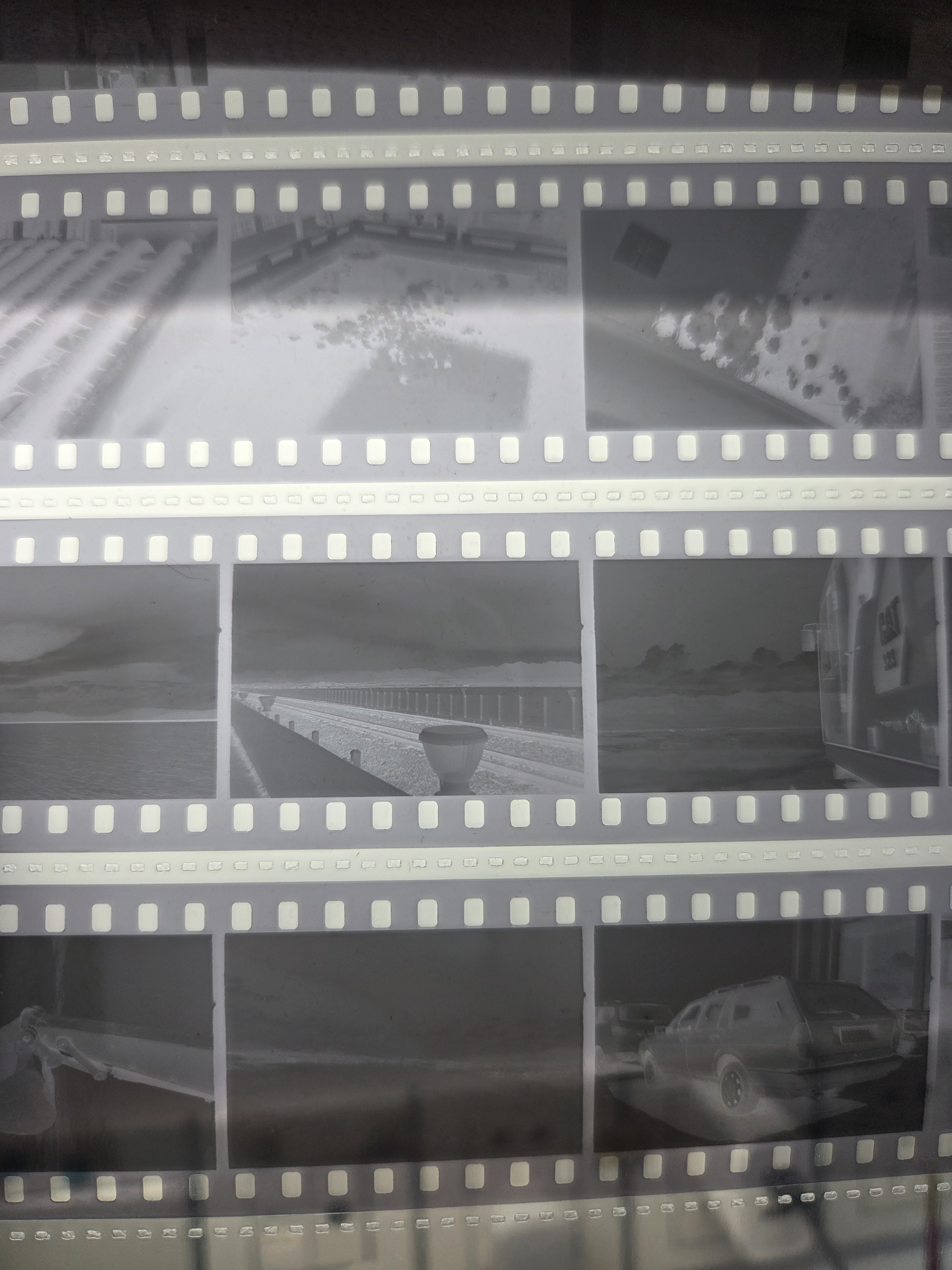

Yes, I did. However, it didn't work. I cut some excerpts from the same roll, and divided them into several groups: Xtol without pre-wash, Xtol with 30min pre-wash, Rodinal without pre-wash, 510-Pyro without pre-wash. Only strips developed by Xtol showed those spots.
Ahhh... FP-100 sheet was also polluted by Xtol
And I tried 35mm FomaPan100, 35mm HP5+ and 4x5 FP-100 sheet, spots happended on all these film developed with Xtol. Image I quote is FP-100. I've used Xtol for a long time and I firmly sure that this Foma200 bulk roll I own had never got any wrong.
Then I think you've identified your batch of Xtol as being the problem. Discard it and get some from elsewhere. Do you have a record of the batch number or whether it was made by Sino Promise or Photo Systems Inc.? I suggest you do NOT buy any Xtol made by Sino Promise, as they effed up a lot of the Kodak branded chemistry.
