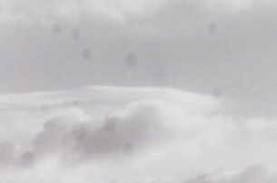

Then it must be a developer "style or type" problem. If things are fine with Rodinal and not with a Vitamin C type developer then there has to be a reason why. I'd start looking at your water quality if you're not using distilled water. Maybe something in your water doesn't like something in your Vitamin C style developer. Maybe Rodinal doesn't care what's in your water? If you use distilled water for all the steps in your developing process I don't know where else to look for the problem. What I'm saying is if you're not using distilled water I'd certainly give that a try since it would be a pretty cheap fix. I wish you luck!
except wash, i use distilled water in all processes
I have no idea about what they are and what cause them

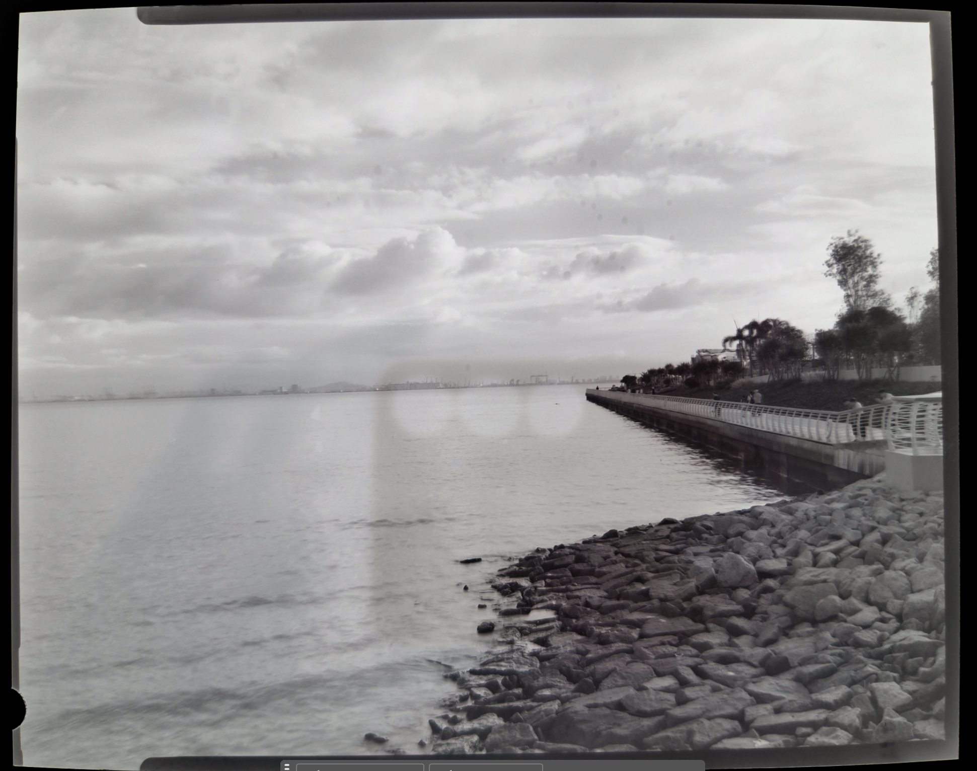

That appears to be light fog - it is a faint image, rather than a problem with chemicals.

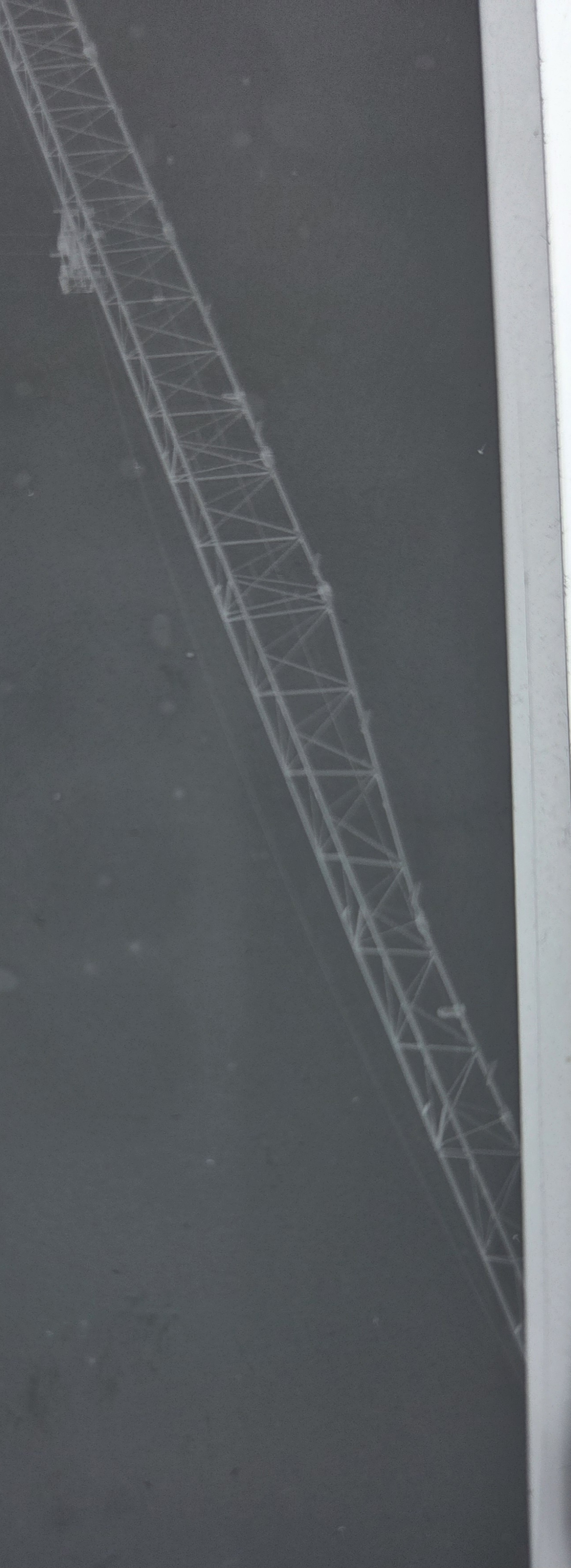

I think what we're talking about is not the big artifacts, but the small ones here:
The big ones look like they're caused by how the backlit negative was photographed.
It's really odd, this one. I'm quite sure (but would have to check) that I've developed Fomapan200 4x5" in my own version of instant mytol. Not 100% sure though...What I am certain of is that I've never seen these particular spots on this film. Or any kind of conspicuous defect, really.
@MsLing are you still using a soak prior to development? I'm clutching at straws here, obviously. It's really odd. I wouldn't be surprised if you would hit upon a sheet of film that breaks the pattern of this particular type of developer correlating with this particular defect. I.e. it might be a 'simple' case of one sheet being affected, while the next one isn't, regardless of how the film is developed.
May be my phone and hand.

No, I didn't use, just directly pour developer in. I decide to try FomaRotro320
Quite nice. Rodinal 1+100+2g sodium isoascorbate/L
Same sheet with Rodinal is OK. I am now mixing another version with pure water.
Surfactants! I think the lack of surfactants cause those spots. Without it, developer cannot opportunely soak emulsion. I added some drops of surfactants into developer and developed another sheet of Retro320, no visible spots and density seems bit lower than without surfactants.
Makes good sense; surfactants are often added to developers (e.g. C41 developer usually has surfactants in it) as well as to the film emulsion itself, although in the latter case the rationale might also be coating dynamics.
Obviously cleaner

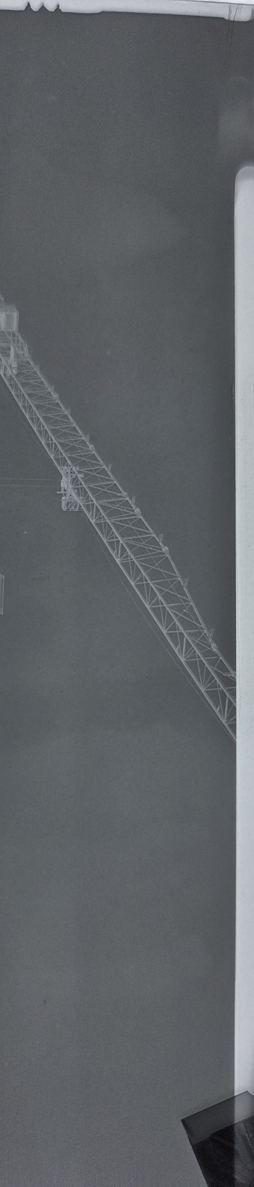

Certainly looks like it, although you may now have something else going on here:
However, maybe this is not in the actual negative and it's just an artifact of photographing the negative. I boosted the contrast in the example above to make it easier to see what I'm referring to.
I check it on negative, that's a shadow of something, film is clean.
