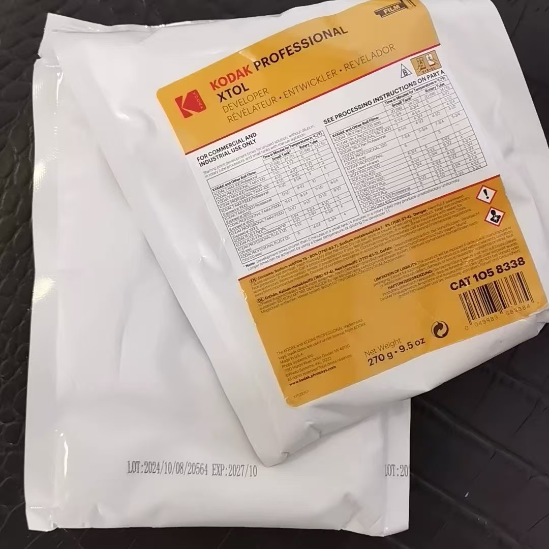

Do you have a record of the batch number or whether it was made by Sino Promise or Photo Systems Inc.? I suggest you do NOT buy any Xtol made by Sino Promise, as they effed up a lot of the Kodak branded chemistry.
PSI manufactured it. Humorously, maybe Sino version developer ran out all my luck, since all my Sino Xtol work well from beginning to the end XD

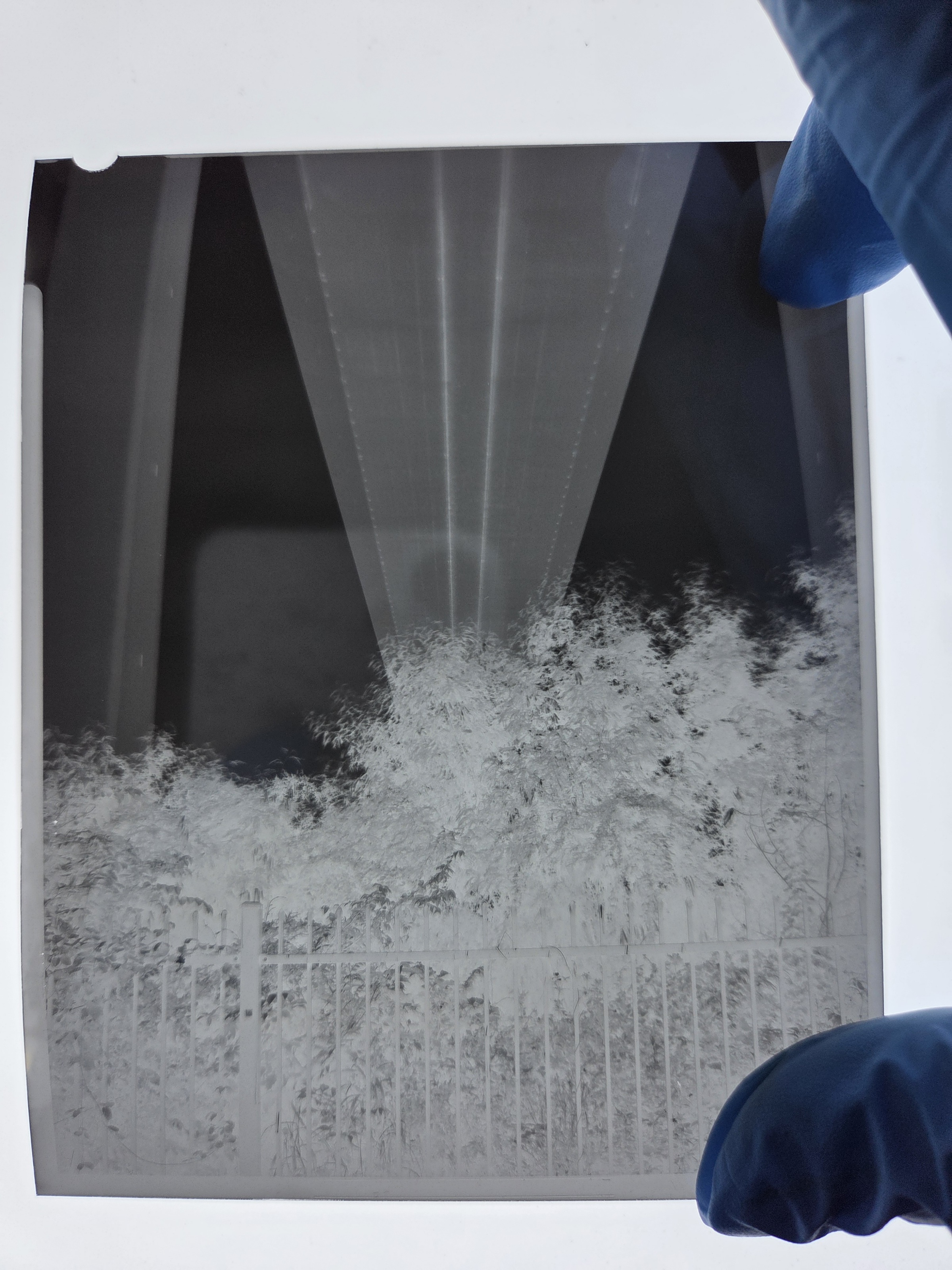

Yes, I did. However, it didn't work. I cut some excerpts from the same roll, and divided them into several groups: Xtol without pre-wash, Xtol with 30min pre-wash, Rodinal without pre-wash, 510-Pyro without pre-wash. Only strips developed by Xtol showed those spots.
And I tried 35mm FomaPan100, 35mm HP5+ and 4x5 FP-100 sheet, spots happended on all these film developed with Xtol. Image I quote is FP-100. I've used Xtol for a long time and I firmly sure that this Foma200 bulk roll I own had never got any wrong.
Yup, you have a bad batch of Xtol.

I decide to test US patent 5853964. Looking for more info about DTPA content and waiting for PSI's reply now
Maybe it's solid particles surrounded by a bubble for some physical reason. That would explain the similarity to air bells.
Good news, I finish mixing. If test result is nice, I'm going to switch to industrial chemicals which can reduce plenty of cost. These AR chemicals cost about CNY11 per L($1.53), includes distilled water. DTPA-5Na and sodium isoascorbate cost nearly 50% of all cost. If I use industrial level, it will only take me ¥4.486/L($0.62). Nice
Failure! Those ghost spots still there! But ahhh... I think I should add some antifoam, since lots of foam erupted when developing finish. And this developer, if use Xtol's process time, will provide a underexposed and low density negtive
Is it with the same film as before? Are you using distilled water for mixing your developer? It could be the film itself, but that sounds strange.
A few years ago, I had two 100-foot rolls of RPX25 that also showed these “spots.” The material was stored at -21°C (like all my photographic materials). It was not stored beyond the warranty period. I discarded it and never used RPX25 again.
Neither pre-wetting (with and without wetting agent) nor the use of different developers helped to eliminate the problem.
My two 100-foot rolls were simply junk.
That's why I ask if it was the same film. Chasing a developer problem might just be barking up the wrong tree, so to speak.
This film is absolutely perfect, I used Rodinal and didn't see any problem yesterday. And of course distilled water.
