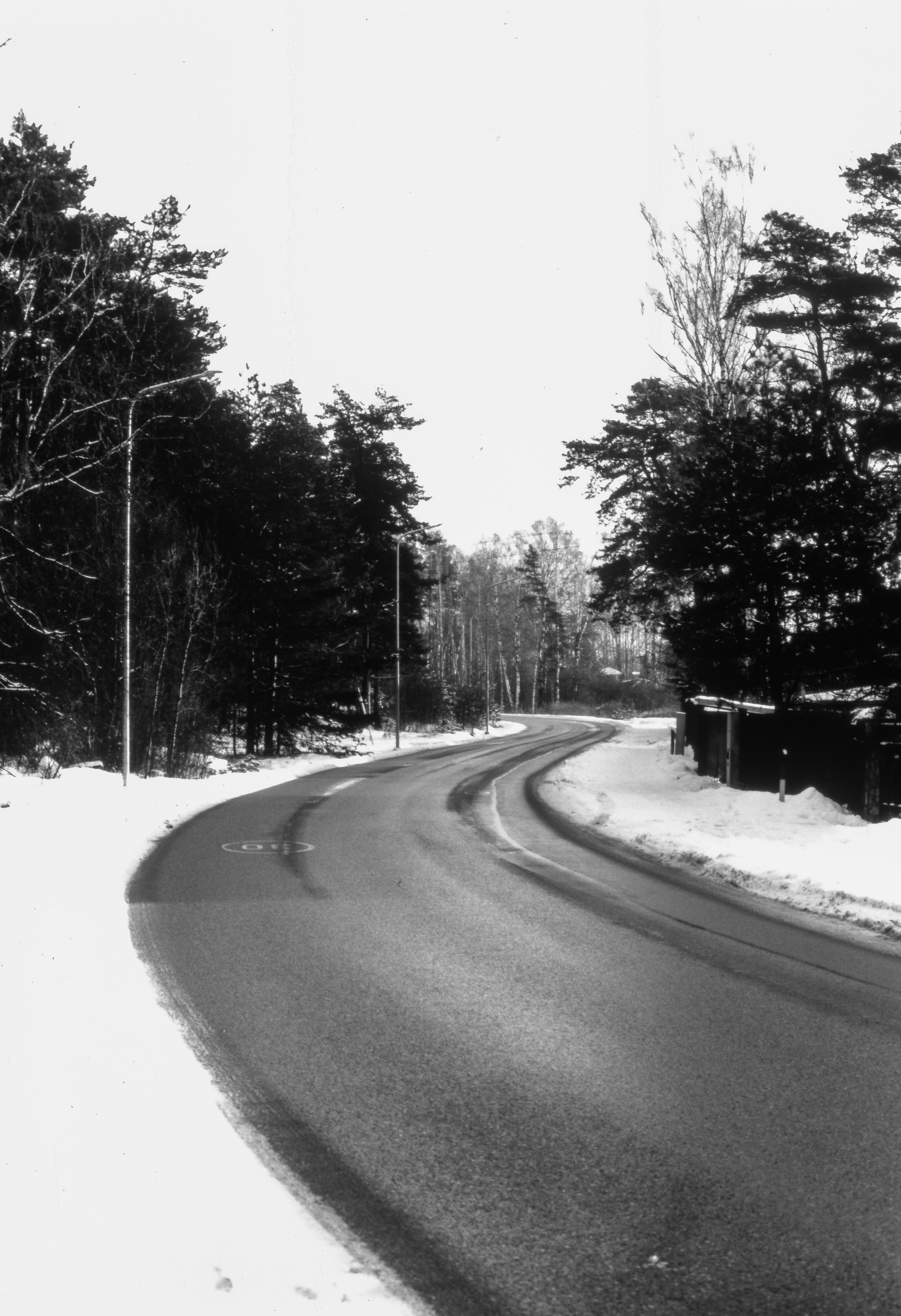

P30 in Diafine at EI50. It looks ok here and it’s printable at this speed, but the negatives are thin. Prints with split grade only.
Nice. Shadow detail looks good.

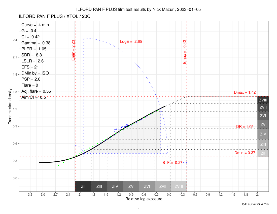

I though I'd include a couple of plots to add a bit of detail to the analysis.

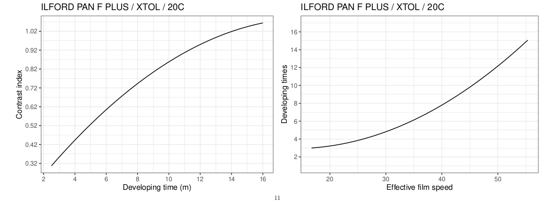

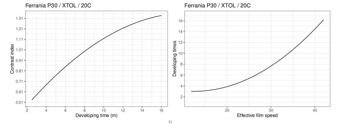

The first pair shows the relationships between Contrast Index (CI), developing time, and Effective Film Speed (EFS). Both films respond very nicely to varying development times.
View attachment 325890View attachment 325891
I am sure a lot of you already know this, but perhaps this will be useful to some of you. The term Contrast Index is often used interchangeably with Average Gradient () and Gamma (γ), but they are not strictly the same. Often, is calculated as the ratio of DR to LogE, which you can see marked in red in the plot below. Gamma is the slope of the straight-line portion of the curve. Identifying that straight line was often done "by eye" but it can also be derived by statistical analysis, which is what my program does. It is marked with the green dotted line. Finally, CI, is calculated based on Kodak's graphical model, which involves two circle segments, measuring the slope by means of a graphical "calculator," such as this one below. In my program, CI is also derived programmatically, rather than graphically, but it amounts to the same thing. It is marked with blue dotted lines in the plot below. So in this particular curve, the CI is 0.42, is 0.4, and γ equals 0.38, so they are all very close. It's not always this way, as some of the more idiosyncratic curves, esp. s-shaped ones, often produce divergent values for these three parameters. Personally, I don't mind using these three parameters interchangeably, but since I calculate them separately, I thought I'd mention it.
This plot also shows one possible way of deriving Zone System information from the characteristic curve. This is just one example of several models that have been used in ZS literature. Here, I am using relative log exposure values so the axis looks reversed. It's a convention used in the Beyond the Zone System model.

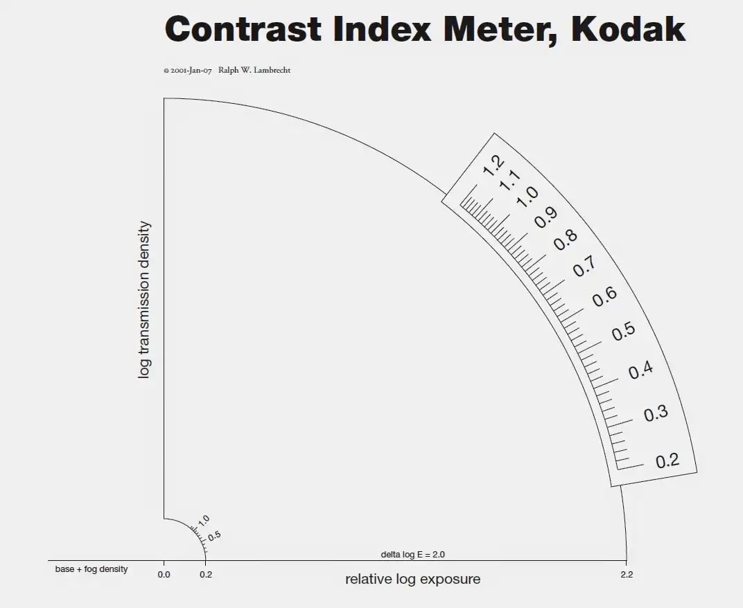

Kodak's CI graphical calculator:

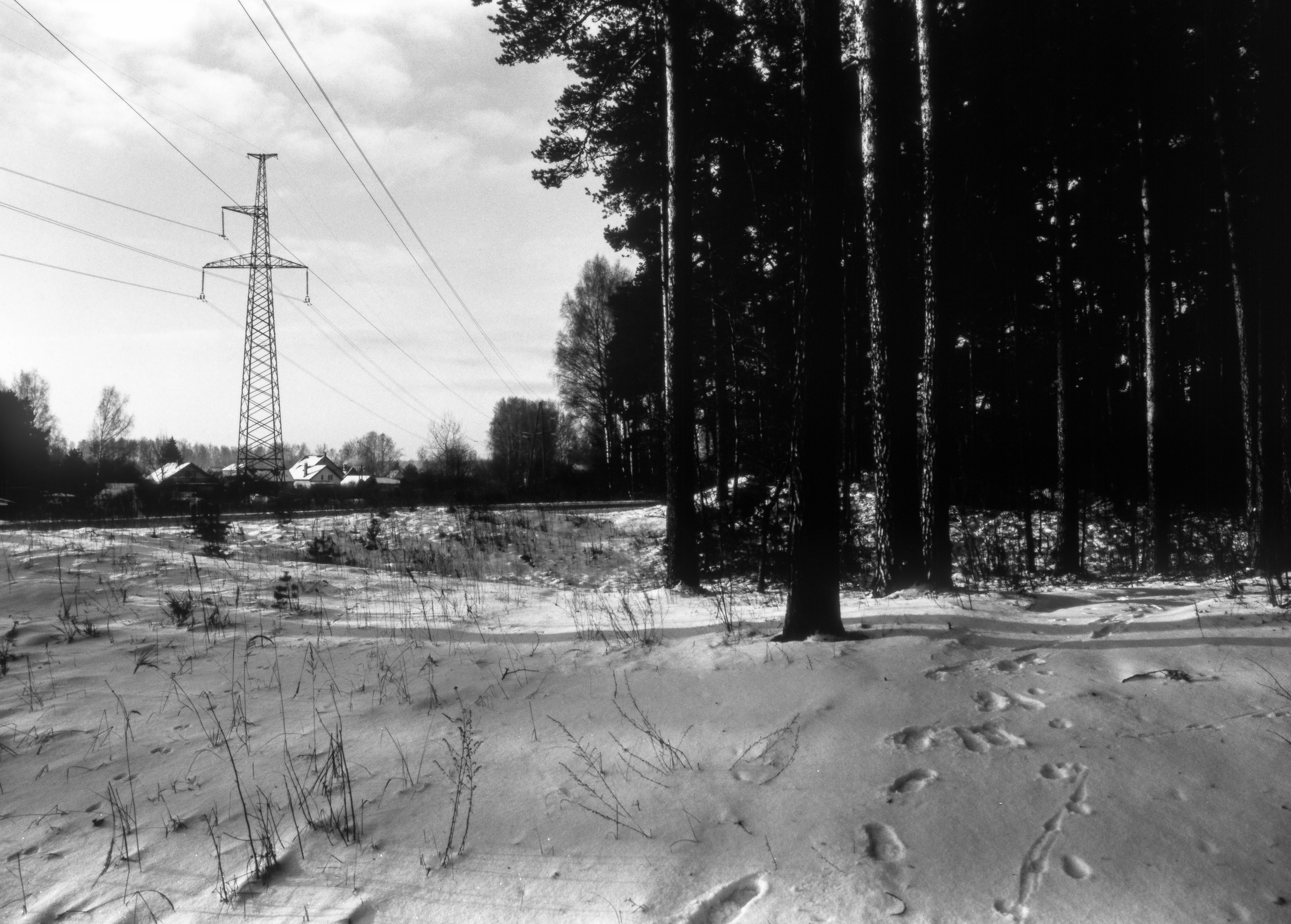

Meanwhile let me share some examples from this run:

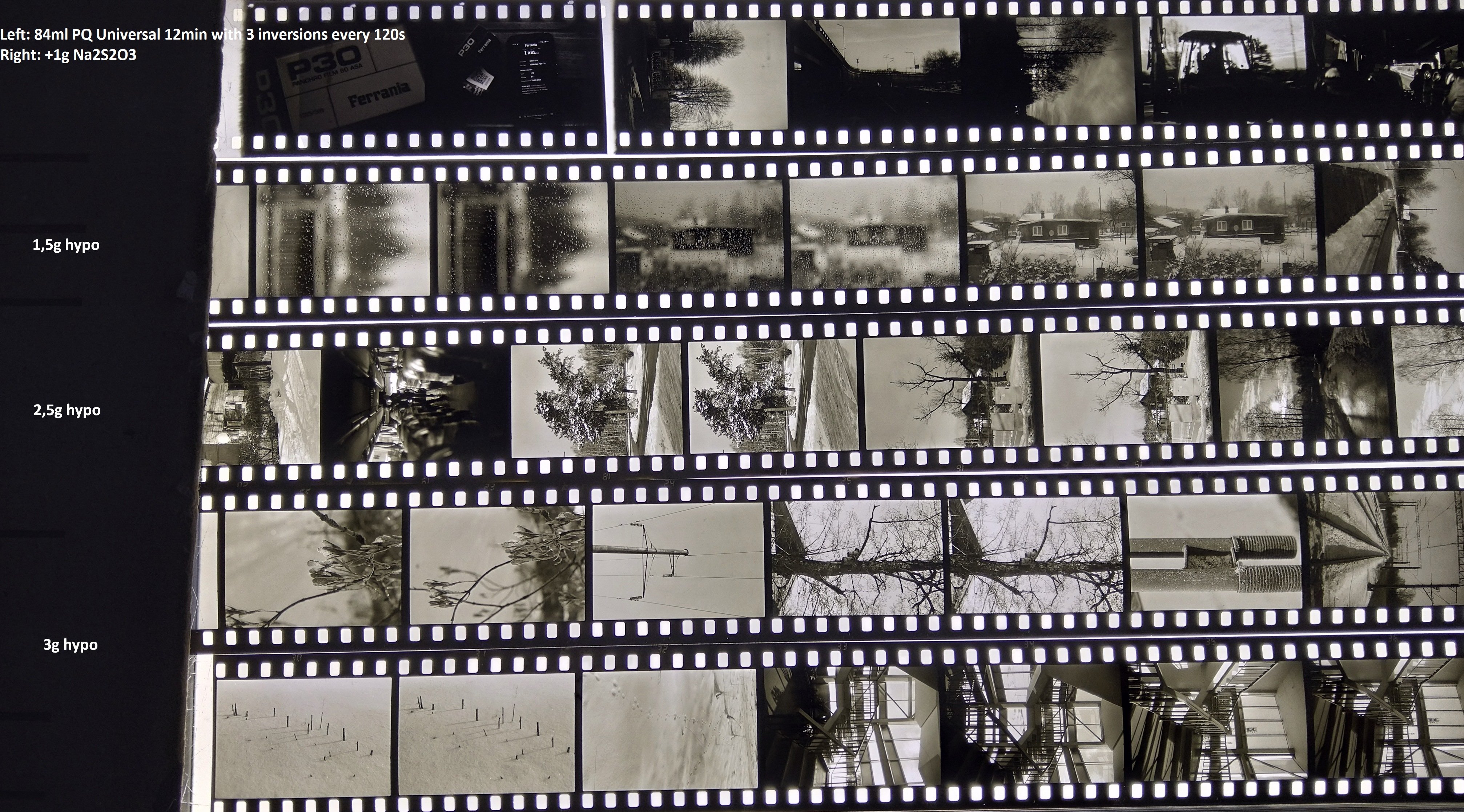

I did the dance and yesterday reversed one roll of P30, cut in 4 individual strips. My process was:
1) Took the same developer (that yielded underdevelopment) to reverse second film in it - I rate it up to 2x 135/36 films, third is a stretch and requires compensation - I avoid third generally.
2) Then I added 1g Sodium Thiosulphate (hypo) crystals to it as a starting point for strip 1/4, based on the severity of previous underdevelopment.
Everything else remained the same to allow control for one variable: the necessary hypo concentration in developer for Ferrania P30 to clear overexposed highlights to the base:
- 84ml PQ + Xg hypo: 12min 1st development with 3 inversions every 2 minutes: Strip 1/4: 1g | Strip 2/4: 1,5g | Strip 3/4: 2,5g | Strip 4/4: 3g hypo
- 6min dilute bleach bath > 2min Clear > 2min Reexposure, unspooled
- 6min 2nd development in the same juice > 2min hypo fix > 2min Antistatic Rinse aid.
- Strip 1/4 and 2/4 got 1,5g hypo in second developer | Strip 3/4 and 4/4 got 3g of hypo in 2nd developer.
What I got is something that finally approaches perfection - fine-tuning is all that remains. Shadow's are alive, highlights aren't blown + I like it!
And by the looks of it - next time I'll do this the same, starting with 4g of hypo. This amount approaches that of what Delta 100 - a T-grain film - needs for successful reversal. I'm mentioning this, because it's known that T-grain films need more oomph in the juice.
