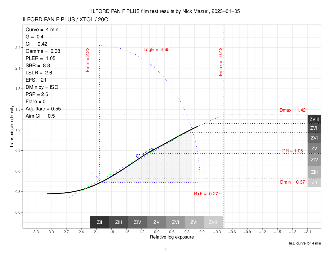

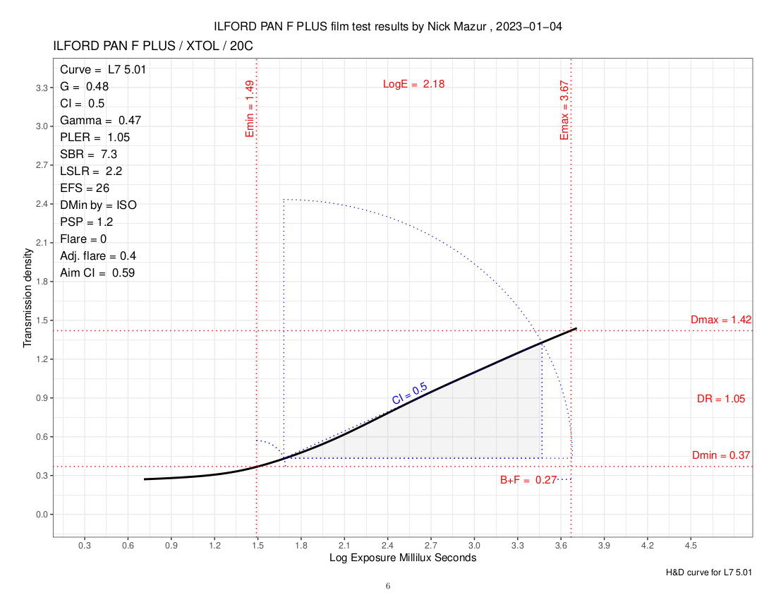

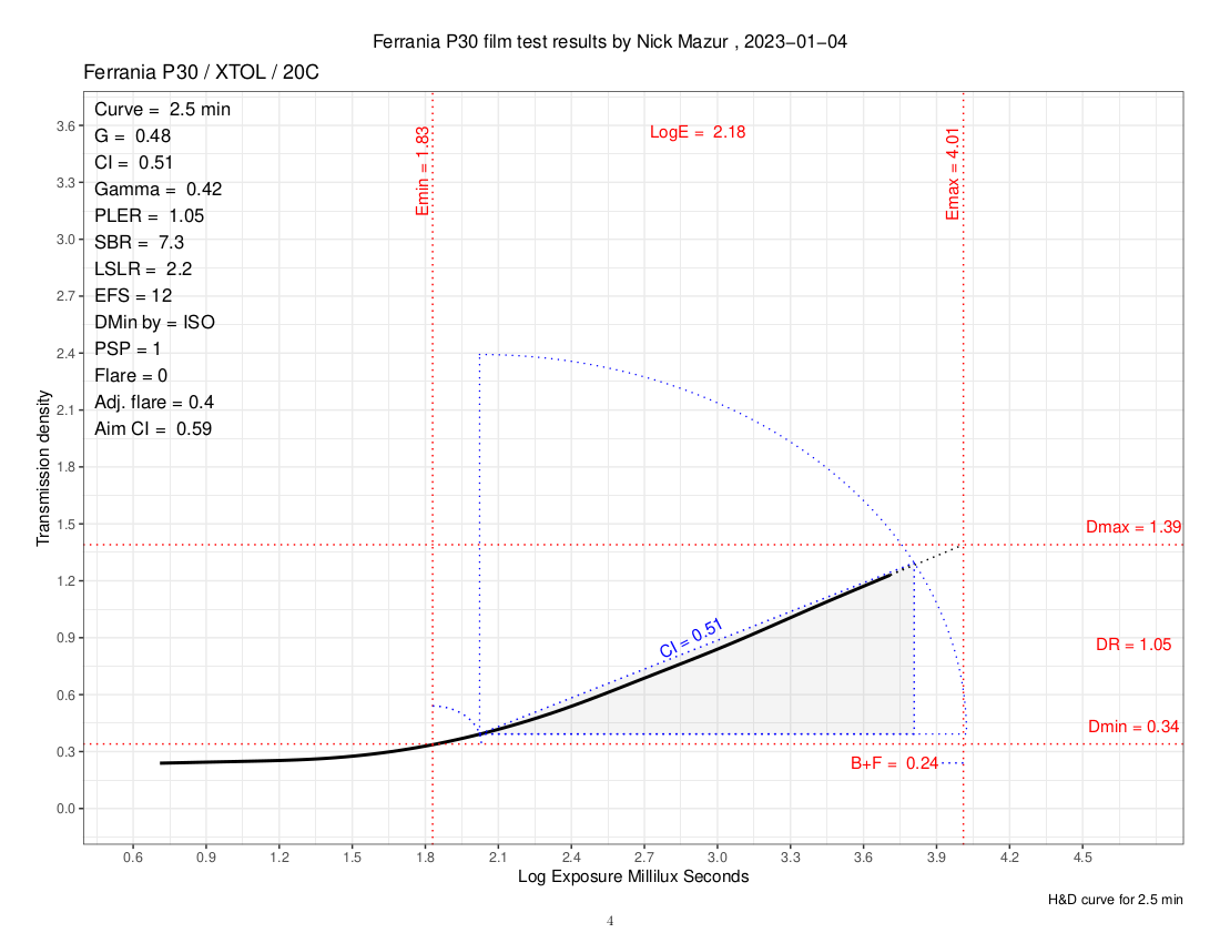

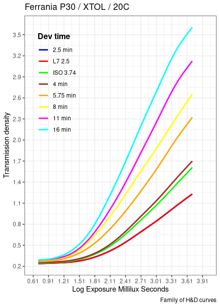

I want to follow up on the discussion of the Exposure Index (EI) of the ILFORD PAN F Plus and Ferrania P30. My analysis will probably come as no surprise to those of you who know these films very well. For example, a lot of photographers use half the box speed as their EI for "normal" outdoor scenes. It is has been common practice for a lot of films out there, and so it turns out to be good practice for the PAN F Plus, but not exactly for the P30.
Here, I have a theoretical curve for the ILFORD PAN F Plus, based on my data, and, indeed, the EI (here I use the BTZS term "Effective Film Speed," or "EFS") turns out to be ISO 26 and a development time of around 5 minutes in XTOL at 20C in a rotary processor. The "normal" scene here is considered to be about 7 stops, or, to be exact, the Log Subject Luminance Range (LSLR) of 2.2. The BTZS framework uses the terms "Subject Brightness Range" or "SBR," instead of the more common "LSLR," but it is, essentially, the same thing, except SBR is typically expressed in stops, so the SBR of 7.3 equals the LSLR of 2.2.
For the Ferrania P30, I didn't have to generate such a curve, as the 2.5 minute curve happens to correspond to the LSLR of 2.2, with the EFS (or EI) of ISO 12. So, yes, the P30 turns out be quite a bit slower than the advertised EI 80 or even EI 40, but it doesn't bother me. It's an interesting "special purpose" film as far as I am concerned.
As far as the term "ISO film speed" is concerned, opinions are divided on whether or not a film can have a range of ISO speeds or just one. Strictly speaking, a film can only have one "true" ISO speed, one measured by means of a specific formula. However, we can measure the "effective" film speed, or EI, at different average gradients, or CIs, to obtain a range of film speeds, which would be characterized by quantifiable gain, or loss, in shadow detail. In my test, the PAN F Plus can range from around EI 15+ to EI 50+ whereas the P30 ranges from EI 13- to EI 40+ or thereabouts. In practical terms, this would translate into setting one's exposure meter to, say, ISO 15 if one wants to pull the PAN F Plus (on a bright sunny day, with lots of shadow detail needed) or ISO 50, if one wants to slightly push it (on an overcast day). I don't mean to dispute the definition of either "ISO film speed," "EI," or "EFS." I just report on my findings.
It occurred to me that it may be more clear if I showed how these "ideal" curves compare to the curve family. Those "ideal" curves are the ISO curve and the L7 curve. The ISO curve is characterized by the Average Gradient () of 0.62, and the L7 curve is characterized by the Log Subject Luminance Range of 2.2 (or SBR of 7.3). These two curves are generated by my program, but they are based on the existing data set, so they have the same characteristics as the other curves in the family. One thing that's immediately clear to me is that XTOL plus rotary processing are not a good match for the P30.
View attachment 325769View attachment 325770
This is very clear, thank you!
Yes, because it is constant agitation. And constant or generally more agitation leads to more density in the highlights.

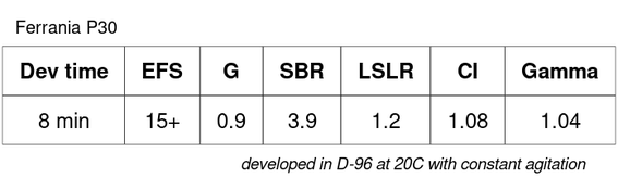

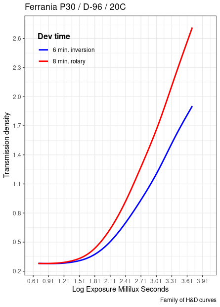

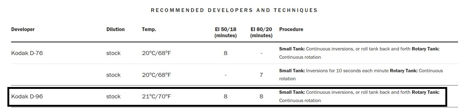

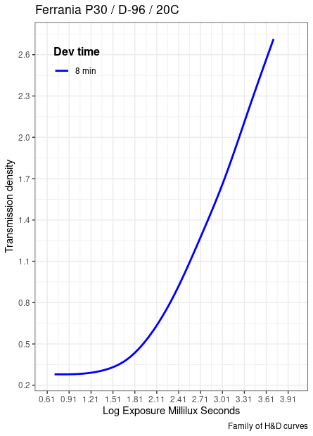

Well, I mixed up a batch of D-96 and processed my Ferrania P30 samples, using the Ferrania official recommended time, temperature, and procedure. Here's a screenshot from that page:
Ferrania recommends eight minutes at EI 50 or EI 80 at 21C using continuous agitation. My Jobo set up is calibrated for 20C, so that's a deviation from the recommendations. I got a very interesting result. Essentially, exposing at EI 50 and processing in D-96 gave me somewhat lower effective film speed and slightly higher contrast than XTOL.

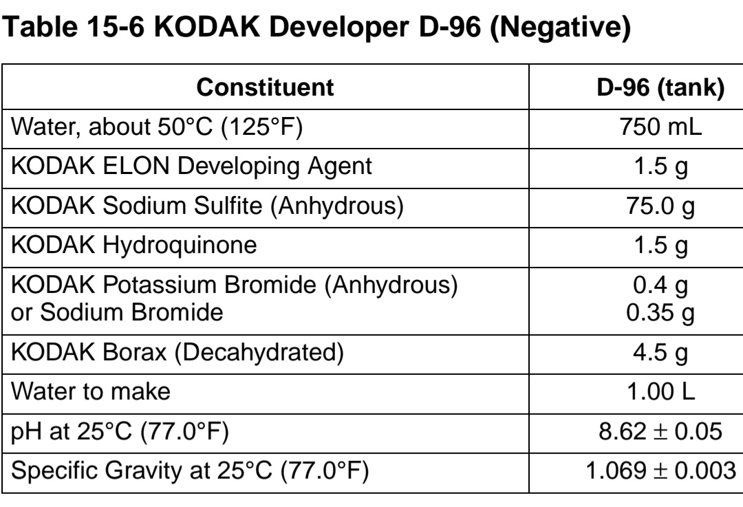

Yes, it's possible that the formula for D-96 I used is wrong, so I post it here so you can tell me if it's correct or not. My chemicals seem fresh. I use them often for mixing my own D-76 when I just need a one-liter batch. I repeated the test twice and got virtually identical results. This tells me that it makes little sense to run an entire curve family test again because D-96 does not produce results that are drastically different than XTOL, unless you guys think otherwise. I don't mind running the full test, if you guys think it makes sense.

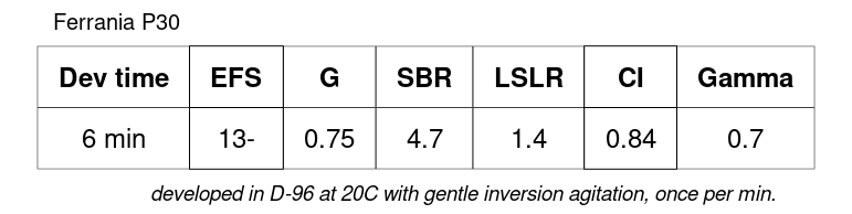

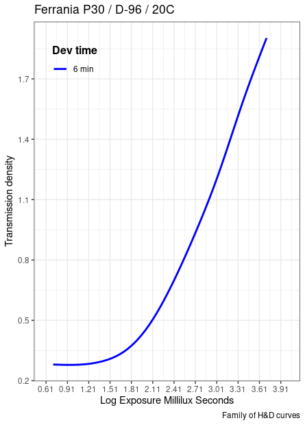

@Film-Niko mentioned that inversion agitation should be used with the P30. That sounded like a very good idea, so I decided to try it. I used D-96 for six minutes at 20C with four very gentle inversions every minute. I though that was a good compromise between trying to tame contrast and reducing the risk of uneven development. Essentially, the curve has the same overall shape, so you can expect very similar tonality between inversion and rotary agitation, but contrast did drop a bit, along with a negligible change in effective film speed. At this point, inversion agitation seems to work out better because you don't have to cut development time below four minutes. So, perhaps five-six minutes at 20C in D-96 with gentle inversion agitation is the way to go, provided it gives even development. More work is needed to confirm that. I think @Paul Howell and @Andrew O'Neill mentioned using a two-bath developer, and I am beginning to think that that would probably be a good choice for Ferrania P30, I am just not sure how it would work for more fine-grained contrast control, as in pulling and pushing. I don't have much experience with two-bath developers, so perhaps someone would chime in and tell us more about them.
Here are the two curves on the same plot for comparison's sake:
It seems to me that Ferrania wants to promote a "punchy" kind of look, much like the recently launched CatLABS X FILM 320 Pro, doesn't it? It's an interesting look, no doubt, but, to me, it's only for a special occasion. I can also understand people being frustrated with the film and giving up on it. After all, the ILFORD PAN F Plus turned out to be exactly what Ilford promised in its documentation, whereas the P30 needs more careful treatment to get good performance out of it.
Wow, that's massive contrast! Definitely need to use a lower contrast developer with P30 film.

Four inversions per minute is still quite a lot for P30. I can understand that you have chosen it in fear of getting uneven development.
But at least with the developers I had tried so far, I did not get any problems with uneven development (like bromide drags) with using only one inversion per minute.
Generally by less agitation you get less highlight density and less contrast. That approach works perfectly with all standard films.
In my experience with P30 it works, too. But it is a kind of little finetuning only, and cannot solve the general contrast / too steep curve problem P30 has.

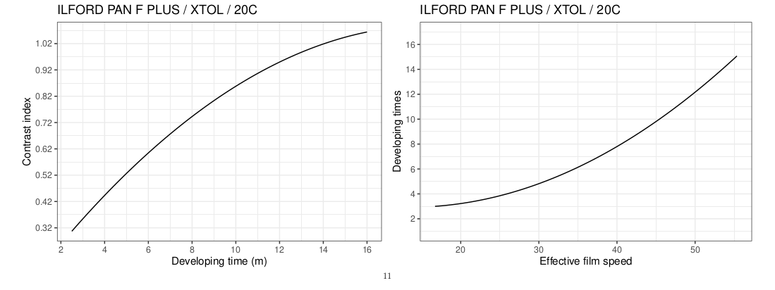

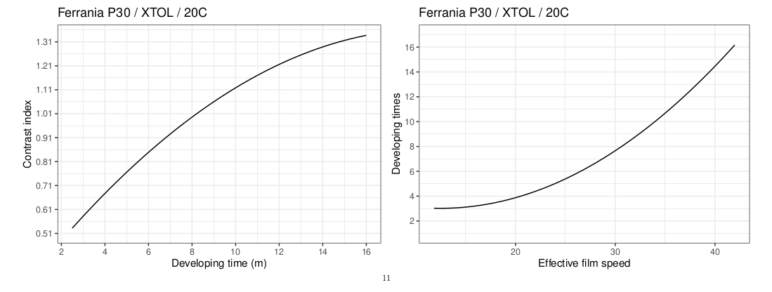

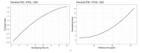

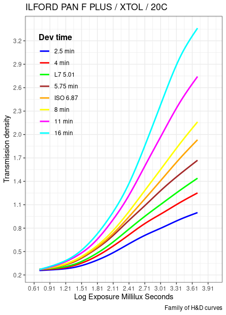

I though I'd include a couple of plots to add a bit of detail to the analysis.
The first pair shows the relationships between Contrast Index (CI), developing time, and Effective Film Speed (EFS). Both films respond very nicely to varying development times.
ferraniaP30Plots.pdfabsolute_finalCIDevTime.pngilfordPanFPlots.pdfabsolute_finalCIDevTime.png

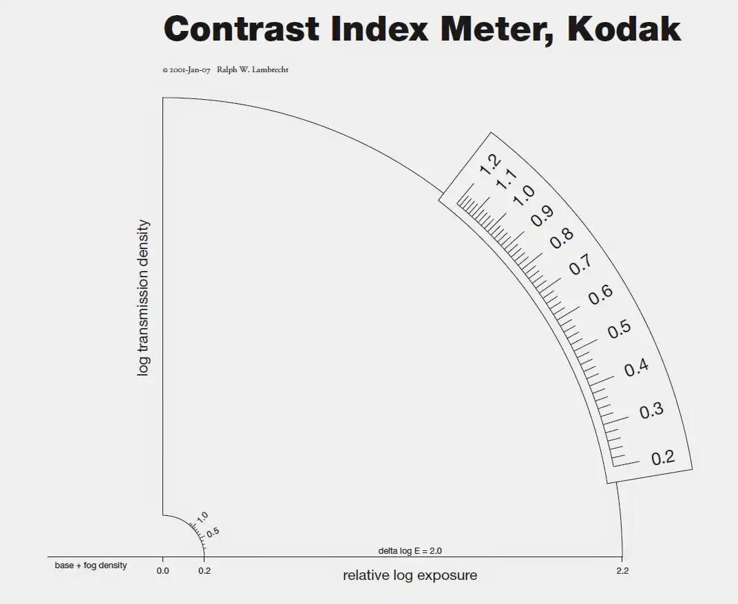

I am sure a lot of you already know this, but perhaps this will be useful to some of you. The term Contrast Index is often used interchangeably with Average Gradient () and Gamma (γ), but they are not strictly the same. Often, is calculated as the ratio of DR to LogE, which you can see marked in red in the plot below. Gamma is the slope of the straight-line portion of the curve. Identifying that straight line was often done "by eye" but it can also be derived by statistical analysis, which is what my program does. It is marked with the green dotted line. Finally, CI, is calculated based on Kodak's graphical model, which involves two circle segments, measuring the slope by means of a graphical "calculator," such as this one below. In my program, CI is also derived programmatically, rather than graphically, but it amounts to the same thing. It is marked with blue dotted lines in the plot below. So in this particular curve, the CI is 0.42, is 0.4, and γ equals 0.38, so they are all very close. It's not always this way, as some of the more idiosyncratic curves, esp. s-shaped ones, often produce divergent values for these three parameters. Personally, I don't mind using these three parameters interchangeably, but since I calculate them separately, I thought I'd mention it.
This plot also shows one possible way of deriving Zone System information from the characteristic curve. This is just one example of several models that have been used in ZS literature. Here, I am using relative log exposure values so the axis looks reversed. It's a convention used in the Beyond the Zone System model.
Kodak's CI graphical calculator:
