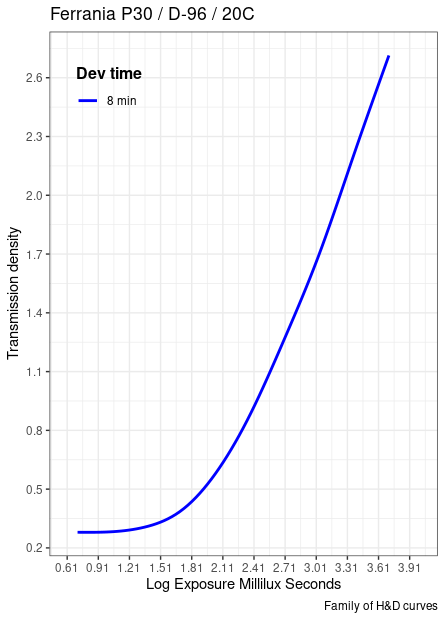

Well, I mixed up a batch of D-96 and processed my Ferrania P30 samples, using the Ferrania official recommended time, temperature, and procedure. Here's a screenshot from that page:

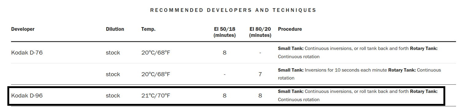

Ferrania recommends eight minutes at EI 50 or EI 80 at 21C using continuous agitation. My Jobo set up is calibrated for 20C, so that's a deviation from the recommendations. I got a very interesting result. Essentially, exposing at EI 50 and processing in D-96 gave me somewhat lower effective film speed and slightly higher contrast than XTOL.
View attachment 325793View attachment 325795

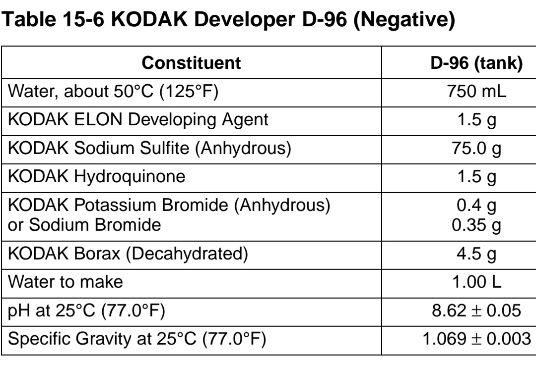

Yes, it's possible that the formula for D-96 I used is wrong, so I post it here so you can tell me if it's correct or not. My chemicals seem fresh. I use them often for mixing my own D-76 when I just need a one-liter batch. I repeated the test twice and got virtually identical results. This tells me that it makes little sense to run an entire curve family test again because D-96 does not produce results that are drastically different than XTOL, unless you guys think otherwise. I don't mind running the full test, if you guys think it makes sense.

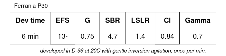

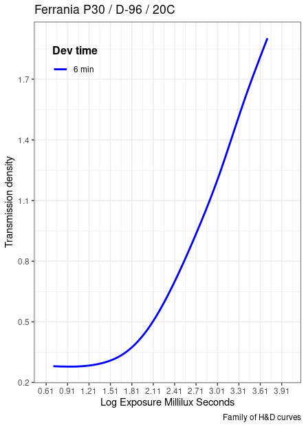

@Film-Niko mentioned that inversion agitation should be used with the P30. That sounded like a very good idea, so I decided to try it. I used D-96 for six minutes at 20C with four very gentle inversions every minute. I though that was a good compromise between trying to tame contrast and reducing the risk of uneven development. Essentially, the curve has the same overall shape, so you can expect very similar tonality between inversion and rotary agitation, but contrast did drop a bit, along with a negligible change in effective film speed. At this point, inversion agitation seems to work out better because you don't have to cut development time below four minutes. So, perhaps five-six minutes at 20C in D-96 with gentle inversion agitation is the way to go, provided it gives even development. More work is needed to confirm that. I think @Paul Howell and @Andrew O'Neill mentioned using a two-bath developer, and I am beginning to think that that would probably be a good choice for Ferrania P30, I am just not sure how it would work for more fine-grained contrast control, as in pulling and pushing. I don't have much experience with two-bath developers, so perhaps someone would chime in and tell us more about them.
View attachment 325798View attachment 325803

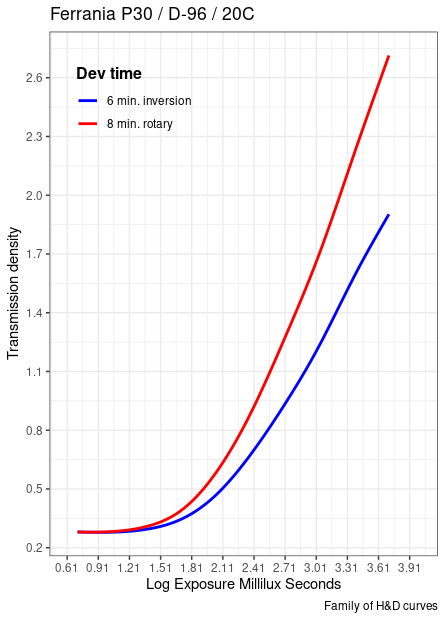

Here are the two curves on the same plot for comparison's sake:
It seems to me that Ferrania wants to promote a "punchy" kind of look, much like the recently launched CatLABS X FILM 320 Pro, doesn't it? It's an interesting look, no doubt, but, to me, it's only for a special occasion. I can also understand people being frustrated with the film and giving up on it. After all, the ILFORD PAN F Plus turned out to be exactly what Ilford promised in its documentation, whereas the P30 needs more careful treatment to get good performance out of it.

But on the Ferraina website they have a page that says: "Please understand that this is not a classic data sheet or “dev chart” but a collection of best practices collected from user feedback - and so it is subject to users' personal and evaluative tastes." But an ISO speed is based on an objective engineering standard and is not a matter of personal taste. Have they published a curve for P30 or stated how they established its speed as 80?
