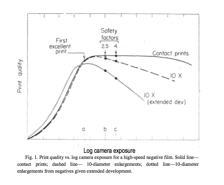

Effective Film Speed.
Yes, but what is it. Where is it defined? Who came up with it, what does it mean with respect to exposure index and ISO? How does it relate to image quality on this graph?I can't say I ever ran across this term.
Craig
Apr 8, 2004
2,387
Calgary
It comes from Phil Davis's "Beyond the Zone System" and he goes through the math of how it is derived. It's based on the ISO speed determination, and when you have a family of curves like the ones that Aparat has presented, each of those lines has a different speed. Several pages in the book are devoted to how to determine it.
The software that you can feed in all the densitromtry data will plot the curves and generate the EFS.
ic-racer
Feb 25, 2007
16,643
USA
Ok, thank you, it is a Zone System thing.
Ceratinly not an ISO speed.

I wouldn't have called it a zone system thing per se. This isn't an area I have great knowledge in, so I am probably misinterpreting the book; but roughly ISO speed is where the curve crosses the 0.1over B+F line. As that crossing point is different for each of the different developing time lines, the speed point is also different; thus the speed assigned to each developing time is also different.
That's shrinking 6 pages of explanation into 2 lines, so obviously I'm leaving a lot out. You should probably read the book for his explanation, I'm sure you'll understand it better than me.

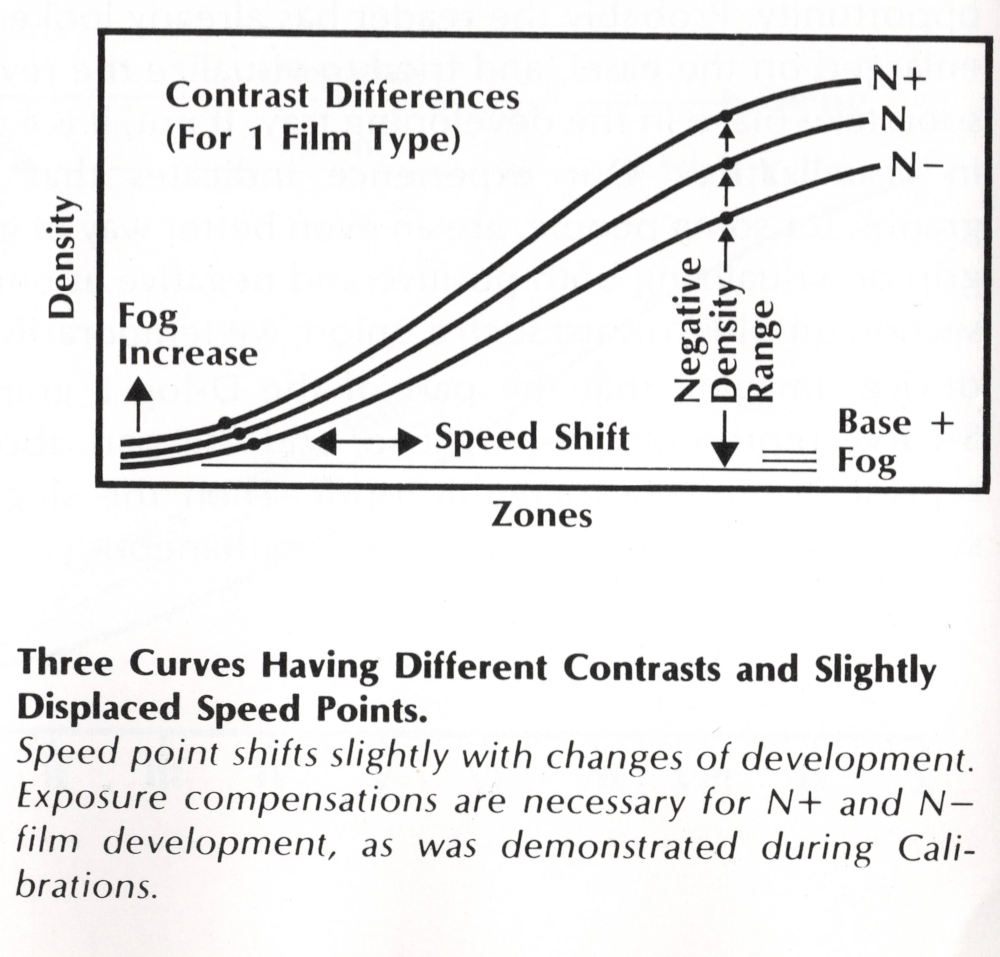

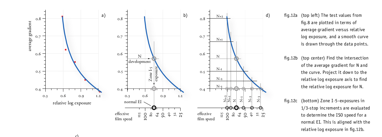

The idea behind Effective Film Speed (EFS) is that every film curve will have its own "speed point," which will vary along with contrast as a function of development. In the literature, it has been described as Effective Speed (e.g., Henry, 1988), Effective Film Speed (e.g., Lambrecht and Woodhouse, 2011), or simply "speed point" (White, Zakia, and Lorenz, 1976). Only one curve in a family will have a speed point that meets the current ISO definition, and that is what most people refer to as "box speed." All the other curves in the family, have their own EFS. In the Zone System literature, EFS is linked very closely to the notion of "N-development." I do not know who was the first person to coin the term Effective Film Speed. In my program, I have three options for calculating EFS, but the results are usually virtually identical, so I just use the default method.
Here are a couple of images that illustrate the idea of EFS.
This one is from Lambrecht and Woodhouse (2011, p. 119):
And this one is from White, Zakia, and Lorenz (1976, p. 106):
