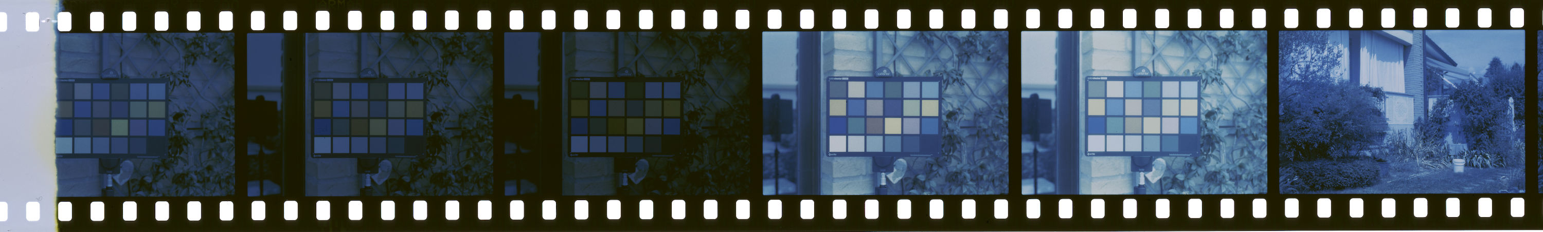

When used as color negative film Phoenix has strong color crossover with cyan highlights, so it would be strange if same behaviour had not been shown using Phoenix 200 as slide. Looking at gray squares of colorchecker (scans in my first post) you can see a crossover with light pink highlights and cyan shadows. In post #13 I read the base+fog and the maximum black with a color densitometer comparing with maximum black of some slide film of 20 years ago and the D-max imho is comparable but also the densitometer show a cyan cast on the blacks.
Phoenix is indeed a young color film and may be that is for its "youth" that inversion is so successfull with this film, but the imperfect color balance is inherent in this film: intepreting Harman's words, at this stage of development the Phoenix 200 is a "beta version" film.

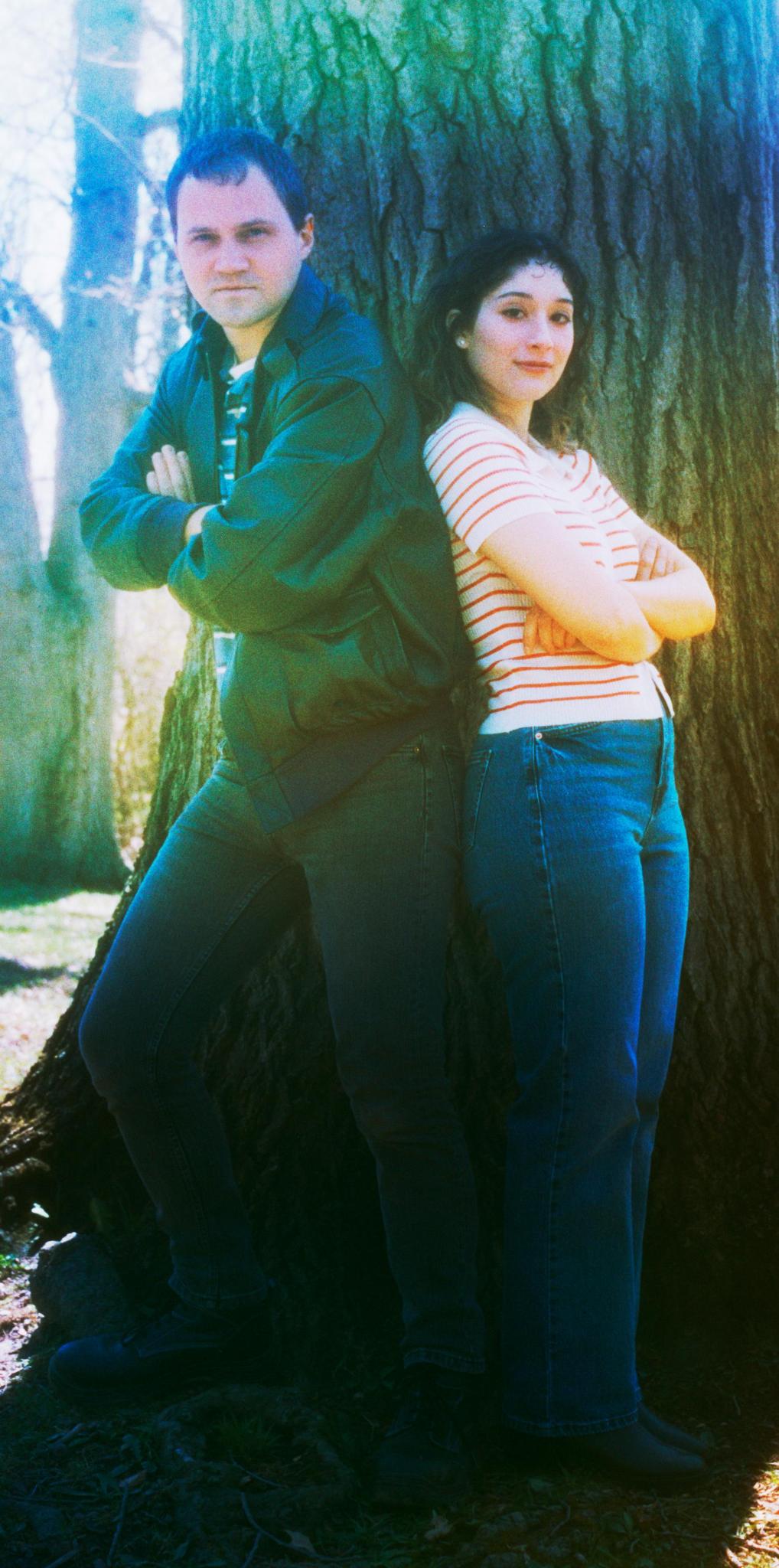

Well, here are my results with the Autocord and the cloudy filter. While it did help me get more shadow detail, it also made colorful veiling flares and bloom all over the place that can't really be corrected, so not much of a solution. This was at f/8 and 1/4 second if I recall correctly, metered at 16 for the shadows, possibly underdeveloped although couldn't have been by much.
I ended up preferring the black and white conversion. I think that will be it for my Phoenix reversal experiments, I just can't nail it down enough to get consistency in the results. 50x25mm crop. Maybe good for XPro lovers?

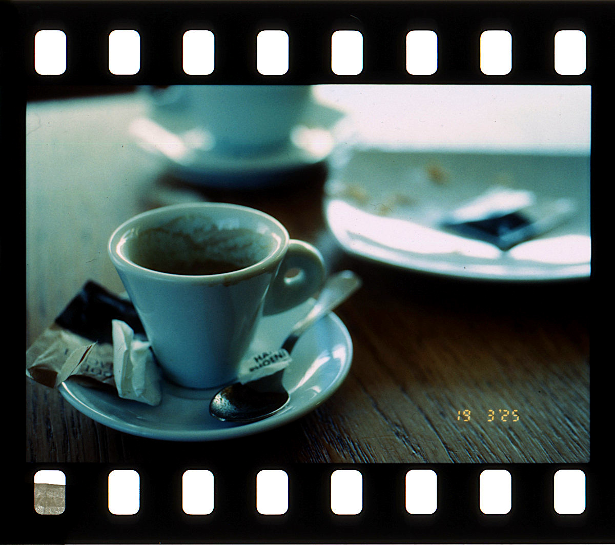

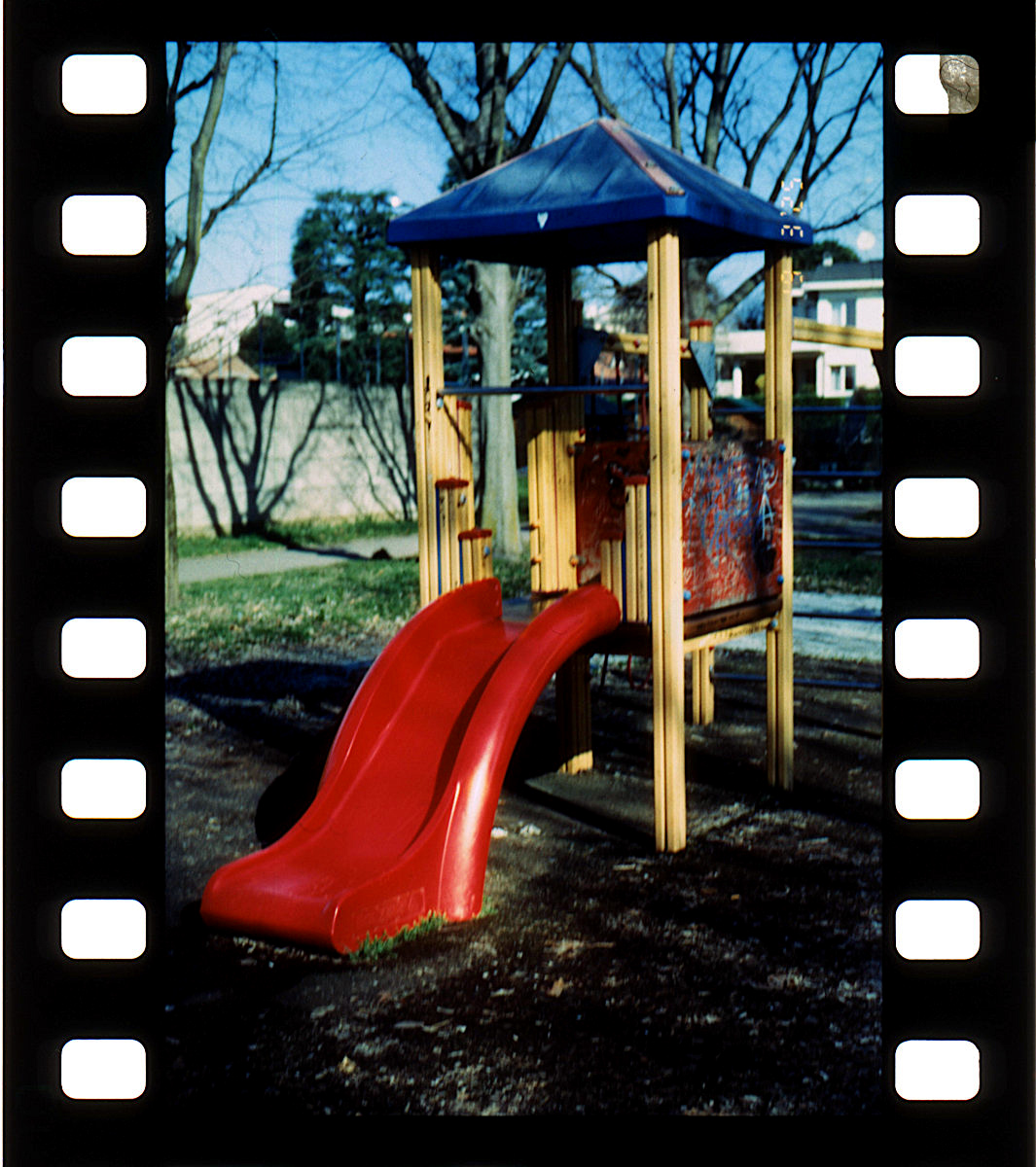

I tried Phoenix 200 reversal process with ISO 12. First development HC110 1:19 @38°C and 6m30s, followed by reversal exposure. With general C41 color development, bleaching, and fixing.
It performs well in good lighting conditions, but the exposure latitude is a little low, resulting in highlights appearing warm and shadows appearing cold. The sunset, flowers, and night scenes(ISO?) might be a good idea, but portraits are not so great.

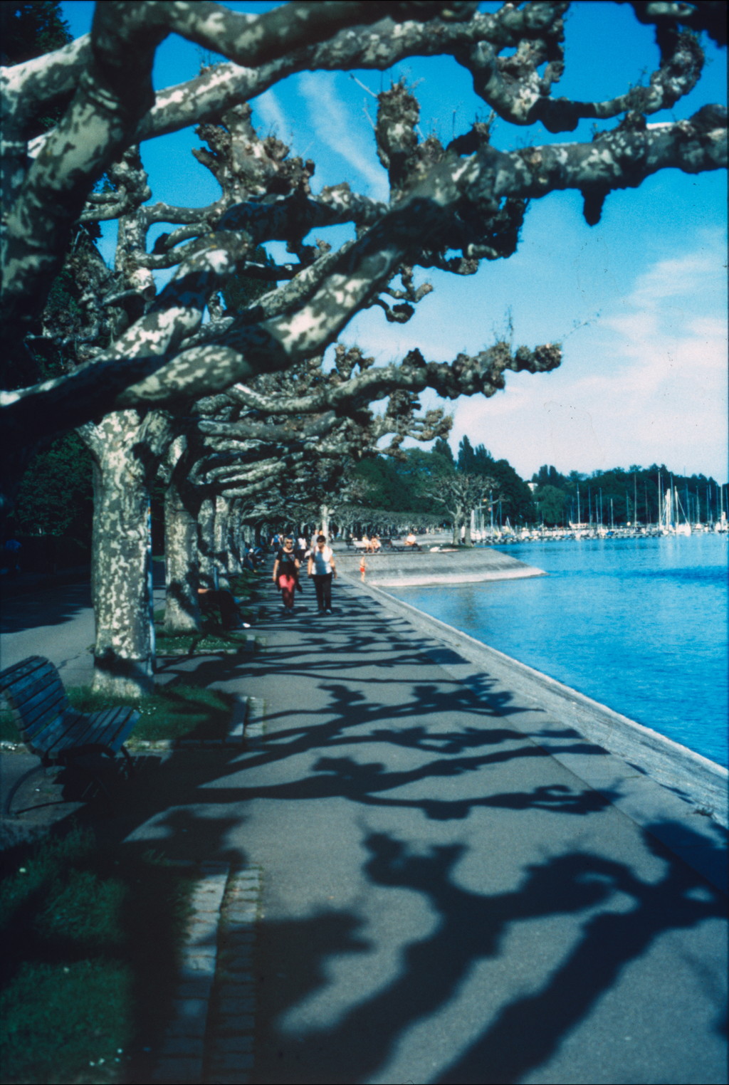

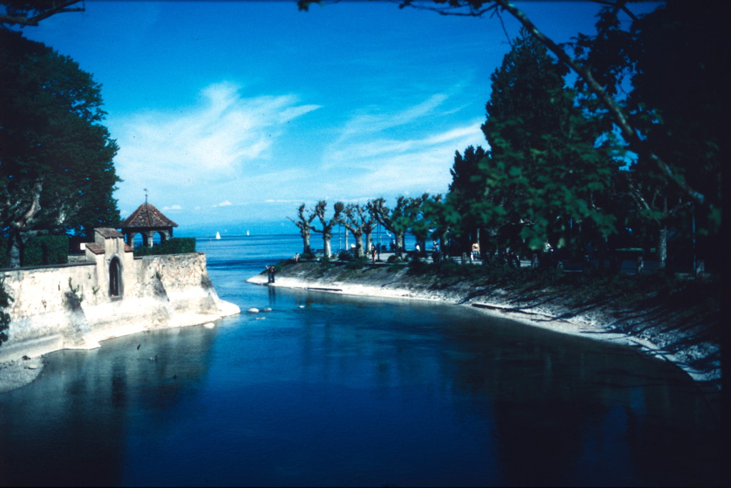

new roll, shot at 100ASA, HC 1:19 for 13´
@Meinrad Very nice! Your method works well on images with a lot of sky and water.
