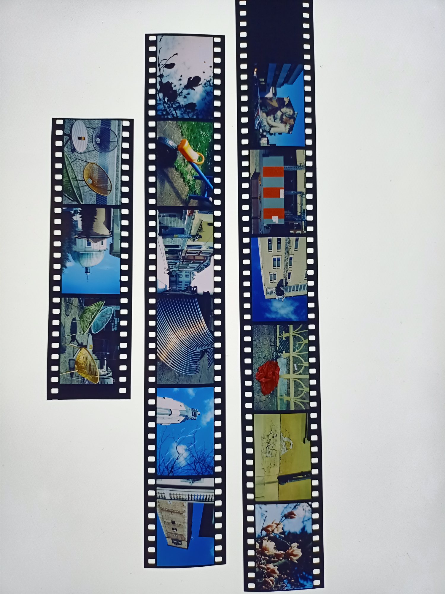

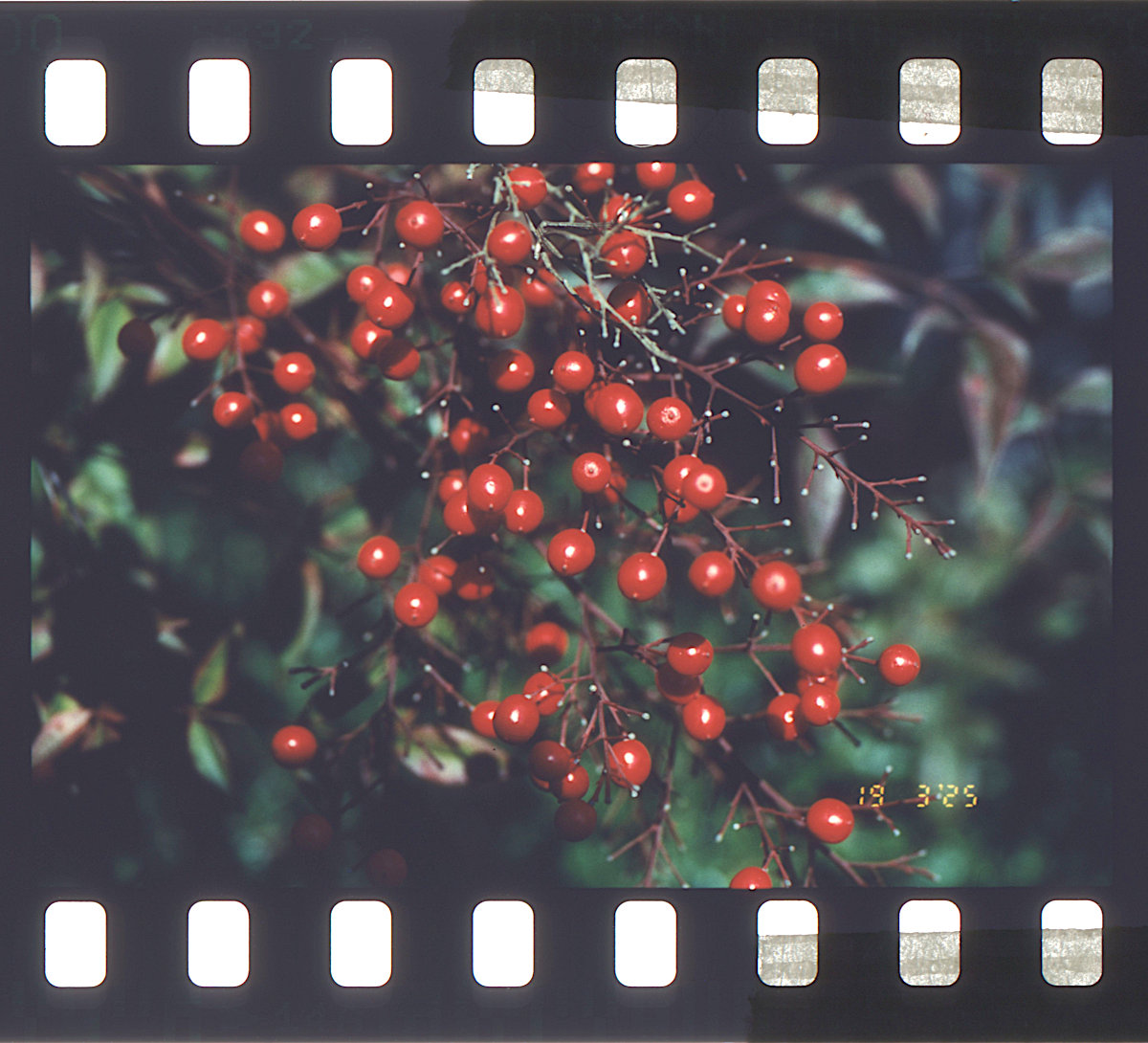

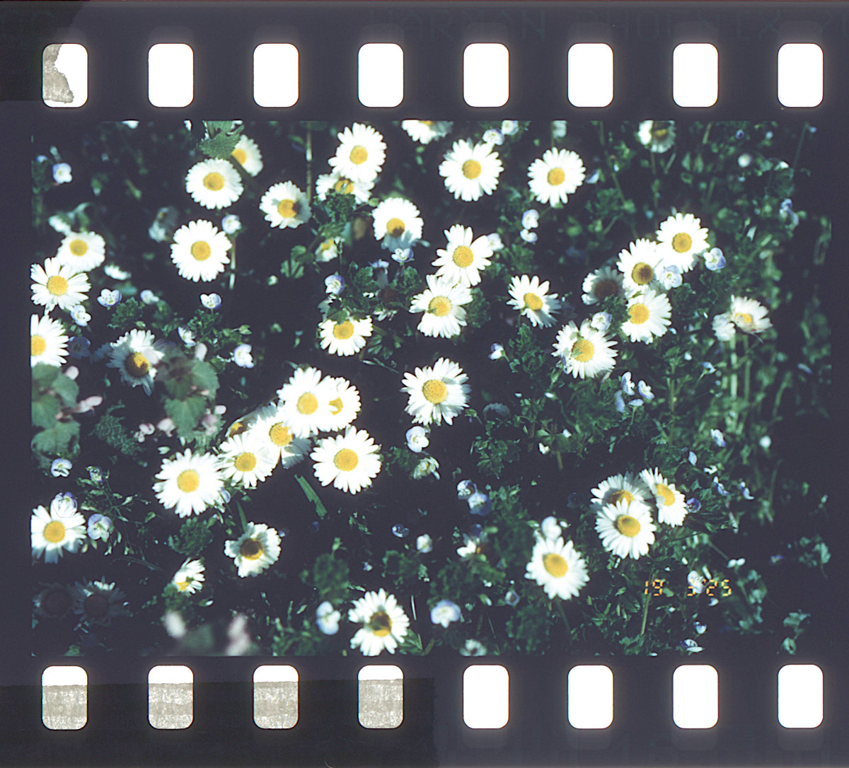

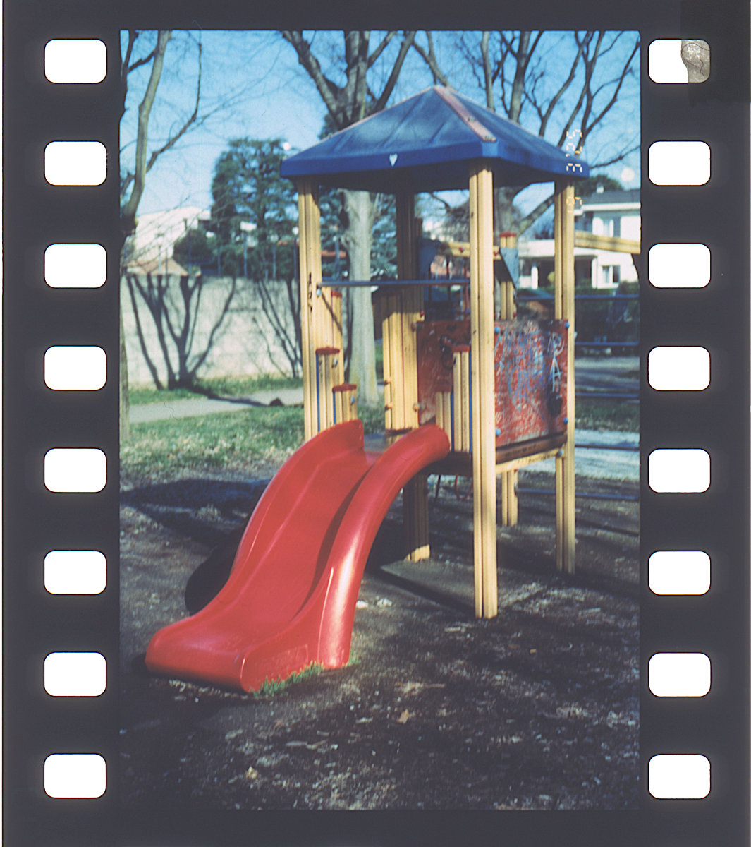

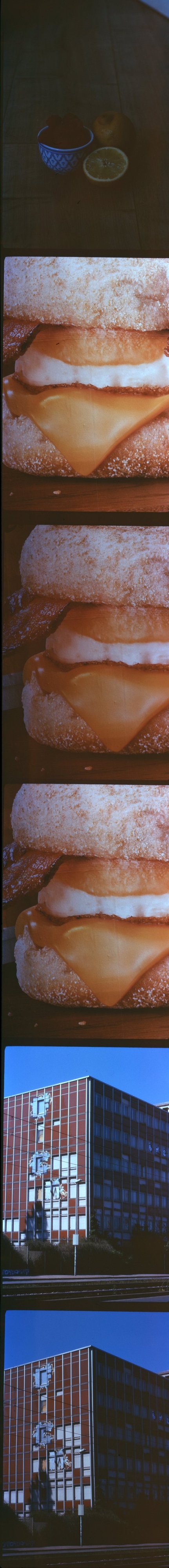

I would share some test for get slides from Phoenix 200.
The speed is quite low, at 16 ISO there is the best balance between highlight and shadows. Color balance is quite good and color fidelity is like the Phoenix in C-41, brilliant reds and blues but yellow, orange and caucasian skin tones are lacking hue and saturation. Looking at the grayscale of the color-checker there is just a bit of cross-color with warm highlight and cold/greenish shadows.
This was the Process I used:
First developer Kodak HC-110 (old formula "Original Syrup") 1+19 for 6'30" @ 38°C
4 water rinses of 30" each
Inversion exposing the reel at a 400w halogen lamps for a total of 4', flipping upside down the reel after 2'
Color developer of Bellini C-41 kit for 3' @ 38°C
ECN-2 ferrycianide bleach (SR-29) for 5' @ 38°C
Rollei RXN neutral fixer 1+4 for 5' @ 38°C
wash
C-41 stabilizer

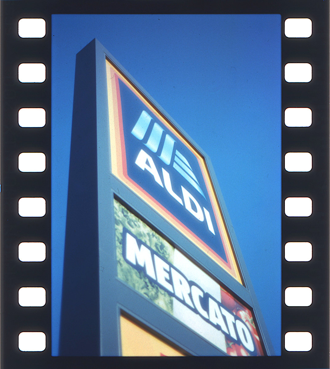

These are scans of the transparencies:
View attachment 394367View attachment 394368View attachment 394369View attachment 394370View attachment 394371View attachment 394372View attachment 394373View attachment 394374View attachment 394375

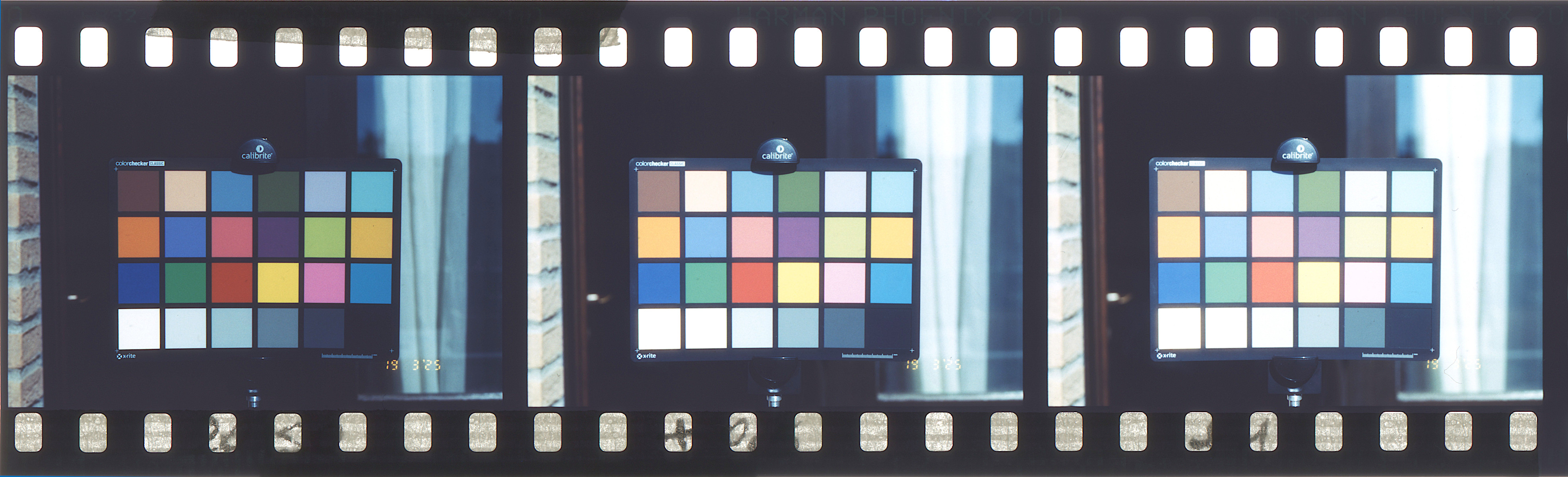

ISO 16 ? Did you mean 160? The three passport colour checkers photos, what where the settings ISO and EV?
I mean 16 ISO.
For the three colorchecker photos the exposure was taken with sekonic 858d light Meter in incident mode and ISO 20.
Camera was a Nikon f90 (no X) with Nikon SE 50mm f/1.8 in manuale mode. The frame on the left was exposed following the meter reading, the frame on the center at +0,5 stop and the frame on the right at +1 stop.
Looking at bottom row of colorchecker of the 20 ISO frame you can see that light values are well separate but shadow are too dark. The opposite in the centrale frame (the frame on the right is clearly overexposed), meaning that the right film speed is between 20 ISO and 20 minus half stop ISO, so 16 is a good choice.

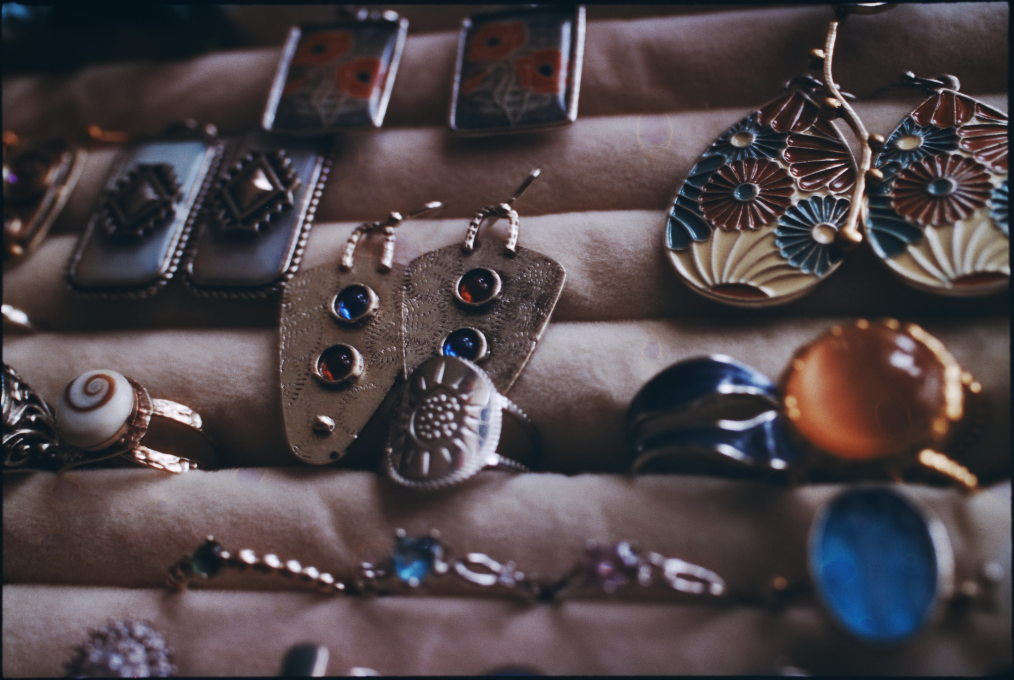

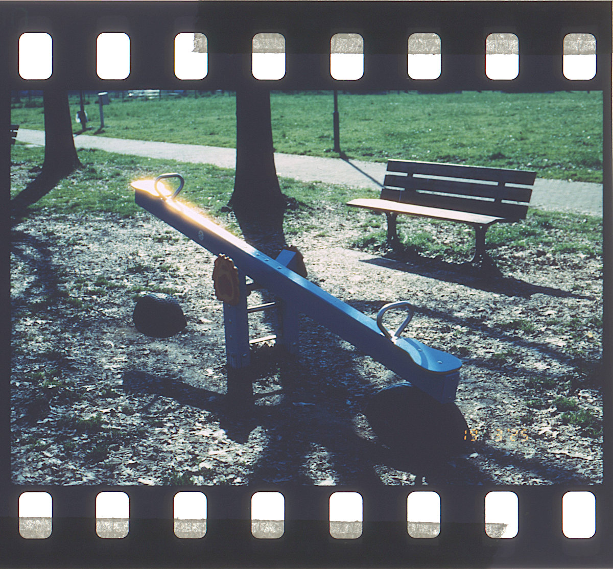

These were exposed with Leica R9 in Program and Matrix with film Speed at 16.

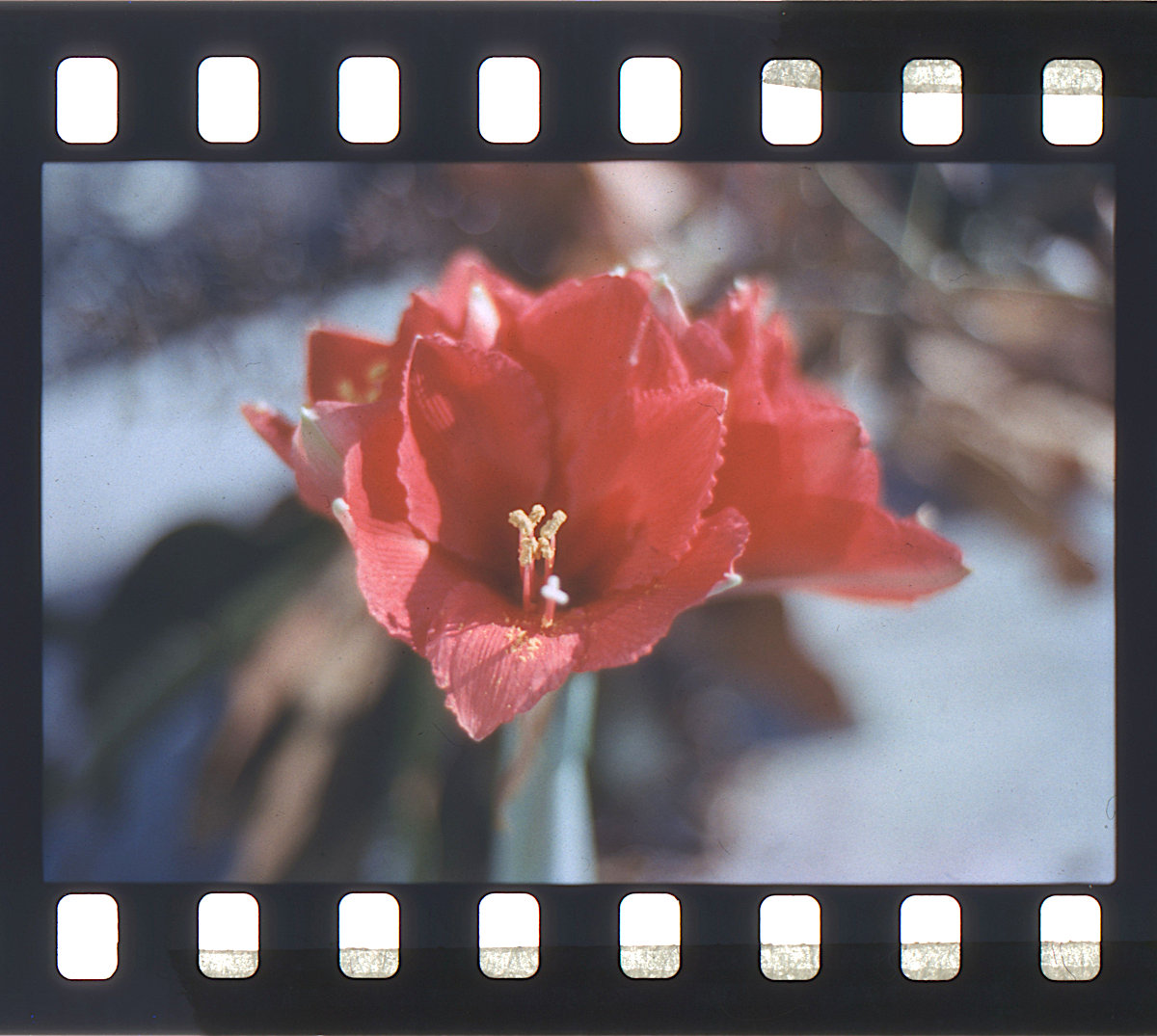

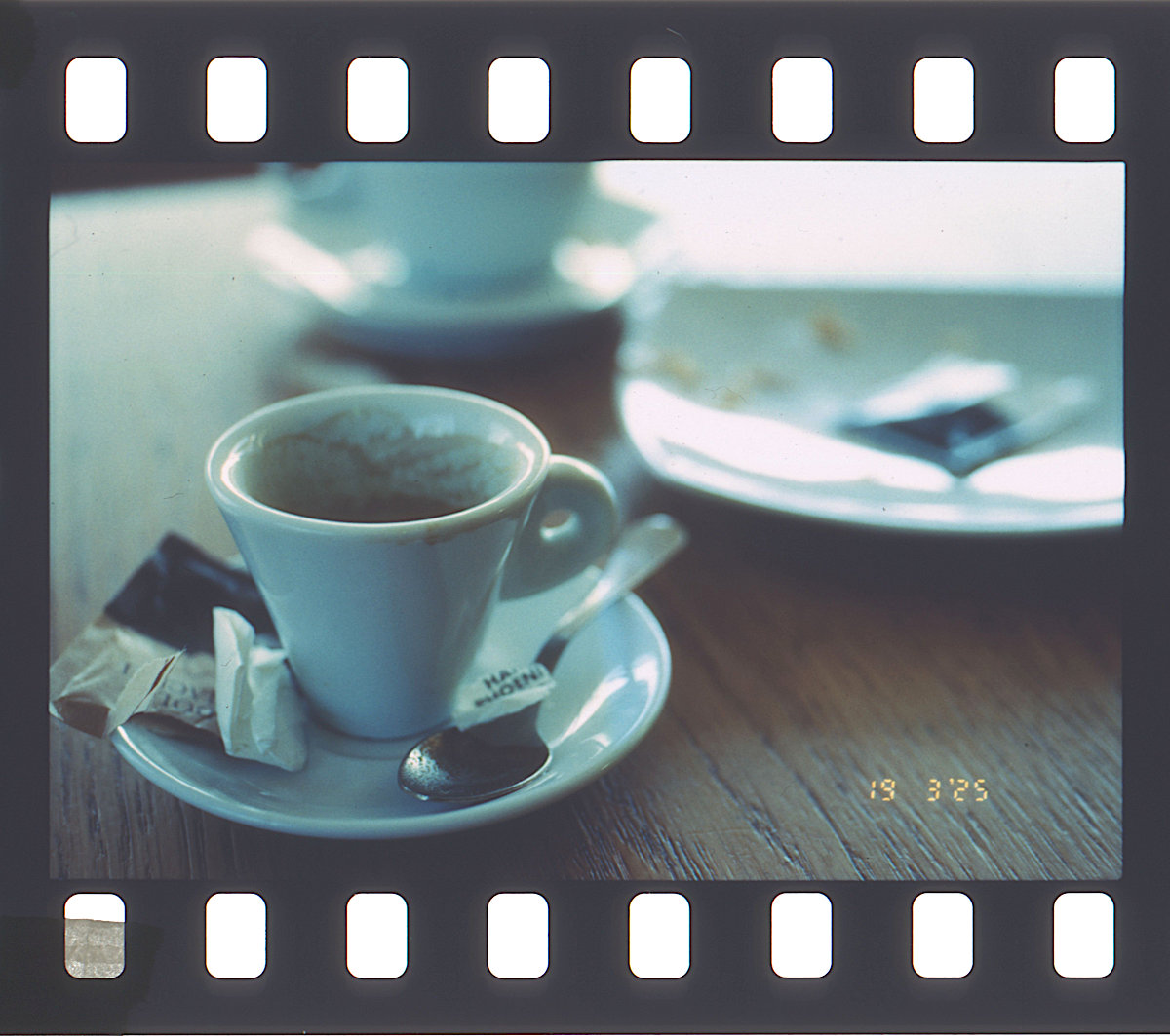

One more Phoenix reversal, I think in soft light the way it picks up colors is beautiful.
very nice, i like the blue tones of Phoenix, the greens are a little bit weak i also noticed with my tries…

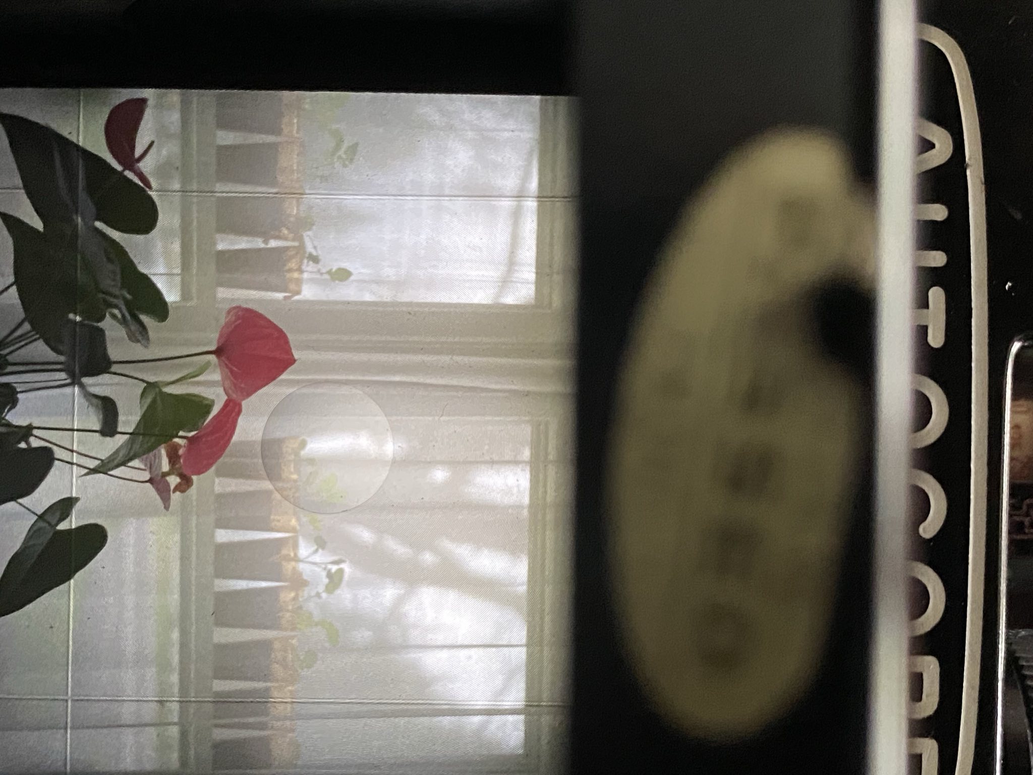

I am going to try the Phoenix C-41 reversal again, this time with 6x6, using the Autocord.
It will be a couples shoot tomorrow with my wife using the self timer in a park under shade trees.

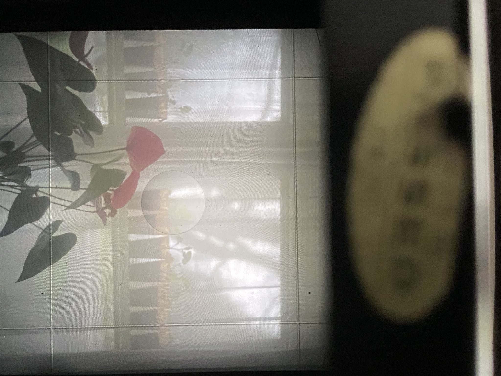

In order to tame the contrast, I'm going to try using this old, cloudy Vivitar cross screen filter. I hope it helps.
Before and after with the filter:

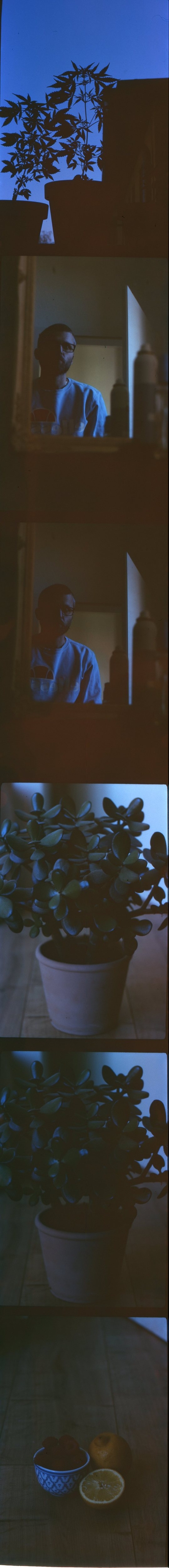

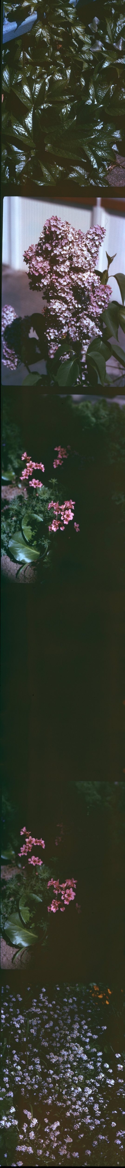

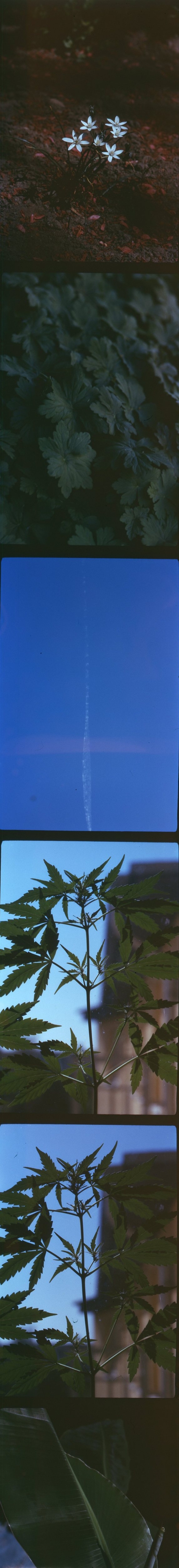

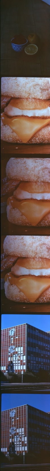

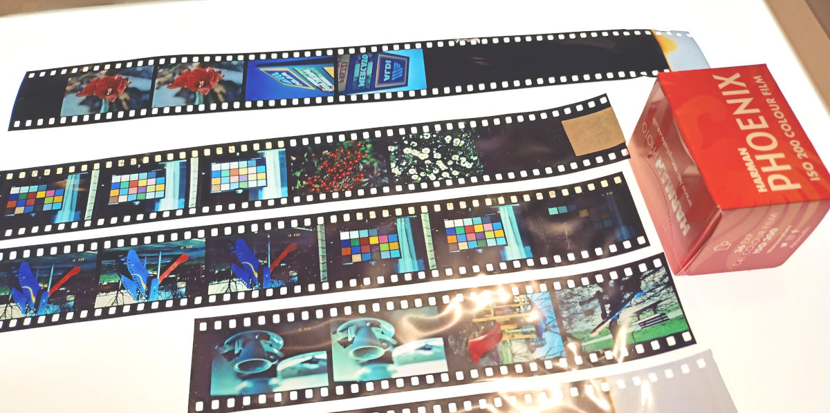

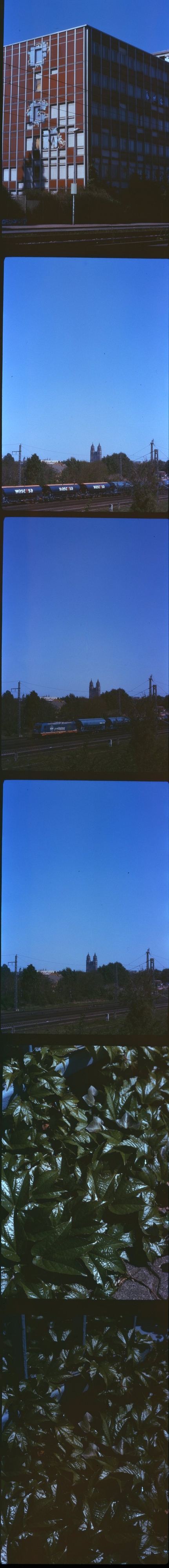

So, I shot a test roll with my Rolleicord III with Xenar and rolleikin 35mm adapter.
Metered with Sekonic l-308x. Mostly incident metering.
All scanned with Epson V550 and Epson scan program.
Quick disclaimer: I decided to rate film at 25, 20 and 16 ISO. Why? Because I was afraid that my shutter might be not accurate enough for 16 ISO and narrow dynamic range. And somethimes when I just took one photo I metered for 20 ISO… Turned out I was wrong about my shutter. Oh and there are some light leaks here and there, all my stupid fault.
Here are my processing steps (all with sous vide)
5min pre-wash @ 38C
6,5min BW developer – Adox 110 1+19 @ 38C
4 x water rinse 30s each @ 38C
4min exposure to light ( my wife’s white light led lamp) in transparent plastic beaker filled with water. Reel fliped after 2min.
*extra step – I realized that temperature has dropped a bit so after puting film back in dev. tank I filled it with water and put for 3min in sous vide to bring it back to 38C before the next step.
3.5 min Color developer – Adox c-tec c-41 - @ 38C (It was roll No. 7 in this chemicals thus longer time)
12 min Blix - Adox c-tec c-41 - @ 38C (It was roll No. 7 in this chemicals thus longer time – should be 6min but I understood that for reversal processing I should double the time)
6 min water rinse
1 min stabiliser
Conclusion:
1. Shadows go off super fast.
2. ISO 25 garbage. ISO 20 usable, 16 good, I want to try 12 next rime.
3. Indoor shots were quite interesting, I feel like reciprocity failure kicked in quite fast. Shots that were metered at 16 with ½ shutterspeed could use more light. Shots with 1 sec. Shutterspeed definately need more light. But it might be also my metering error.
4. I also had a redish tint. It’s super easy to correct while scanning. I dont think it would bother me during projection but I dont have slide projector so I can’t really test it.
5. I love those punchy colors, high contrast and crushed shadows. I actually prefer these colors over standard Phoenix color palette.
Question:
For all of you who have more experience that me (it was my first reversal processing!). My unexposed film base is not complately black. Its very dark but still a bit transparent. Does it mean I did something wrong? Should do a longer light exposure or something?
@spacetuna
Good job, I'll try to develop mine I took with the cloudy filter in the next couple days to share and see if it helps the shadows.
My film base isn't completely black either, but I just chalk it up to not being designed for this process.
The real speed when done this way is definitely in the range of 12-16. 12 will look a little better unless there are bright highlights to blow out.
