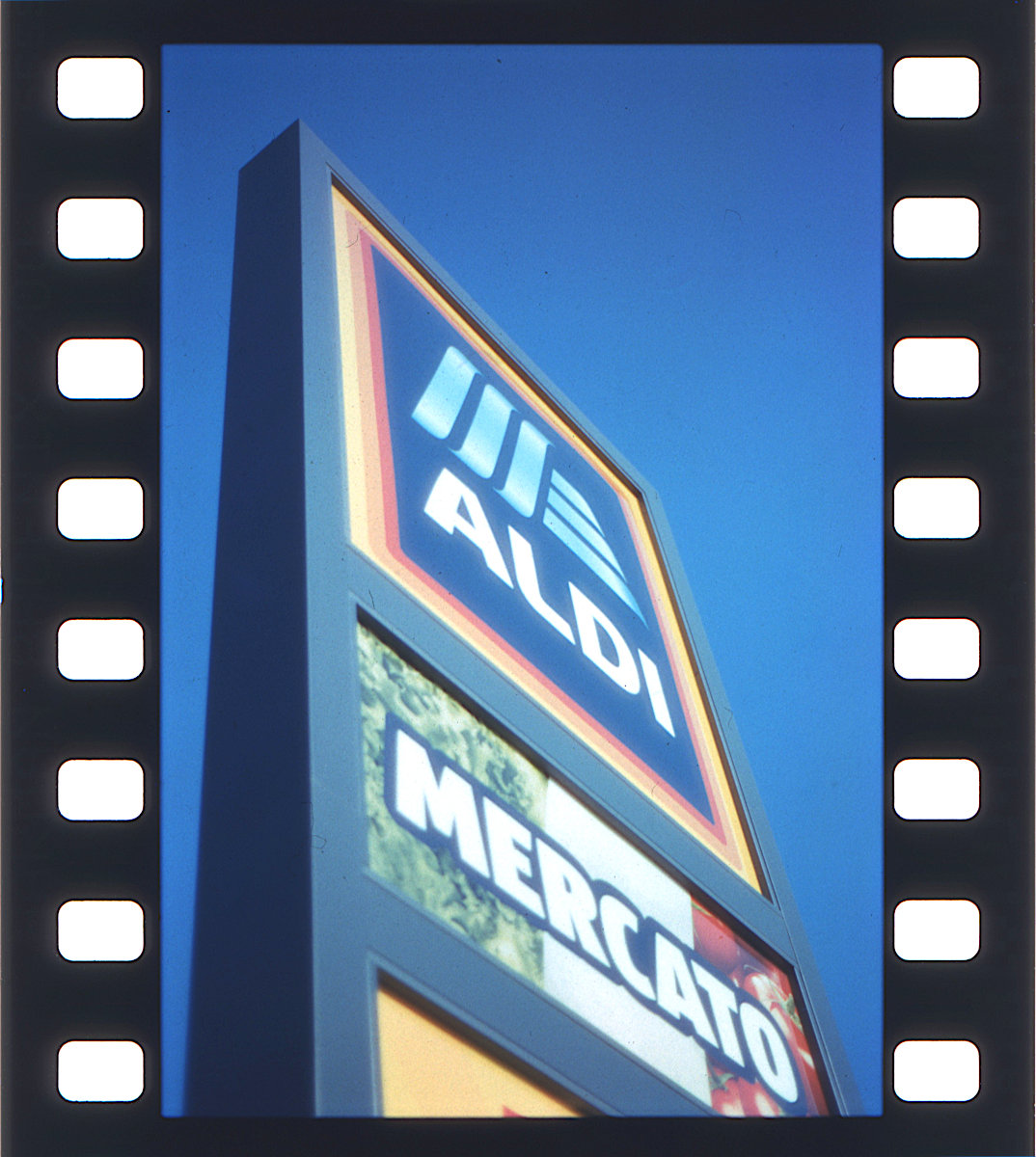

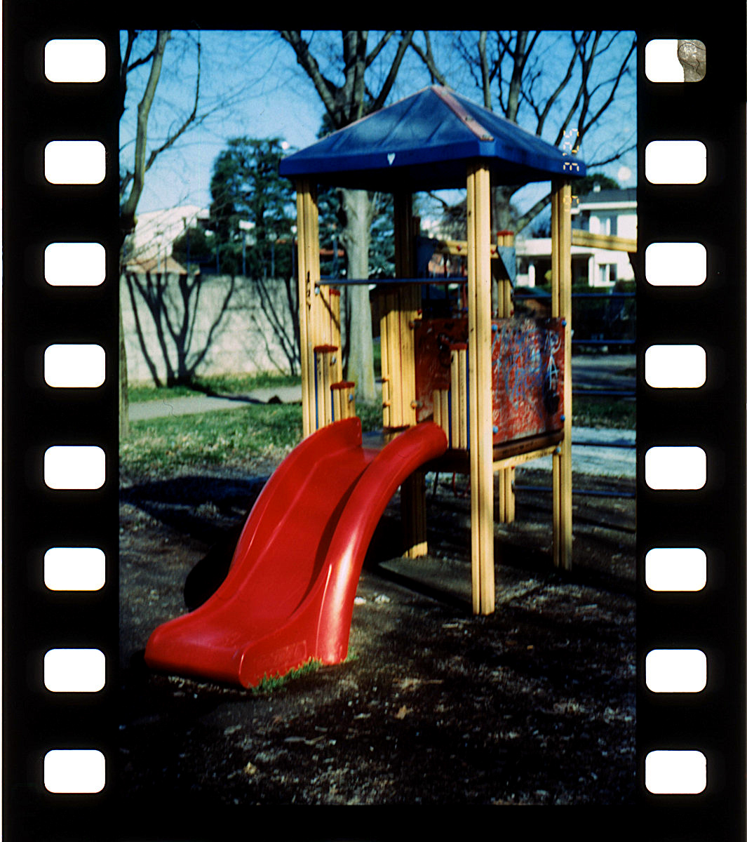

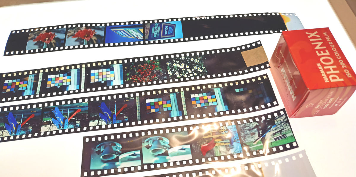

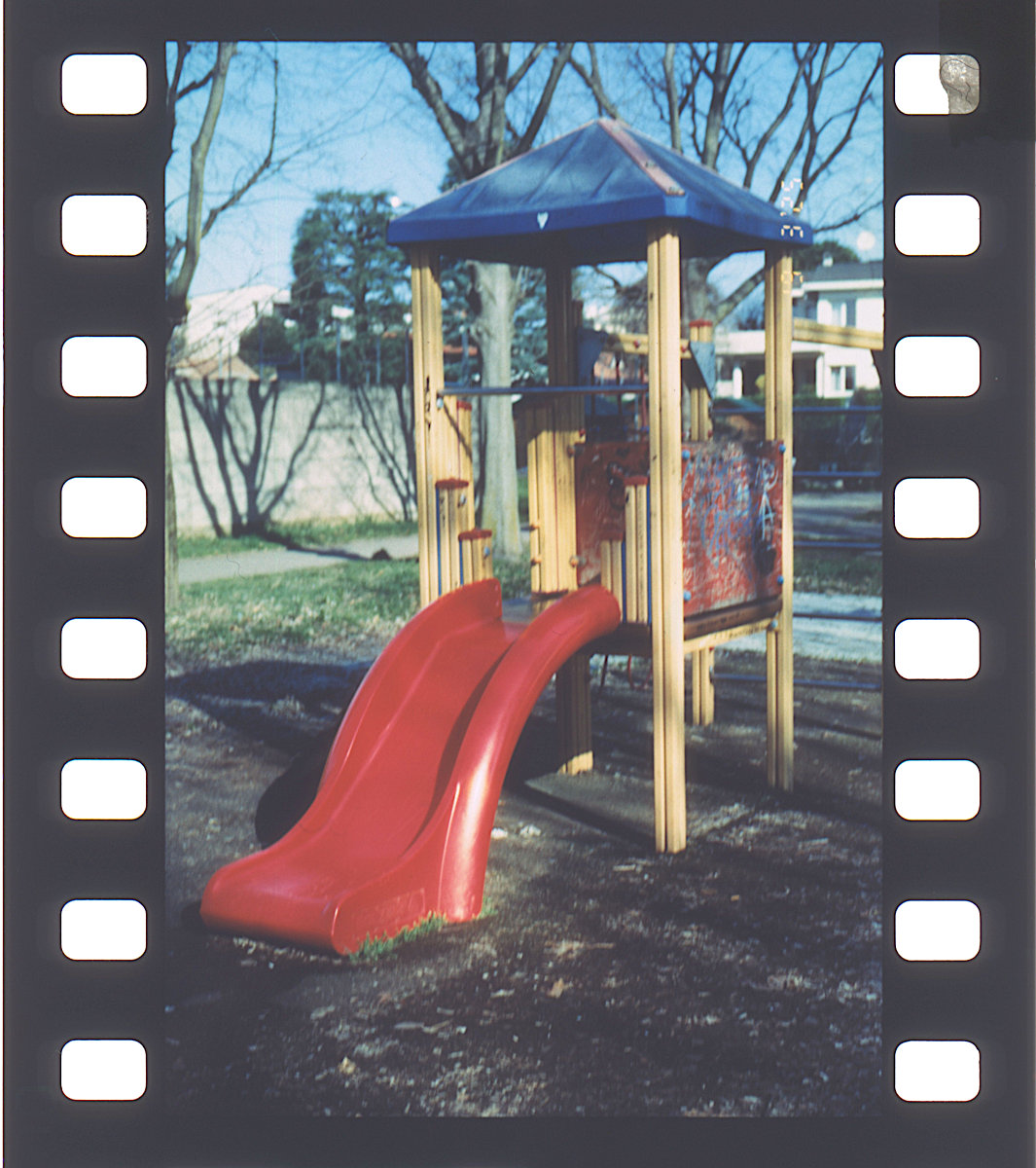

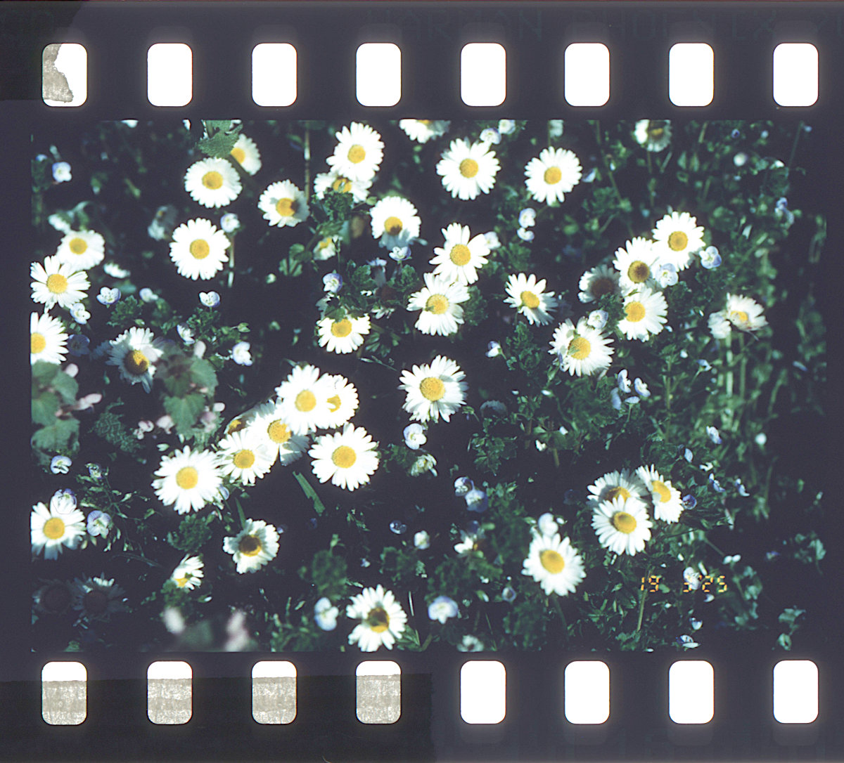

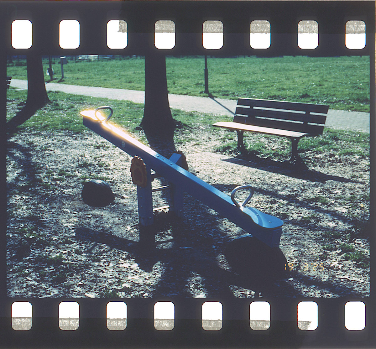

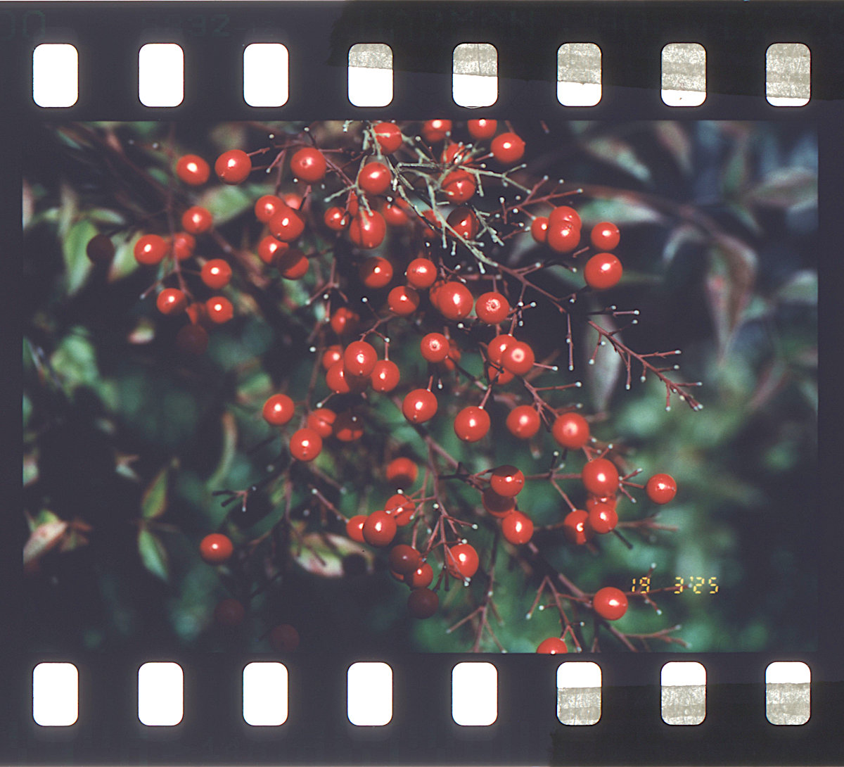

I would share some test for get slides from Phoenix 200.
The speed is quite low, at 16 ISO there is the best balance between highlight and shadows. Color balance is quite good and color fidelity is like the Phoenix in C-41, brilliant reds and blues but yellow, orange and caucasian skin tones are lacking hue and saturation. Looking at the grayscale of the color-checker there is just a bit of cross-color with warm highlight and cold/greenish shadows.
This was the Process I used:
First developer Kodak HC-110 (old formula "Original Syrup") 1+19 for 6'30" @ 38°C
4 water rinses of 30" each
Inversion exposing the reel at a 400w halogen lamps for a total of 4', flipping upside down the reel after 2'
Color developer of Bellini C-41 kit for 3' @ 38°C
ECN-2 ferrycianide bleach (SR-29) for 5' @ 38°C
Rollei RXN neutral fixer 1+4 for 5' @ 38°C
wash
C-41 stabilizer

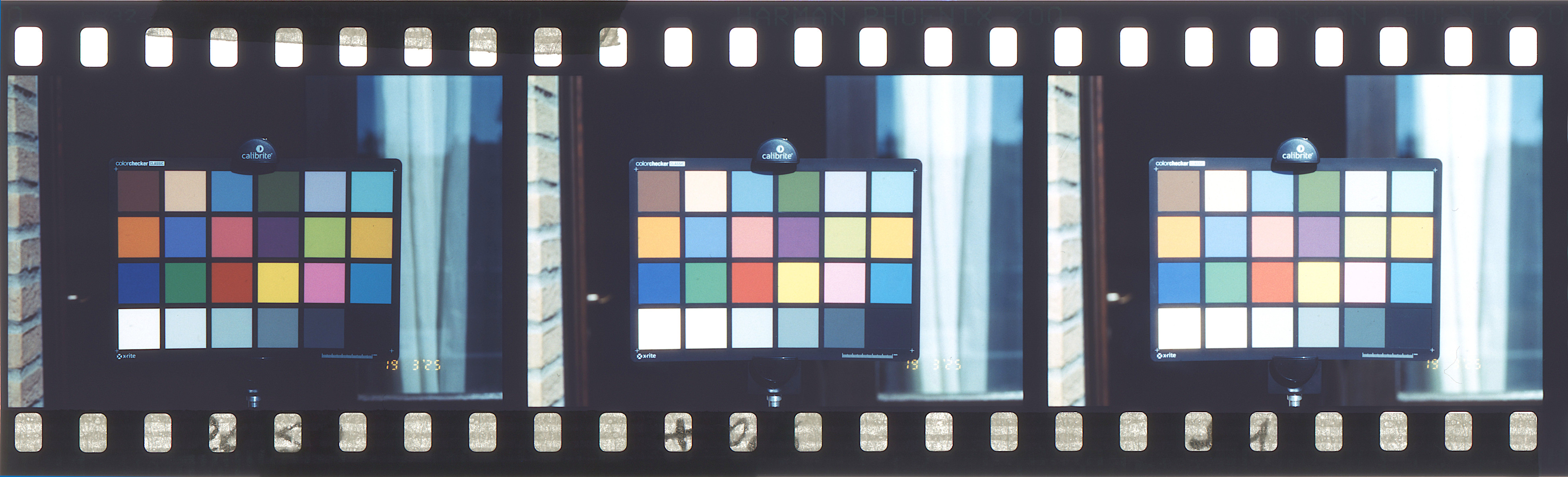

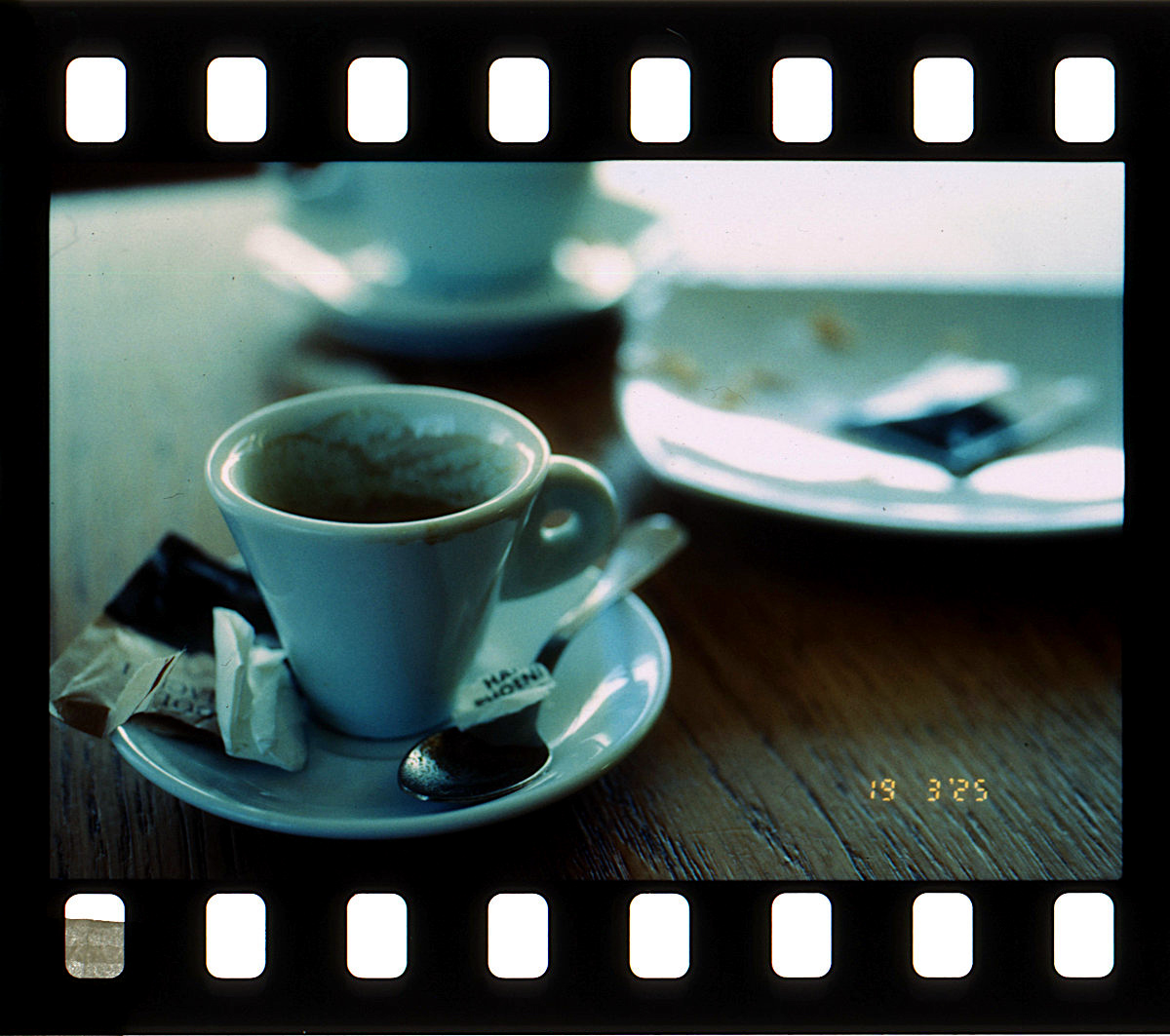

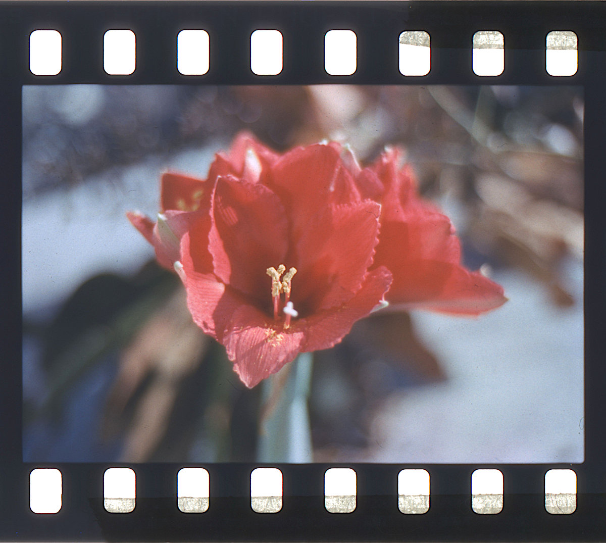

These are scans of the transparencies:

That's surprisingly good - excellent in fact! I had not expected them to come out this neutral looking.
Well, a lot less than I had expected and of course, there's the magenta dmin that you'll always run into, I imagine.
Much better than I expected as well!

Your results look quite good with good dmax in your photo showing all the film strips, but your scans seem off in contrast. I took a few and set the black point to the rebate in photoshop. Would you say this is similar to how they render in person?
Woah, those are excellent examples when compared to what others have achieved!
View attachment 394498View attachment 394499View attachment 394500
If it really looks like that, then there will have to be another "reading" of the Phoenix. And Harman should think carefully about whether to just release a slide :smile:
True. And people are much more forgiving of a thin-latitude film if it's for slide.
The photo showing all film strips was taken with all "improvements" of a cell phone camera. The scans came from an entry-level flat bed scanner (Epson V550) and I have just basic scanning skills.
For a more objective judgment the densitometer readings of D-min and D-max are the following:
D-min (status A)
R = 0.32
G = 0.34
B = 0.32
D-Max (status A)
R = 3.43
G = 2.90
B = 2.36
The D-min is quite high: to my eyes the base of Phoenix is the same triacetate of Harman/Ilford BW films and surely isn't crystal-clear how a transparency color film base should be.. but Phoenix 200 isn't slide film (BTW D-min of Ilford BW films are about at the same density of 0.28/0.32).
D-max is shifting to blue/cyan tones, confirmed by backlight vieving the leader of the film.

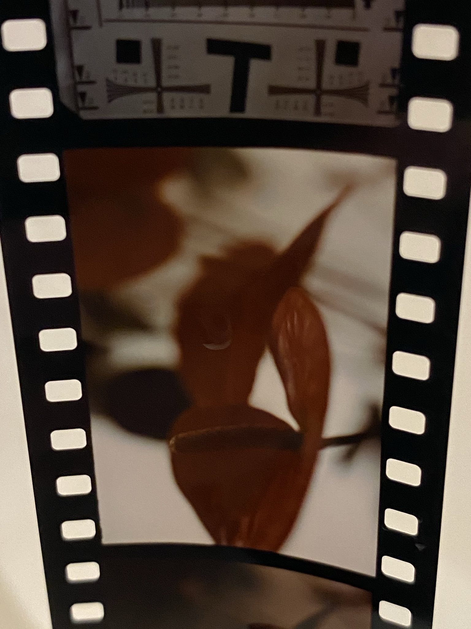

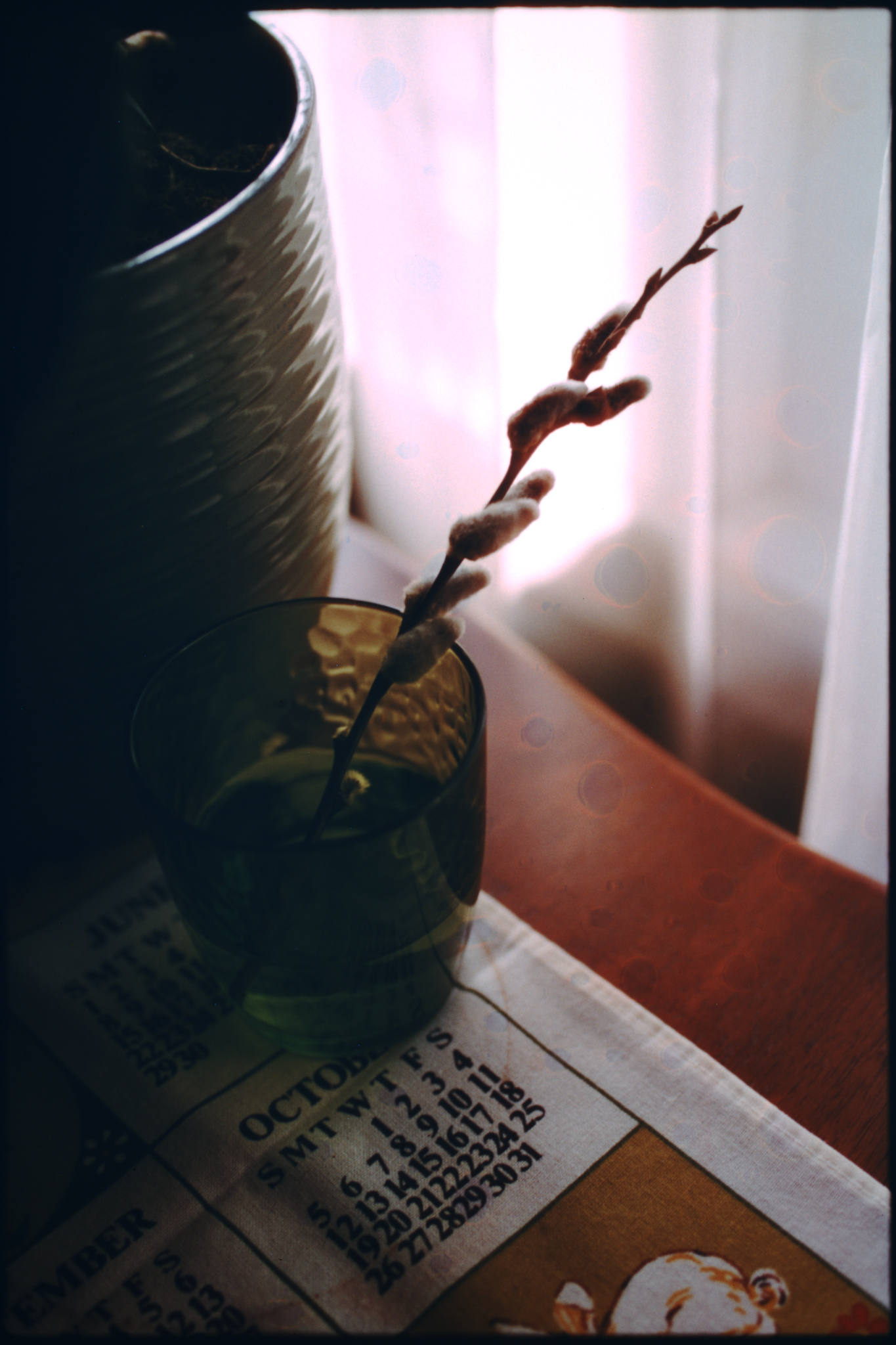

Bit of a sidetrack here: @chromemax what camera/date back were you using for your initial shots? I notice the date back is able to record current dates. That's a rarity these days.
I made the mistake of doing the light exposure without submerging the reel in water, leading to some uneven bubbles on the frames.
Still, a couple things to show. Here are the straight out of camera frames.
They've got a red shift. Corrected:
Unfortunately, the brightness range is pretty extreme. It's hard to retain both highlights and shadows. Maybe someone can figure out how to fix that. These shots were taken in soft window light.
At 1:1, critical detail is what we expect from Phoenix, not very good compared to most other films:
