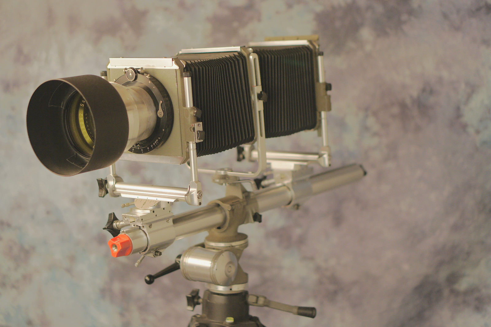

For telescopic location work (scaled down a bit!) the 500mm Schneider Tele-Xenar F5.5 in Compound Shutter. Been advised by my repairman not to use the cable release, it caused a jam he fixed it. Best to use it as is, I'll be trying. Same perspective very similar view to 1000mm F16 I'm keeping set up in the studio for long 8x10 work. It's heavy but hey it's sturdy to use.
This Sinar Norma is set up for 9x12cm and 4x5in long telephoto perspective. And it's portable, I believe I can fit all of this in my original Norma 4x5 Case for traveling. We will see.
SONY DSC by Nokton48, on Flickr
I've reworked mounting the lens, settled on a strip of Gorilla Tape for now. This whole unit will slide onto the very long rail of 18" pieces, creating a portable Optical Bench using all original Norma Parts. I've also switched out the supports, from FOBA C40's, to Big Manfrottos with hex connections. Manfrotto is more portable than FOBA for this use. In the studio FOBA is way more solid. In the field this could be transported to the location in one complete piece. And then no need for a gym workout!

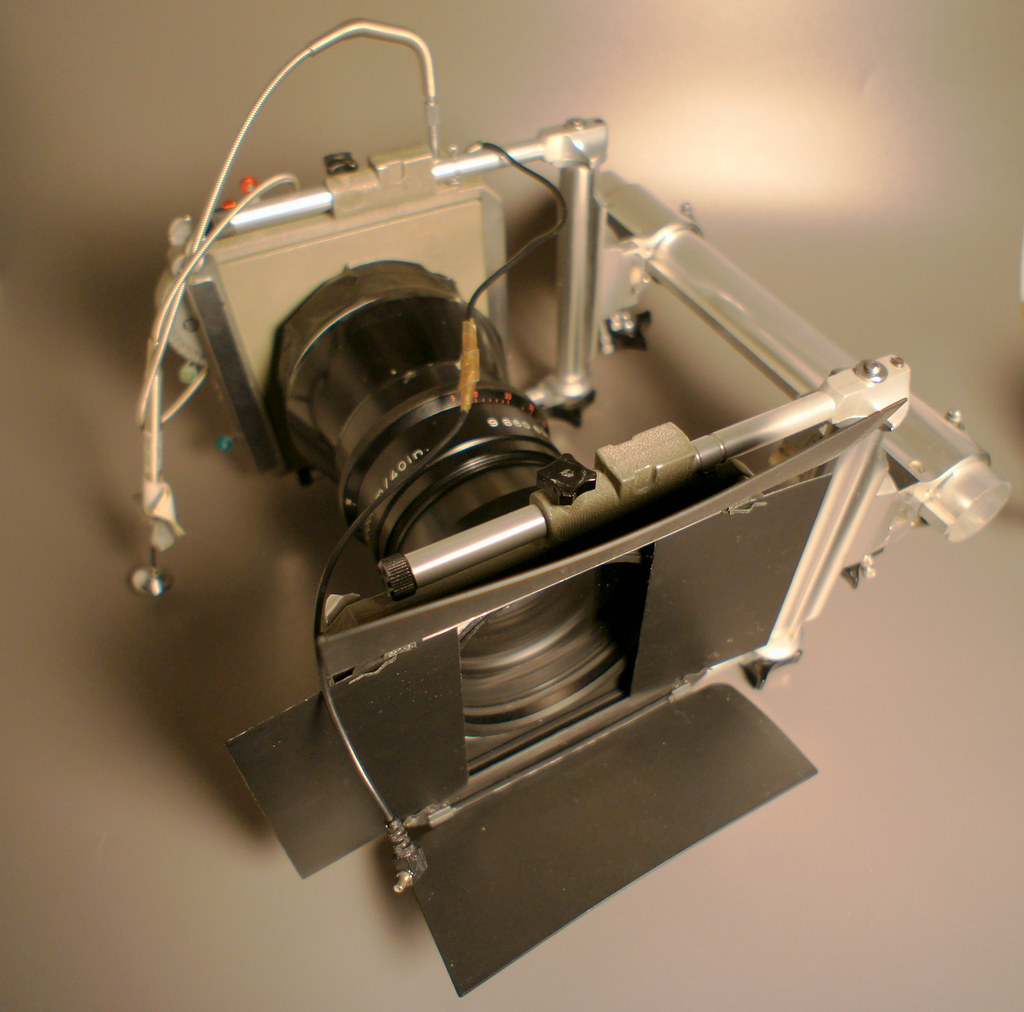

Here I'm testing my suspended Broncolor Hazylight Modeling Light On. Additional FOBA F1000 Head down low left to illuminate shadows. The 3D Printed Tophat appears robust to my eye, we will see. This I intend to test out in the field soon. I can carry it around assembled for now. I will put the 5x7 Bag Bellows and Monocular on the back, for outdoor viewing. I do have the Reducing Back for 4x12/9x12 as well if I need cropping.
Here the Broncolor Hazylight Head is doing what it does best. Providing beautiful simulated "window lighting". I'm using the Broncolor Hazylight 1600JHead which is an unusual design.

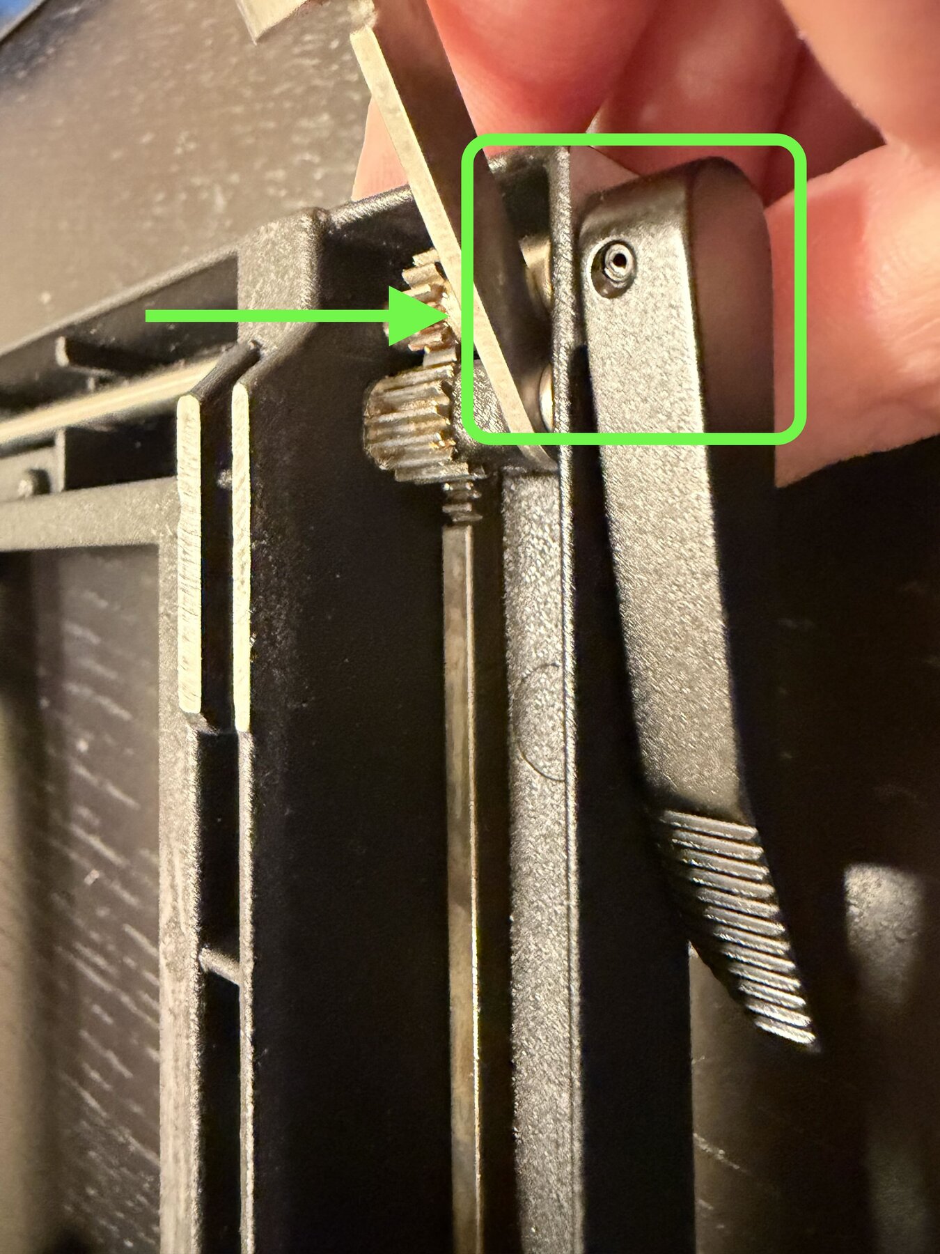

@Nokton48 could I ask you with what tools you punched out and in again the pins? I'm trying to do that with P2 parts but I'm afraid I will 1. bend the pins, no replacement available, I'm screwed 2. not being able to punch them in again. Sorry for necroposting :D

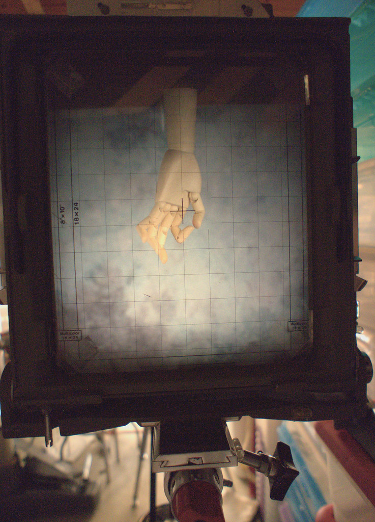

View through 8x10 Tele Sinar Norma 1000mm F16 Apo Ronar by Nokton48, on Flickr
View through the 8x10 Tele Norma 1000mm F16 Rodenstock Apo Ronar. I have a fresnel screen on the camera, the hotspot moves around, to view the glass in "quadrants". Quite sharp as I would expect from all my Apo Ronar, from the 150mm tiny gem, to this MONSTER. I'll leave this up til I'm satisfied, need to load 8x10 and 18x24cm holders next. This is great fun! :smile:

I was thinking about the pins that hold in place some of the piece of the P series like the back of the lever, let me attach a picture for clarity.

OK but my Norma knobs and levers are completely different from the P2 cameras. Why not post a thread and ask P2 users what they think?
You are right, I wasn’t aware they were so much different, that’s why :smile:
