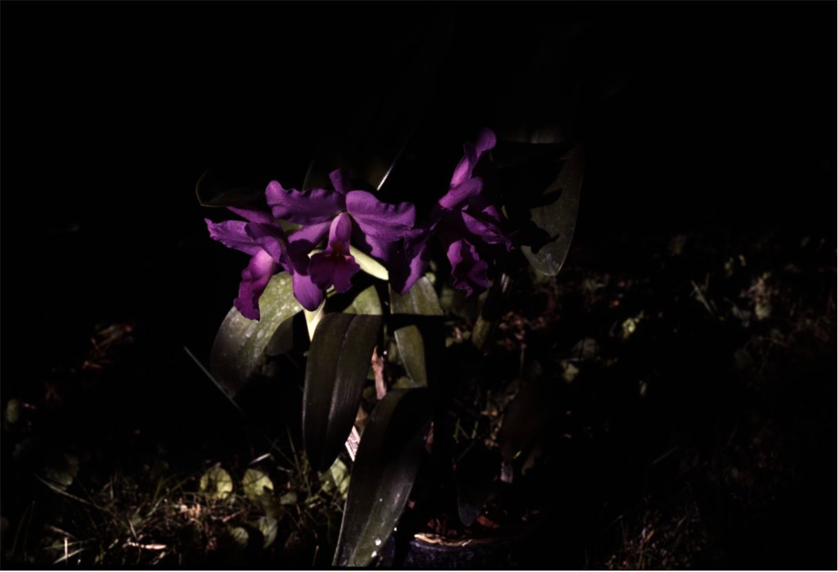

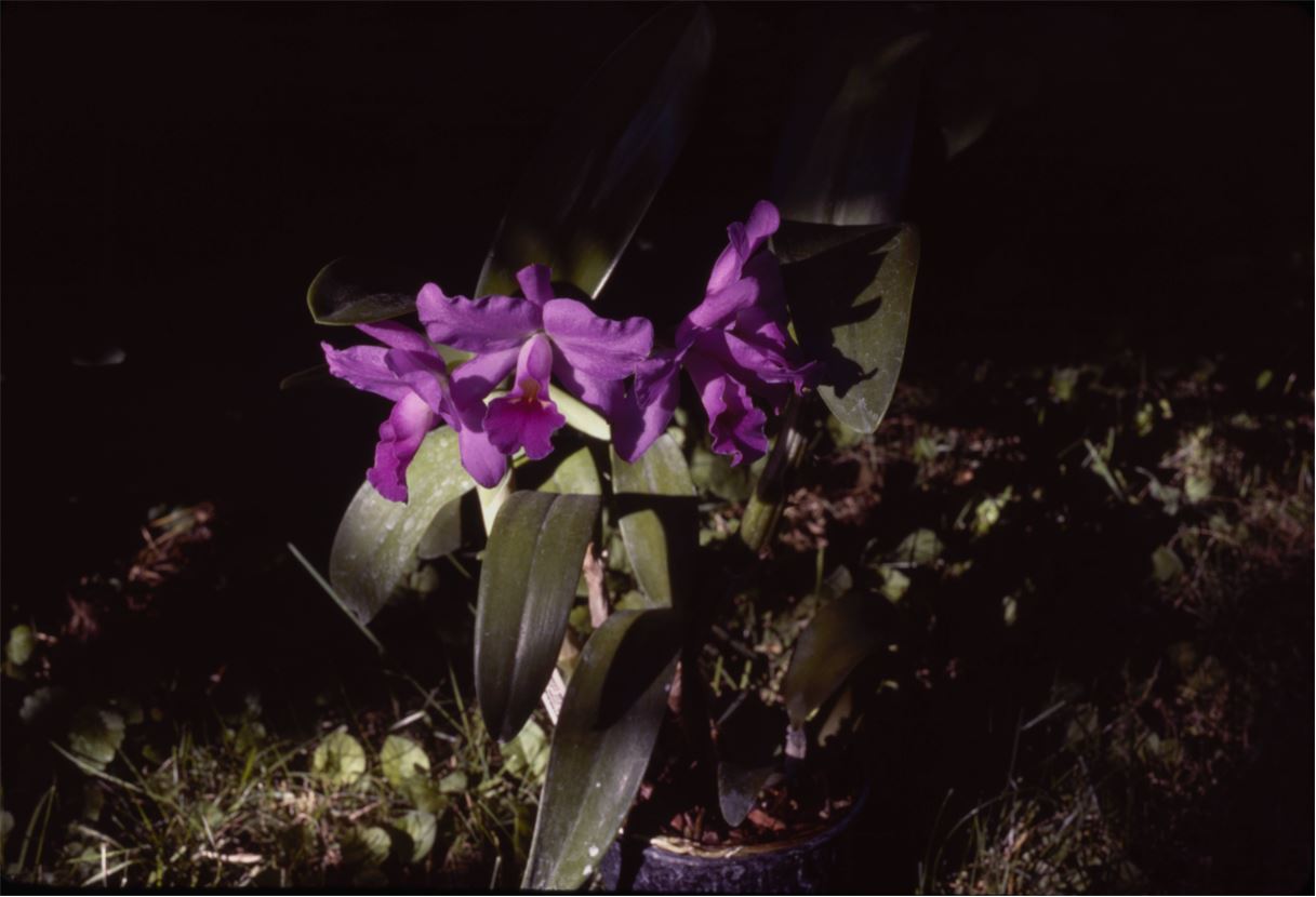

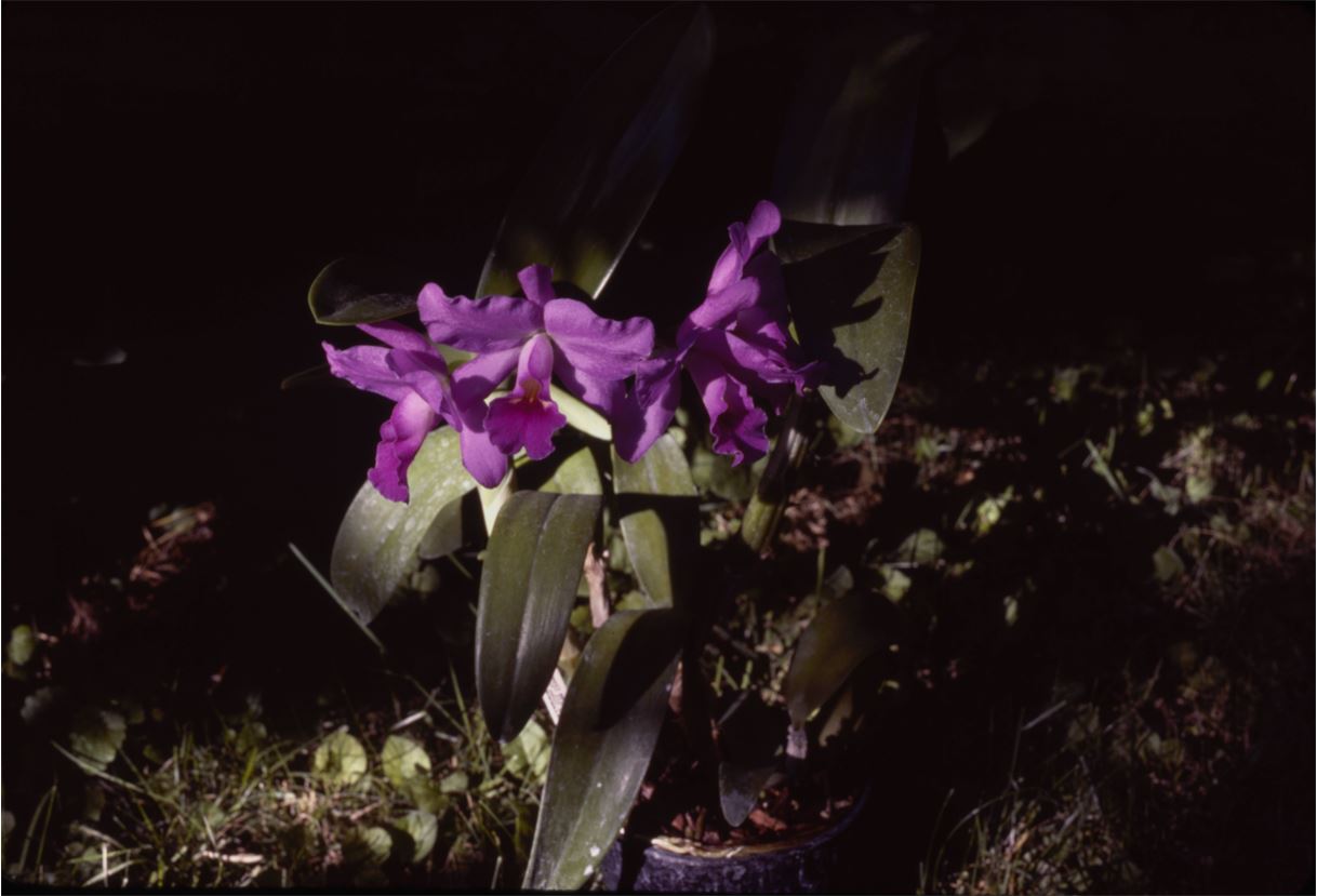

Here are four files scanned on the Epson V750. The first was saved as a 16 bit TIFF (16 in 16 out). The second was taken from the very same scan saved as a 16 bit RAW (16 in 16 out). The third (16 in 8 out) was stored as RAW from the very same scan . The forth was RAW taken from the second scan (8 in 8 out.). For the record, a TIFF file from the second scan looked like the 16 bit TIFF from the first scan and the 8 bit RAW from the second scan. I am not uploading that one because it provides no additional useful information. Note. The files uploaded are jpeg version from the original TIFF and RAW files.
The ONLY consistent explanation for the fact that the 16 bit RAW image looks different from all of the other images and that both of the 8 bit RAW images look very much like the 16 bit TIFF image is that all of the images except for the 16 bit raw were gamma encoded. That includes both 8 bit RAW files, regardless of whether they started out as 16 bit or 8 bit input. This is pretty definitive proof that 16 in 8 out RAW files are gamma encoded, no matter what Mr. Hamrick said in his communications with Adrian. Please note that Mr. Hamrick brushed Adrian off rather than giving a meaningful response to his request for final clarification.
8 bit RAW files are gamma encoded and can't be directly compared to 16 bit raw files.
I would be happy to post images of the histograms from the original TIFF and RAW files if requested, but visual inspection should be sufficient to demonstrate the point.

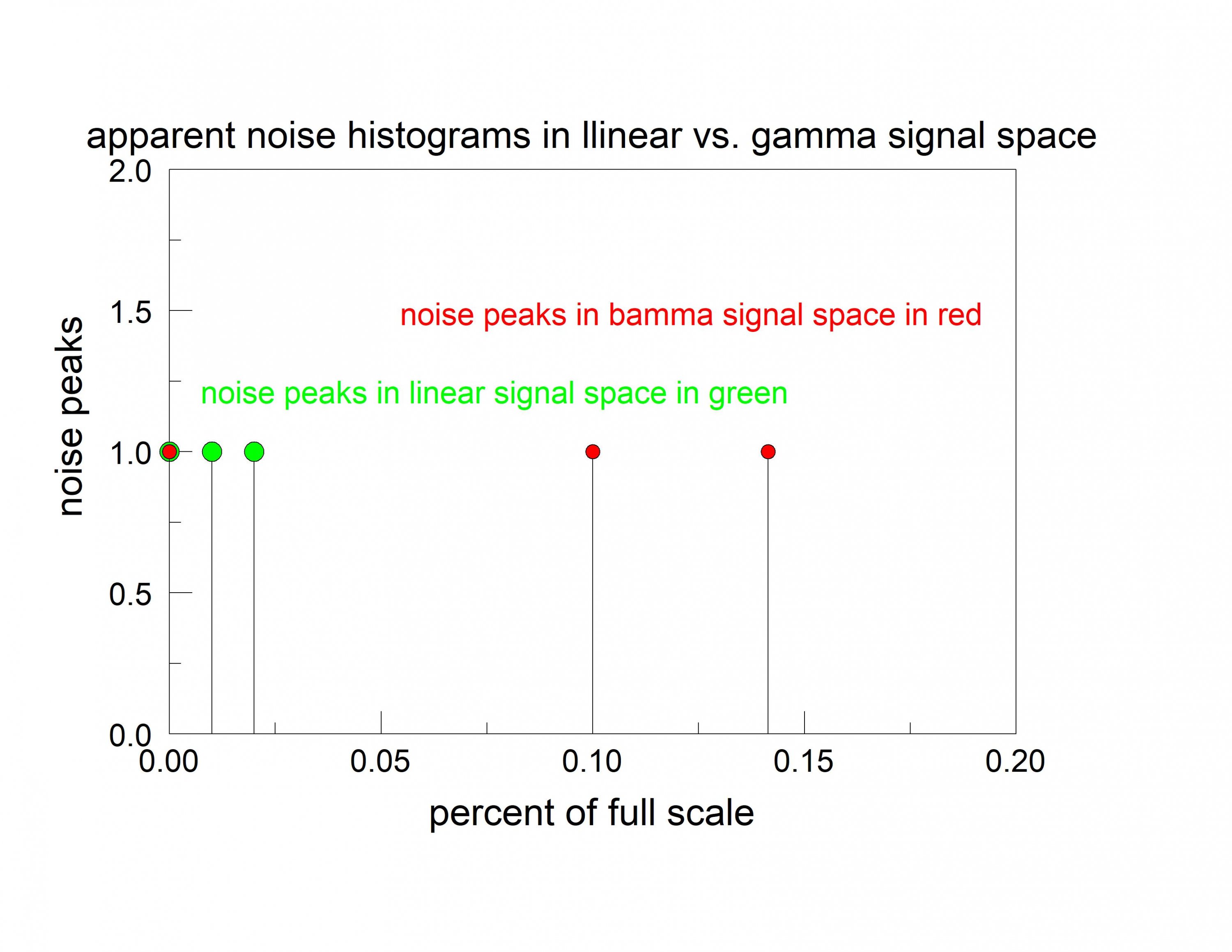

Addressing the point of noise in 16 bit vs. 8 bit noise levels. If the electronics and digital programming of a scanner are designed correctly then if noise shows up at 8 bit scanning then it will show up at essentially the same relative level at 16 bits. For example, if noise were 1% of full scale in an 8 bit scan it will also be at 1% of a 16 bit scan. The only difference would come in because of round-off error and digitization error, which are closely related to each other, and this can show up noticeably when the root mean square noise level is less than about one ADC step size of the 8 bit digitzer. As the noise level gets lower the first noticeable change will be dynamic range, and the next noticeable change will be that banding can become visible under extreme image manipulation.
In comparing the inherent noise level of 8 bit vs. 16 bit scans it is necessary to do the comparison under comparable conditions. Most importantly, one can't compare 8 bit scan that has undergone gamma transformation with a 16 bit scan that has not undergone gamma transformation. The underlying reason for this is that the gamma transformation spreads out the data in the low range, making the data look "wider" in that range, so noise levels that would be similar if histograms (or the images themselves) are both viewed in linear signal space do not look similar if one of the scans has undergone gamma transformation.
I'm going to do a little math to show what I mean. I'm going to use a simple gamma transformation equation for illustration purposes. Real gamma transformations typically are not quite that simple, but the principle being illustrated is the same. consider an image of a dark region whose histogram were to consist of three peaks in linear signal space, one at 0% of full scale, one at 1% of full scale and one at 2% of full scale. Let full scale have a value of 1. Consider a gamma transformation with a gamma equal to 2, and assume that the following equation governs the transformation.
output = (full scale)*(input)^(1/gamma)/(full scale)^(1/gamma)
This equation is a power law that preserves the zero point and the full scale point. If full scale is 1 gamma is 2 then the equation reduces to the following form
output = input^(1/2)
The (input, output) list for 0%, 1%, and 2% fill scale looks like this.
(0, 0)
(0.01, 0.1)
(0.2, 0.141)
As you can see, after gamma transformation the fist peak beyond the zero peak is at 10% full scale instead of 1% full scale, and the second peak is at 14.1% full scale instead of 2% full scale. Thus, the noise spectrum after gamma transformation looks like its far worse, even though it's not. The apparent spreading of the noise is a mathematical artifact of the gamma transformation, not a result of a difference in noise level itself.
Therefore, if one were to compare noise in the low-noise region for two scans that have the same relative amounts of noise (relative to full scale) of one of the scans had undergone gamma transformation it would look far nosier than the other, even though it is not actually noisier.
This is why you can't compare the low-level noise of an image that has been gamma transformed from one that has not.
To date in this discussion there has not been a comparison of a linear 16 bit results to a linear 8 bit result. There has only been a comparison of a linear 16 bit result to a gamma transformed 8 bit result, And this is why a proper comparison has not yet been done.
I mentioned already that real gamma transformation processes don't necessarily follow a simple power law, but the spreading of the signal at low signal levels is still a feature of the gamma transformation process, even for those that use more complicated algorithms, so the fact remains that you can't compare the noise in two images if one has undergone the gamma transition and one has not, because the gamma-transformed image will look artificially noisy.
I'm posting a figure to show the results of the calculation I did. As you can see, the noise gets spread wider in gamma signal space. (Please overlook the typo in the graph. It should say gamma, not bamma.)
Bottom line: You can't compare noise in linear signal space with noise in gamma signal space. Both have to be in the same signal space.

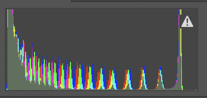

8 bit acquire, 8 bit save raw
16 bit acquire, 8 bit save raw
If Vuescan was in fact not gamma encoding 8 bit acquire and 8 bit raw save, then these two histograms should not match, but as a matter of fact, they mostly do. If I toggle between them, there's a difference down on the lower end, but I suspect that is due to the difference of less noise and more dynamic range on the 16 bit acquire.
I've also done the exercise with saving to tiff files and arrived at the same place, though there is a slight difference between 8 bit raw saves and 8 bit tiff saves due to the fact that sRGB isn't actually a straight 2.2 TRC. That being said, yes, in fact, 16 bit acquire with 16 bit raw save is not gamma encoded, it really does appear to be just a straight sensor dump to disk, so that's good.
I still would like to get some answers with regards to the wildly different noise floor levels I've seen with my own testing, but I think in the interest of this thread, that is a different subject, and maybe a different thread after I get the time to really poke around at it.

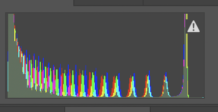

So where does that leave us?
