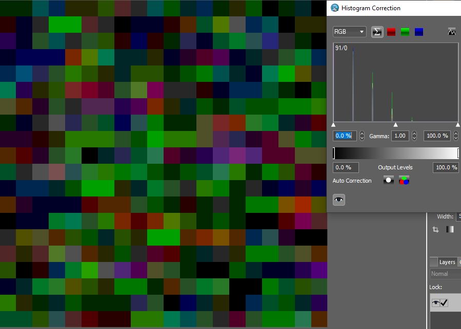

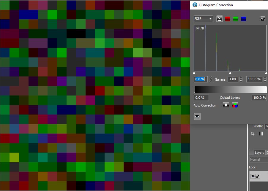

Here's the experimental setup. I did two scans. For each I scanned an image with transparent and dark regions. (See post #118 to see what the full scan region looks like.) Although previously I scanned the same image in gray scale mode, for these results I scanned in rgb mode. I then selected a 20 x 20 pixel region from the lower left corner of the scan, which is where the image was the darkest possible because it is far from the light portion of the image and in the selected region the light would have had to penetrate a book, a black piece of paper, and the black plastic frame of a film holder before reaching the detector. (That's assuming that no light reaches the detector from an indirect scattered-light path.)
I then generated histograms from each image using photoline software. I zoomed the horizontal scale of the histograms in order to expand it to better determine what the distribution looks like. I zoomed in a single step. The zoom factor was 2.5%. I also extracted the intensity values from the histograms and calculated the means and standard deviations of the two distributions, taking the peaks to be separated by one unit on the zoomed horizontal axis.
Here are the images and the histograms.

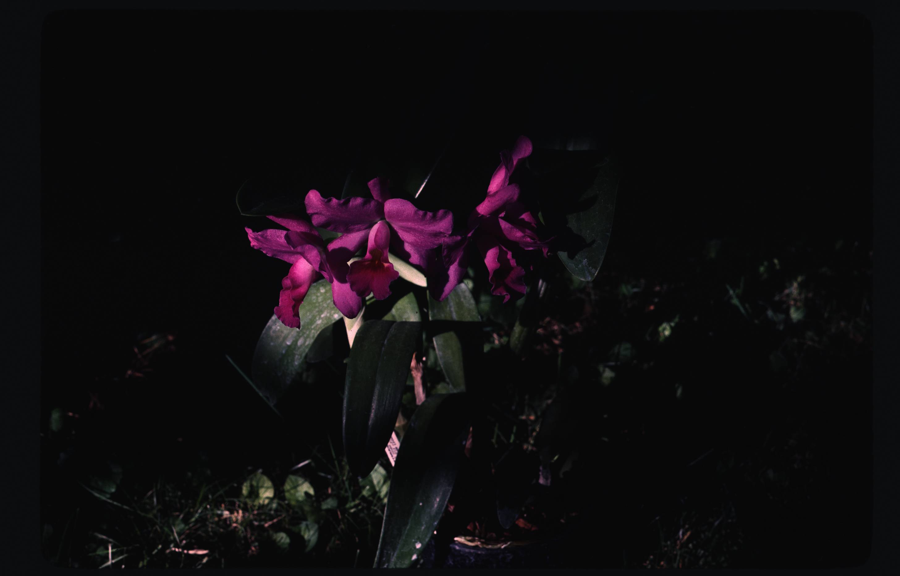

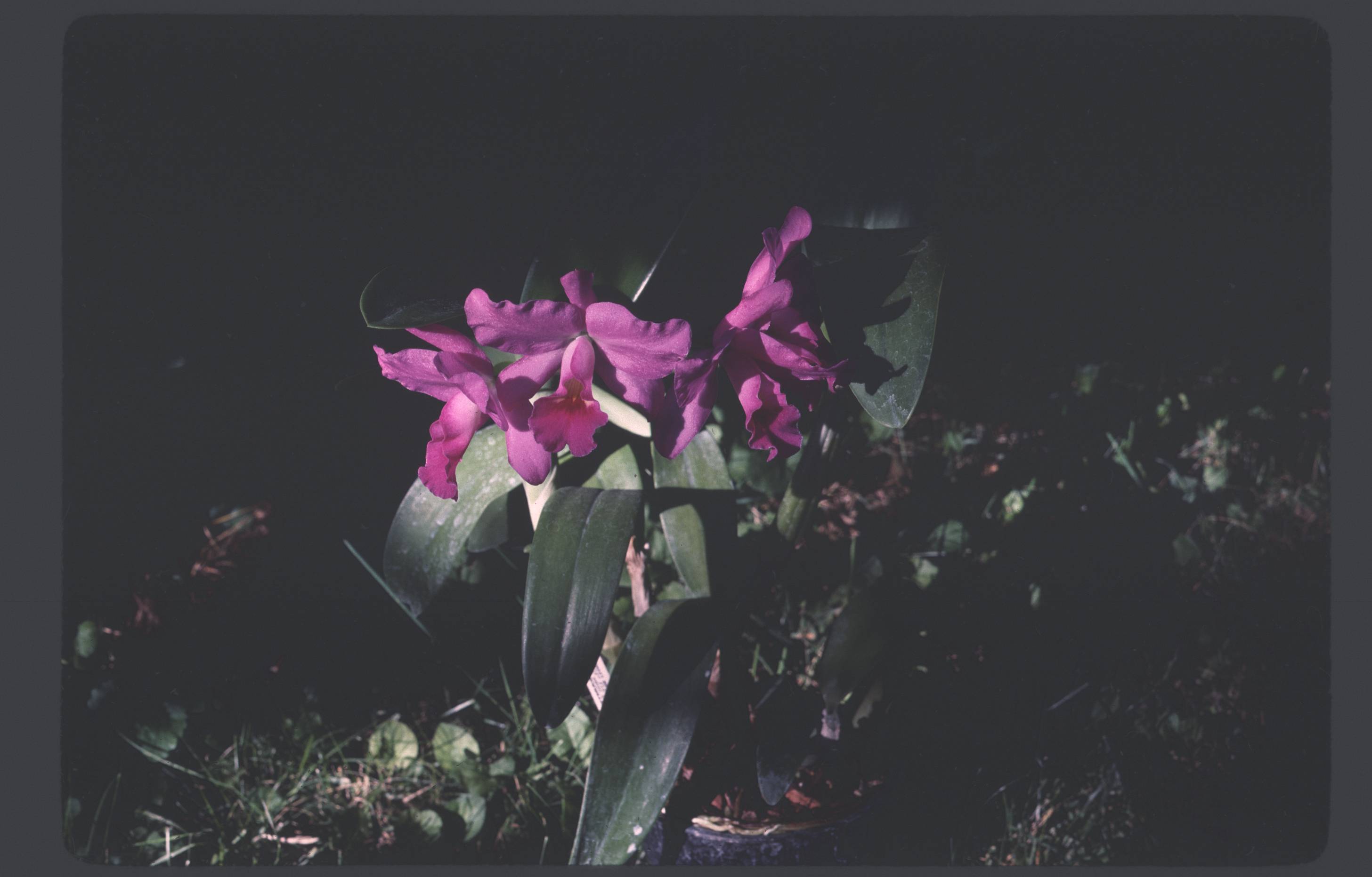

Just Eyeballing the two images I would be hard pressed to tell them apart, so I did some statistics. For the scan with the input set to 8 bits and the output set to 8 bits the mean was 0.9500, and the standard deviation was 0.9526. For the scan with 16 bits in and 8 bits out the mean was 1.0300, and the standard deviation was 0.9078. These results are statistically indistinguishable.
For the scans to be statistically distinguishable would require either that the means from the two scans be further apart or the standard deviations would have to be smaller. Therefore, based on these experimental results if you save the result in 8 bits it does not matter if the input parameter is set to 8 bits or 16 bits because the results are statistically indistinguishable.

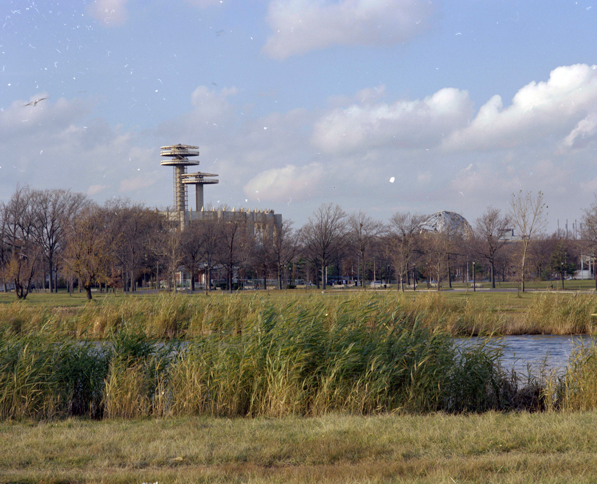

Here's the test. First we have regular tiff file for reference. It was a 16 bit input/16 bit output scan.
Nothing notable about that image.

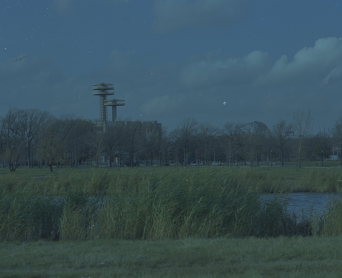

Next is the same image (from the same scan) stored as a raw file. To be clear about this, it is 16 bit input/16 bit output raw file.
As expected for a raw file it looks darker than the normal scan shown in the first image.
Next we have a 8 bit input/8 bit output scan saved as raw.
Compare it to the first image in the post. It looks like a normal scan. This is in accord with the Hamrick documentation which says that an 8 bit raw scan is gamma encoded, just like a normal scan.
Next we have a raw scan using 16 bit input/8 bit output.
Surprise! According Adrian's account of what Hamrick told him this should have been stored in a linear format, not gamma encoded. Therefore it should look like the second image I posted, but it doesn't. It looks like the first image. This means that it was gamma encoded, just like a normal scan. Just to be sure I didn't make a mistake I repeated the last scan. I am not posting it because it would be redundant because it looks the same as the last scan.
So bottom line: forget the information you heard in this thread that a 16 bit input/8 bit output raw scan is saved in linear form (i.e. not gamma encoded) because it's just not true. a 16 bit input/8 bit output raw scan is gamma encoded, which I suppose means it's not a true raw scan doesn't it?
