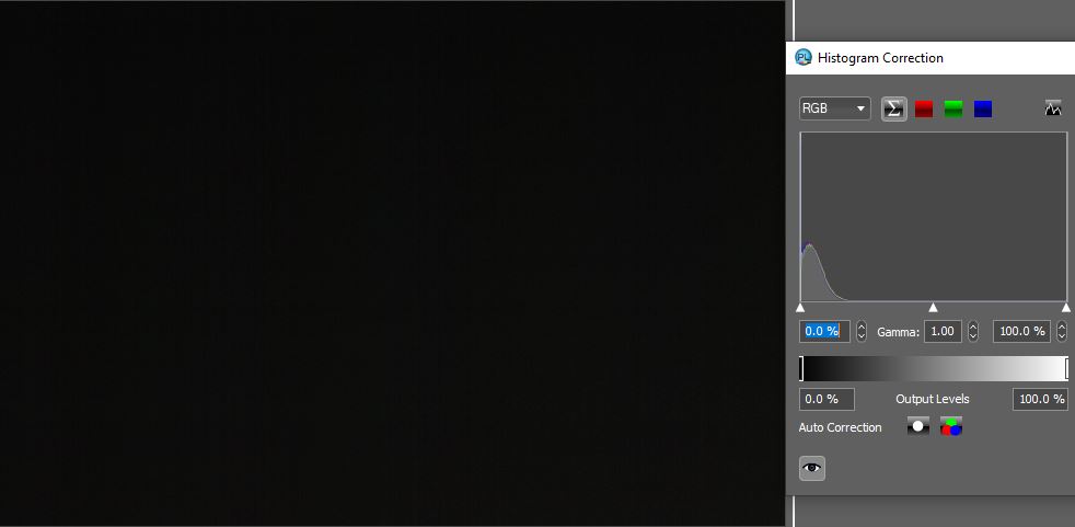

Finally, I come to a discussion of these scans by Adrian. They are scans of a black slide, so in a perfect world the output would be all zeros.
As Adrian noted, the 8 bit scan is noisier than the 16 bit scan. I am uploading the images and histograms to show this. For these histograms I zoomed in on the horizontal scale to 10% for each of the two scans. The horizontal scales are comparable for the two scans because they are both shown in a percent of full scale. (In this case full scale displayed here is 10% of full scale of the original scans.) The first image is the 16 bit histogram, and the second image is the 8 bit histogram.
Just eyeballing the histograms I estimate the noise in the 8 bit result to be about 2.5 times that of the 16 bit result. That is a big difference, but nowhere near the 257 fold difference one would naively expect based on the difference in bit depth alone. (As an aside, yes, 257 is the correct scaling difference between an 8 bit word and a 16 bit word, not 256 or 255.)
I have previously shown from fundamental considerations that if there is much noise showing up in an 8 bit scan then a 16 bit result has to have almost as much noise relative to full scale. At most the 16 bit histogram will show only a little less noise, not the two or three fold difference that we are seeing here.
Also, looking at this from the other direction, based on the width of the distribution in 16 bit mode (from which I estimate that the sigma of the 16 bit result on an 8 bit scale would be about one half bit), there should be a little noise showing up after conversion to 8 bits. There should be peaks at a few but only a few ADC step increments. Therefore, these results are hard for me to explain. There is an explanation for the difference. I just don't know what it is, but it can't be due to the difference in bit depth alone.
Also, it is worth pointing out that even just looking at the 16 bit histogram we can see that there is a lot of noise in a dark image acquired from the scanner, orders of magnitude more than the ADC step size at 16 bits. This implies that 16 bits has far far more bits than required to acquire the full dynamic range available, given the noise level inherent in the instrument. There is nothing wrong with this, but it does show that the scanner is relatively noisy.

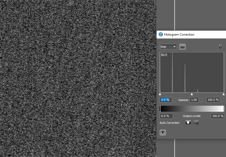

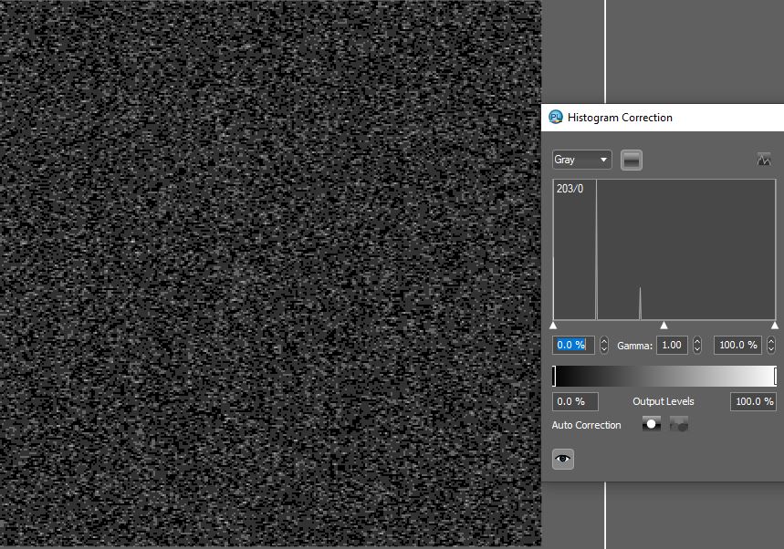

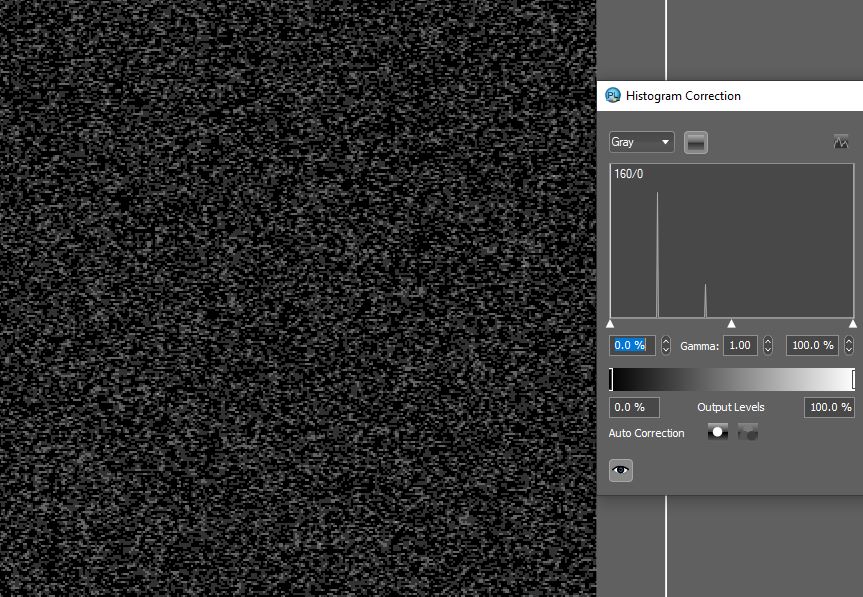

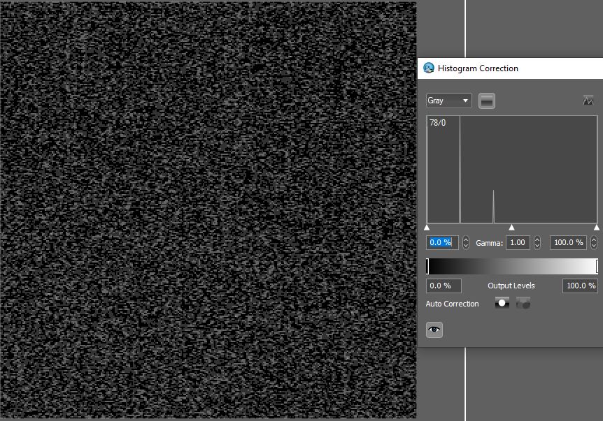

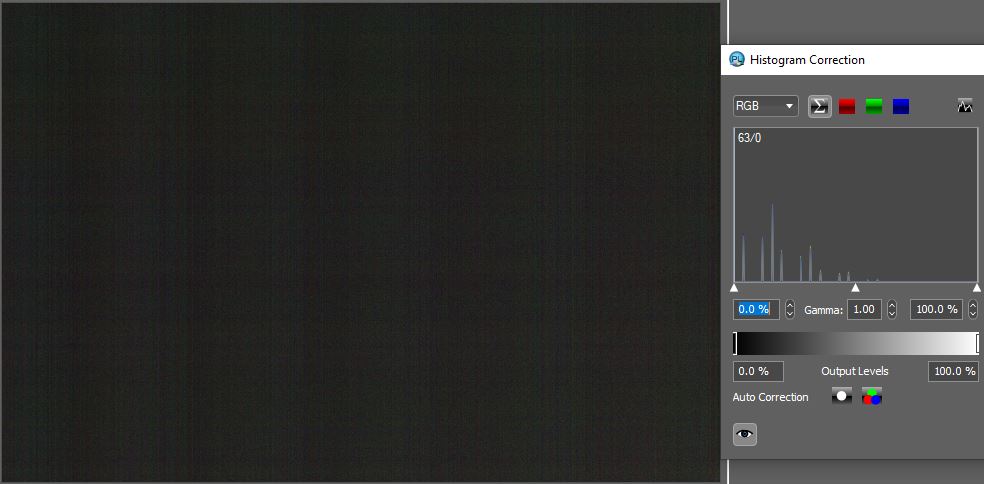

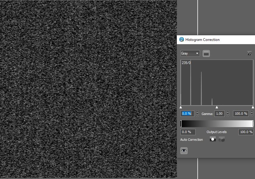

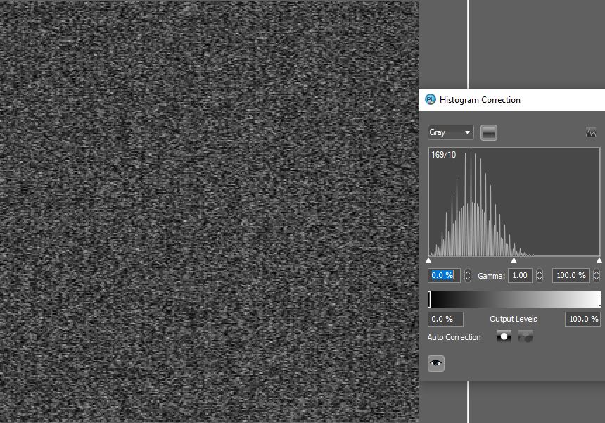

Next I will discuss my re-scans of a dark region. Please refer back to my post #118 to see what the original full image was. This scan was performed an an Epson V/750 scanner, which is a comparable model but an older version compared to the V/850 that Adrian used.
For what I am posting below I took a small crop from the lower left hand corner of the fill image. In this part of the image the light is blocked by a combination of a book, a black piece of paper, and the opaque frame of the film holder. Based on the geometry I used there should be almost no scattered light reaching the sensors, so what I am seeing is the dark response of the system.
These were gray scale images, taken from the green channel. They were acquired in image mode using Vuescan. I don't think that Vuescan applied any profiles to the images. Anyway, that parameter was set to “default”, and I don't think it would make any sense to apply a color profile to a gray scale image, so I assume that “default” in this case means no color profile.
For the histograms shown below I cropped the left most 2% of the scans. I used photoline for the processing.
Please bear with me because there are several image to compare, so don't be overwhelmed by the number of images. I will give the commentary following the images.
The first two images were scans acquired in 8 bit mode and stored by Vuescan in 8 bit mode. The two scans were performed identically. I am showing these two in order to illustrate that scanning is not perfectly reproducible using this system. Note that there are two peaks showing. The relative abundances differ slightly between the two nominally identical scans. Also, if you look carefully at the two images (to the left of the histograms) they look similar, but not quite the same, another indication that scans are not perfectly reproducible on this scanner.
The peaks are spaced by one 8 bit ADC increment. There is actually a third peak present positioned at zero on the horizontal scale, but it is obscured by the axis. Also, for some reason photoline does not allow me to place the cursor there to get an abundance. However, from other experiments (which I will not describe here) I know that there is a peak at the leftmost axis, and I have reason to believe that the graph is scaled so that the obscured peak is at full scale.
The fact that there are two peaks showing in the 8 bit scan means that there is a little bit of noise in the system, enough to register non-zero counts in the lowest few ADC increments.
The third image was acquired in 16 bit mode and stored in 8 bit mode by Vuescan. It is extremely similar to the first to scans.
The fourth image was acquired in 16 bit mode and stored in 16 bit mode. Just by eyeballing the images it looks to me like the width of the distribution is about the same as in the scans stored in 8 bit mode. If anything it might actually be slightly broader and shifted slightly to the right
The fifth image was the same scan as the fourth image. However, it was converted to 8 bit using photoline before the histogram operation was performed. Note that it looks very similar to the other 8 bit results. If anything the distribution might be slightly wider and shifted slightly to the right.
All of this adds up to the following conclusions. There is noise in both the 8 bit and 16 bit images, and the amount of noise is almost the same regardless of whether they are in 8 bit or 16 bit mode.
The sixth and last image is one that was acquired in 8 bit mode and stored in 16 bit mode. There is a sparse set of peaks, as expected for an image stored in 8 bit mode, but compared to the other 8 bit images the peaks are spaced closer together. I don't know why this is happening. Perhaps the image was gamma encoded twice. Anyway, other than the fact that the peaks are spaced closer together, the image is pretty much similar to all of the others.
Here's what I conclude. The Epson scanner produces scans that are slightly noisy, and the noise is down at the range of about one bit relative to an 8 bit ADC. Furthermore, there is little or no difference in the noise, regardless of whether one store the results in 8 bit or 16 bit mode. Because there is some noise, there will not be banding in 8 bit mode, assuming that if one does subsequent image processing it is done in 16 bit mode. Also, because of the similarity in noise level in 8 bit vs. 16 bit mode the difference in dynamic range will be small-to-negligible.

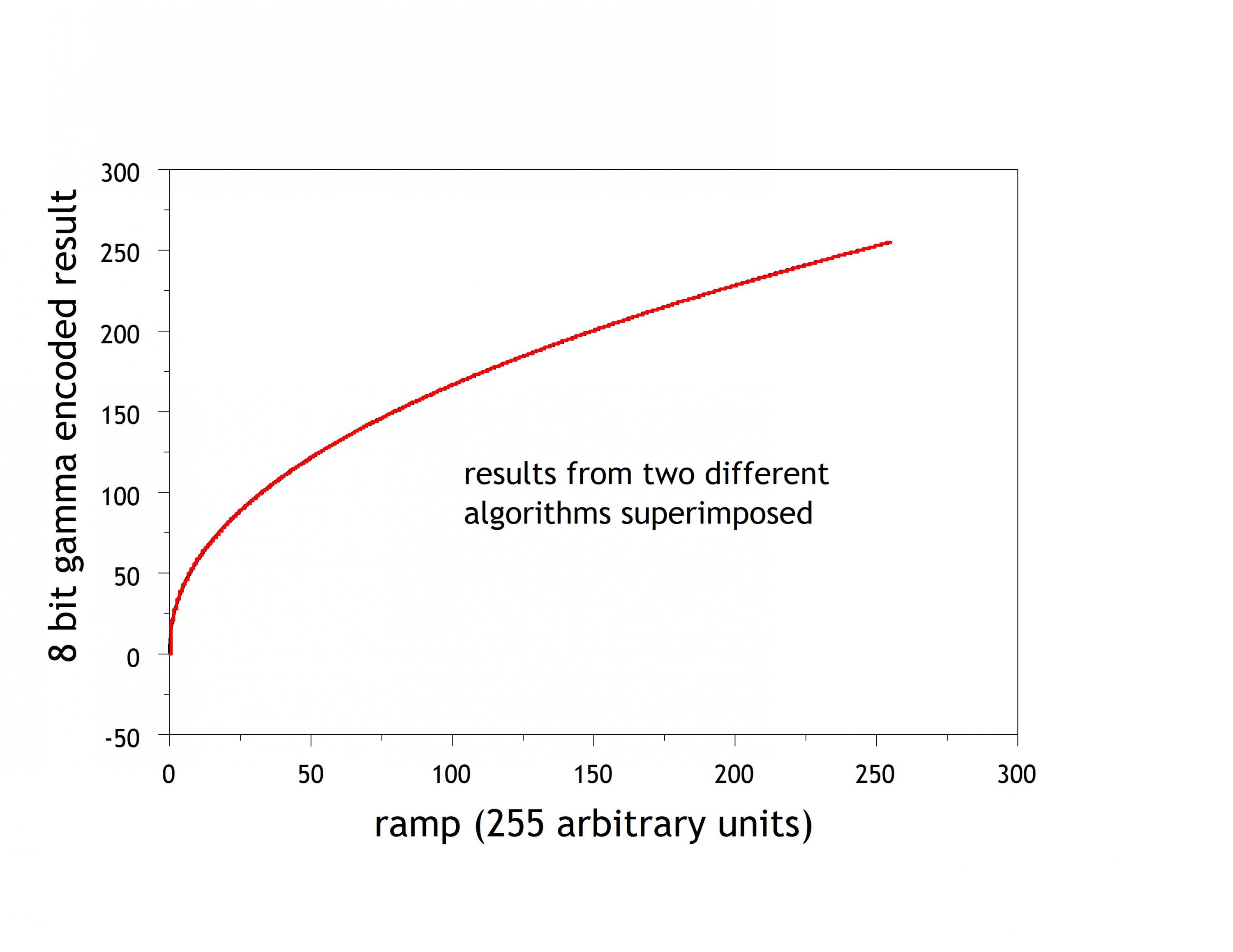

I did a little sleuthing and I learned that when I save the same scan in 8 bit mode in both raw and tff, the two results are nearly identical. What I mean is that when I zoom in on a histogram region the peak pattern is nearly the same.
However, when I save a scan in 16 bit mode in both raw and tiff mode they histograms look different when I zoom in on a histogram region.
Assuming that vuescan saves regular tiffs in gamma encoded mode, the results above confirm what the vuescan documentation says at the Harmrick website, which is that when you save an 8 bit file in raw mode it actually saves in gamma encoded mode. This kind of throws the comparisons for a loop, by which I mean that you can't compare a 16 bit raw to an 8 bit raw because vuescan's 8 bit raw saves aren't really raw. They are gamma encoded.

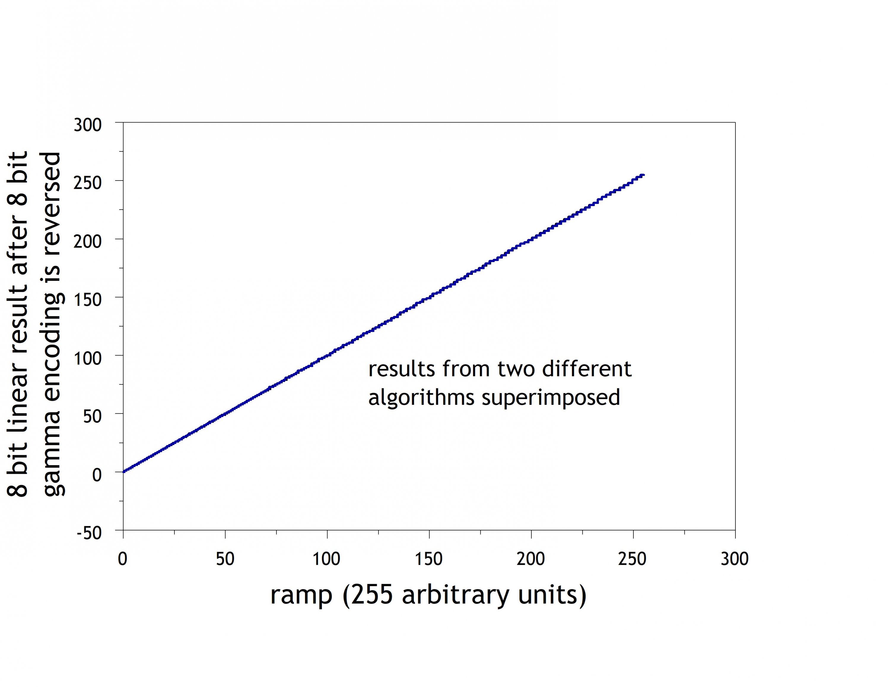

I am not able to reverse the 8 bit gamma encoding to create a linear file. I also don't have a way to convert a RAW 16 bit file to a gamma encoded 16 bit file.
Therefore, things seem to be in a bit of an impasse, since a true RAW file can't be directly compared to one that is gamma encoded. If you are able to convert a gamma encoded 8 bit file to a linear one (or convert a RAW 16 bit file to a gamma encoded file) then that would enable a comparison to be made. Otherwise comparisons can't be made, and we are just spinning our wheels.
As far as color profiles are concerned, I strongly suspect that because I did not check the box "TIFF Profile" in the output window a color profile was not applied to my results, especially because all of my work on this problem has been in gray scale. (I don't see why a color profile would be applied to a gray scale image, but maybe I am missing something.)
I agree that gamma encoding an 8 bit "RAW" file is a dumb idea, and confusing as well. I wonder if this whole issue could be bypassed by using Silverfast. Unfortunately, I am not competent with that program, and in any case the version of Silverfast that come with my V750 won't run under Windows 10.
One more thing, it is already implicit in our discussions so far, but it's worth explicitly noting that I saved my files in Grayscale, and I think yours were save in color, so that is another point of difference between what you are doing and what I am doing.
Actually, despite the apparent impasse due to incompatible file types, I think this discussion is making progress, but I don't see much in the way of future progress without breaking through the impasse.
Also, if you look at the last set of gray scale images I posted you will see that when I took a file saved in 16 bits and converted it to 8 bits within Photoline the results were practically the same as the file I saved in 8 bits, so I think that gets around some of the issues you raised with regard to gamma encoding, color profiles, etc. Any thoughts on that?

Also, gamma encoding isn't actually much of an issue. It can be shown that the following two workflows do not produce identical results, but the differences between them are small. Workflow 1: digitize in 16 bit mode. Do the gamma transformation. Round off to nearest integer. Convert to 8 bits. Round to nearest integer. This produces a gamma encoded result by one algorithm. Workflow 2: digitize in 16 bit mode. divide by 257 to produce a generally non-integer intermediate result. Round to nearest integer to produce an 8 bit result. (At this point it is the same as if you simply digitized with an 8 bit ADC, so if one actually had an 8 bit digitizer in the instrument one would start here.) Apply the gamma transformation. Round off to nearest integer. This produces a gamma encoded result by a different algorithm. The two results are not identical, but they aren't much different either. Here's a plot of the results of the two different workflows overlaid on the same plot, one it black and the other in red.
The difference becomes even less if one then converts back to linear signal space. Here's a plot of the results of the two workflows overlaid on the same graph, one in black and the other in blue.
I think most people can agree that based on the graphs, the two workflows produce very similar results. Therefore, although it is true that if one wants to save 8 bit scans then the best workflow is to acquire in 16 bit and save in 8 bit (provided the option is available), and this is the workflow I used, the end result won't be much different if one simply acquires in 8 bit and saves in 8 bit.
One slight clarification about the figures in this post. The x axis is labeled as "ramp (255 arbitrary units)." This means that the numbers run from zero to 255, not that there were 255 separate values in the ramp. The ramp has 65535 separate values, so it is quasi-continuous.
