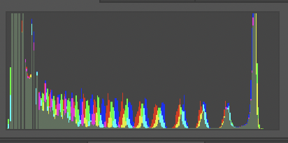

The histogram for the acquire 8 bit save 8 bit raw

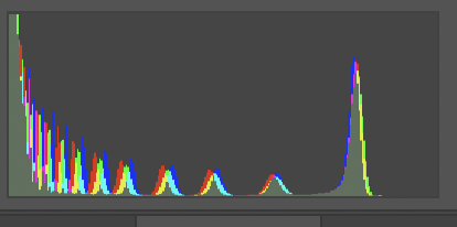

Now the acquire 8 bit, save 16 bit raw

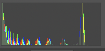

Now the acquire 16 bit, save 16 bit raw
The two 16 bit raw saves are a very close match, and very different than the 8 bit acquire save 8 bit raw, so they should be able to be compared to each other for the purposes of looking at dynamic range differences. I can generate and upload just some black frame noise floor images if anybody wants to look at those as well, though toggling between the two 16 bit raw save histograms shows that there is a difference between the two down on the bottom end of the scale.

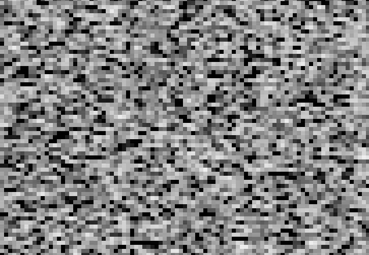

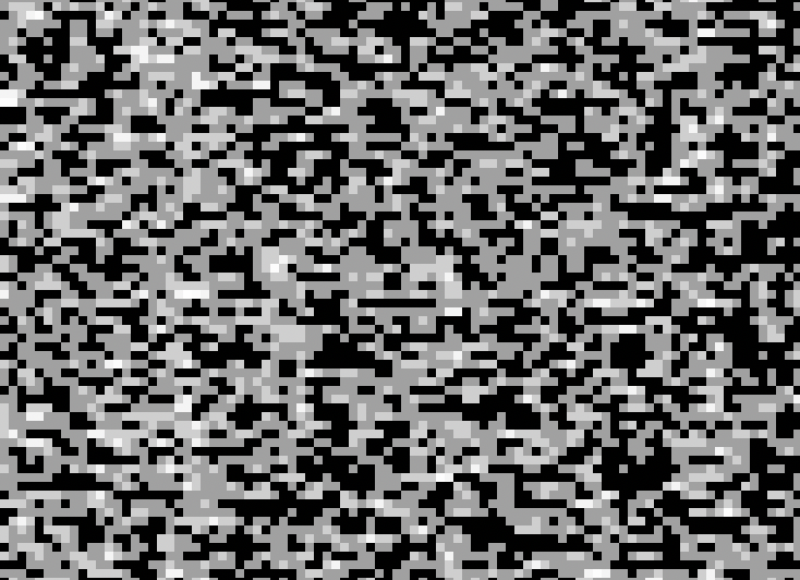

The width of the histogram is a reflection of the amount of noise present. The cleaner the noise floor is, the skinnier the spike in the histogram is.
Zooming in and looking also reflects that acquiring in 8 bits is a bit noisier as well.
acquire 8 bits, save 16 bit raw
acquire 16 bits, save 16 bit raw
