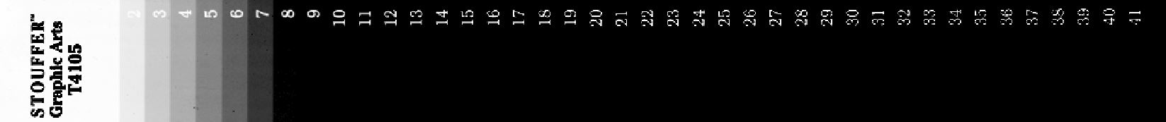

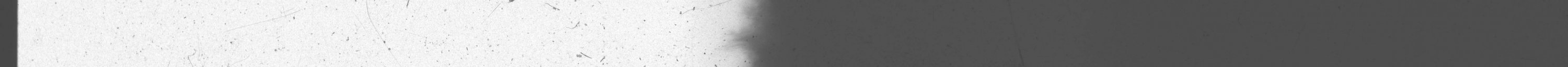

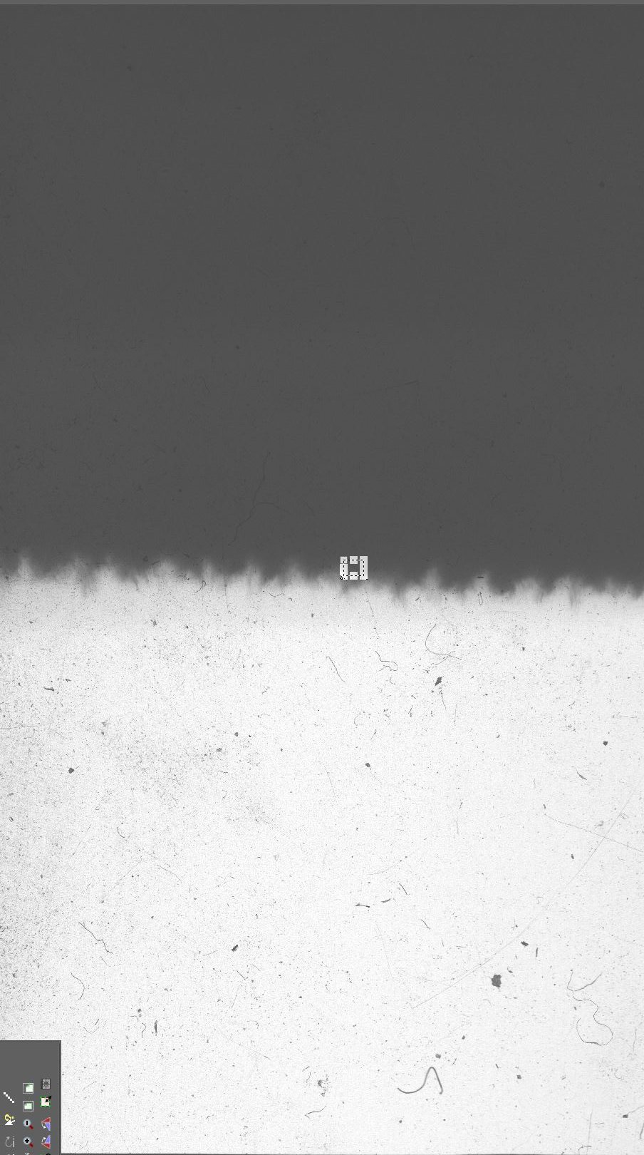

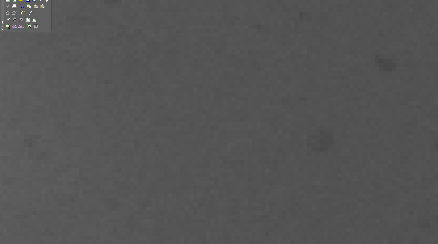

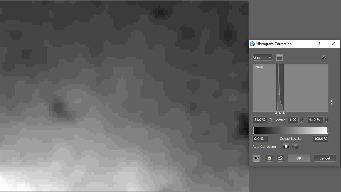

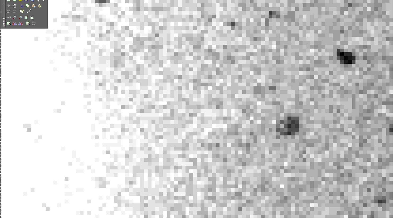

I've done a little more experimentation. I scanned a Tmax 100 negative and selected 8 bit gray scale for the storage mode. The scanner was a canon fs4000us in 4000 dpi mode. The image was the leader part of the film, including exposed and unexposed parts of the leader. It's very dusty because there's not much point in protecting a leader from dust, but this fact is irrelevant to the demo. Here's what the scanned slide looks like. It shows the crop window that I used for subsequent operations.
All of the following images are from the cropped area. The first image below shows the cropped rectangle with no operations performed on the scan.

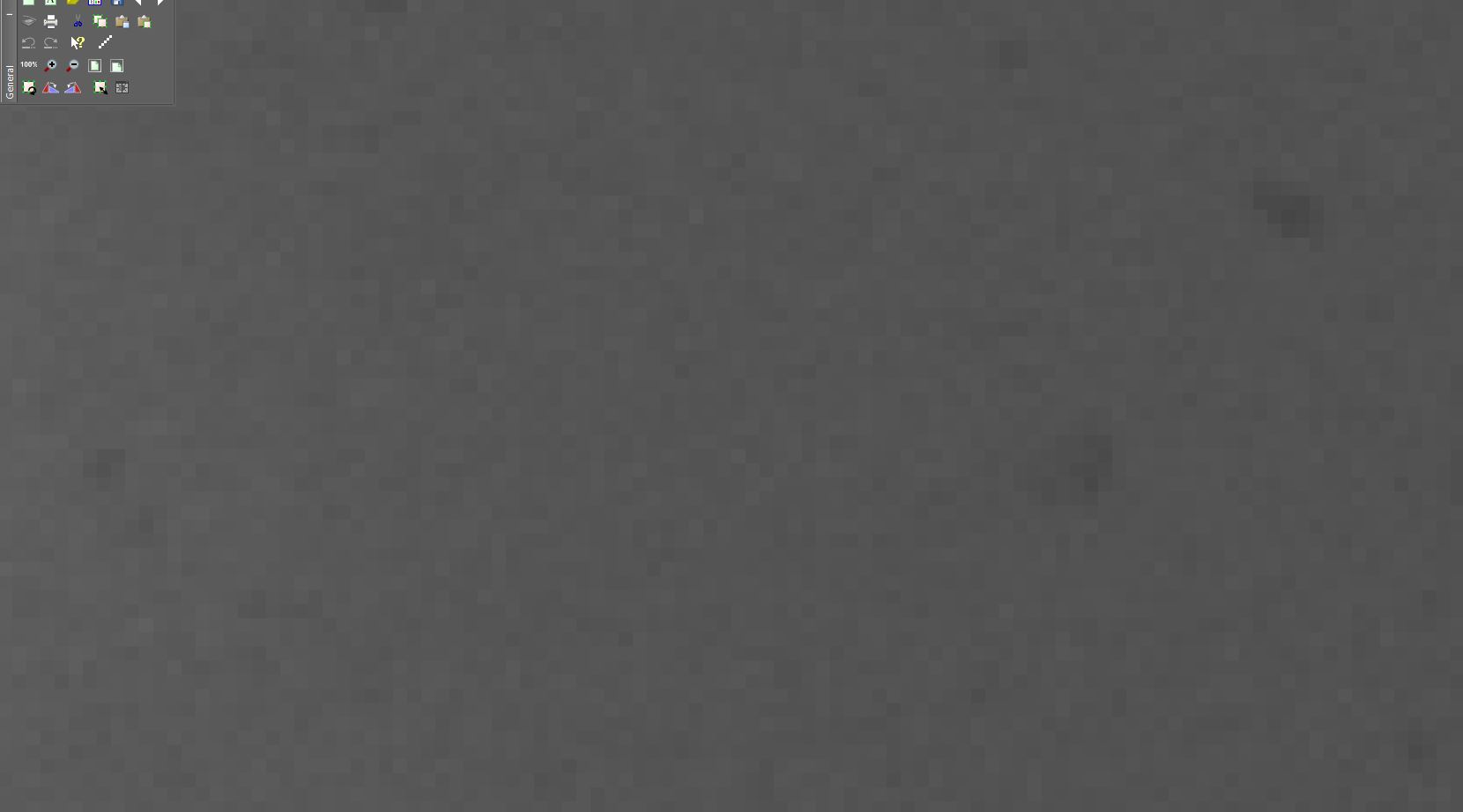

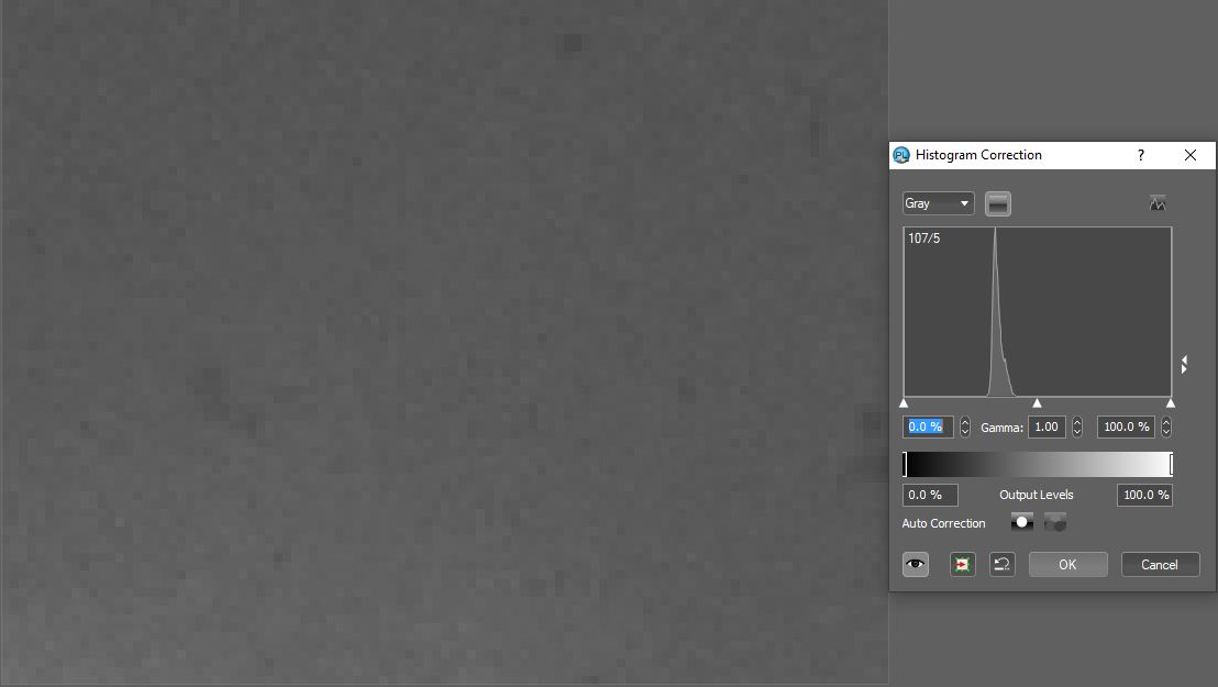

In the image above I'm showing a histogram adjustment window, but no adjustments have been made, as indicated in the percentage boxes. Note that there is a very subtle gradient in the image.

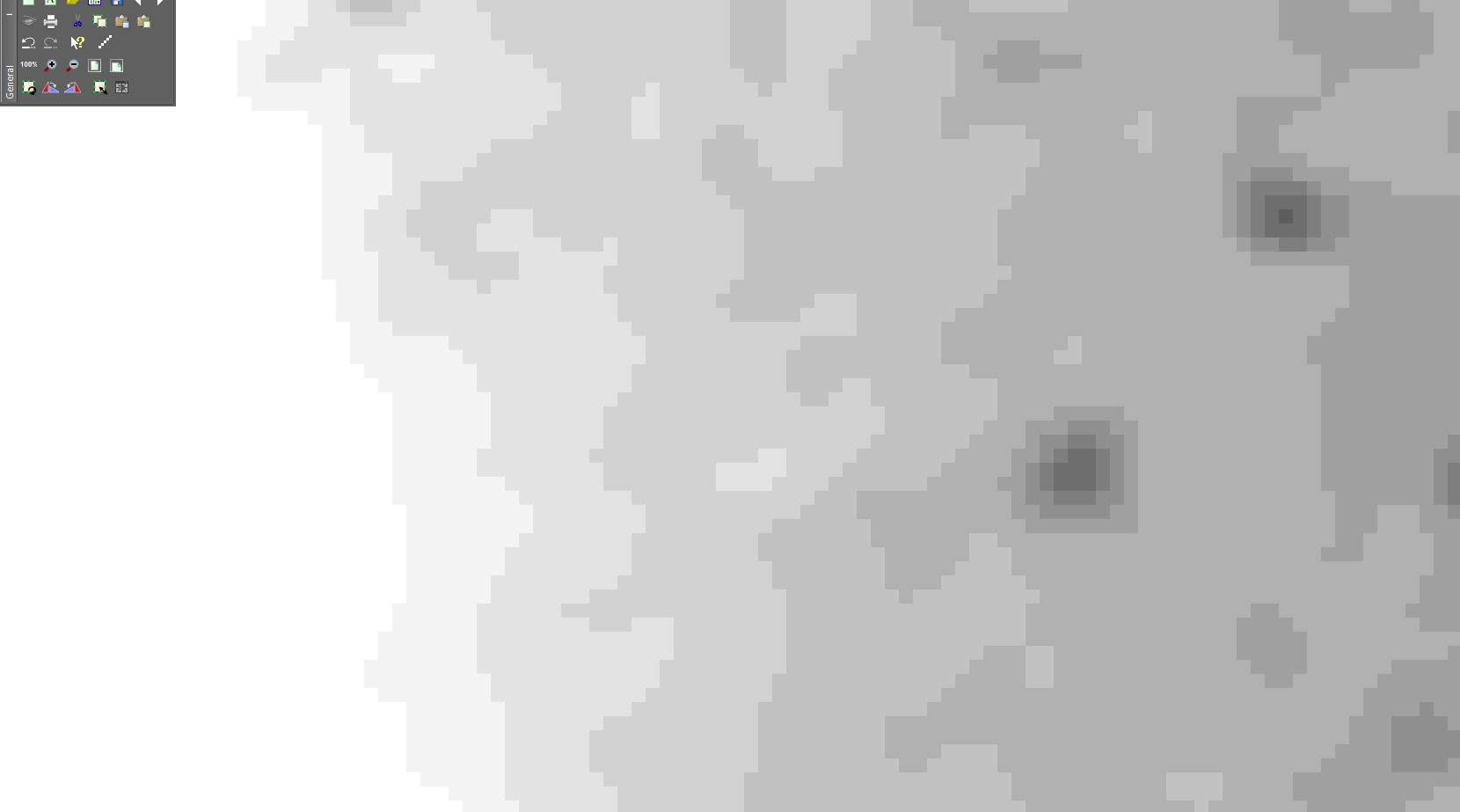

I then did the following adjustments in 8 bit mode using photoline software. First I did a 5 pixel Gaussian blur, followed by a histogram using the limits of 31% to 41% for the histogram, as seen in the histogram window. This workflow was intended to show that banding can occur if an image is scanned in 8 bit mode followed by the wrong workflow. As you can see, this workflow did produce a lot of banding.
tmax crop 8 bit scan 5 pixel Gaussian blur in 8 bit mode followed by 31 to 41 histogram.JPG

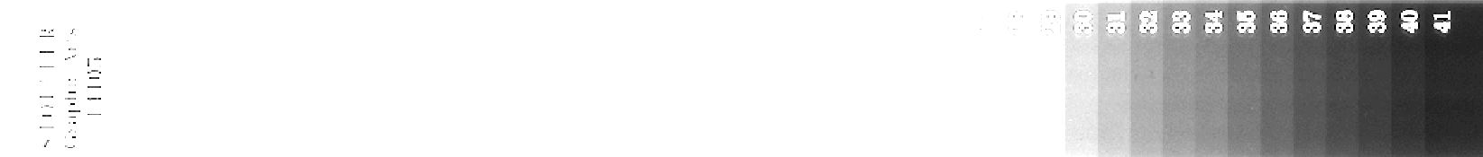

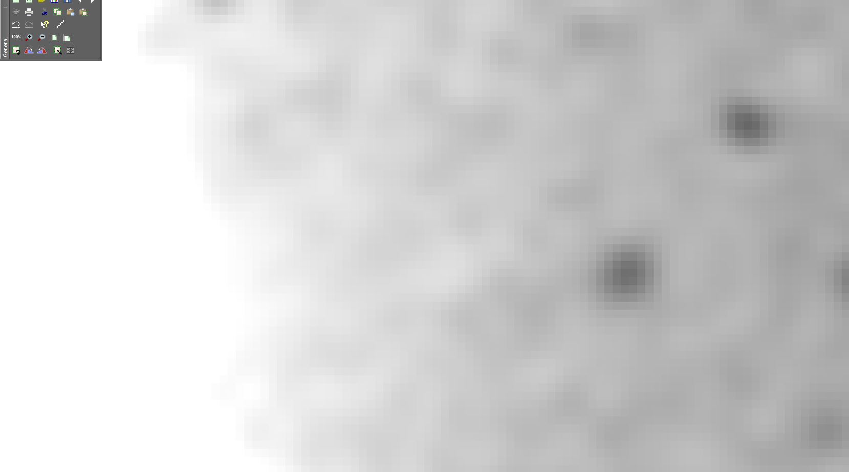

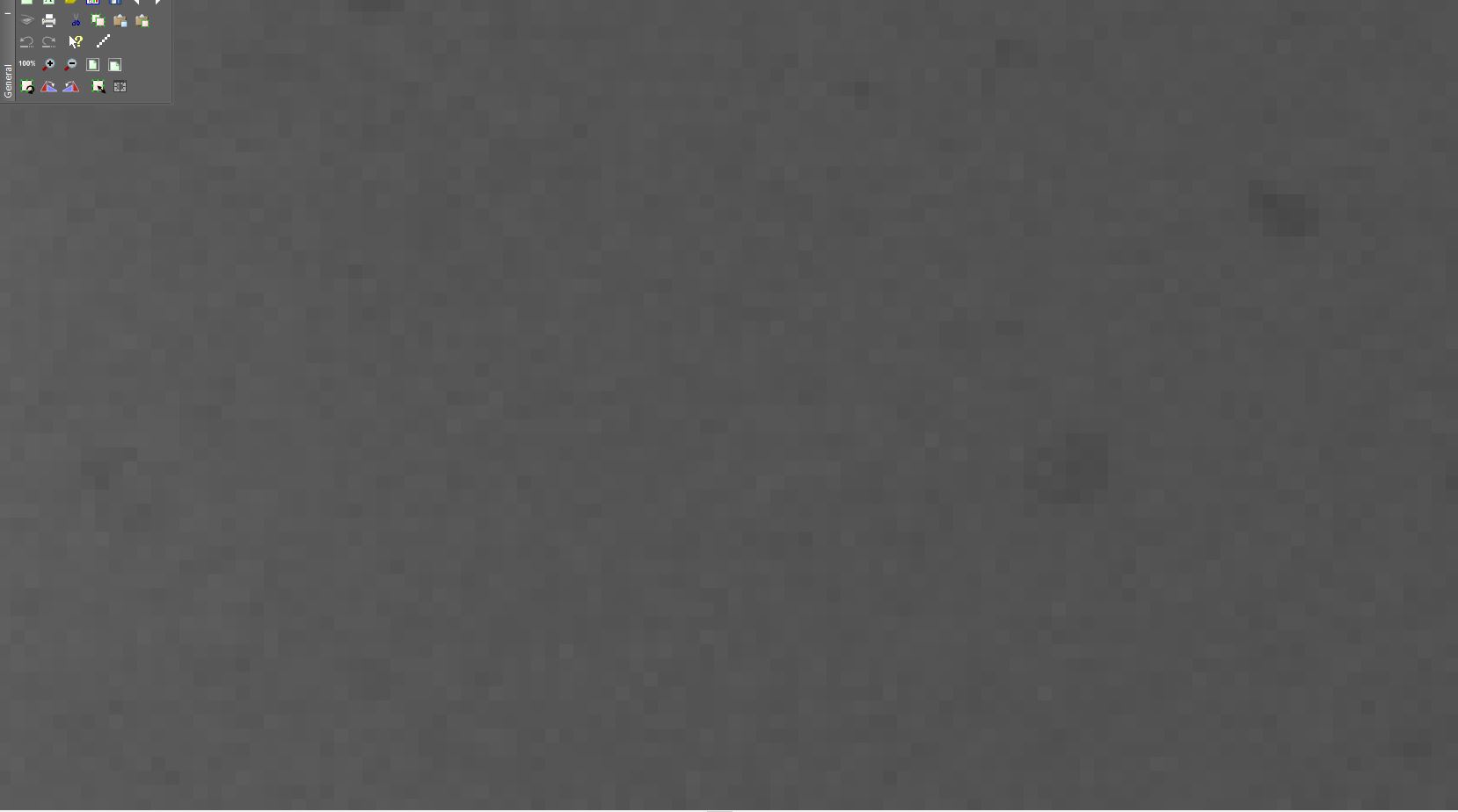

Then I did a slightly different workflow. For this one I started with the same cropped 8 bit image, but this time I first did a conversion to 16 bits. Then I smoothed with a 5 pixel radius followed by a 31% to 41% histogram. This is exactly what I did in the other workflow except that I started by converting the 8 bit image to 16 bits. As you can see, there is pixelation because it's a small crop window, but there is no banding. The gradients are nice and smooth.
I think this pretty convincingly shows that the workflow I proposed worked like a charm to eliminate banding, even though the scan was only 8 bits. It also demonstrates the risk of using the wrong workflow.

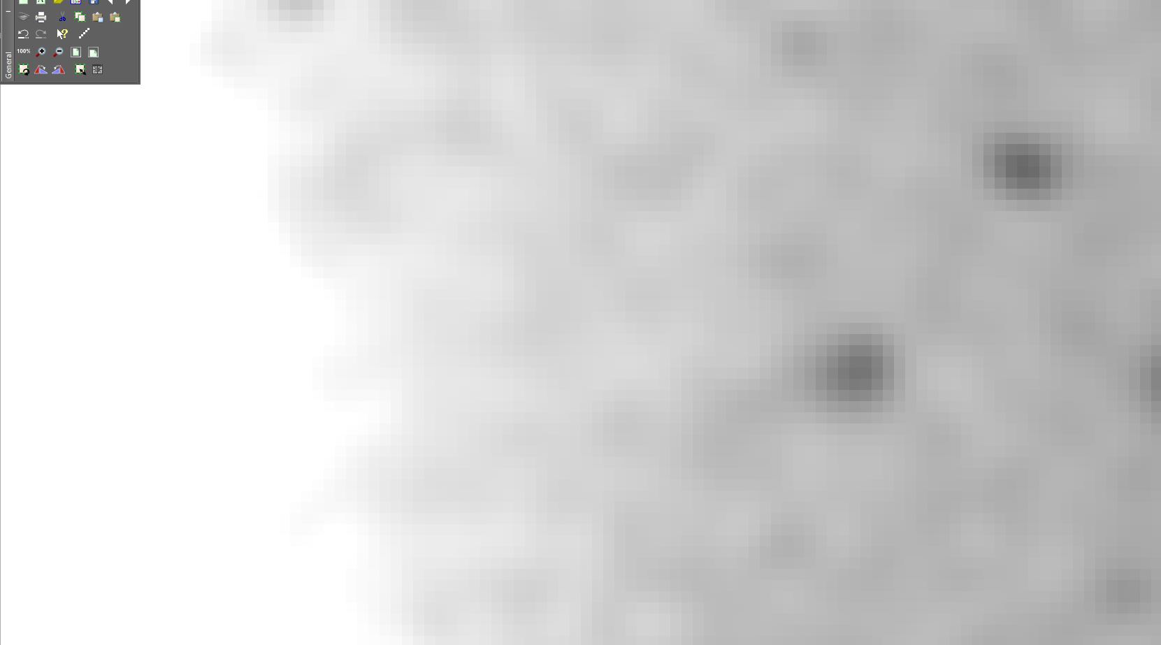

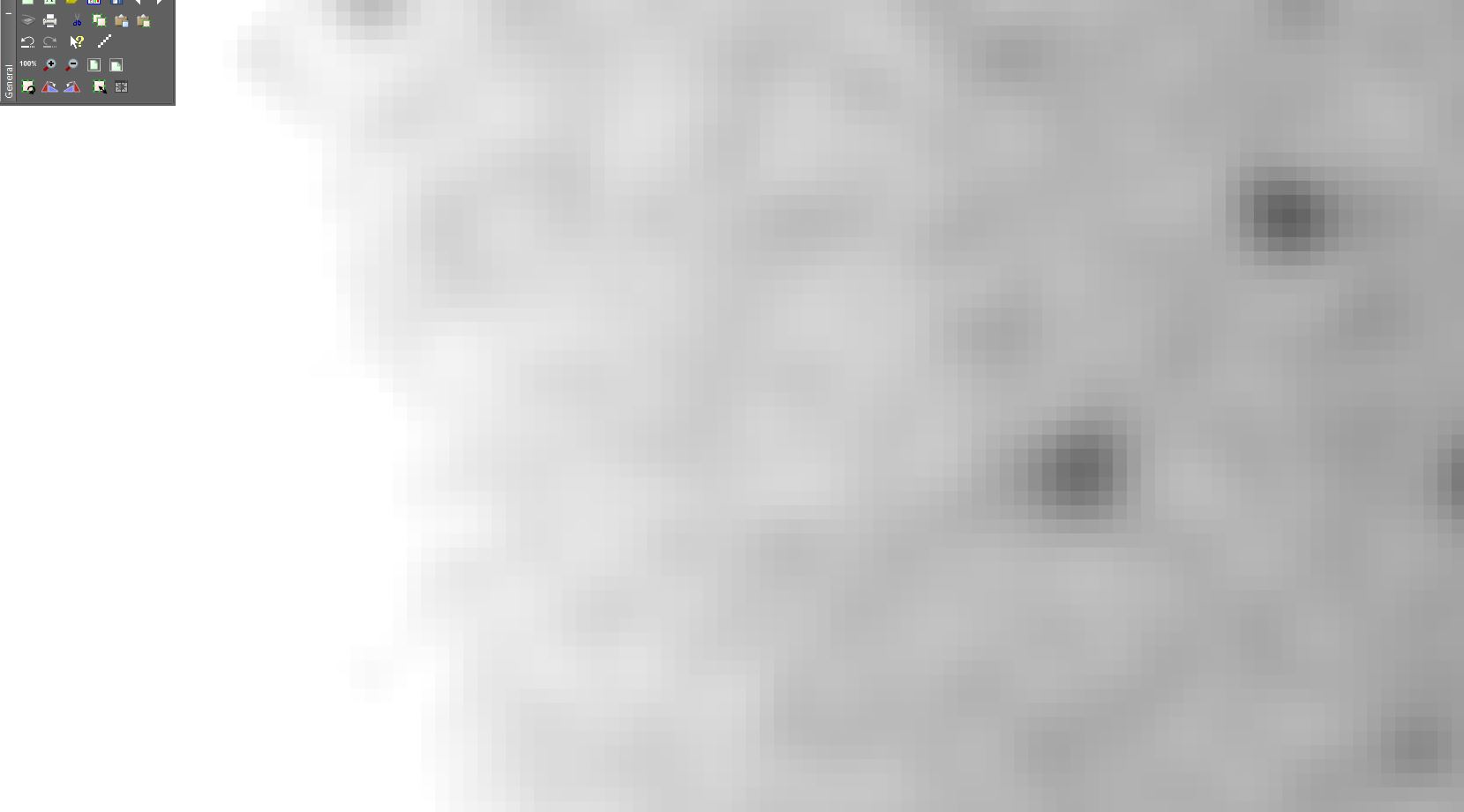

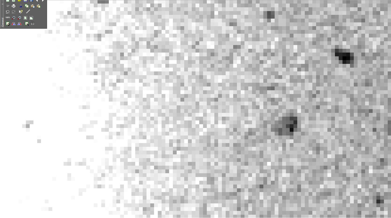

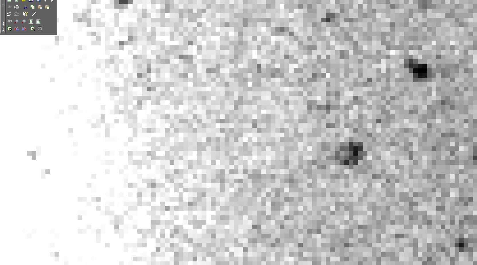

Next I show four images. They are taken from a zoomed in portion near the middle of the slide, the exact same region in each case. I am showing them in the following order. 1) A 16 bit scan, 2) the other 16 bit scan, 3) the 8 bit scan altered after being converted to a sixteen bit image, and 4) the same 8 bit scan left as an 8 bit image. If you look really carefully you might notice some very subtle differences between the images, but the differences are very hard to see. (Note: you will see absolutely no difference between two versions of the 8 bit scan, the original version or the version that was converted to 16 bits.) For shorthand I am going to refer to these four images collectively as Group 1 images, and they form a starting point for what follows them.

2022-03-12-0010 - 8 bit converted to 16 bit zoomed in and blurred and histogramed.JPG
So what does all this mean? It means that if your scan shows grain structure then you don't need more bits in order to capture all of the pictorially significant information in the image. However, if doing extreme image manipulation it can be beneficial to convert the image to a wider word, such as from 8 bit to 16 bit form, before doing any image manipulation.
In an effort to minimize subjectivity and maximize objectivity, here are 8 and 16 bit scans of two different step wedges. One step wedge is at 0.05 log increments over 41 steps and is roughly 2.05 log total density range, about what you'd expect for a "normal" bw negative. The other is 0.1 log increments over 41 steps for a total of 4.1 log density range. Each has been scanned to a raw DNG in both 8 bit scanning mode and 16 bit scanning mode on an Epson V850Pro and with Vuescan.
The file is here: http://m.avcdn.com/sfl/8vs16bit_step_wedges_revised.zip
Anybody can pull it down and do anything they want with the files to test things out for themselves.
A few observations:
I was demonstrating that with the correct workflow you don't get banding when doing an 8 bit scan. The possibility of banding is the usual reason for recommending a 16 bit scan over an 8 bit scan if extreme image manipulations are to be performed on the image after scanning. That is why I focused on that issue.
Actually, you want to scan with 16 bits not really to avoid banding (that is one reason, but not the primary reason), but to get more dynamic range. Plain and simple. Take the 8 bit and 16 bit scans of either of the step wedges and overlay them over each other, then toggle between them. It's painfully obvious that the 16 bit scan is capturing more dynamic range and more discrete tone values than the 8 bit scan, even when viewing both with an 8 bit display. Even with the step wedge that is 2.05 density range, which is well inside what 8 bits should be able to capture. The bottom 3-4 bits is enough noise and such that you just don't get that many usable discrete tone values with an 8 bit scan.
This also translates to a superior 8 bit file if scanning at 16 bits then saving at 8 bits, especially if saved in a color space that has gamma encoding, so I'd be leery of saying an 8 bit scan is all you need. If you want to save your files at 8 bits, feel free to, though, if you're going to be doing a lot of edits or manipulations, it's best to have the 16 bit data, especially if doing color work. Black and white is more tolerant and posterization and banding won't show up as quickly, but if doing color work, 8 bit falls apart pretty quick.
After compression (lossless of course), the size difference between 8 and 16 bit tif files isn't that large, so there's almost no practical impetus to save at 8 bits, as it doesn't cut your disk usage in half if you use compression when saving the tif files.
The file is here: http://m.avcdn.com/sfl/8vs16bit_step_wedges.zip
A few observations:
Hi Adrian, Something is wrong with your 410 tiff files. Both are 16 bits, so I have not attempted to evaluate the 410 files.
So I had a look at the 205 files. As far as dynamic range in these files is concerned the question is whether one can distinguish between the steps over the entire range of the step wedge. As shown below, the steps are well-distinguished at both ends of the range for both the 8 bit and the 16 files.
I am attaching files demonstrating this. First I will compare the steps at the dark end of the 205 step wedge, which is more challenging end. The first thing I did was to convert the 8 bit tiff file to 16 bits. This is in accord with the workflow I have specified throughout this discussion. Then I did histogram correction to the dark end of the two files. The amount of histogram correction was almost but not quite the same for the two files. I gave them enough correction to distinguish step number 41 from step number 40 while at the same time making the gradient was almost the same between the 8-to-16 bit file and the 8 bit file. Here are the images, starting with the 8-to-16 bit file.
The 40th step is definitely distinguishable from the 41st step in both cases.
Next, I do the same thing for the light end of the step wedge.
Again, the steps are well-differentiated at this end of the step wedge.
There's no need to do this for the middle of the step wedge because those steps are distinguishable without fiddling with the files further.
The upshot is that as far as the dynamic range is concerned, there is no evidence in these two files that there is more dynamic range in the 16 bit file than in the 8 bit file.
Note: I didn't try this experiment on the 8 bit file without converting it to 16 bits first because that would violate the workflow that I have specified.
... After compression (lossless of course), the size difference between 8 and 16 bit tif files isn't that large, so there's almost no practical impetus to save at 8 bits, as it doesn't cut your disk usage in half if you use compression when saving the tif files.
I actually tested this idea on one file and reported the results in post number 65 of this thread. The 8 bit scan reduced by 35.8% upon compression. The 16 bit file increased in size by 15.5% upon "compression."
I decided to do the same thing with your 205 files step wedge tiff files. I loaded both into photoline. There are several lossless compression options to save tiff files from photoline. Who has time to try them all? So I tried the first compression format in the menu, which was LZW-packed. Here are the results. The 8 bit tiff went from 344 KB to 87.7 KB. The compressed file is about 25% the size of the uncompressed file, a very useful amount of compression. Most likely it did well because there is very little detail in the step wedge file. The 16 bit tiff went from 674 KB to 486 KB. The compressed file is about 72% of the uncompressed file. That's a useful amount of compression, but not all that impressive compared to compression of the 8 bit file. The compression for the 16 bit file was about three times worse than the 8 bit file. Looked at another way, the sized of the compressed 8 bit file only 18% that of the compressed 16 bit file, and the 16 bit file does not contain more useful pictorial information than the 8 bit file (assuming one can even use the term "pictorial" in reference to a step wedge.)
