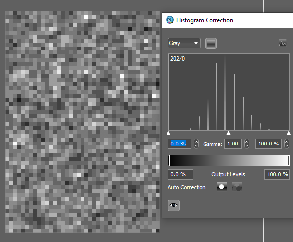

I'm following up on my posts last month discussing 8 bit scanning. I said that if you can see grain in an 8 bit scan then there is basically nothing to be gained by scanning at a higher ADC resolution, such as 16 bit. I discussed this in the context of whether banding would show in the scan.
Today I did an experiment. I scanned a tmax 100 negative using my canon fs4000us scanner and saved the scan in 8 bit mode. I opened the file with photoline and converted the image to 16 bit mode.
I cropped out a very small section selected from a dense featureless region of the negative. (It was a featureless sky region.) There was no gradient in the negative in that region. I then used the histogram correction feature to zoom in on the horizontal axis of the histogram sufficiently to see the digitization step size. I am attaching a photo that shows that small part of the image and the the histogram. (Note that the "grain" looks exaggerated in the image because I zoomed the horizontal scale of the histogram. This is for display purposes and also to make it easy to pick of the values from the peaks. It doesn't change anything in a fundamental way.)
Note that there are several peaks in the histogram. Treating the histogram as a probability distribution, I picked values from the histogram and did some statistics. The standard deviation worked out to be 1.64 digitization steps. That standard deviation is more than sufficient to eliminate the possibility of seeing banding.
Please note that I used rodinal for developing this negative. This implies that the grain will be somewhat greater then if I had used a low-grain developer. However, based on the result in this experiment I am pretty confident that even a low-grain developer will leave enough grain to eliminate banding in an 8 bit scan. Most negatives will be grainier than tmax 100. For an ultrafine grained image using, for example, microfilm filmstock developed in a pictoral mode it might be possible for the grain structure to be so fine that banding might be possible in an 8 bit scan. Slide film might also be a different story in some cases, though I couldn't say one way or the other. However, for normal black and white negative film stocks I'm pretty sure that 8 bit scanning is sufficient. However, be sure to convert to 16 bit before doing any image manipulation.
