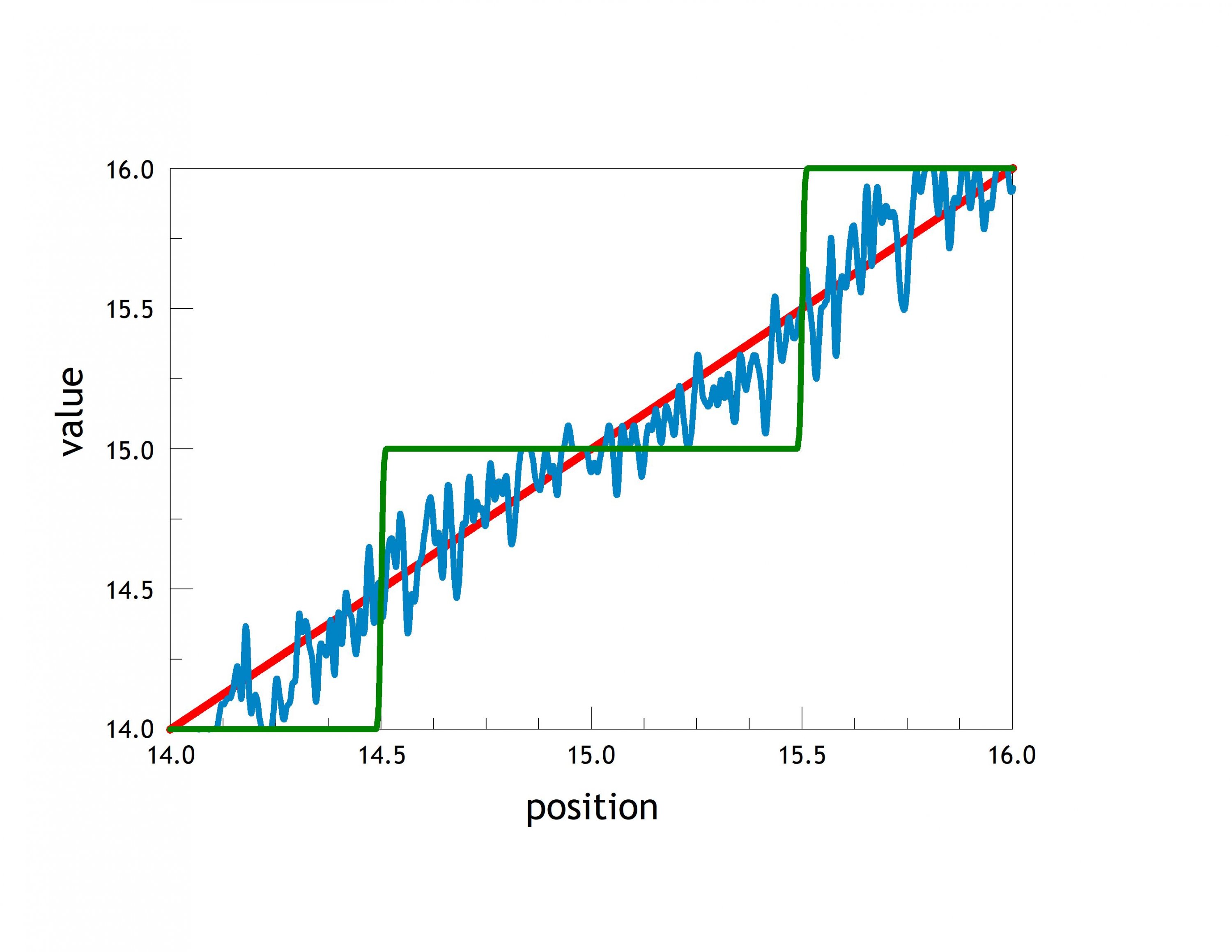

I mentioned earlier that a standard deviation of the noise due to grain of 0.33 is enough to eliminate banding in perceptual terms. (This value of 0.33 is scaled with a digitization step size of 1.) Even a standard deviation of 0.25 will be enough to pretty much eliminate banding as a practical matter. I am posting a figure of a simulation I did of a smooth linear gradient with noise added having a standard deviation of 0.25. I then digitized the smooth gradient producing a stair step pattern, i.e. banding, and the noisy gradient. I smoothed the all of the results for presentation purposes. The smoothing wasn't enough to eliminate the stair step pattern in the digitization of the smooth gradient. It simply rounded the steps slightly near the step transitions. As you can see, in the noisy signal the stair step pattern is gone, leaving a somewhat noisy but other was nearly smooth gradient. Other than the noise, there is just hint that the gradient is not perfectly straight, but because there are no hard transitions and only relatively small changes in the slope, the deviation from a perfectly smooth gradient is probably not enough for anyone to notice.
The smooth noiseless gradient is in red. The stair step pattern resulting from digitization of the smooth gradient is in red, and the digitization of noisy gradient is in blue. (Reminder, I smoothed each curve by the same amount, which is why the noise does not appear as one-bit increments in the noisy curve.) Please note, there are 1000 points for each step in this simulation.

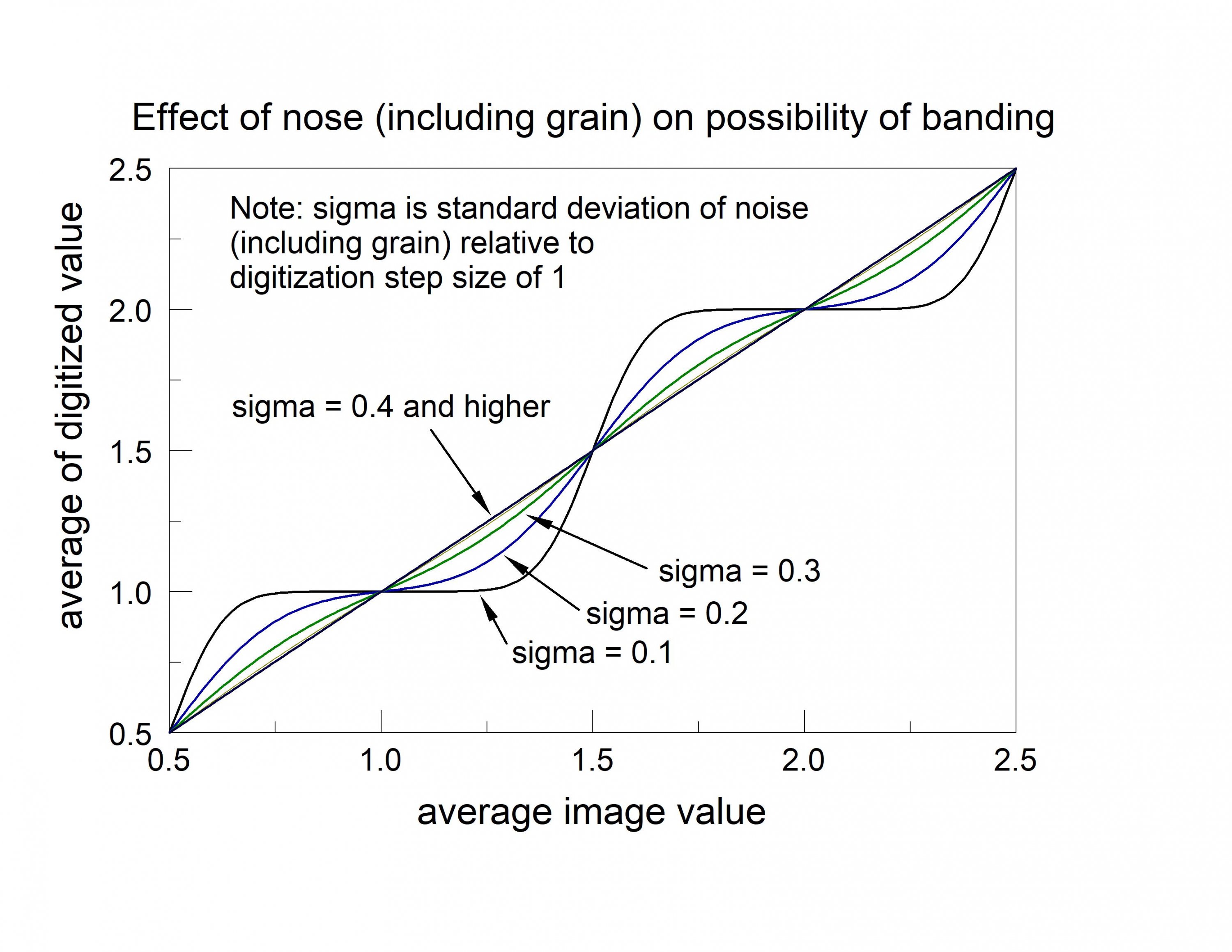

I've done a little more theoretical work on this problem, summarized in this graph. It shows how noise (including grain) affects the possibility of banding. This assumes that the image is grainy, and that the other sources of noise of whatever source are lumped together with grain in the scan.
The noise, including grain, is characterized by standard deviation (denoted by sigma in the graph), and it assumes a digitization step size of one. For example, if sigma is 0.1 it means that the standard deviation of the noise is equal to one tenth of the digitization step size.
The values on the x and y axis are averaged values, e.g. averaged over the grain.
As you can see, when sigma = 0.1 the steps are significantly rounded in going from one step to another. Banding will be seen, but the edges between the steps will be softened rather than abrupt.
For sigma = 0.2 the steps are no longer level between step transitions. In other words, the gradient is starting to smooth out everywhere, but the gradient is still a bit wavy.
For sigma = 0.3 the waviness in the gradient has mostly gone away. It seems likely to me that a viewer will see this as a smooth gradient and likely will not notice that it is not perfectly smooth.
For sigma = 0.4 and higher the gradient has become, for all practical purposes, perfectly smooth. there are actually two lines in the plot for sigma = or > 0.4, namely sigma = 0.4 and sigma = 0.5. They overlap on the plot to less than the width of the line.
To put it in a nutshell, by the time sigma = 0.4 relative to the digitization step size (which is only a relatively small amount of grain relative to the digitization step size) there will be no perceptible banding in the image. Thus, if there is grain visible in an 8 bit scan it will be enough to suppress the possibility of banding. To assure that this holds after extreme image manipulation one should be sure to convert an 8 bit scanned image to 16 bit before manipulating the image in photoshop or other image processing software.
By the way, it is my understanding that when converting in the other direction (16 bit to 8 bit) photoshop normally adds a little bit of noise (dither) in order to suppress the possibility of banding resulting from that downshift in the bit depth. However, that doesn't concern us here, since we are discussing a different process.
Also, what I am discussing here are images that start with some noise (such as grain) or in which noise is added during the creation of the digitized version of an image (such as electronic noise in a scanner). It may or may not apply to images created by other means, such as a software-based image creation, or possibly a natural scene acquired using a low-noise digital camera.

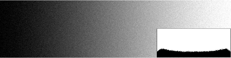

I found a website that demonstrates what I have been talking about in a slightly different way. It relates to how scanning with a low bit depth (e.g. 8 bit) can still be just fine and won't result in banding if there is some noise (including grain) in the image.
Here's the link.
https://homes.psd.uchicago.edu/~ejmartin/pix/20d/tests/noise/noise-p3.html
First a little bit of explanation or background info. In my most recent post I presented the concept in the form of a graph. (For presentation purposes noise is removed in the graphs to show the underlying gradient or stair-step structure, without the noise showing up in the figure.) The link above presents the concept in a more visual form.
The context of the link is slightly different. The author of that web page presents it in the context of how noise, such as sensor noise, affects an image captured by a digital camera, whereas my discussion is presented in terms of how grain affects a scanned image. However, the underlying principles are the same.

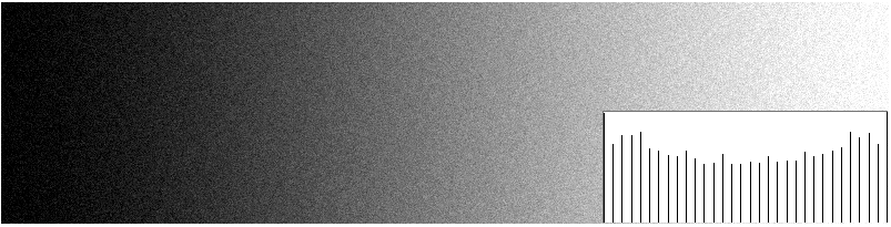

Here's a copy of the first image from the link. It is a smooth gradient artificially generated in photoshop in 8 bit mode. Note that the gradient appears smooth and noiseless.
The histogram of the image is shown n the inset. Note that the histogram is not perfectly smooth. This is probably because photoshop put in a tiny bit of noise when it generated the gradient so that banding won't show up if extreme image manipulation were to be performed later. For our purposes we can ignore that small detail and assume that the histogram is perfectly smooth.
Here's the same image with some noise added. For comparison purposes to my graph the amount of noise would be equivalent to sigma=1.46. I didn't include a trace in my graph for sigma that large. (I only went up to sigma=0.5), so this amount of noise is actually more than I simulated for that graph. However, it's comparable to the sigma that I extracted from a tmax scan discussed in an earlier post.
The next image is the same as the last one except that the bit depth has been decreased from 8 bits to 5 bits. This was done by truncation of the lower order 3 bits. This is not quite the same as rounding to the nearest step, but for our purposes we can ignore that subtle issue.
The two images are, for all practical purposes, indistinguishable, in accord with the point I have been making that if grain is visible in an 8 bit scan then there is virtually nothing to be gained by going to a 16 bit scan.

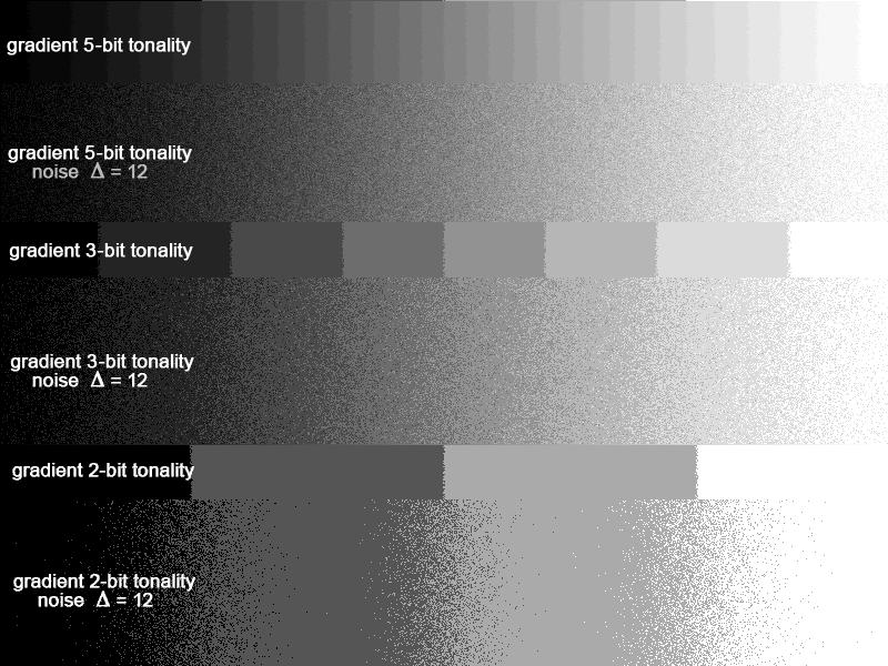

The next image is a composite one showing what happens when the step size is increased, i.e. the digitization bit depth is decreased.
The top sub-image shows what happens when the smooth noiseless 8 bit gradient is converted to a 5 bit gradient by truncation of the lower three bits. This is similar to what would happen if you digitized a perfect gradient using a 5 bit word. Banding is strong. This is basically a repeat of information shown earlier in this post.
The next sub-image down shows what happens when noise is added before the conversion to a 5 bit word length. This is basically similar to what would happen if the gradient were digitized with a 5 bit word, and it is also essentially a repeat of what was shown earlier in the post.
The next sub-image shows what happens if the perfect gradient is digitized with a 3 bit word. There are fewer bands, but they are more distinct than the bands digitized with a 5 bit word.
The next sub-image shows what happens to the noisy version of the gradient after it is digitized with a 3 bit word. This one would be equivalent to the standard deviation of the noise being equivalent to 0.32 relative to the step size of the 3 bit word. This is pretty close to one of the traces in the figure I posted in my previous post (sigma=0.3). Banding is still pretty much negligible, meaning that it is not evident to the casual observer. It's unlikely that it would even be noticed to a careful observer unless it were compared to a better result in a direct A to B comparison or unless one already know what to look for. A careful comparison reveals that the noise is a little higher in the part of the gradient where step transitions would occur when digitizing the perfect gradient, and noise is a bit lower in between those regions. My impression is that the noise might be a tiny bit higher overall, but I couldn't say for sure.
Finally, we see the results of digitization with a 2 bit word. Banding is is very strong and broad in the second to last sub-image which derived from the noiseless gradient. Banding is also strong in the last sub-image, which was digitized from the noisy gradient. However, the transition region between the bands is softened by fairly steep but noisy and fairly narrow gradient regions. This one is comparable to sigma=0.14, which is intermediate between two of the traces in the figure in my last post.
Anyway, hopefully this give everyone a better intuitive feel for how noise (or grain) can provide a dithering function that can suppress banding. Please not that when scanning film it is not necessary to add noise to accomplish dithering. In most cases the noise will already be there through the combination of film grain, sensor noise, and electronic noise.

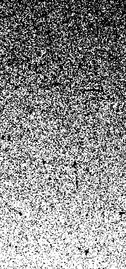

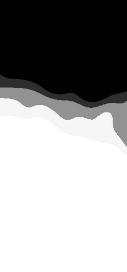

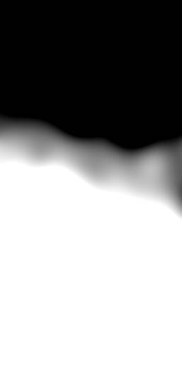

Here's a bit more on the 8 bit/16 bit discussion.
In my scanner I selected a region of almost featureless sky in a negative and scanned it. I say "almost featureless" because there is a slight gradient in the sky. There is also a fair amount of dust on the negative, but that's not important for this demonstration. I scanned in 8 bit storage mode.
I loaded it into photoline for manipulation. First I did an extreme gaussian blur followed by an extreme histogram correction. The extreme blur was to smooth out the grain so that it resembled an 8 bit grainless original, and the extreme histogram was intended to produce banding. Here's the result.
As you can see, I succeeded in producing banding, which is what I thought would happen.
Next is the result of loading the same 8 bit file into photoline, converting to 16 bit, and then doing exactly the same thing as I did to the first image. Here's the result.
cropped 8 bit sky converted to 16 bit then extreme blur then extreme  manipulation.jpg
As you can see, there is no banding. This demonstrates that if you have enough grain in the original image (and it doesn't take much grain) then scanning in 8 bit mode will not produce banding, provided that you are careful to convert the 8 b it scan to 16 bits before performing extreme image manipulation.
The next image is the same original 8 bit scan followed by conversion to 16 bits and then the same histogram manipulation as the other images. (There was no smoothing applied to this image.) The intent is to illustrate grain in the image. When I say "extreme histogram manipulation" I mean that I sliced out a 1% section from the histogram (81% to 82%), which I think would be considered extreme manipulation by any reasonable standard. The extreme histogram manipulation was the same for all images in this post. Note the complete absence of even a hint of banding, even under this extreme degree of manipulation.
So hopefully this settles the issue of whether 8 bit scans are good enough, at least in cases where there grain shows up in the scan.
