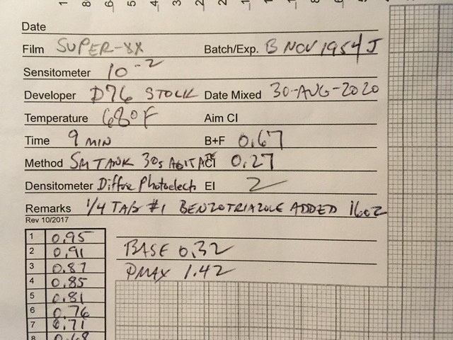

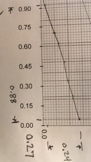

Can you show us the film curve?
This is what I got from my first roll (I bought one 20-exp roll before I bought the bulk roll)
Some elevated fog, not terrible. Process gamma is 0.88?
Gonna try D76 1:1? I am sure you know 0.65 gamma is "normal", but do you like the extra contrast?
It does have a grey base; right?
Edit: Oh I see; .88 density range. Looks like a pretty steep curve and I see no evidence of a toe or a shoulder. What did you rate it at? If you rated it at 250, it looks like it has decreased in speed quite a bit.
Provided I am reading your plot correctly...
I think he has the H&D curve on its side. Also, just a guess, that most of the steps are clear, due to the slow speed, so only the toe shows. I was actually interested in the whole tonal range. Maybe blast it a few times with multiple pops of the strobe to fill out the curve. That is what I have done with the E.I. 6 film I had a few years ago.
It’s sideways, the toe is lost in fog (about 0.4 fog). But it’s a nice straight line as far as I got, the fully exposed piece of leader reached 1.42 density that makes me think the straight line continues. I will see what happens when I hit a test from the bulk roll full blast.

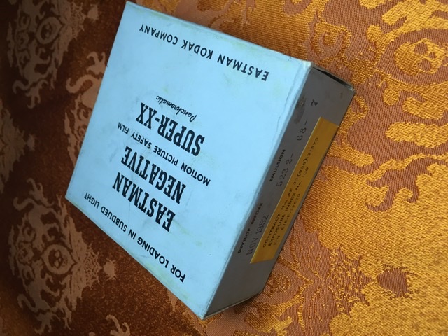

I just got five 4x5 Tri-X filmpacks some dated 1983, some dated 1976!
And a 4x5 filmpack of SuperXX dated 1953.
This is going to be fun. I love using filmpacks. Shanghai should reintroduce them with 400 GP3
Film packs are great. Needing special equipment to process the film isn't so much. Pack film is full glass plate size (i.e. actually four inches by five inches in 4x5), instead of undersize by the thickness of a film sheath. It won't fit in our standard 4x5 tanks, scanner carriers, etc. No to mention needing a film pack adapter (which, though generally cheap, are pretty much gone from eBay by now).
I have three FR 4x5 film tanks that need to be dusted off. The corners always chip off but I have rebuilt some of mine. And two 4x5 pack film holders. There are zillions on Ebay.
I remember reading that Kodak Super-XX can be many decades over expiration, still works great. You can burn through a lot of dichroic fog and the negs still print in an exquisite manner.
Maybe not so the Tri-X, we will see. I have fond memories of shooting old expired Tri-X filmpacks twenty five years ago and it was all good at the time. Fred Picker of Zone VI fame liked Tri-X filmpacks. There is a curl along one edge that causes that outer strip to be out of focus. Fred marked his groundglass
