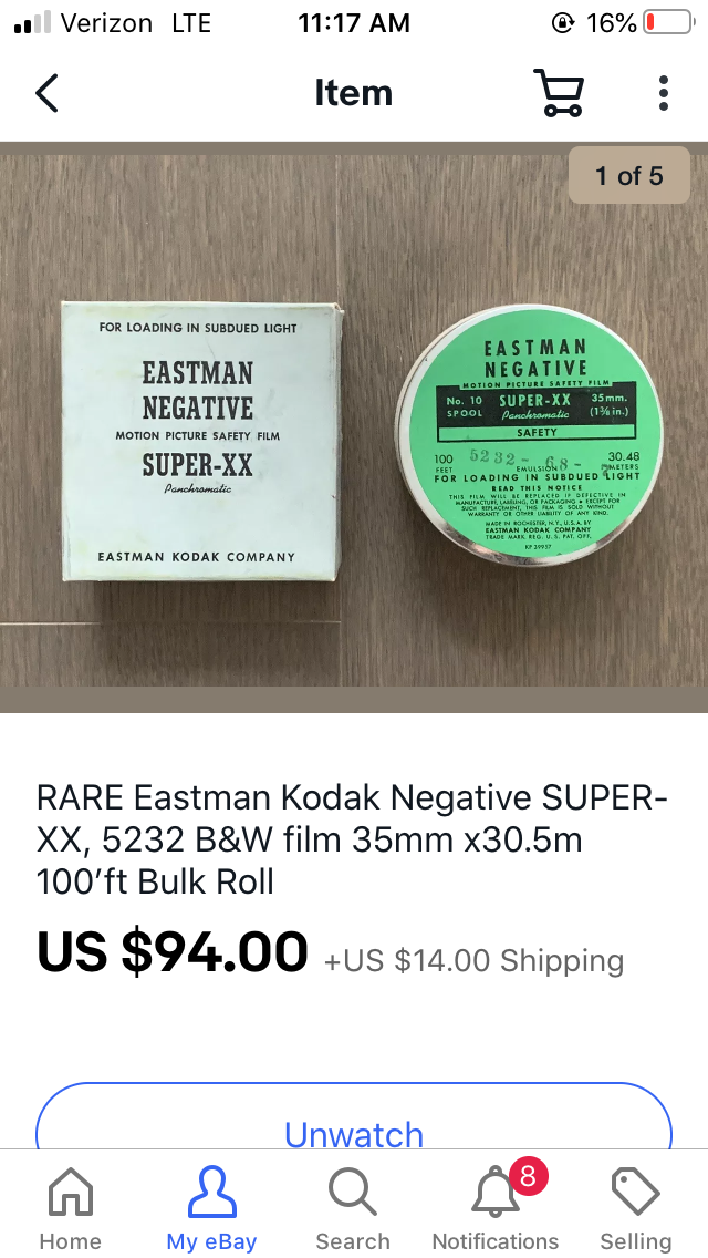

I've been experimenting with some old film and found one that gives me a film speed of 2 (4 if I push) and the grain is somewhere between Tri-X and Plus-X... There's a bulk roll of it out there that I have permission from my wife to buy.
But I was wondering... Should I? What good would it be? Best I can imagine is that I could get waves and flowing water wide open, and with prominent grain. It might be fun.
Or should I buy a fresh 200 speed film and get the benefit of the higher film speed?

15A9CBD7-5FB7-48D1-9736-91C4A4198BCF.png Got it! Seller even reduced the price. Thanks for the encouragement. Indeed I use Benzotriazole. It will be fun learning the ins and outs of fog reducing techniques. One of my meters only goes down to 3. I have seen 2 and 4 with the old roll I am shooting now so I will try to find the magic bullet that gets me to 3

Nice. You may be surprised on what the effective speed is. That's only a little over 50 years old, by rule of thumb it ought to be closer to EI 16, and if it's been well stored it might be a stop or more faster than that.

Expires 1954 so near 70 years. Guess that makes EI of 4 to be expected.
Still it looks like this was frozen or otherwise well cared for. So I will welcome a little surprise.
