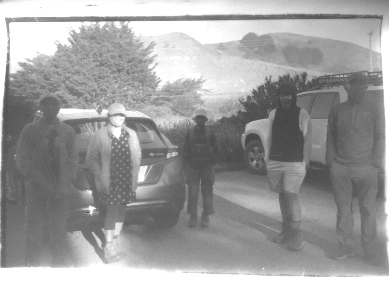

I’m getting close to usable results from my 70 year old Super-XX.
About 2 1/2 minutes in Dektol stock. Cold... 50-degrees F. No special reason to develop it cold besides slowing it down.
Fog is about 0.96 and CI is about 0.30. Next time I am going to develop a little more.
EI is about 2.
I developed by inspection using infrared.
But I am considering developing by traditional green safelight. I think it won’t raise the fog enough to affect image.

Jay DeFehr is getting good results with his JD-50 (DK-50 equivalent) and some old film of similar vintage.
So I am going to see if I can pull off results like he's getting.
Here’s the best so far. I am going to try R09 next to see if I can bring down the fog a bit.
