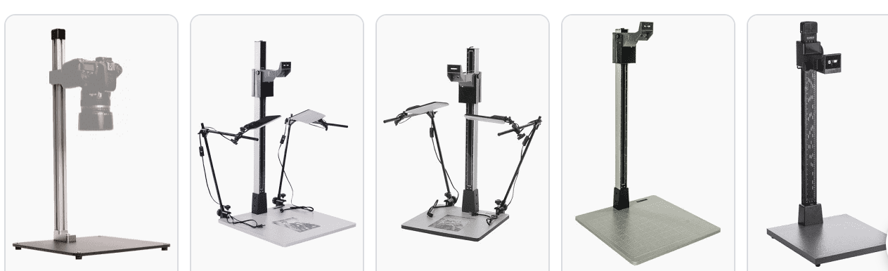

If you've got a DSLR or equivalent a decent macro lens, then a copy stand is what you're looking for. Don't know how well it would work for digitizing prints-- for that, I'd normally use my V800. I would guess a light box with diffuse lighting would allow you to take available light photos.

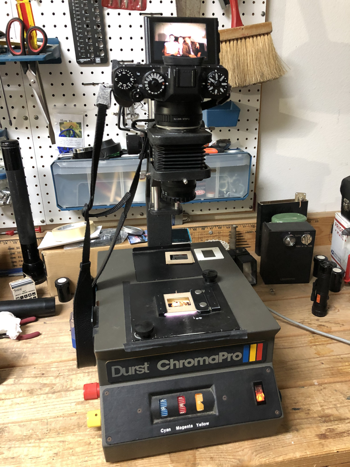

Do you have medium format film to scan?
How many frames of film are you potentially going to scan?
For 35mm, I use the autobellows from Pentax and Nikon but that's ideal only if you have fullframe cameras of those mounts. Bonus is that you can use relatively cheap manual focus macro lenses. This is the fastest and easiest way. The camera and target film are always perfectly aligned. Any movement will not affect it. Setup is super quick and moving frames across is a breeze. SLides you just pop them in one at a time.
K20D_50mm Macro_AutoBellows by Les DMess, on Flickr
Just to be sure, a DSLR scan is fastest for true b&w film. Very minimal post work and dust and scratch removal done in post same as scans.
DSLR scan with slides can be faster because again post is very minimal. However, add dust and scratches and the time can change even drastically.
For instance, this is very old Kodachrome and the dust and scratches did not come off even with many passes through antistatic cloth and even some safe cleaning fluid. It would have taken me many many minutes to clean this in post. The Coolscan only takes about 50 seconds and the Epson V850 is stated to take less than 3 minutes with ICE.
Kodachrome D800-Coolscan by Les DMess, on Flickr
Incidentally, the higher resolution the camera the more you will see dust and scratches that you may not have noticed before.
DSLR scan of color negatives now imposes color conversion on top of dust and scratch removal. Unless you have the Nikon D850 which apparently has a built-in color conversion - which I haven't tried yet. In this example I tried to manually do it and even with the scanned image as a reference - and many minutes of post work, I still could not match the colors from the scan. Then of course the dust and scratch removal. I can't even imagine how long it would have taken me to get results that clean.
Kodak 160VC-06-36 K20D vs 9K ICE by Les DMess, on Flickr

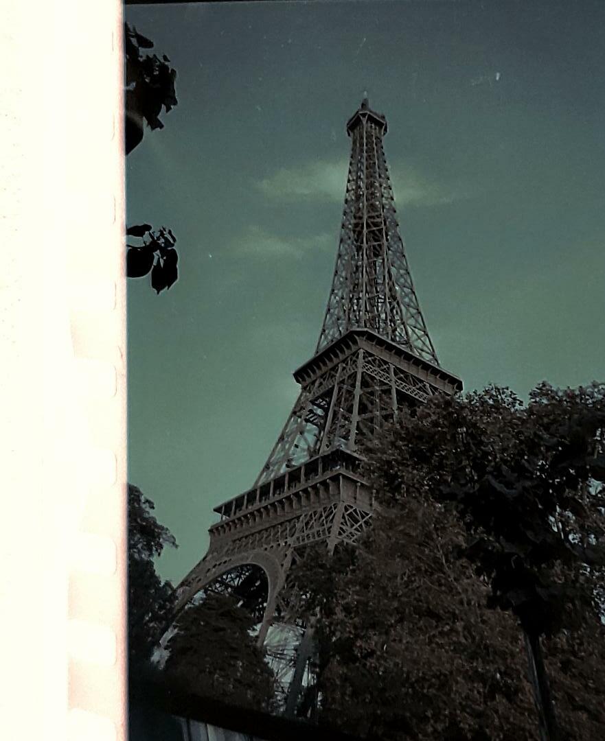

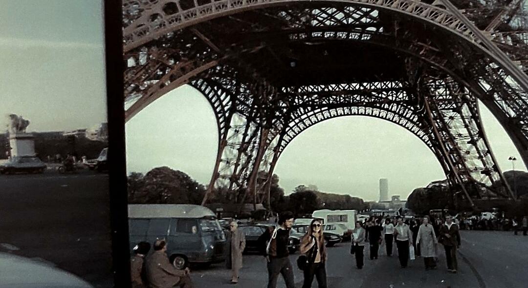

Wonderful it works quite nicely. Please see the photos (without post-editing) attached, taken by me in Paris long time ago.
I hold my Samsung Galaxy S9+ smart phone by hands to capture and using Samsung Tablet as light box. If I build a simple fixture for scanning the result, the quality of photos, would be even better.
2 years ago I also used this technique but without scanning software (pls see my #15 posting above). It also worked.
For quality photos, post-editing couldn't be avoided because of the quality of the negatives. Technically mass post-editing on photos is possible. But for quality it needs post-editing the photos individually (one by one).
I'll run "Remote Desktop"(the technology) to capture the negatives remotely on a computer, just with a click on mouse. In such arrangement I won't touch the smart phone. creating un-necessary motion during shooting.
If finally I decide selecting this route to digitize my old film negatives, I would use the money purchasing a new Samsung Galaxy S22 Ultra smart phone to do the job, instead of Epson V850 Pro flatbed scanner.

If your pictures are all 35mm positives, then find an old Durst or other slide copier and use a digital camera to digitize. Fast, easy and pretty cheap (I found a Durst for $65 + $85 to ship). I digitize slides and B&W negatives with it. I do not have a good system for color negatives yet. I use enlarging lenses and adapters to the Durst (the Durst is M42, and that works for some enlarging lenses. I also have an M42 to M39 thread adapter).
With the Durst and positive images, once the picture is taken, you are done (unless you want to tweak contrast, color correct a little). For some old slides with color cast, the built-in dichroic filters can help correct.
