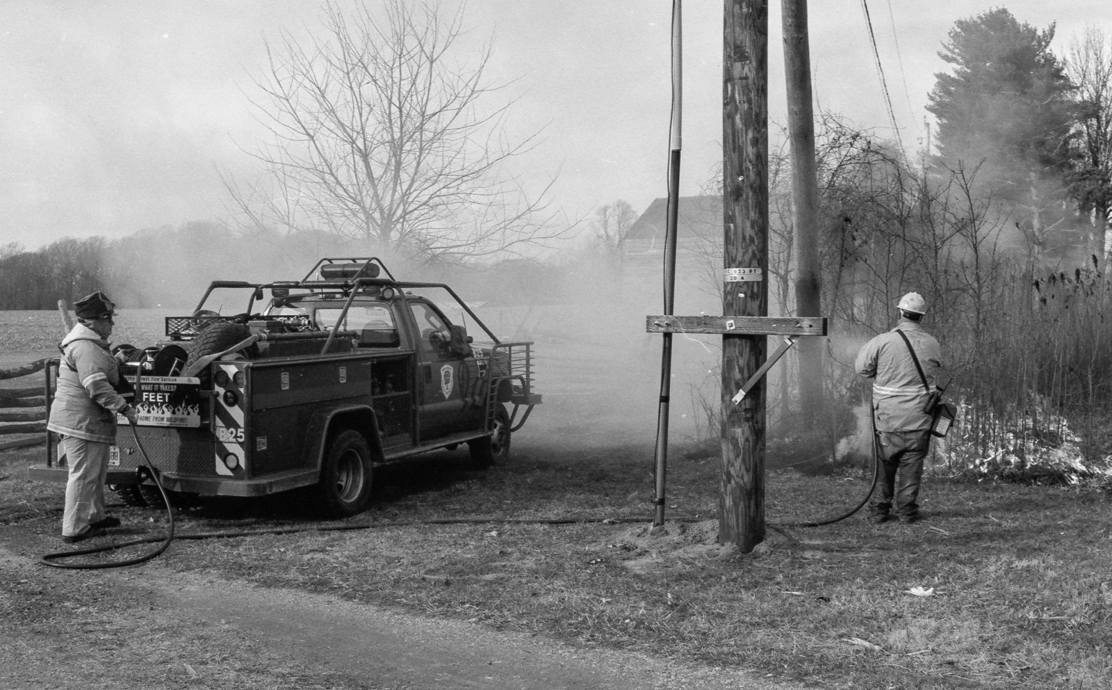

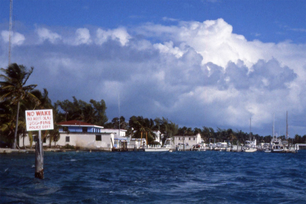

Samples of 35mm scans. The V600 runs around $225 and the V850 runs around $1150 but allows large-format scans as well as 120 and 35mm that's done on the V600. The dMax is a little better on the V850.
Epson V600 (various film stock):
https://www.flickr.com/photos/alanklein2000/albums/72157625526207614
Epson V850 (Tmax 400 only): https://www.flickr.com/photos/alanklein2000/albums/72157716777378896
