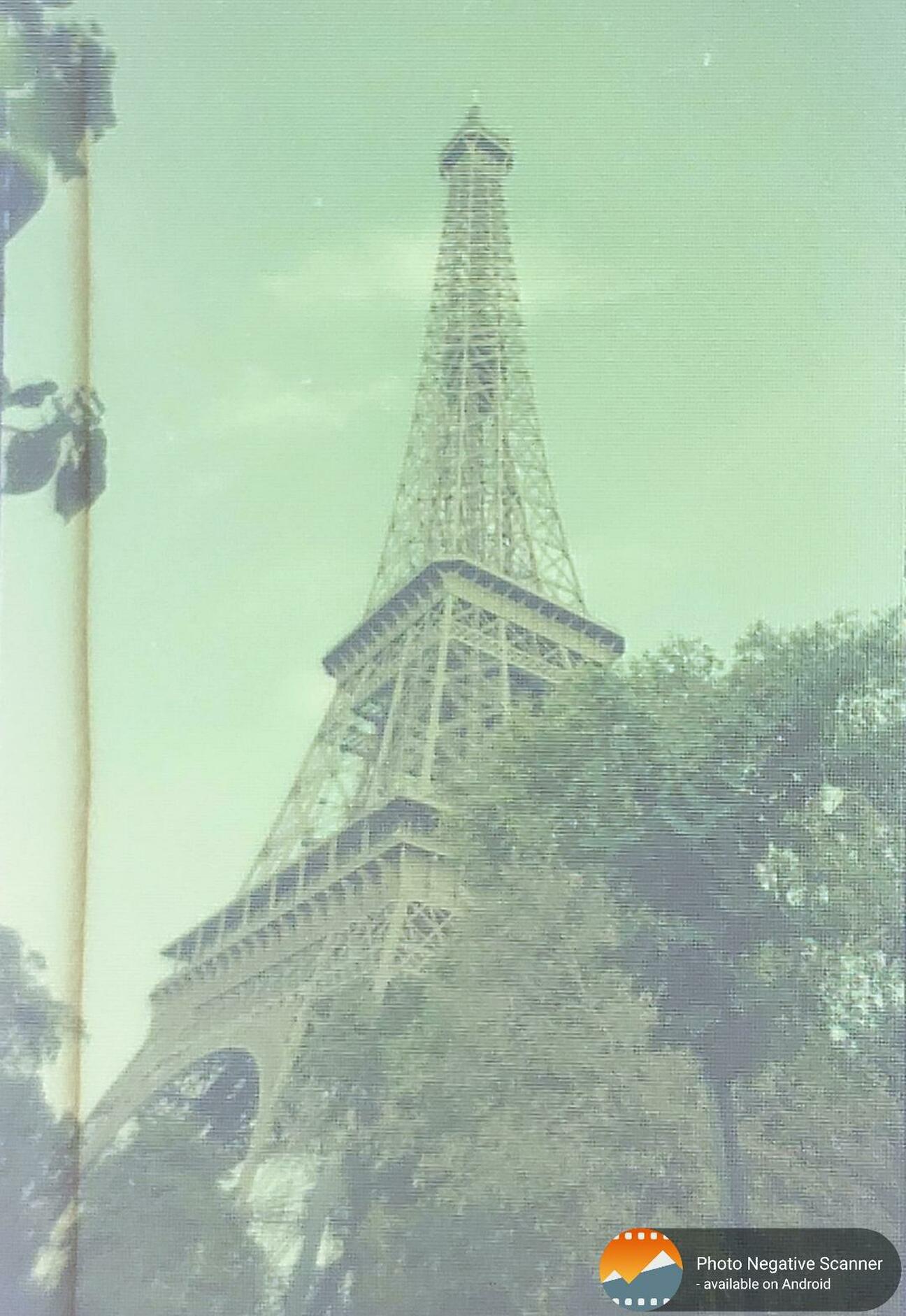

Performed further test, scanning film negatives on Smart Phone;
Smart Phone - Samsung Galaxy S9+
Scanning software - Photo Negative Scanner: View & Convert color film
Light Box - Samsung Tablet
Step 1
Start Photo Negative Scanner
Place the film negative strip on the Tablet
Hold the Smart Phone above, parallel to the negative, and take a shot
The captured negative file is directly and automatically converted to positive file after scanning
Step 2
Download the file to Computer
Step 3
Adjust Brightness and Contrast on GIMP
The photo quality is acceptable. Please refer to attached photo.
(Scanning Software:
Free Version - there is a water-mark on the right bottom corner
The pay version is without water mark)
I'll go this route - scanning film negatives on Smart Phone

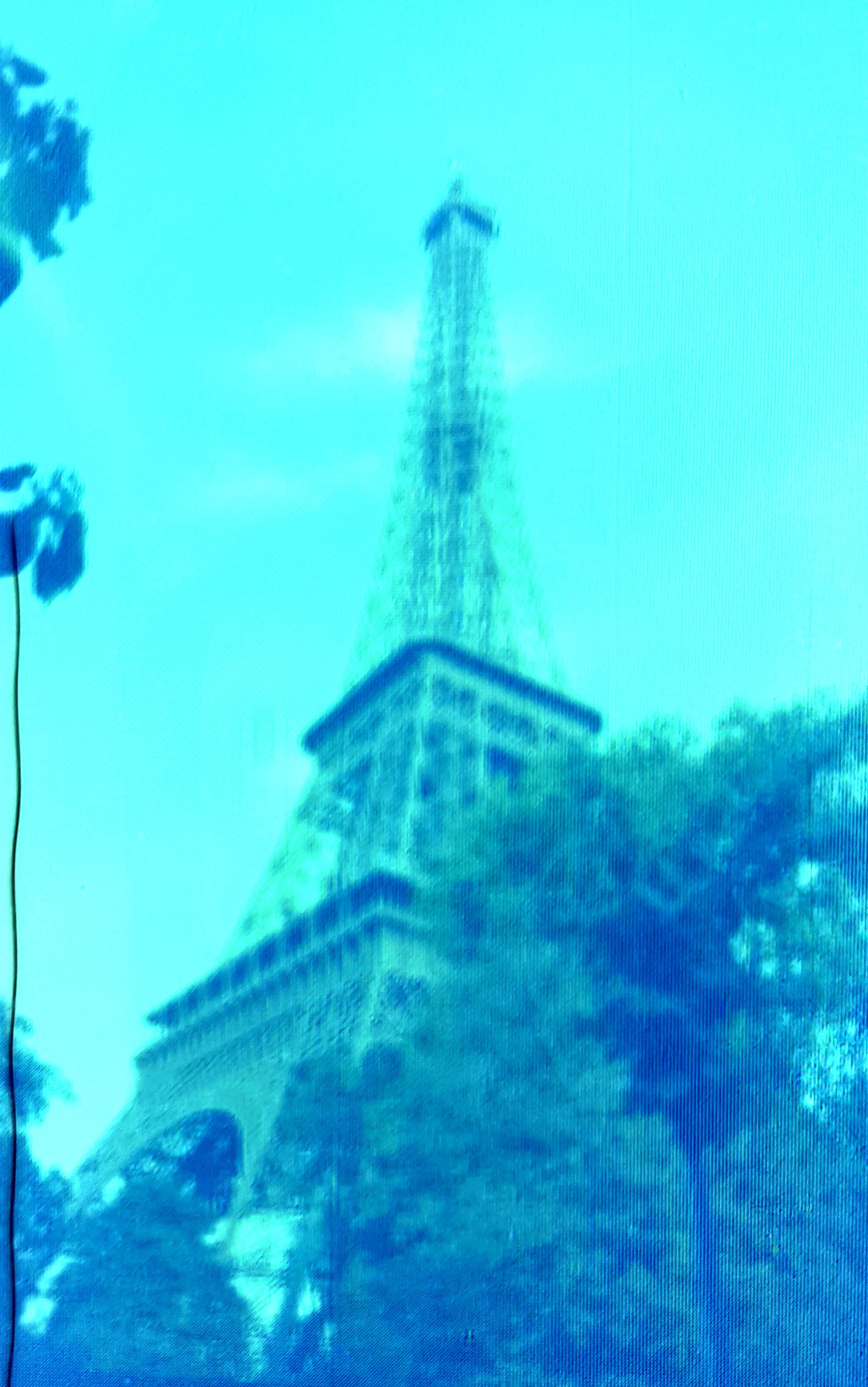

Performed another test, using an old Smart Phone without scanning software installed.
Smart Phone - Samsung Galaxy S6 (a very old smart phone >15 years)
Light Box - 10" Samsung Tablet
Steps:
1. Place film strip on Samsung Tablet
2. Hold the smart phone above and parallel to the Samsung Tablet to capture
3. Import the negative image to Ubuntu 20.04 PC (Linux PC)
After cropping the negative image
4. On Terminal run following commands;
(convert negative image to positive)
(rotate negative image 90deg, counter-clockwise)
Even without post-editing, such as brightness, contrast, Hue, RGB, Sharpness etc. the quality of the scanned image is not bad (pls refer to attached photo).
Actually we can use an old Smart Phone, without scanning software installed to digitize film negatives. The quality of the final photos/images is directly proportional to the knowledge on software, the experience on using the software and the time invested on post-editing.
Regards
