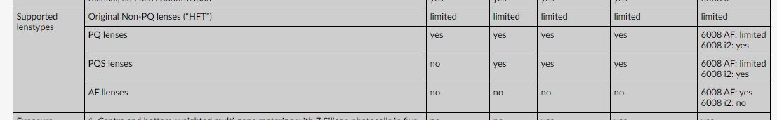

Since 6008AFs are so hard to find, I may have to settle for an integral. Do you know if the AF lenses can be used as manual focus lenses on the 6008i?
[edit] This chart seems to say that AF lenses can't be used on 6008i/ii:

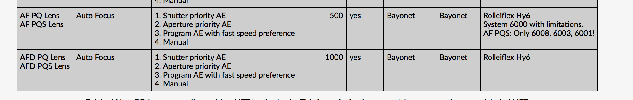

Here is another chart. I think that one above is meant to indicate there will be limitations in function.
I'm also noticing a high pitched chirp when using the AFD lenses on the 6008AF, so I'm going to stop doing this, even though the do fit and autofocus and seem to function OK in auto mode. Also, the shutter won't close when using the mirror up.
Thanks. That chart is better.
