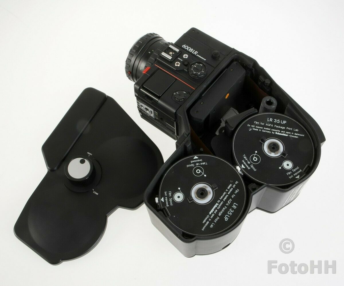

Totally off-topic, but I came across this today from the Rollei (Leica) shop in the Netherlands: A 6008 fitted with a 250-exposure back. I assume it is for 70mm film, but can't really tell.
I saw that too, they even have 2 of these listed (at a ridiculously high price, but expensive items are usual for Foto Henny Hoogeveen, although I wonder who would want an accessory supposed to work with an unknown film format...). They also list an old DSP 104, without the necessary accessories to make it work... what is strange about that film magazine is that 1. the 70mm film magazine for series 6000 is completely different (much more reasonably sized) 2. The rolls do say "for Agfa package print lab" (cannot find any information about what this is) and 3) "Made in Germany by Schneider-Dresden" - I suppose this means Pentacon? Schneider did own Rollei/F&H for a while so this could explain why this accessory even exists. If someone has a large amount of money to spend on that "thing", I'd be curious to have a closer look...

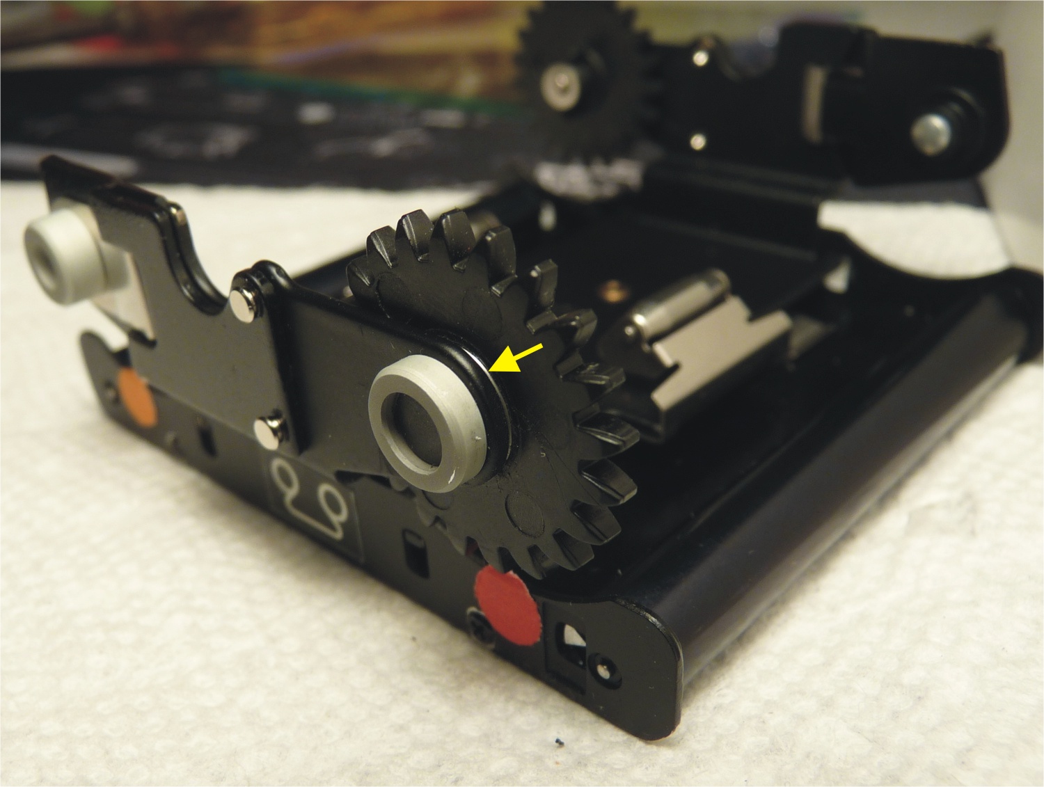

One thing I noticed about my film insert is that the gear on one side turns very hard in one direction while the gear on the other side turns relatively freely in both directions. As it turns out, the gear that turns easily in both directions has a metal washer, while the gear that turns hard (in one direction) has no such washer. Since, the insert is supposed to be symmetrical, I am guessing that both gears should behave the same way. To prevent any undo stress un the motor, I only use the insert in a way that the gear with no washer turns relatively easily (by mounting the spool with film on that side). Has anyone noticed differences in how easily the gears turn or whether there are metal washers between the gears and the frame (see pictures)?

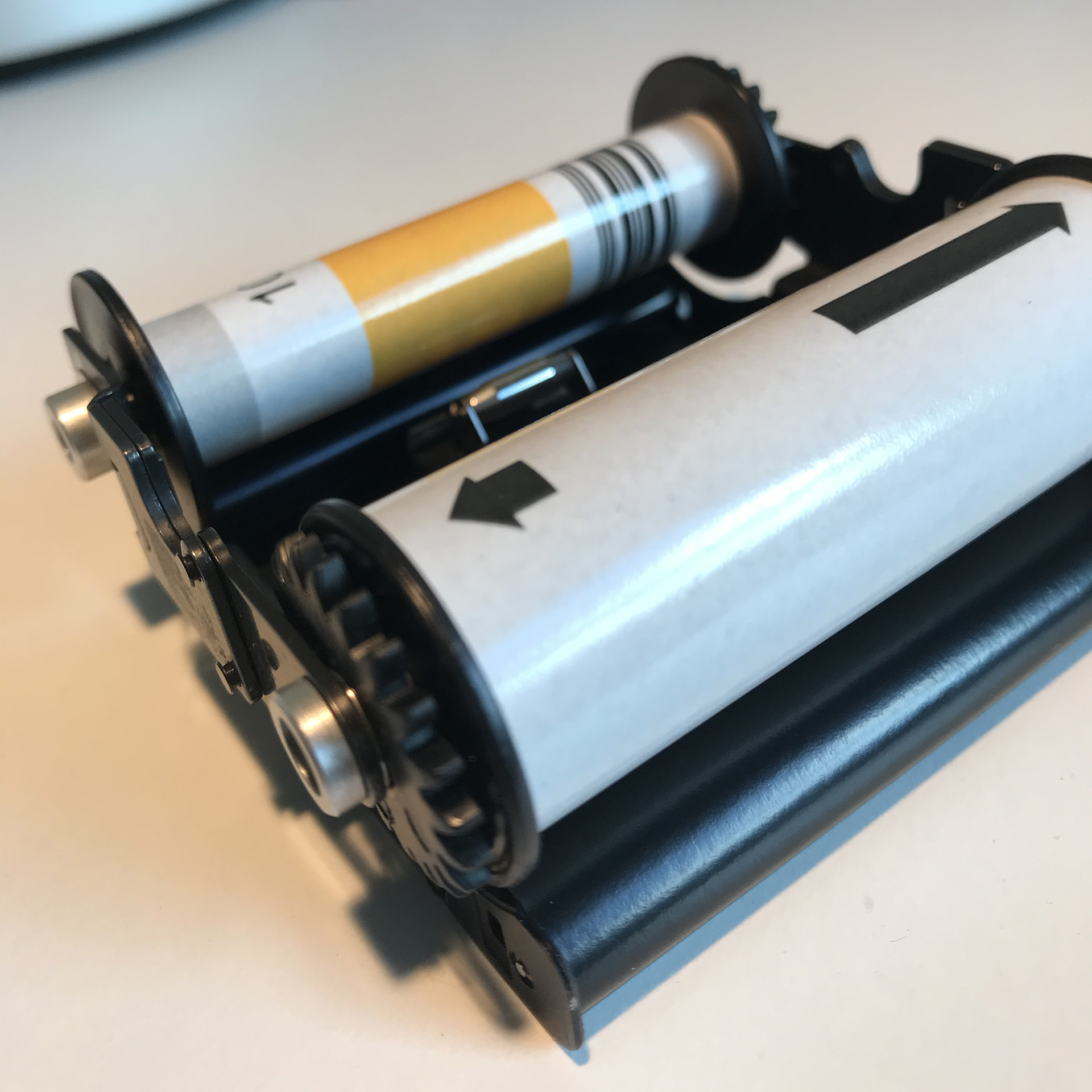

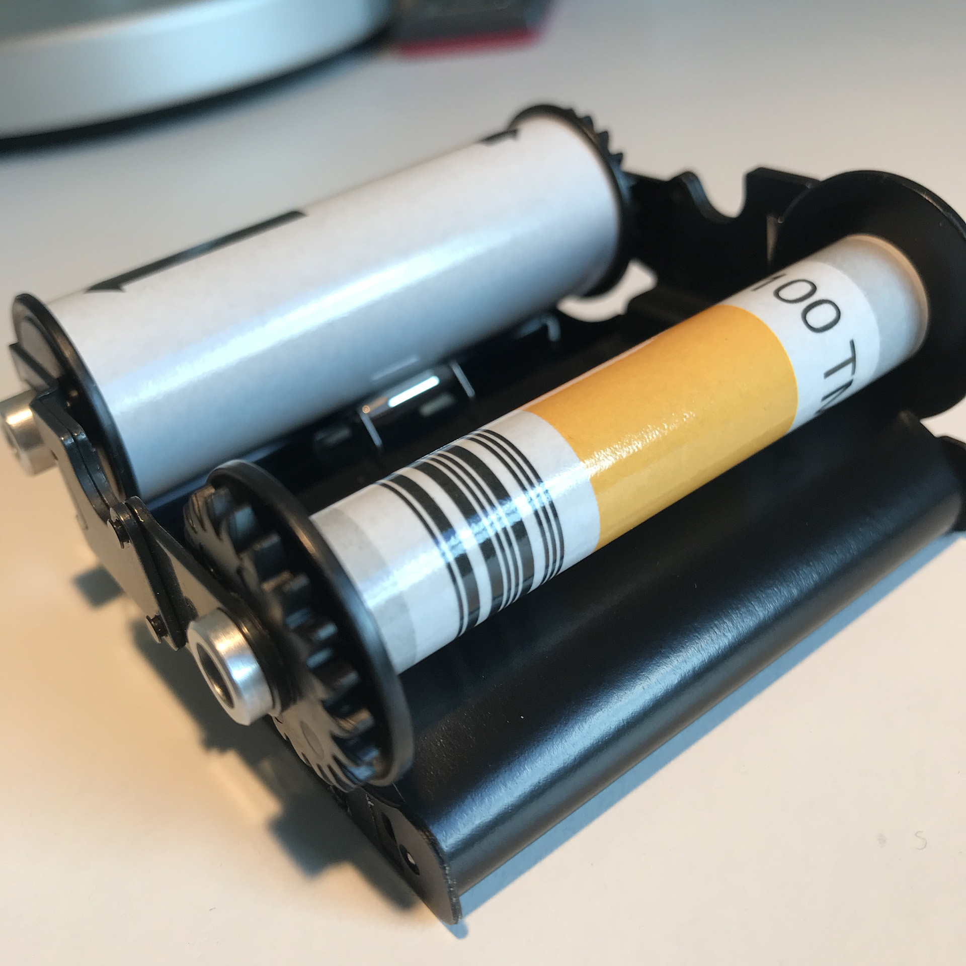

Interesting. I had a problem with one of the film inserts being too tight and shrining the motor so after a few frames it would not advance a full frame at a time, resulting in overlapping frames. Sometimes it wouldn't even wind to the end of the film, resulting in my having to spoil the end of the roll by opening the back and winding the film up by hand. I also noticed that one of the geared sides would only turn in one direction. That insert was returned to the factory and came back seemingly OK. Here are photos of the now repaired insert, and there is a metal washer on one geared side, but not on the other. The other insert I have is in the camera with film. I will check that one when I take it out.
