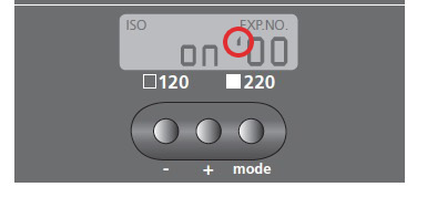

So, anyone know what this indicates?
Of course, the travel direction is different, should have seen that.
When that function is "on" the frame number is displayed in the camera viewfinder and the apostrophe is shown. When this function is "off" the apostrophe goes away.

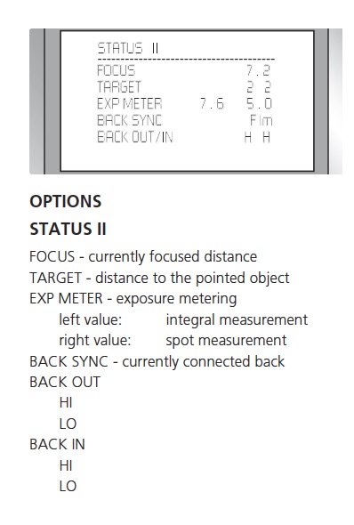

Thanks. Navigating the Hy6 manual can be quite frustrating. Now I have another question: what is meant by Back Out/In? I assume it is not just for digital since the illustration shows a film back in use.
Good question. I noticed this, too. In fact, I asked Eric about it several days ago, but I then completely forgot about it.

I suspect the real answer lies in compatibility somehow with digital backs and rollfilm in the same camera.

Going back to the apostrophe mentioned above in post #351. I think the apostrophe indicates that the camera is now showing the number of exposures on a single frame (multi-exposure mode) vs showing which frame is in the film stage.
Apostrophe - wow there are so many little things I still don't know for sure but you can toggle the ' on or off by using the mode button until you see the 'on' on the left side and hitting the plus or minus button. Once off, the apostrophe will go away. My understanding is that tells the back to display the frame number on the back or not.
You were correct the first time, it indicates the frame number is also displayed in the viewfinder.

Is that what post #353 is all about? BACK IN and BACK OUT signal levels (Hi vs Lo)?

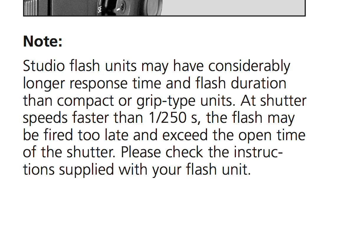

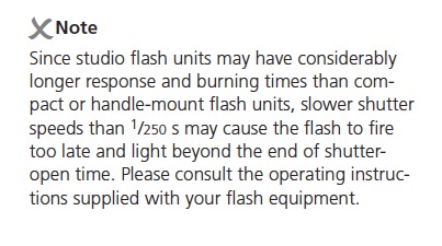

I thought I should give the Hy6 manual another reading-through, and noticed this entry about manual flash sync. It seems it should be the other way around, that speeds faster than 1/250 could cause problems with studio flash. Or am I misreading this altogether?
Never seen an issue with studio strobes and strobe timing with the Hy6. I think you can disregard this note in the manual.
I think
I think this is a poor translation. The prior manual (6008AF) was correct. Of course, why am I reading the 6008AF manual? Guess what came in the mail today !!!
