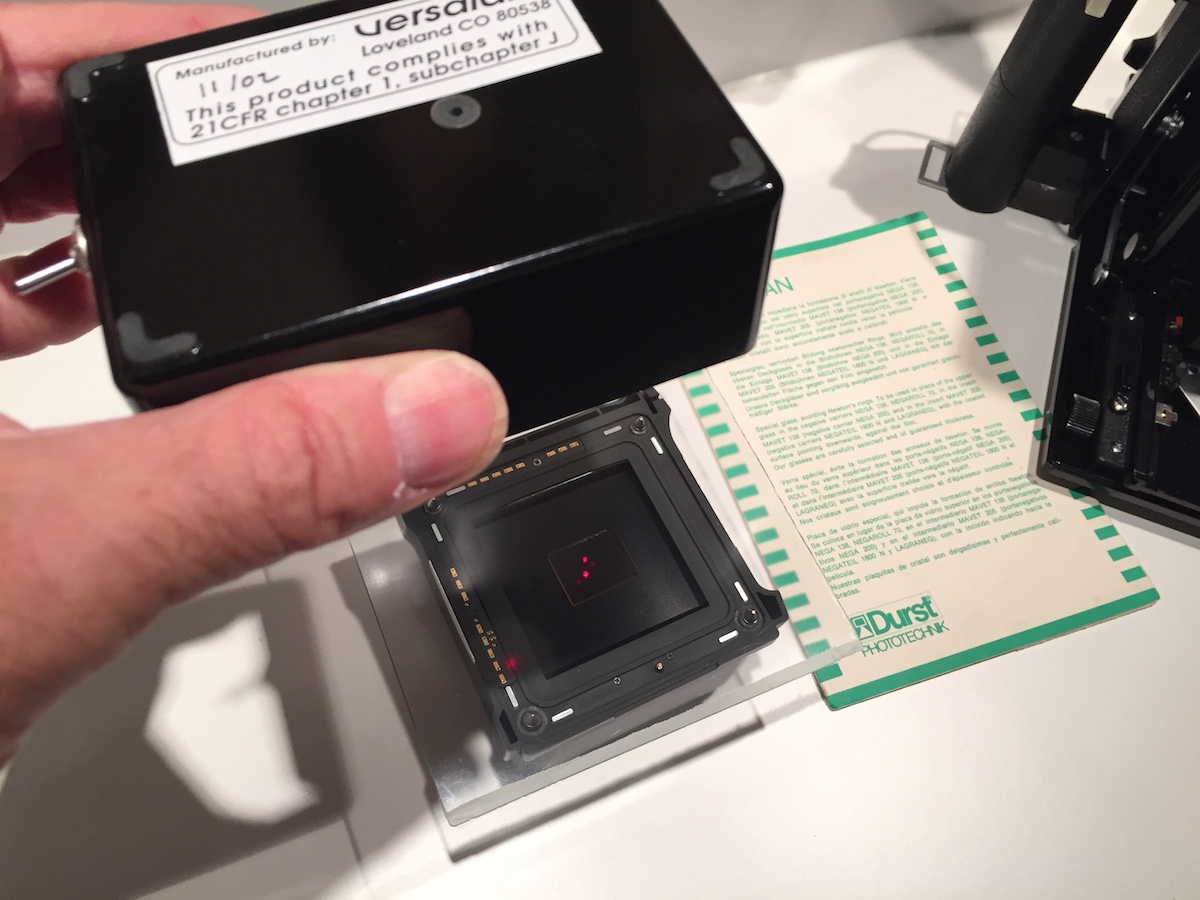

This is one of the checks I did on my pressure plate alignment. Similar to how I setup the film plane on a medium format technical camera. I'm holding the laser for the picture, but for the test it is affixed firmly above the device. The two optical flat glasses need to reflect back to the same point.
I also mount the lens with a front filter and see the laser bounces off the filter and the pressure plate the same.
I think maybe the pressure plate on my insert may have been pressed in accidentally after it left the assembly line. After adjusting it, I treat it with care; the insert is a precision device that sets the focus for the entire system. If the pressure plate attached to the insert is out of whack just a little bit it messes everything.
