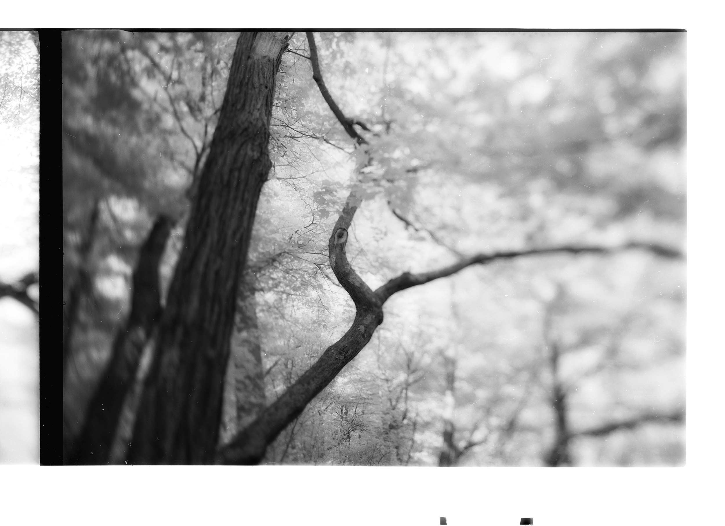

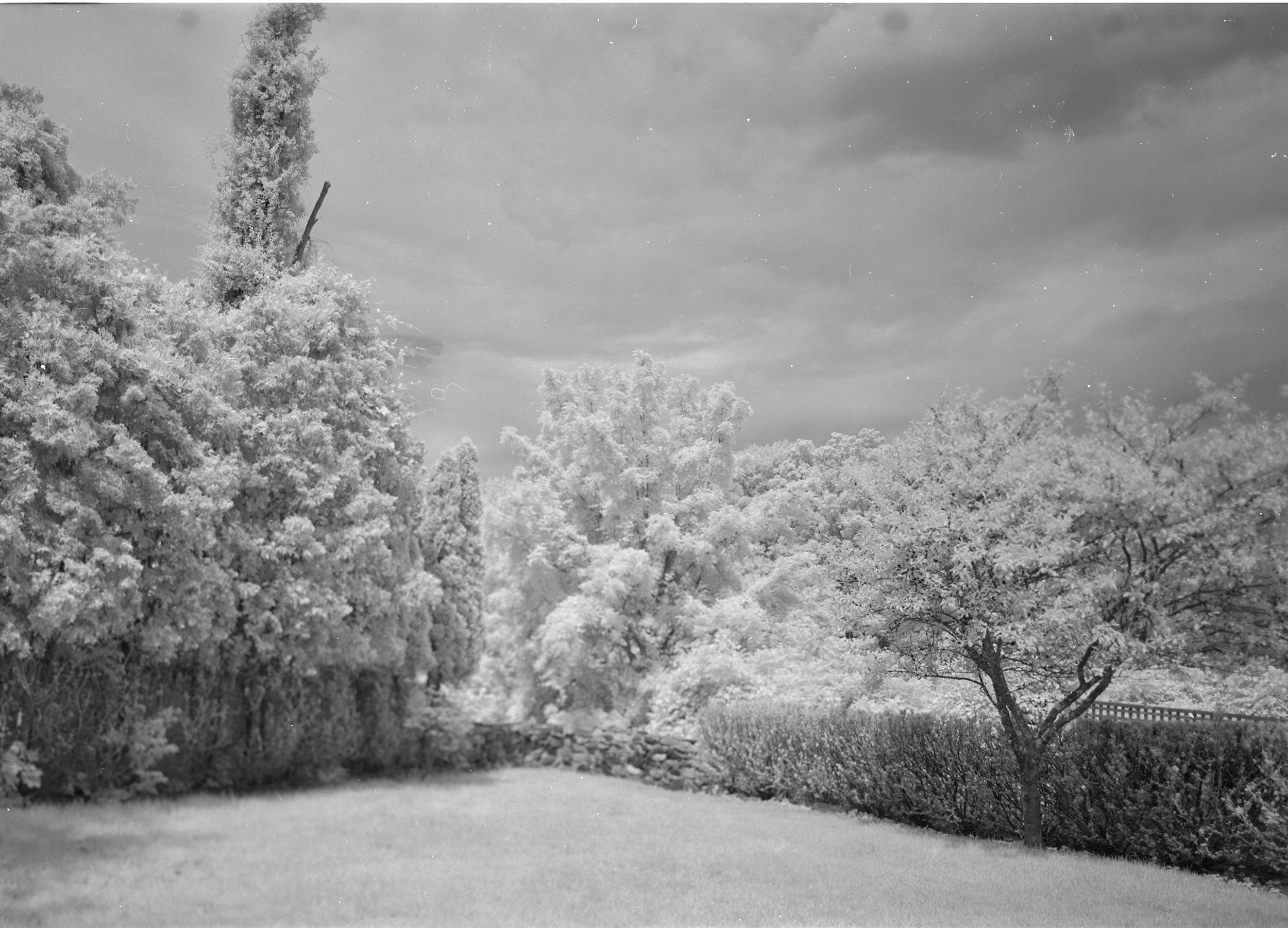

ok, here are two more shots - these were on my Chamonix 4x5 with a 6x9 roll film back. the lens was tested not too long ago, and shutter speeds found to be accurate.
the first shot (trees) was metered at 50 and that exposure transferred to camera with no further adjustment. the second, with the trees and far wall, was metered and exposed at 100; the sun was just beginning to break out here.
