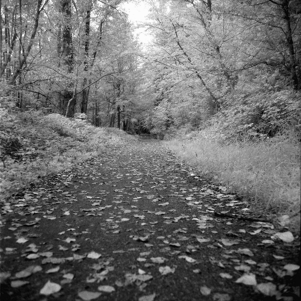

Yup, and I love infrared in overgrown abandoned premises where nature takes over - that looks gorgeous to my eyes. Should've metered it at ~160 though

HB 500c/m 80mm Rollei 400 R72 in pyrocat

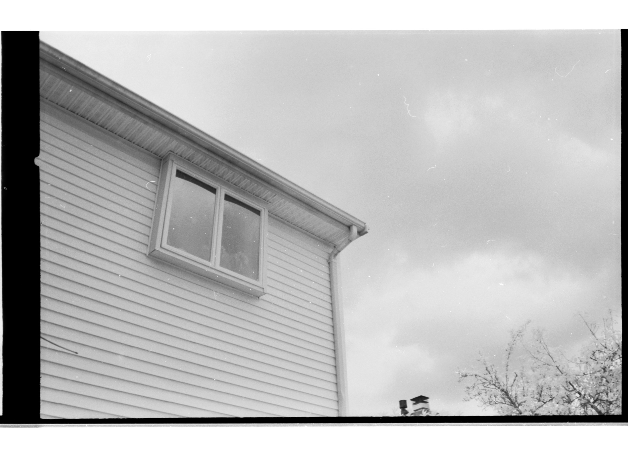

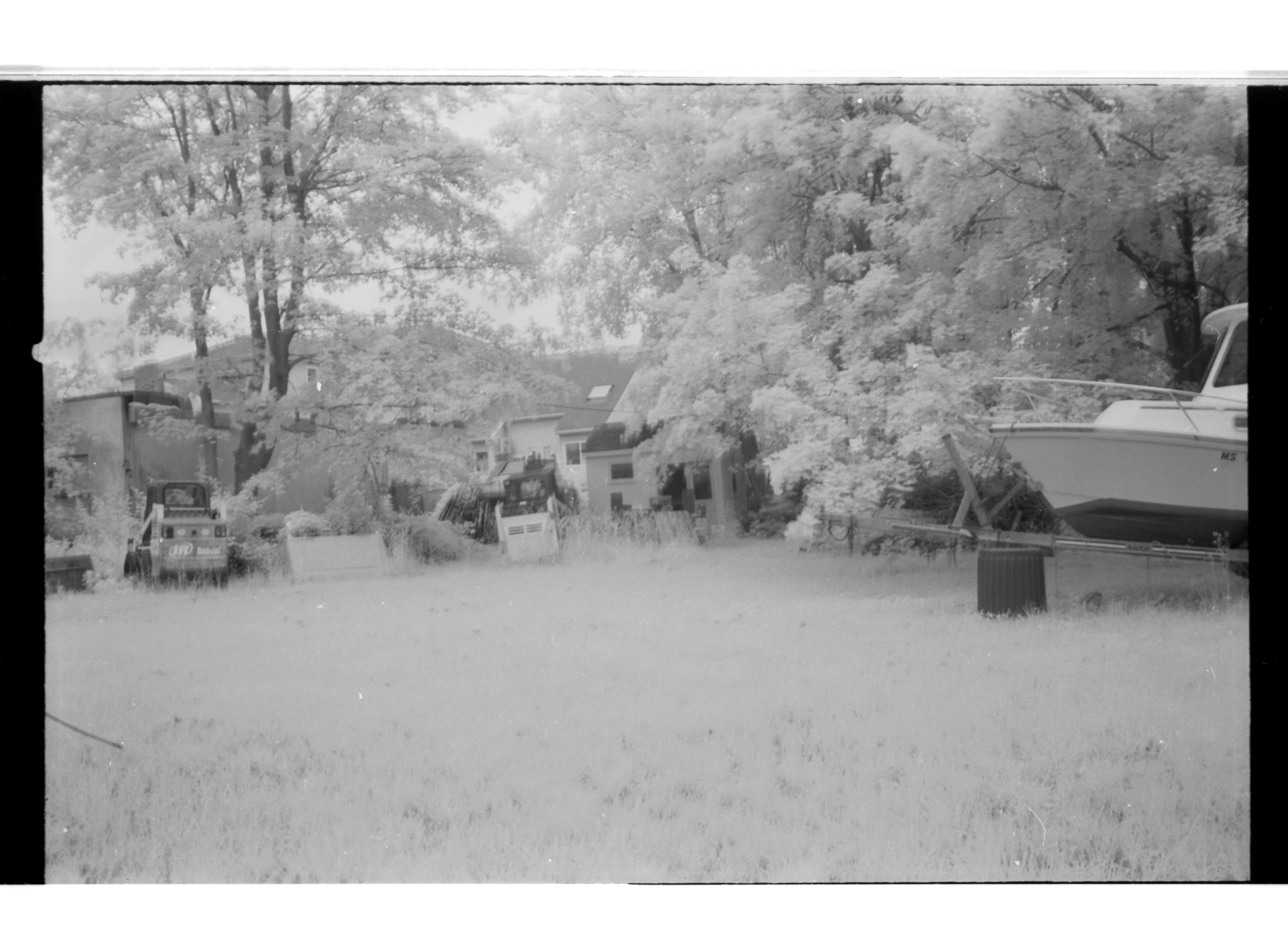

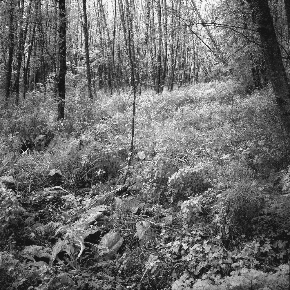

I just scanned my test negatives, and iso 50/3 stops looks good for the overcast conditions I had. One shot with a lot of sky even looks good at 100. I was guessing a bit on development, but the package insert said 10:50 with d-76 1:1, so I used Sprint developer as an equivalent and adjust my time to 8:30 at 70 degrees.
Is anyone able to upload images here, or do I need a paid memebership? That might give us some more info to discuss.
Jimi3
Apr 15, 2023
124
Salem, MA US
ok, so apologies for the crappy photos, but i was just looking for exposure and didnt really bother to correct for focus. the first shot was at iso 50, and the second was actually at 100. tweaked in acr as the raw scans were really flat, as usual i guess. the negatives look good, and as you can see there's plenty of shadow detail.

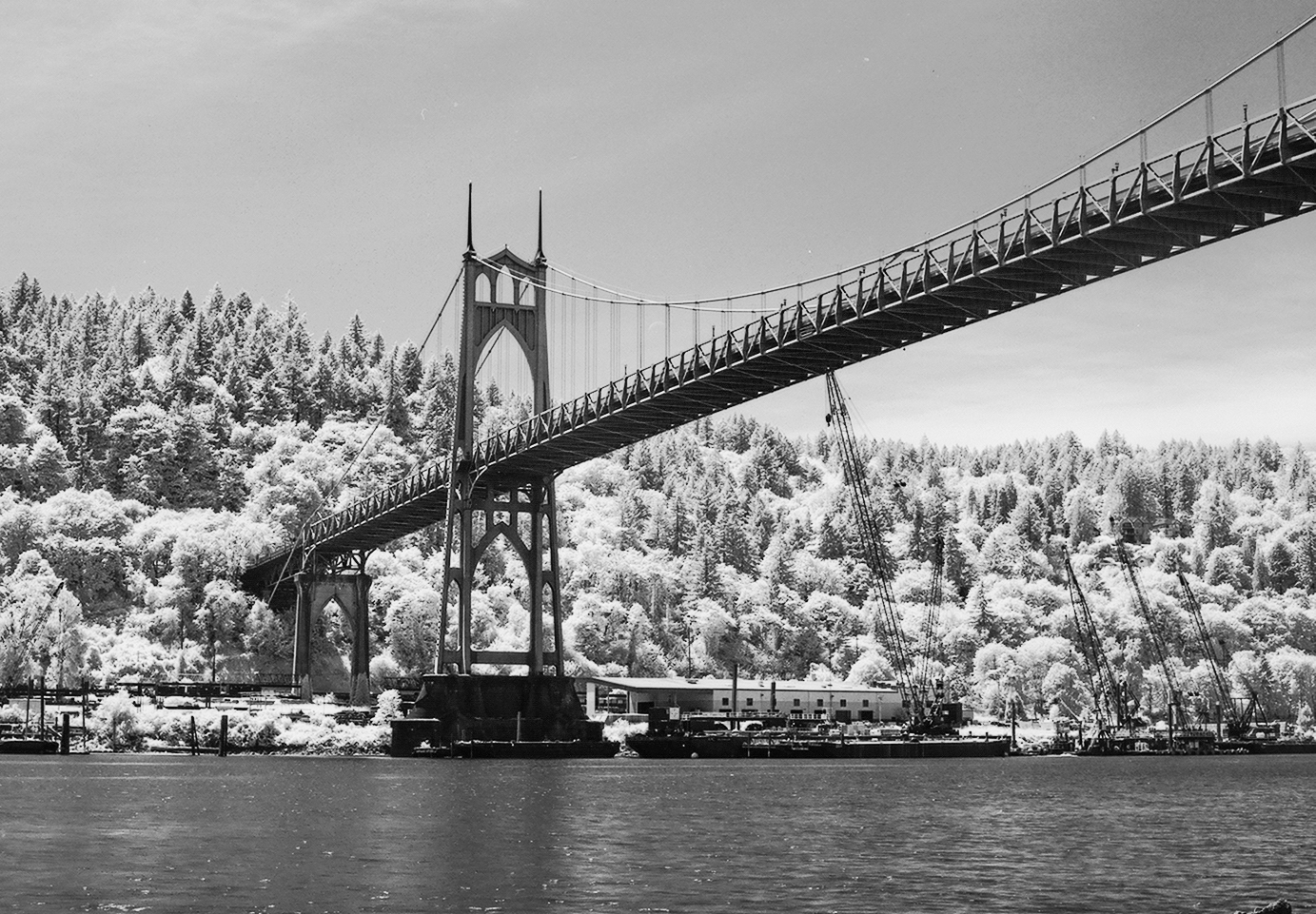

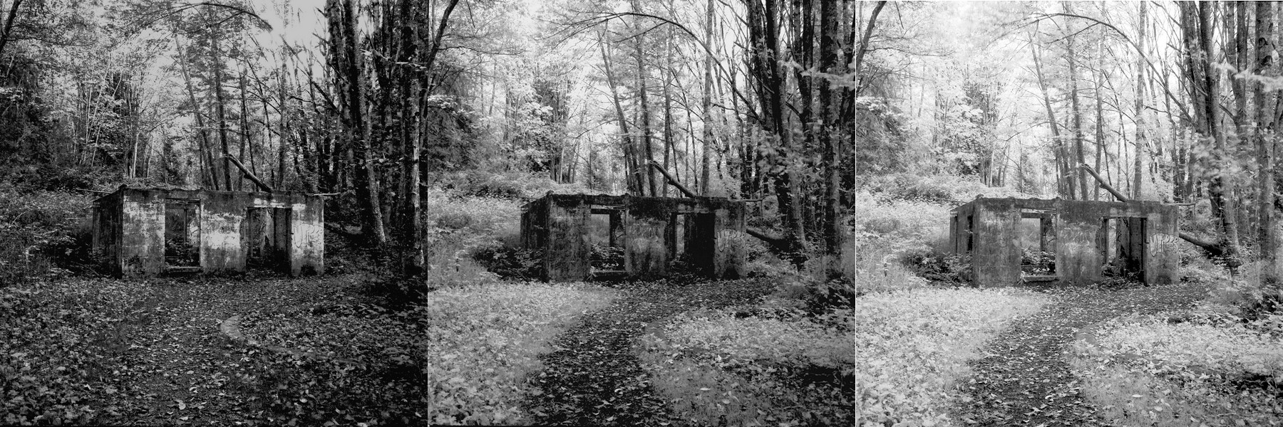

If you are limiting yourself to sunny days, you are missing out on a lot of the great opportunities that near IR capable films offer, These are all using Ilford SFX. The triptych shows the results of SFX without a filter and exposed and metered at the box speed of 200, SFX with an R72 filter metered at box speed and exposed at the reading plus 6 stops, and SFX with an R72 filter metered at box speed and exposed at the reading plus 9 stops:

Exactly! One shouldn't be afraid to experiment. IR portrait? Why not? IR macro? Great! IR interior? Works too, especially with tungsten lightning...
If the shot at 50 is the one in your lower post of the boat, grass and foliage then that's a pretty good "Wood Effect" for an overcast day. especially at 50

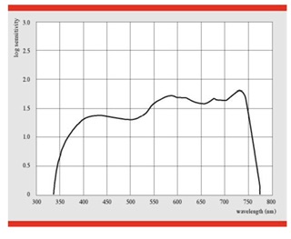

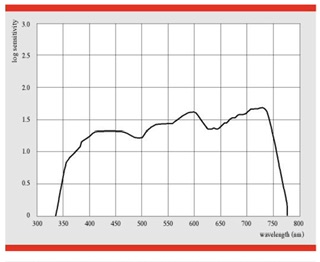

I think that Adox HR-50 (Scala) may be the best IR film for 35 mm. To my eye, its IR sensitivity is almost as good as IR 400. Since the effective speed of IR 400 is likely less than 100, the difference in speed may not really be that much. One usually shoots IR on a tripod anyway, so slight differences in speed are less important. But HR-50 has vastly finer grain than IR 400; it's one of the finest grain films available. HR-50 also benefits from Adox's Speed Boost treatment which mitigates the extreme "S" shaped curve that plagues the aero films.
Helge
Jun 27, 2018
3,938
Denmark
This is Aviphot 200 vs. 80.
Not that much of a difference in speed above 700 nm. In fact the dip in sensitivity before 650 nm might be helpful for no perfect filters (basically all) and using red to get a smidgen of Woods effect.
The contrast and dynamics are different though.

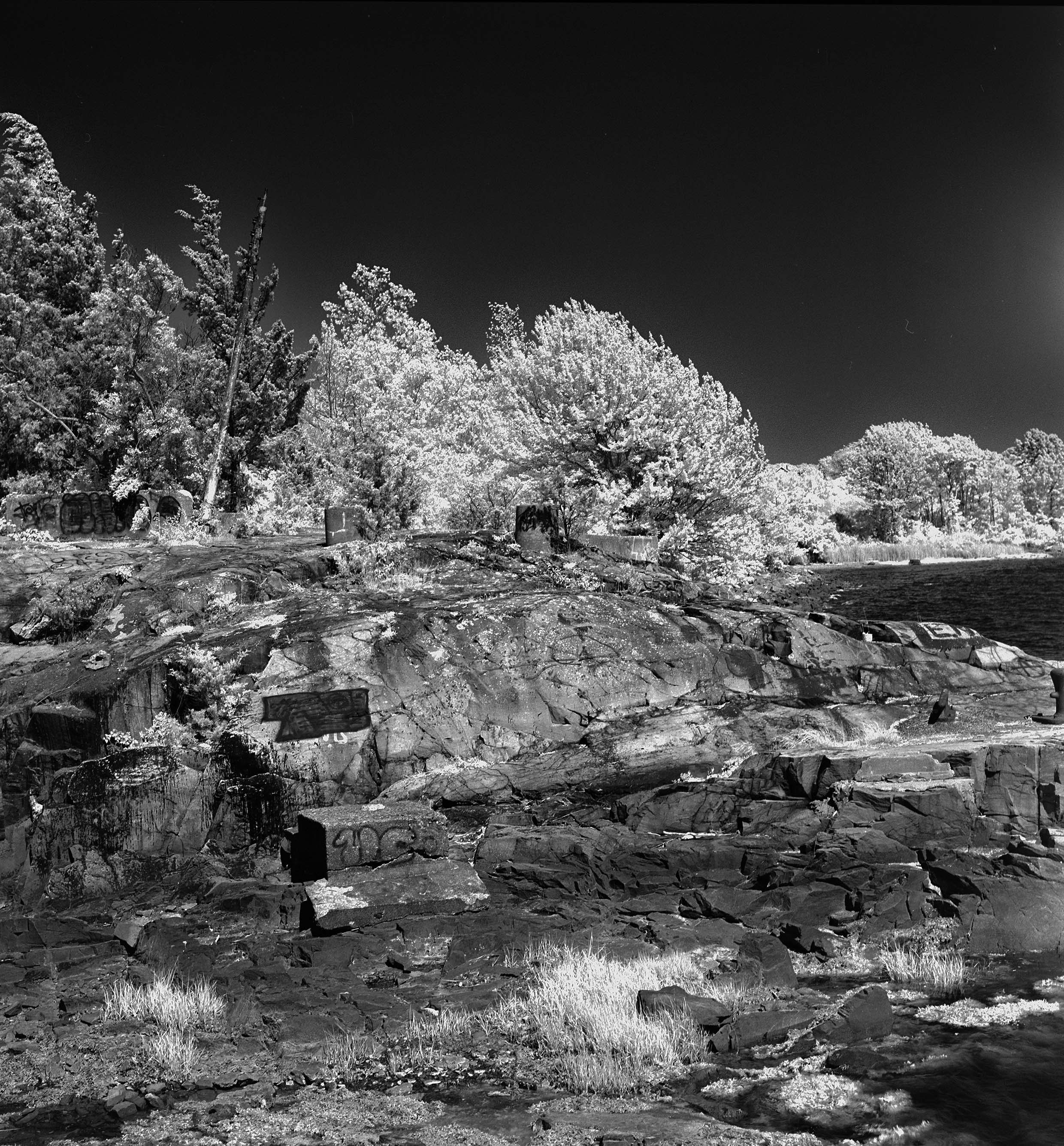

Adox HR-50 can give a Wood effect with R-72 filter. E.I. 40 with HR-50 developer.
pentaxuser
yea, that was at 50. It took some tweaking in camera raw, but the negative has good information.
My darkroom isn’t set up for printing, though I do still have an enlarger and a safe light, so I may just get some trays and at least do some contact prints.
