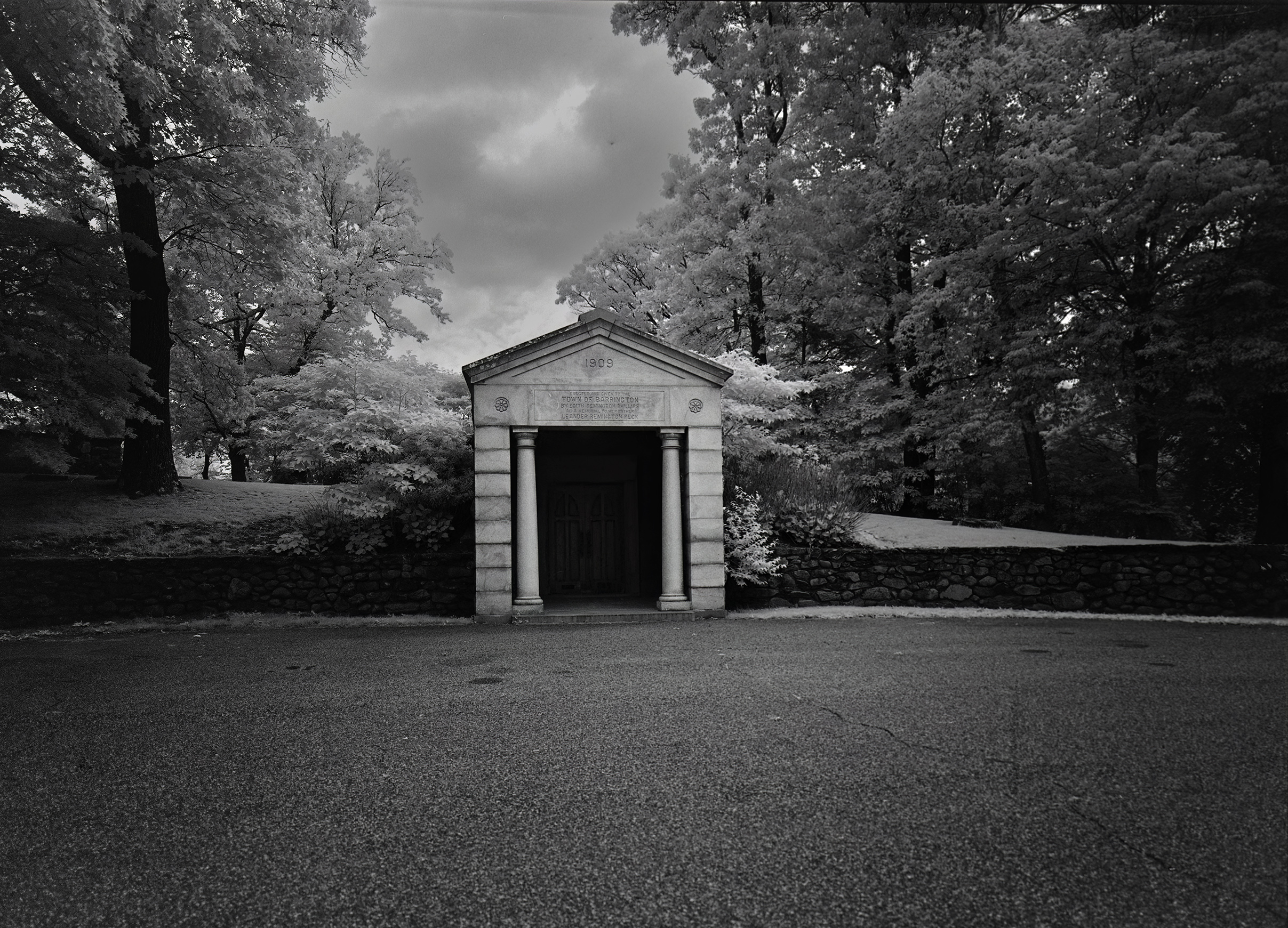

I’ve searched for answers to this, but wanted to pose a question of my own. I’m just getting back into shooting infrared film and settled on Rollei with an r72, and came across the recommendation to start at iso 6 with this combo. That sounded in line with what I used to do with Maco IR film many years ago, so I tried it, but my Rollei shots came out WAY overexposed, even in cloudy conditions. So far my testing indicates that I’m getting better exposures around iso 50, but that’s with an old Konica 35mm and appropriate film- didn’t want to waste the 4x5.
So I’m wondering what baseline iso others are using, as 50 sounds high, but unless my shutter speeds are off, looks to yield decent negatives.
5 stops would be ISO 12, right? I've found that even then I've overexposed a bit (not terrible with MF, as easy to correct in Photoshop). But I shot this yesterday with Rollei 400 and a Hoya 72, and rated it around 4 stops. When I shot a lot of IR digitally and so without concern for "wasting" photos, I thought it was somewhat hit-or-miss. All I could do is guesstimate and get close.
4 stops in shade/overcast will give you results like these indeed.
