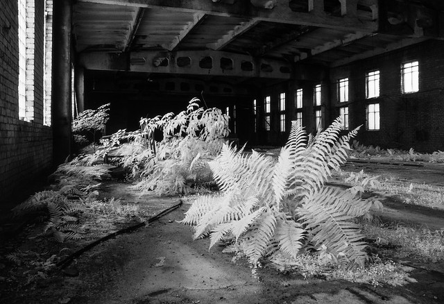

Some examples from my exposures:
Māras dīķis by Ivo Stunga, on Flickr
4 stops in cloudy sunlight resulted in slight overexposure, reduced it in Lightroom
Pareidolia | Kodama by Ivo Stunga, on Flickr
IR close-up, 4 stops in shade
URBEX LV : Infrared by Ivo Stunga, on Flickr
IR in premises, 5 stops
Your shots are definitely moderated to not lose highlights. You keep a lot of detail in the Woods effected areas, but it is still clearly Woods effect, and look great.
