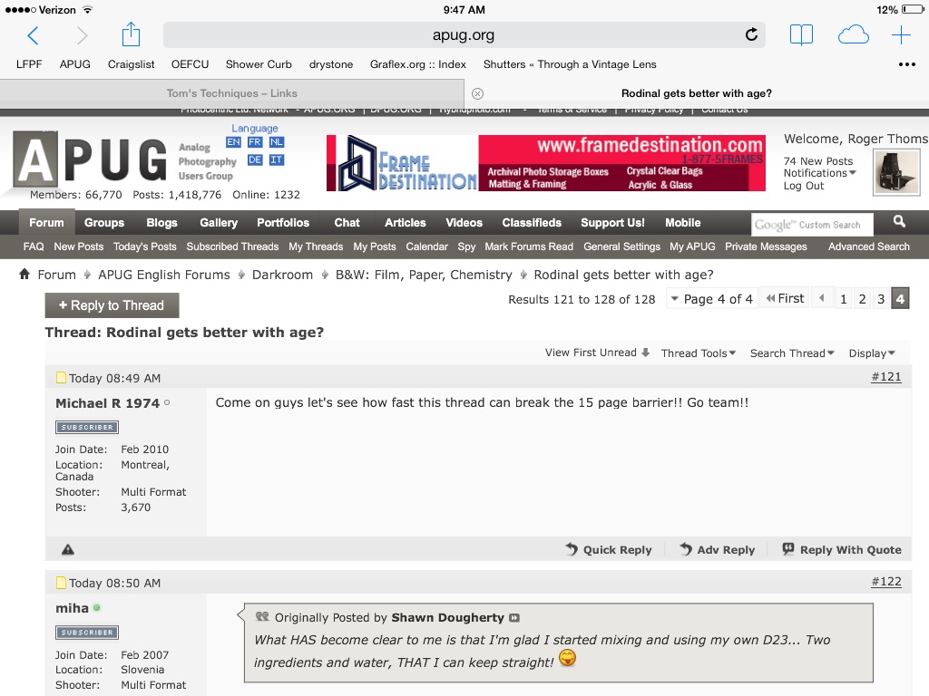

This may be more clear: (there was a url link here which no longer exists)
