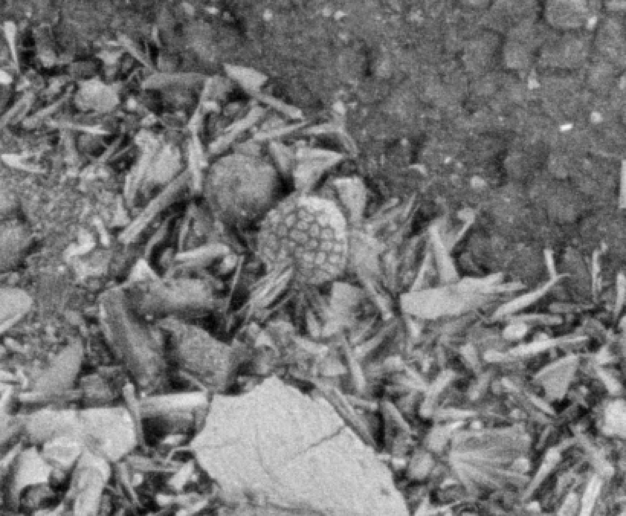

Example images from a very high level scan.
100g/L
http://oi41.tinypic.com/k350eh.jpg (probably easier to see if you view it full size)
85g/L
http://oi39.tinypic.com/2q9xnjr.jpg
100g/L
85g/L
I can't quite understand what the difference between these 4 photos ...
2 Photos. Difference in grain. The links above the pics are for bigger viewing. Just to demonstrate a point to not automatically repeated info ad nauseam that people don't try out themselves. Sodium Sulphite is supposed to reach peak solvency ay 75g/L according to sources iirc. Both these values are above that, and there is only a small difference in amount between them, yet still show a difference between them.
