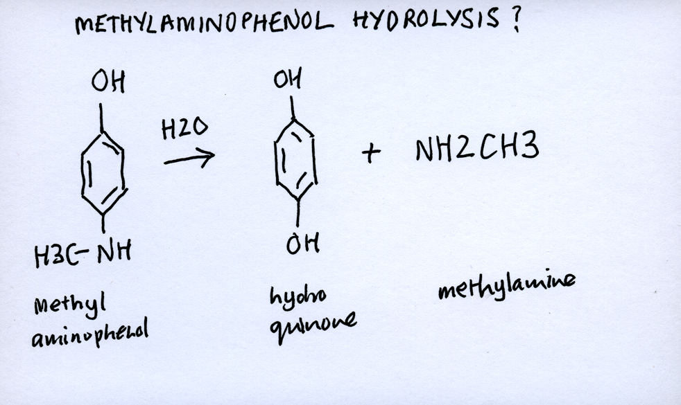

The reason I asked is that I was unaware of any literature on the subject. I could not see any plausible hydrolysis other than the formation of p-aminophenol.......
Something like the attached, producing hydroquinone and methylamine?
If that is unlikely it is even more unlikely with p-aminophenol which has an equation producing gaseous ammonia.
Both ammonia and methylamine have very distinctive odors that I have never detected in aged bottles of Rodinal and Kalogen.
The metol based developers where the manufacturer claims a shelf life of 6 months in a full sealed bottle may (my theory) decompose by hydrolysis , unlike Rodinal.
In the attachment I posted above for simplicity I left out 1/2 H2SO4 from the metol side.This may react with methylamine converting it to a less fragrant form.
Howevever since old developer from a sealed bottle is sometimes brown this simple scheme giving methylamine sulfate is not a full explanation, which is not known.
In a highly alkaline developer like Kalogen the sulfuric acid portion of the metol has already been neutralized. Any ammonia or amine would be released unchanged.

Why so? If you add ammonium chloride to Kalogen developer there is no evolution of ammonia?
How is methylamine sulfate different?
No, perhaps I didn't make it clear. In a highly alkaline developer any ammonia and amine will be released as it forms.
This probably does happen in the B bath of Thornton's 2 bath developer which has an amine-like smell after some use . It contains carried-over metol but notably no sulfite.
In old metol developers with sulfite in sealed bottles there is no amine smell.Maybe amine is formed and reacts with sulfite.
