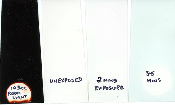

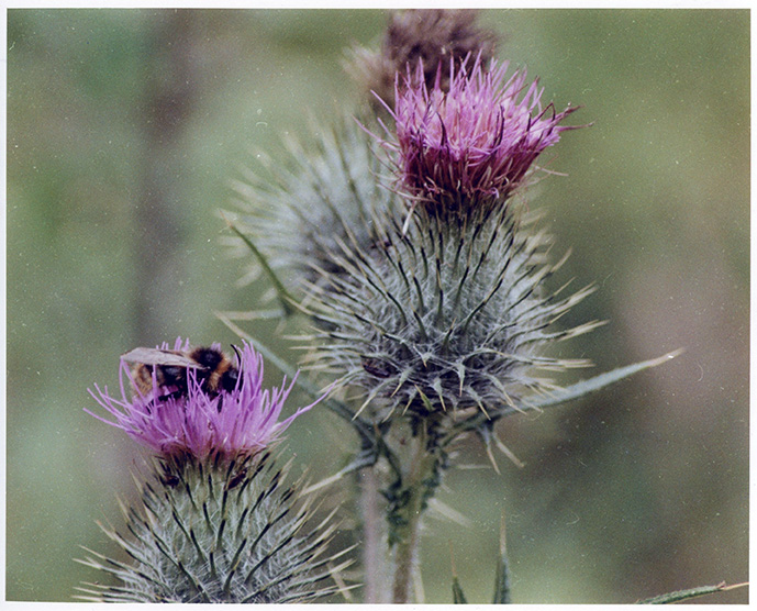

Is printing RA4 colour when using a DUKA safelight actually safe? Well in my view it is perfectly safe.
In view of some of the the comments on the subject in this thread I decided to do a series of tests just to prove what could be misguided information in what has been stated or or has been found. printing RA4 is no more more difficult than B&W (Not of course accounting for the more exact temperatures and times needed.) I have been printing RA4 since around 1992 starting with Kodak materials and chemicals, but with the demise of Kodak items I have been forced to fall back onto using Fuji paper and chemicals. I will be quite honest I don't particularly like Fuji RA4, but you have to work with what you can get hold of.
In the test that I carried out I used cut sheets of Fuji Crystal Archive glossy paper and Fuji CPRA developer and Blix with an acetic acid stop bath in between. The print of the thistles and the bee, I made was on the same paper/developer combination but the negative film was Kodak Gold 200. The lighting on that day was bright but with few shadows.
My darkroom is quite a modest size being approx 2.75m long and about 2.00m broad. The walls are a very pale cream and the ceiling is white. Both are matt painted. The reason I included this information was for you to judge the size of room that a DUKA can illuminate and still not fog the paper. The lamp itself sits on a windowsill next to a backed out window. (white blackout material) The lamp is angled at roughly 45 degrees towards the blackout material, so the light is reflected off that upwards towards the ceiling and is completely diffused. I also work between the lamp and the workbench, so no direct light can reach the light sensitive paper. Allowing for the width of my workbench, the lamp is about 1.25m behind me. I can see to work quite easily but not read small printed writing.
The lamp house is adjustable from 1 to 50 marked out 1, 5. 10, 30, and 50 sections. 1 being the dimmest setting and 50 being full illumination. I have the lamp adjusted with the marker at 2/3s of the segment between 5 and 10 (closer to 10) so it is still at quite a low level of brightness.
The bulb is the 2nd I have had, the original expired about 15-20 years ago. I understand the value of the light does change over time and becomes less effective, but I rarely have to change the filtration which I put down to different film stocks and or development anyway. The filtration to produce the print was 65M 75Y which is very close to my average and the exposure was 7.3 seconds. The print was developed for 45s @ 35 degrees +/- .2 of a degree. In this respect Fuji paper is far more stable than the Kodak equivalent was, with more constant filtration by Fuji
The 1st test strip was exposed to the room main light for 10 seconds. The 2nd test strip was totally unexposed paper. The 3rd test strip was exposed to the safelight only for 2 mins and that is to all intents and purposes the same as the unexposed strip, (No2 in the series). The 4th test strip was exposed to the safelight for 3.5 minutes and this when viewed in tungsten light or LED, as expected. does show a marked cyan cast.
The largest print I can make in the darkroom is 12x16 due to the size of my processor and the exposure time for that has never exceeded 50 seconds which allows me a large margin of safety if I prepare beforehand. No 3 and 4 test strips were placed on the workbench where I would normally work so any ambient sodium light would be at the same level as if I was printing normally.
So with over 32 years experience of using RA4 paper and a Duka Safelight, I personally think under normal usage, the two can work safely together. Unless I had been told on Photrio there had been a paper speed increase a few years back I would have been non the wiser. This is of course my personal finding and is not anecdotal.
As for using my Duka when printing B&W it is in the same location and the level of light output is always set on the maximum of 50 and never have I had an instance of fogging, even though size for size B&W paper is slower and so exposed to the light for longer times.
I suggest that without visible proof that can be seen by 3rd parties, simply quoting from tables or other sources that information about what can be done, or as the case may be, cannot be done, is possibly flawed and not always as others may find them. Giving out such formation can dissuade people from trying it out for them selves, and as I have done, learned from my personal experience over many years.
I do agree that the light levels in a darkroom when colour printing have to be very subdued but never the less a DUKA safelight is a viable option.

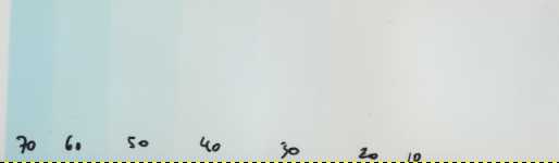

Here's a step wedge under my safelight, which is evidently much less safe (by about 2.5 stops) than yours:
The accompanying text in the blog I linked above mentions that the 20 second wedge is the last one that shows no visible tone; the 30 second wedge shows a slight cyan discoloration, roughly similar to your 2 minute wedge.

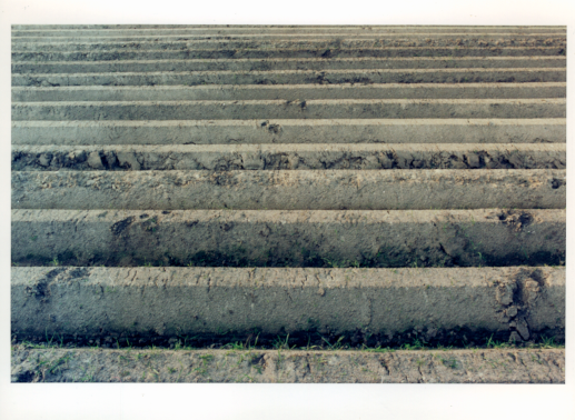

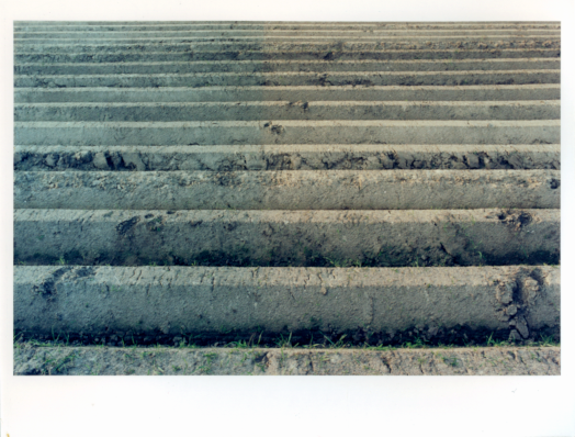

I then did a test print with one half fogged to the 'safe' 20 seconds, and one half unfogged:
Note how the borders are white, although the left side of the sheet (including borders) was fogged for the same time to the safelight. The color shift in the image area, however, is dramatic.
This is a further test with the safelight fogging tuned down another two stops. In your darkroom conditions, and assuming that your 2 minute wedge was unfogged, this would be a 30 second exposure - in my darkroom it was a whole lot shorter - 5 seconds. But that is inconsequential; what matters is how it relates to the time we see fog appear to the whites.
In this sheet, I fogged the left band at 2 stops below the longest time that did not produce a cyan tone to the whites. As you can tell, the color cast is still significant.
To get rid of the color cast, I'd have to go back down at least about 2 stops more or so. Translating this to your darkroom, this would give you a safe time window of less than 7.5 seconds.
The reason why you're not seeing the problem is probably because you're filtering out the color cast, and you're being reasonably consistent in how much safelight fogging you expose your paper to. However, the result of your approach is that you're printing with a reduced gamut on the paper; you cannot by definition use the full range of hues of the paper if you contaminate it all with a hint of cyan.
You're of course free to do and believe as you will, but please understand that the simple fogging test that you have performed is by no means adequate for color work. It takes a fogging test with an image exposure (before or after it, or both, if you prefer) to verify that your safelight conditions are truly safe - or rather, for what period of time they are safe. You will find the actual safe time window is substantially shorter than you believe it is.
