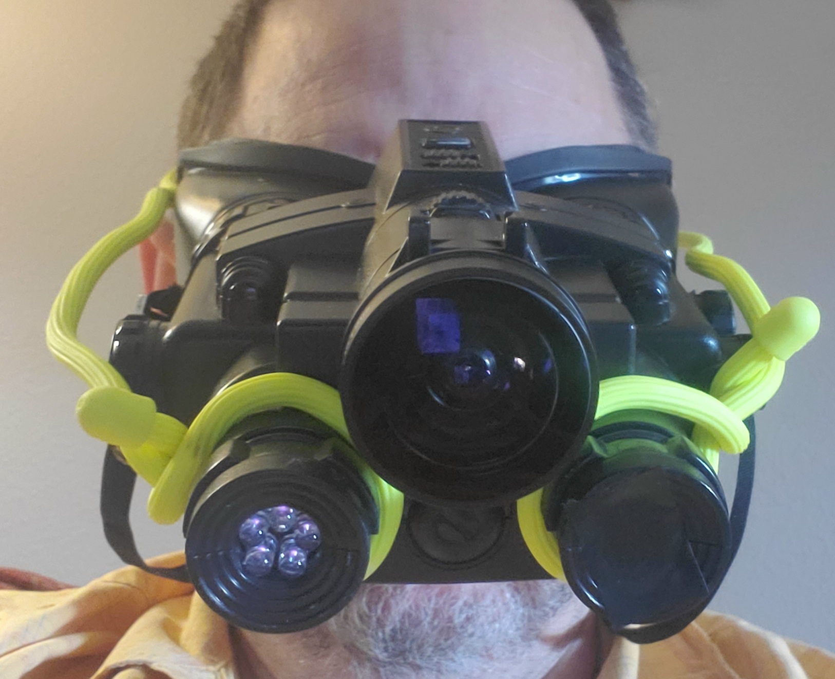

I have some toy IR goggles (Spynet Jakks Pacific) IR goggles that I use for loading film reels and film holders. These are amazing ZERO effect which blows my mind. I don't use these for printing as too clumsy, zero depth perception (monocular IR camera).

The only safe way to be able to see color materials developing is with infrared goggles strapped to your head.
Color materials are sensitive to all of the wavelengths of visible light
If the exposure time is very short (10-30 seconds) you may be able to get away with it.
That last image makes me think of Terry Gilliam's "Brazil".
Do you see yourself as the Robert De Niro character, by chance? :smile:

For those who need/want to see when handling the still sensitive paper, IR goggles are a very affordable and effective option.
Unfortunately, I expect difficulty with light sealing the goggles against the face for those who wear glasses. And the affordable ones are monocular, which means no depth perception while working.
Working in the dark means no depth perception either. It has always worked for me, so I can't imagine that the monocular view through a basic IR viewfinder would be much worse.
