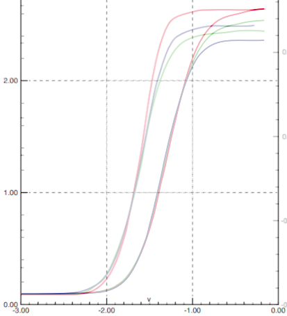

Here's an example taken from a Kodak white paper of how this impacts optical/'analog' exposure of an old-style paper (right-hand set of curves) vs. a new-style 'for-digital' paper (left-hand set of curves):
Note similar speed for the three color channels, as well as the speed increase (shift to the left) of the 'for digital' paper vs. the old product. FujiFilm followed suit when Kodak started down this route.
By nature of the concept of RA4 paper, whenever the speed of the emulsions change, they need to change by virtually identical amounts. So an increased sensitivity in just one color layer did not happen, as it would have rendered the product unusable. Since this is inherent to the concept, it doesn't matter if we discuss Fuji, Kodak or Lucky papers since they are all based on the same principles to prevent cross-contamination between the channels through relative emulsion speed differences between the layers.
