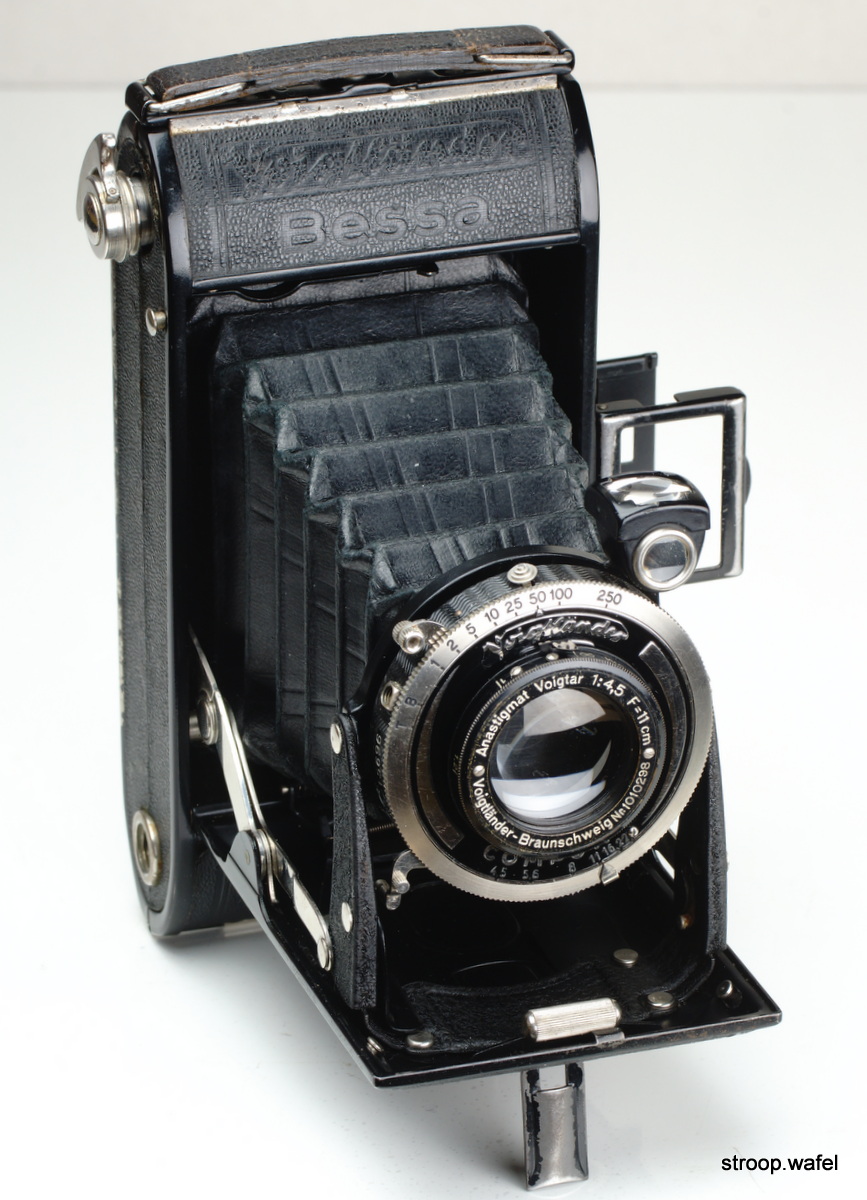

I think this is my camera.

The Bessa is one of the good ones. Like most folders of its day, there were multiple options in lens and shutter -- don't know if Voigtlander ever went as far down as a three-speed shutter, but the Voigtar-Anastigmat in that photo is a "humble" Cooke triplet -- which are perfectly fine lenses from f/8 to f/22 (in that focal length) and still pretty good outside that range. The Skopar and later Color Skopar were the best Voigtlander offered, but there was also the Heliar (Tessar clone?).
I've got a Voigtlander folder a few years older than that one; they called it a "Rollfilmkamera" because, as the only one in their catalog in 1927, it didn't need any other name. It has a Voigtlander Anastigmat 10.5 cm f/4.5, which is either a triplet or Tessar clone (I haven't tried to count reflections in it lately, and I've forgotten what I got when I did years ago) -- and it's my favorite 6x9 camera. Scale focus, all original leather, compact and fairly lightweight, and a nice dial-set Compur that's accurate at all speeds. Great for those days when I want to be sure I finish the roll... :wink:
