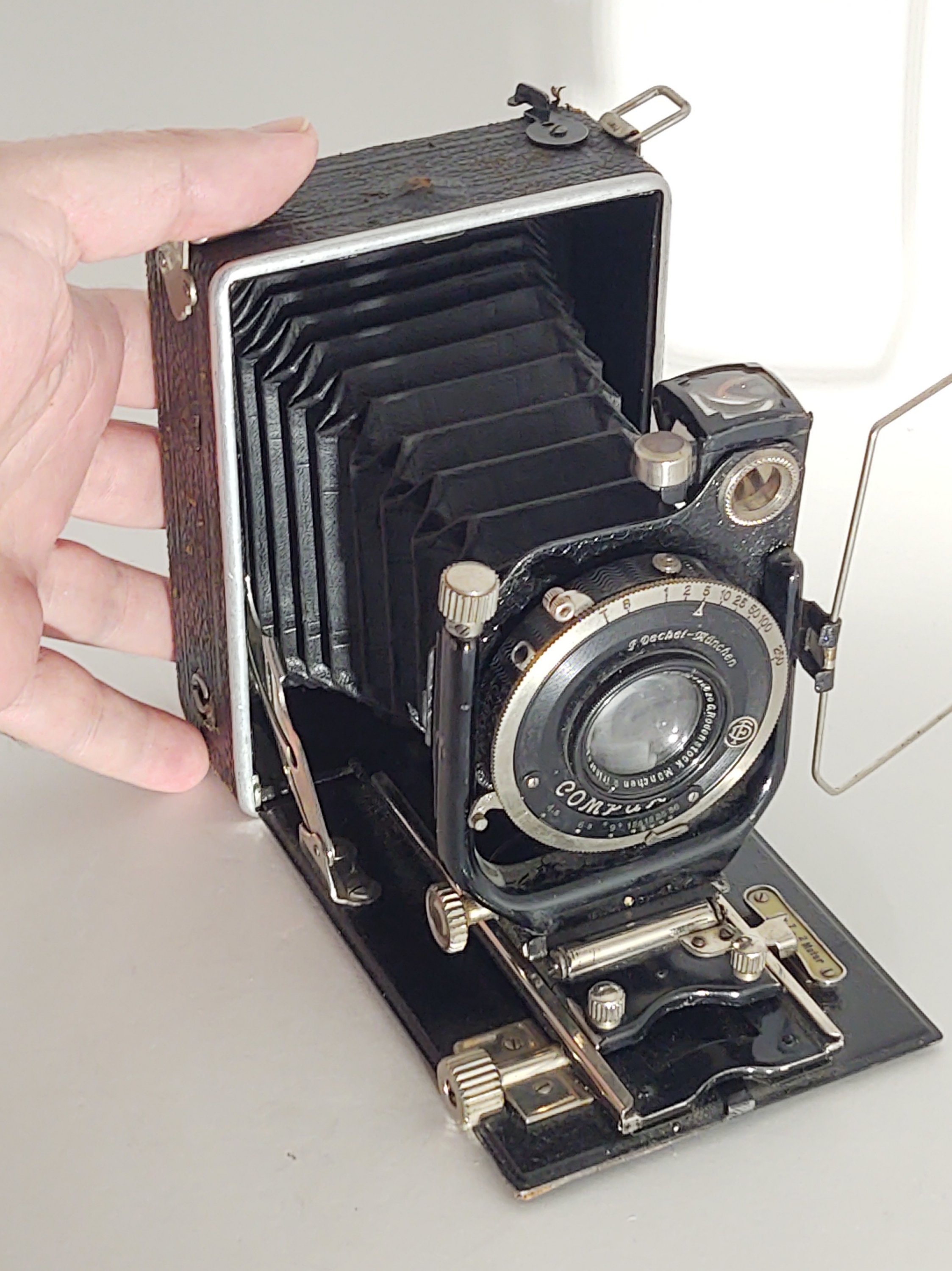

On an interesting side note, I just received this camera a few days ago. Amazingly it has rise, fall, and shift! It is not marked anywhere but it has a rodenstock lens. IMG_20210204_213845824~2.jpg

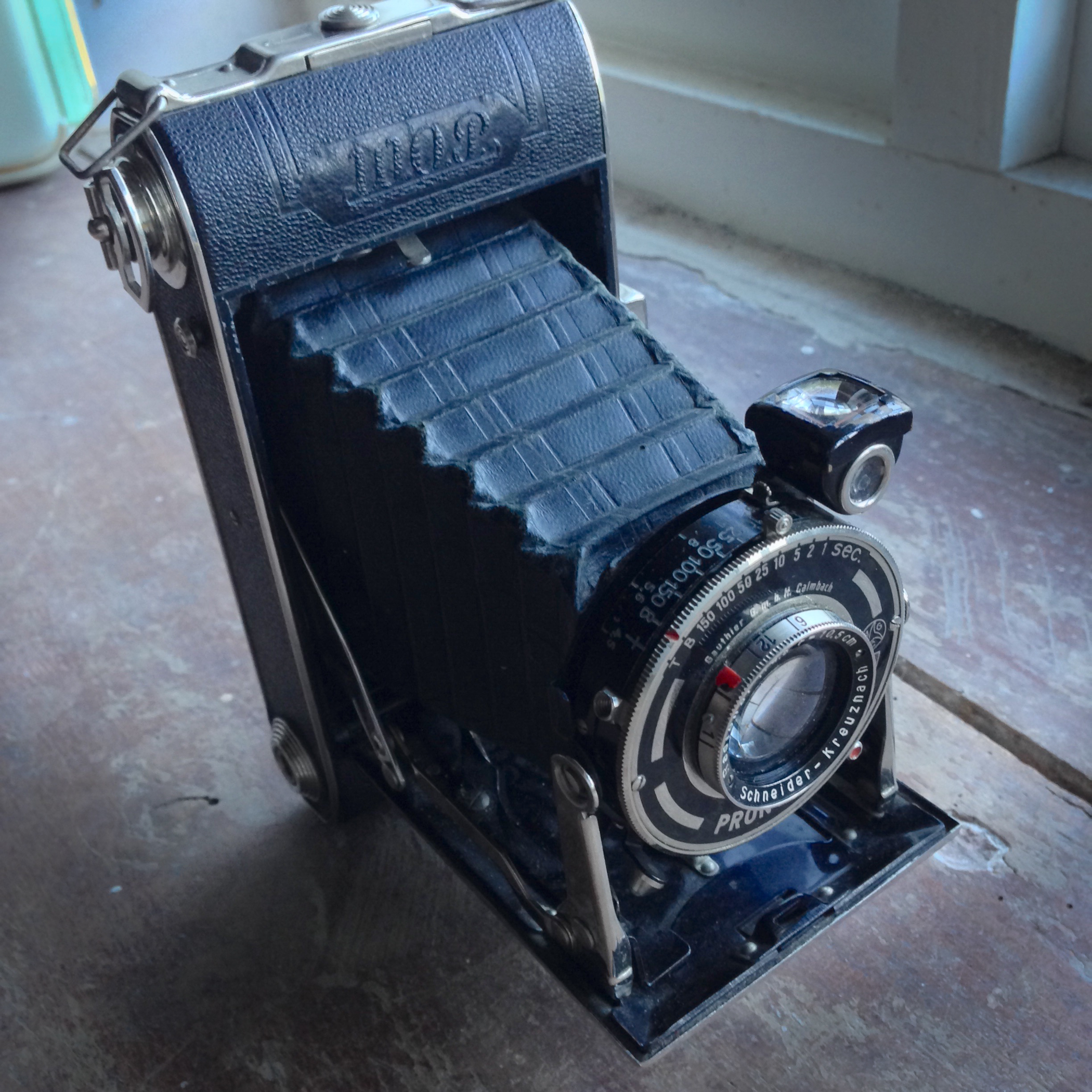

I've used my W.O.P. 6x9 folder for years (really good up the Alps when skiing as it fits into a pocket and still gives a decent size negative). I have never found anything about the W.O.P. cameras but I assume it's 1930's and rebranded for a dealer? Anyway, still works like a dream and I like the results from the uncoated lens.
And it was really cheap too!
