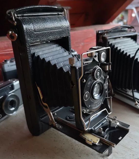

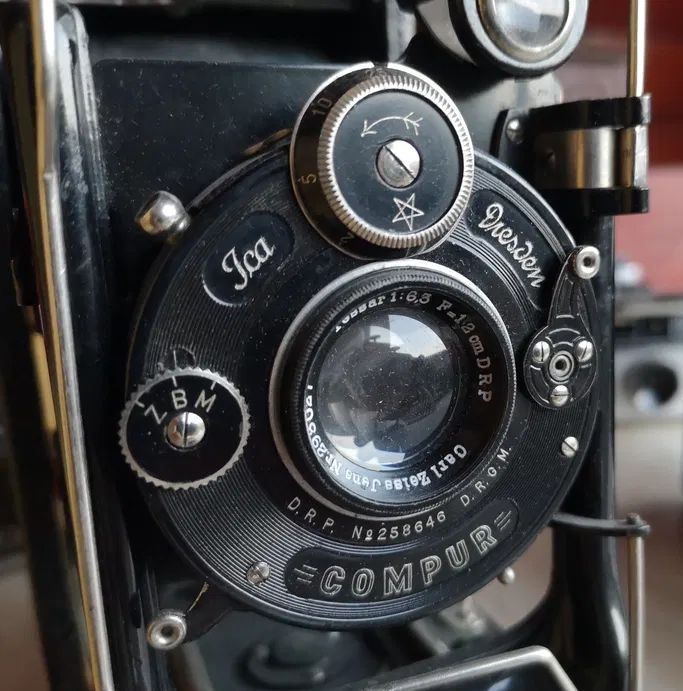

I dont want to derail this thread only divert it for a sec- since you can replace bellows and (presumably?) remove shutters for servicing couldn't you also "technically" change lenses, though not in the easy on the fly way the OP means it? Just curious cause I sometimes see decent lenses on bad folders and vice versa...although the former or more rare
The Zeiss/Ica Ideal in 9x12 cm has bayonet mounted lenses, but the only lenses I've seen on these are 13.5 cm and 15 cm (both f/4.5), which have different rear cell and shutter sizes, and different bayonet plates (hence mounts on the camera). Not exactly pocketable, unless you have really big pockets, but pretty compact for large format.
I wonder if this are 'Ideal' or have interchageble lens.
Those are roll film cameras of some stripe. The Ideals are plate cameras. The body is a square-cornered box, with the bed on the front and the ground glass, plate/film holder, or other accessory on the back. Further, those don't have the bayonet plate on the back of the shutter or its latch on the front standard.
