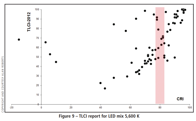

I can illustrate this by analogy using a figure from this link: https://www.mikewoodconsulting.com/articles/Protocol Fall 2013 - TLCI.pdf. This figure plots the results from several light sources that were measured according to CRI and TLCI. As you can see, some light sources give terrific CRI scores but poor TLCI scores, and some give great TLCI scores but poor CRI scores. This mean that one light source will produce good result for a human viewing the scene, but poor results when the same light is used for video recording, and vice versa.
Now, if I were to hazard a guess it would be that the frequency response for film is probably more similar to a digital video camera than it is to the frequency response of the human eye, and if this is true then the TLCI score is probably going to be more relevant to shooting film than the CRI score, but even then I would bet that some high TLCI light sources are probably going to be suboptimal light sources for shooting film.
