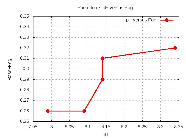

I finally collected some test-strips I'd developed over the last few weeks, and measured base+fog (B+F) levels for Phenidone at various pH-levels using TMY2. All test-strips were developed to approximately the same contrast as XTOL. Here's the graph:
The graph is jumpy and crude, partly because I changed pH-meters partway through. But it shows a trend: As pH rises, Phenidone's B+F rises. For comparison, XTOL uses Dimezone-S, and its B+F is .25 at pH 8.3 (with TMY2). Phenidone only gets close to XTOL's level when pH is no more than around 8.10.
Caveat: All of the Phenidone developers in that graph use ascorbic acid and sodium metaborate. Other chemistries might cause Phenidone to behave differently.

Mark;
Another good reason to use Dimezone-S, unless there is an antifoggant in XTOL!

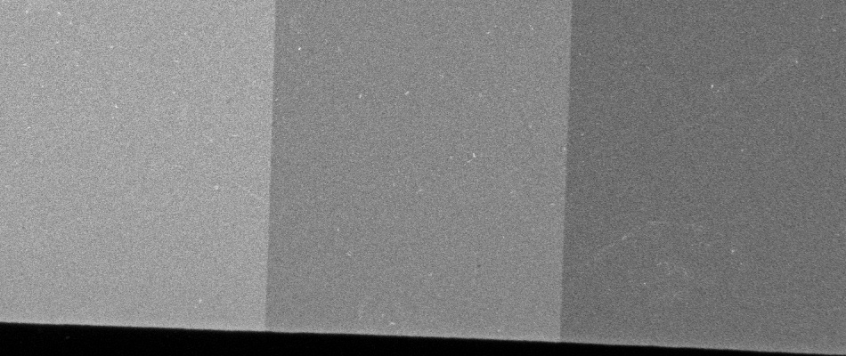

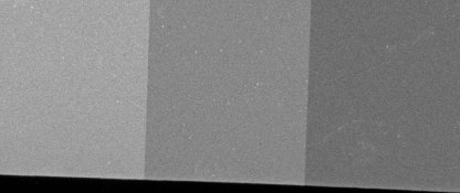

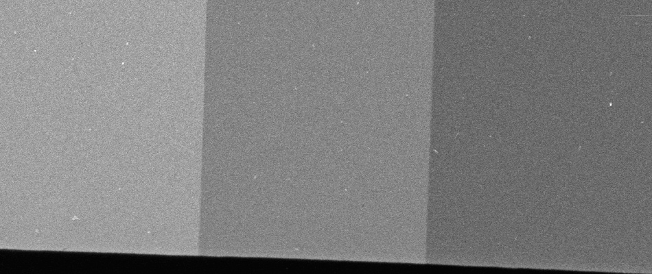

Grain looks a tad better than XTOL in my 22x loupes. Here are full-resolution crops of neg-scans of XTOL (left) and concentrate (right):
An objective way to gauge grain is by the sizes of JPEG files, keeping dimensions and contrast identical. Finer grain (textures) produce smaller files. In the crops above, the concentrate's files are 2.25% smaller.
The sharpness of the high contrast horizontal line looks the same to me, but the low contrast vertical lines look a bit softer for the concentrate. Shutterspeed was 1/8 second (tripod), but there still might have been a bit of horizontal vibration. I'll have to watch future test-strips.
