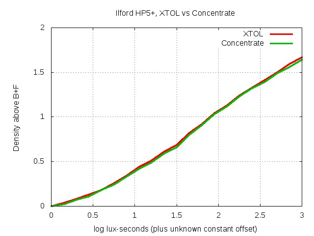

I've done all my testing with TMY2. This time, I wanted to compare this concentrate with XTOL using a film that was not made by Kodak, and not T-grain. And I wanted to test development of an entire roll, not just a short strip, to see if there is a capacity-issue. So I exposed and developed two 36-shot rolls of HP5+, and here are their curves:
They match nicely. That tells me that this concentrate can handle a variety of film-chemistries. Both rolls were developed identically: 220 ml of stock developer for 8 minutes at 20C (Ilford's recommendation).
Grain looks the same in my 22X loupes. I also took some tripod-shots outdoors, so you'll soon see some scans that'll let you gauge both grain and sharpness.

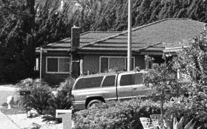

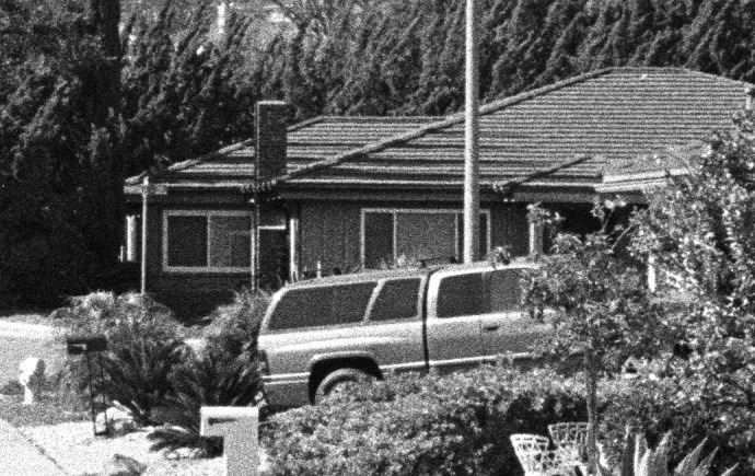

Scans of photos
Here are full-resolution crops of HP5+ shot and developed identically in XTOL and the concentrate. XTOL is on the left; concentrate on the right.
XTOL: hp5-xtol-crop.jpg Concentrate: hp5-conc-crop.jpg
The scanner is a Nikon Coolscan IV-ED, which has a resolution of 2900 DPI on the negative.
What do you think of the grain and sharpness?
Also, I attached a down-scaled scan of the entire frame.

Nice work Mark. I note that there is just a tad more grain in your developer. Do my eyes deceive me? The curves are certainly close though.
PE
To me it does look very slightly grainier but only in some tones. Also looks very slightly sharper but quite difficult to tell from scans. These differences could be entirely imagined, or real but trivial in practice. I would really need to see physical prints/negatives in order to finalize my subjective opinion.
Grain: I've compared on two monitors, both CRT and flat-screen, rapidly switching from one to the other. Flat-screen monitors are best for comparison because their focus doesn't vary, and grain is more conspicuous on them.
Anyway, I see some areas where grain is a hint worse; others where it's a hint better, such as the left house-window.
BTW, the scanner was manually focussed on one of the two house-windows.
The rolls are mostly identical frames, so I can scan more frames.
Sharpness: The photos were taken about 20 minutes apart, and the sun had moved a little, so deeper shadows on the tile roof might increase percieved sharpness in the concentrate. The sharpness of the other lines in the photos look the same to me.
Mark Overton
EDIT: On further critical exam, I notice that other lines are a bit sharper in the concentrate, such as the window-frames. I wonder if this is a focus-issue with the scanner (which would affect grain-perception), or if the concentrate is actually sharper. I'll definitely make some more scans.

@Michael R: No, I have not checked higher densities yet. But I have the leaders of HP5+ from both rolls, so I can measure them tonight if I remember. I like your idea of developing an entire roll to D-max. Exposing such a roll will be easy: Just load it onto the reel in the light!

EDIT: I just measured the leaders of the two test-rolls. XTOL is 2.40, and the concentrate is 2.39. Very close.

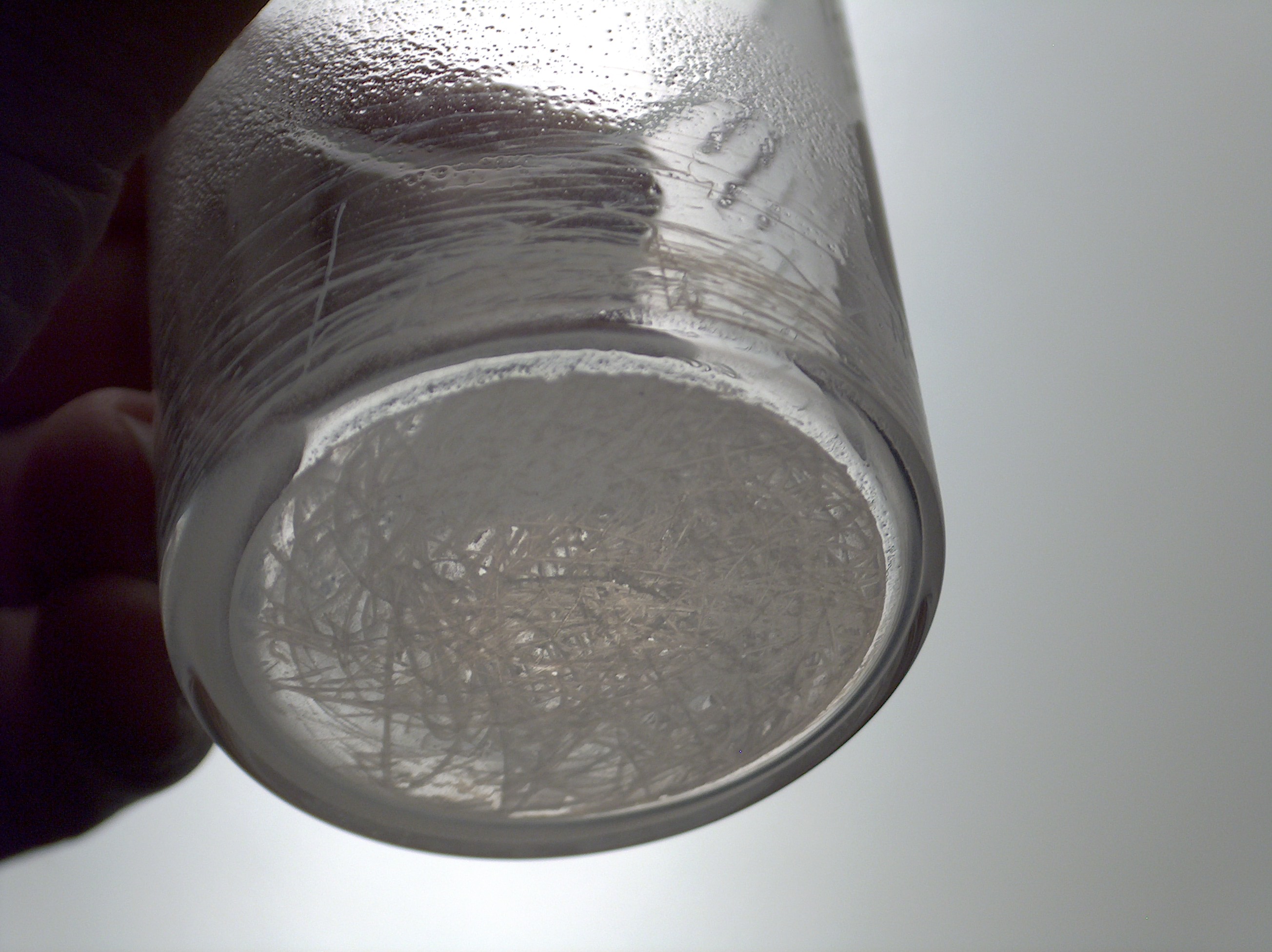

A few days ago, I said that if Dimezone or Phenidone is mixed in last (instead of first), it starts a reaction that produces viscous cloudy liquid and scale on the beaker. Here's a photo of the scale. Everywhere the stirring rod rubbed the beaker, it started a reaction producing a line of scale.
I suspect the cloudiness and this scale are the same catalytic reaction. Have any of the chemists here seen anything like this?
Mark Overton
These are crystals formed by the stirring rod scratching a saturated mixture which then begins to form at the site of the scratch. It is well known to Organic Chemists that they must scratch some mixtures to begin precipitation or crystallization. As for why this forms in one case and not another, it may be due to a salt being formed in one that is not in the other.
