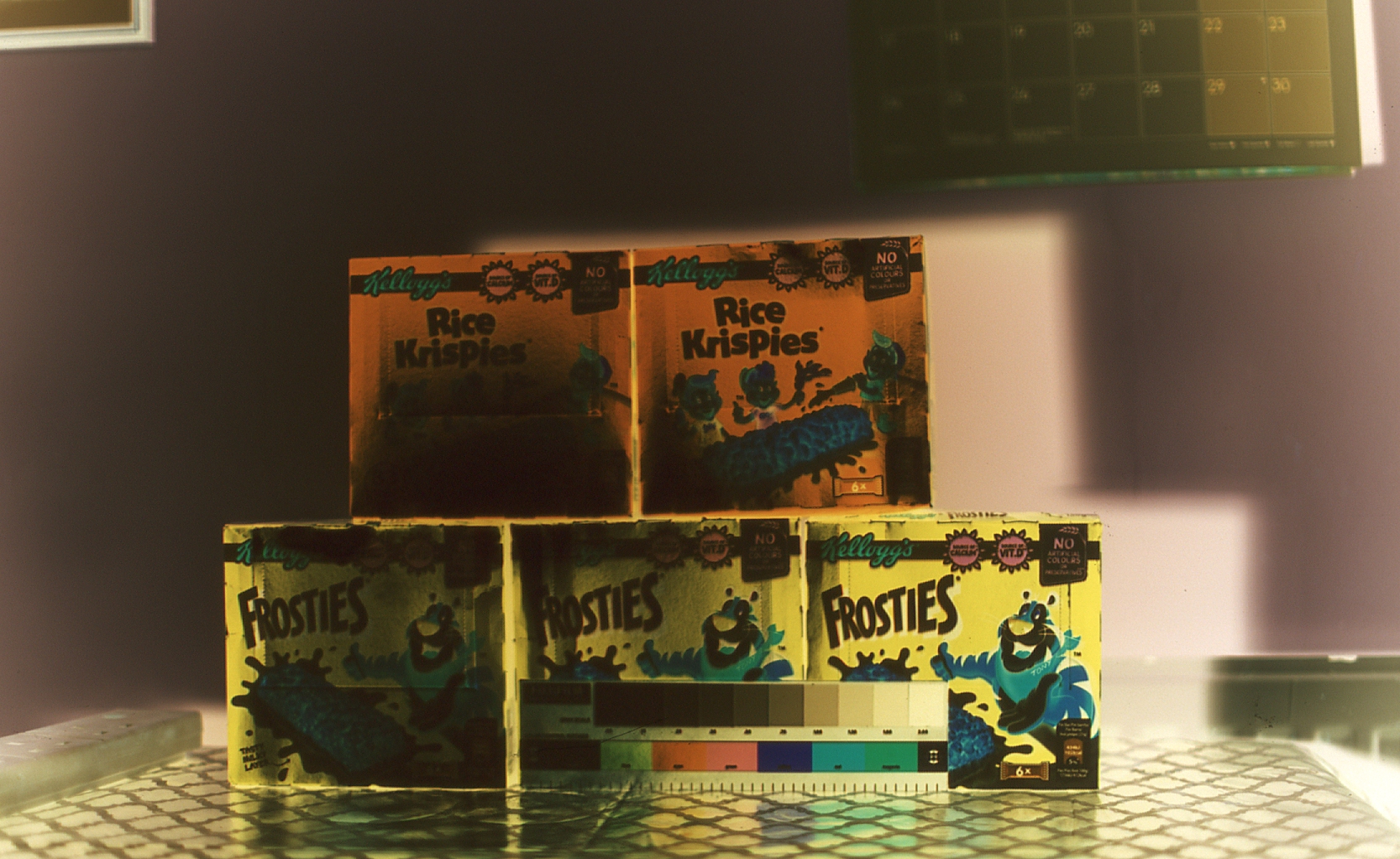

So I was hoping to report success, but after a number of experiments with Kodak 2383 film I only have more confusion. For reference 2383 is color cine print film, for printing ECN-2 negatives for projection. It is a negative color film that is tungsten+ECN orange mask balanced, ~3 ISO, and fairly high contrast. One would think if it can be done, it'd be an ideal though very slow slide film.
So here is what I've tried:

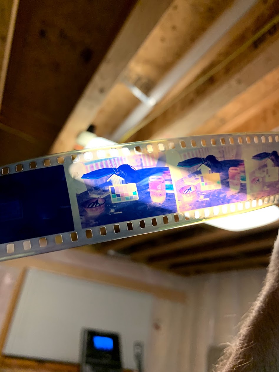

* C-41 process (negative) -- very strong blue cast with weird green color crossing. Interestingly it came out with absolutely no mask at all, very clear dmin, and very dark dmax. The negatives were very saturated with color.
* E-6 process -- Film came out completely clear, no density at all even in the unexposed film area
* Custom first developer+light exposure+C-41 process -- Film completely clear, like with E-6. Inspection after first development to re-expose revealed good density but an odd reddish shiny "mask" where unexposed. Looking at the film after color development revealed the film looked pretty much identical to after first development.
* Clip of custom process after first development and into fixer -- Film didn't clear at all. It looked pretty much identical to the unfixed film, but without the reddish shiny mask. One side appeared to have a negative image made of silver with milky white unexposed areas and the other side appeared black and shiny. Looking through the film to light revealed that the "dmin" here was very dark orange
* Clip of custom process after first dev, re-expose, color dev, and bleach and then put back into color dev then bleach/fix again -- Color density developed! I believe this should've just turned the film straight black, but instead did create a very dark positive image with orange "dmin" and green "dmax" with obvious blue dye shining on one side
Basically. None of this makes any sense to me. How can a film fail to fix like this? C-41 developer works fine with the color couplers despite being mismatched to the film as proven in the negative test, but then why doesn't it work after first development? Why would the film fail to fix? And I ruled out the dyes being water soluble or something by basically doing color dev after bleach, which "worked". I'm not understanding at all how this is possible.
I'm hoping someone here has some kind of insight into this in PE's absence, but ECP film seems like a very obscure material and process. I've seen pretty much nothing in regards to attempts to cross processing it or even just generally using it in-camera.
Anyone have any ideas?

I processed some Kodak ECN-2 process intermediate film at the same time as a form of "control test". This film had no problems in the process, though seemed under developed since ECN-2 is a much lower contrast film.
ECP film does NOT have an orange base. It is not designed to, it's a film meant for printing negatives to so that you can then project it. Basically like the RA-4 of ECN-2 film, but for cine purposes of course. For reference, I attached a simple picture of the C-41 processed negatives (note these were with an orange filter. The unfiltered ones have a very orange image, ie, blue cast in positive)
I've done a huge number of C-41 reversal and E-6 cross processing experiments. I've never completely failed to get an image until I began working with this ECP film. It's baffling because clearly C-41 will cause color to develop. But if you do a first developer beforehand then it's like C-41 doesn't touch it. However, if you bleach back, then C-41 works again for color. I really have no idea how it's possible. My only very small inkling of a thought is that the film is too heavily masked to be easily re-exposed before bleaching, but I would think in that circumstance I'd still get a weak image. I'm not sure of any fogging agents that are easily available that don't also work as a silver halide developer or would destroy the dyes so I'm unsure how to exactly test for that.

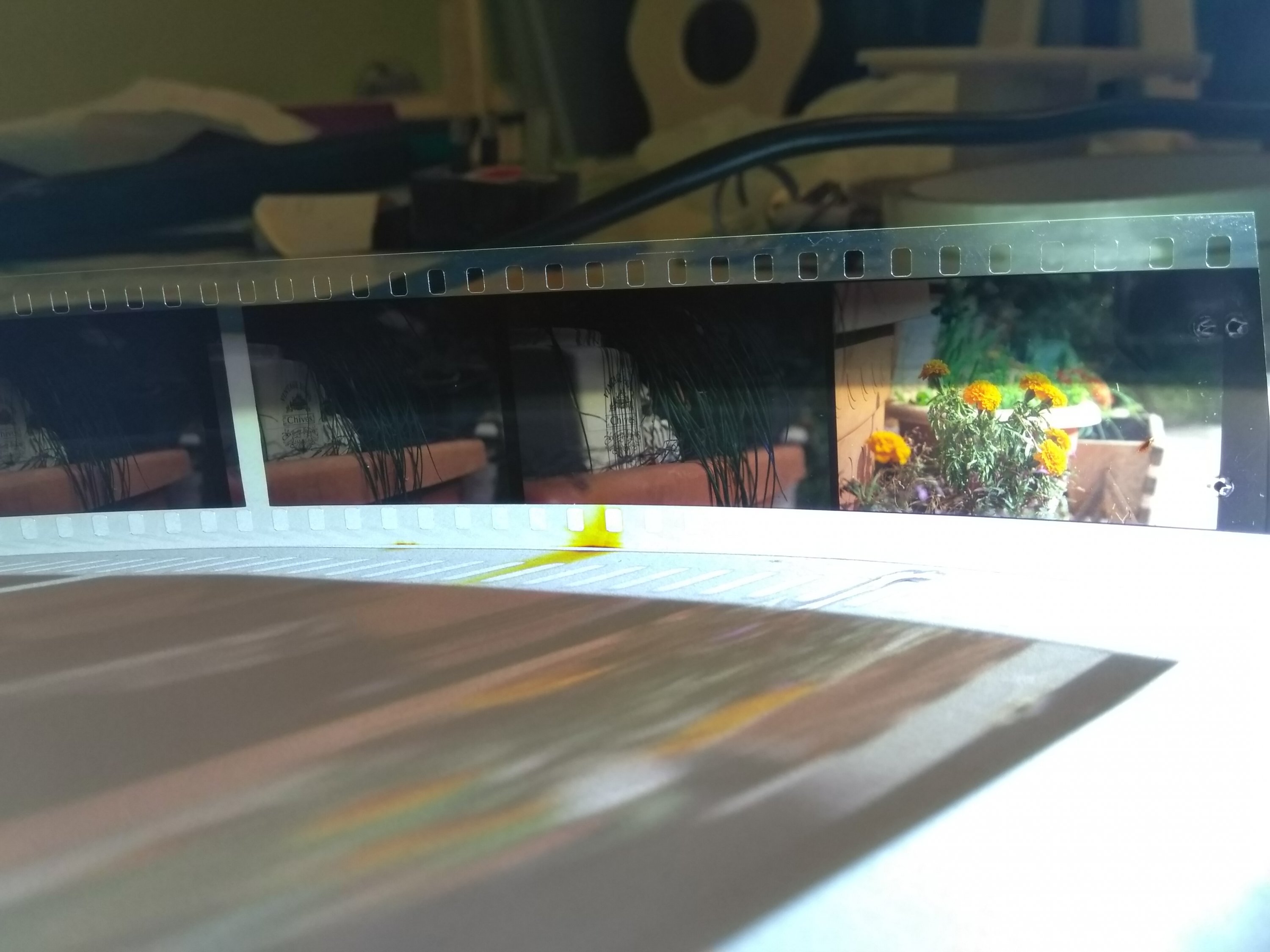

ECN2 developer works well with processing the film, 3 mins at 38c for the dev, 30s stop, 1 min bleach and 40s Fix, all at 38c.No need to use the bleach at 27c, that's just an industry spec due to the aggressive bleach eating way at the tyres on the processing racks!.
Here is an example of a contact print using 70Y and 5M on a colour head, exposure was 1s at a distance of around 4 inches from enlarger lens to film surface.
Here is an example of in camera exposure using the film base as a filter.
I did not bother trying to make a contact print from the 2383 negative image to get a Pos because I would imagine further filtering would be needed using the enlarger filter pack.
Another possibility would be to process the in camera exposed film in a B&W reversal kit!. For exposure this would eliminate the need to filter the camera lens so you can expose at 3 iso. An experiment I may do in the summer when light levels are higher for these slow films.
From my experiments of contact printing from Kodak B&W films, like Plus-x onto the 2383, the images are sepia, likely due to the colour dyes in the 2383. Further experiments are needed as I used XTol and TMax fix in the test. Maybe using the ecn2 kit would produce a better B&W result.
I hope this helps you in some way and I'm open to any questions you may have as myself and a few others are doing ongoing experiments with this film stock.
