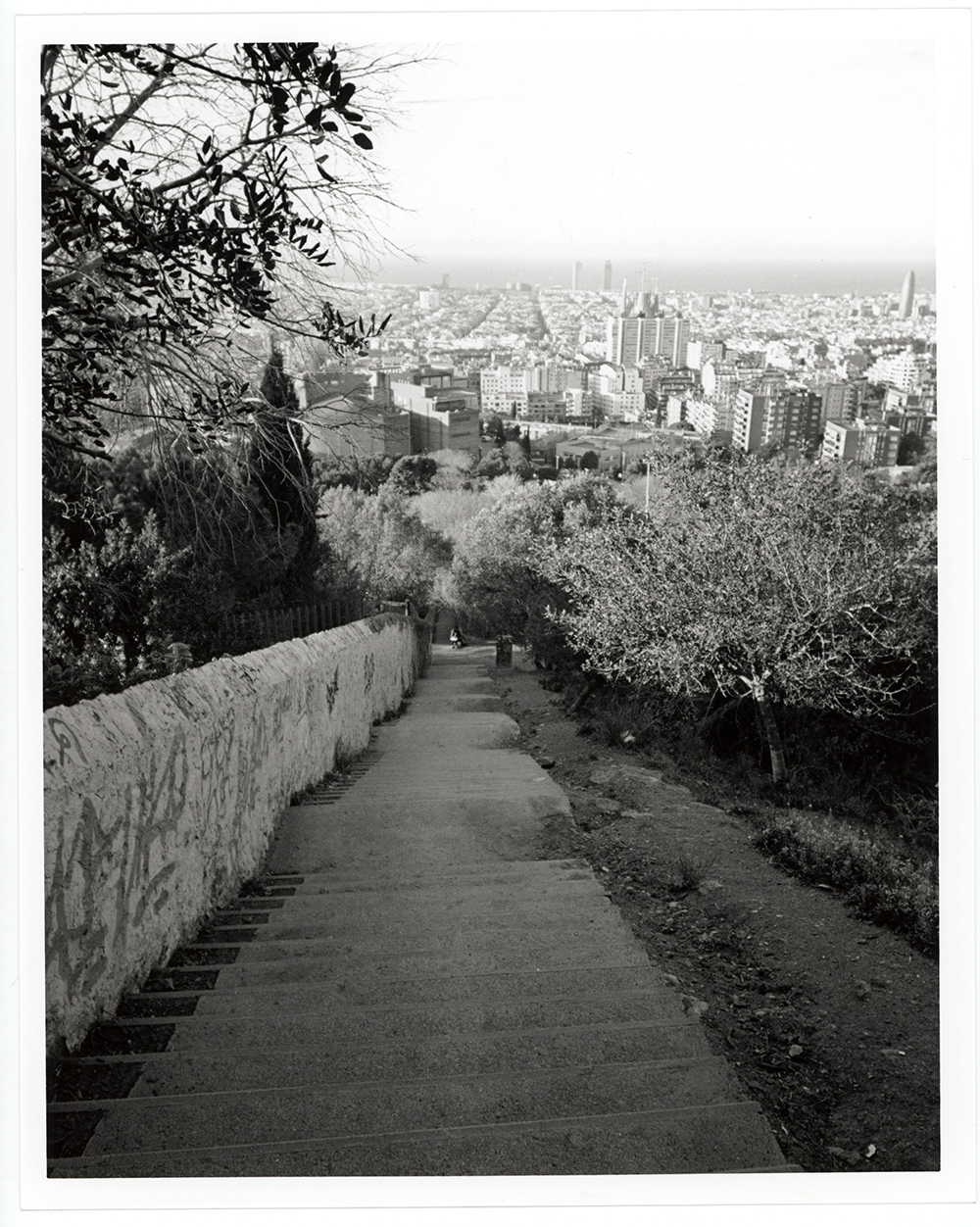

Seeing this thread made me want to try it. The best result I ended up with is below. The trees and such definitely end up looking like IR film, and the contrast of certain colors is pretty strange. Overall I like the result, but for me it wouldn't work for everything. I think it'd be really interesting for something that should carry a feeling of being spooky or mysterious.
The negative is Portra 400 in 120 format. I cropped pretty heavily, maybe 20-30%. I printed it 8x10 on Ilford Pearl RC multigrade, at grade 3 for 40s and f/8. I also did some dodging on the ground portion so that the city background was more clear while not making the shadows pitch black. I did a lot of tests at different settings, but I found at least with my enlarger, going to grade 4 or 5 makes the result way too contrasty. It was pretty surprising to me since I always heard that printing like this will result in flat low contrast prints and requires really long exposure times. My enlarger is particularly bright since I modified a "feature" of it, but the exposure isn't crazy longer, especially with how dim it is at full grade 5 filtration since the orange and blue cancel out. A similar B/W negative print would've taken around 10-20s.

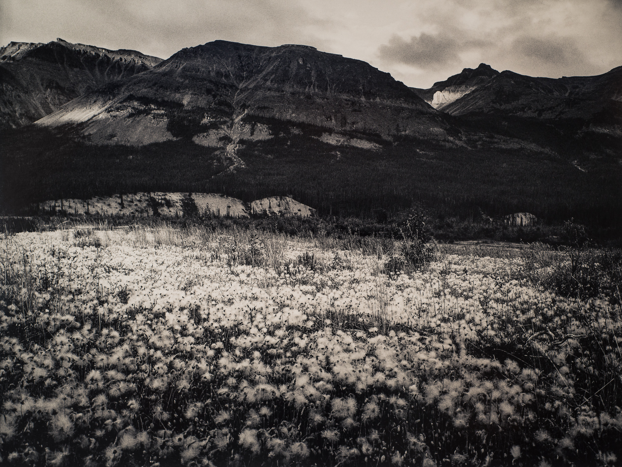

Here is an example of one of my prints. The color images is a scan of the Porta 400 negative. The black and white is a digital photo of the darkroom print.
The print is on Ilford Classic glossy paper, toned with selenium and sepia sulfide. Looking at my notes I printed with 50M (Grade 3). My base exposure was 25 seconds at f/8 for a 12x16 print. I burned the mountain and sky in at the same contrast grade and then did some additional burning at 170M (Grade 5).
In my experience the common wisdom found on the Internet about lack of contrast and really long exposure times are not true. At least with my negatives they print more or less like any other negative.
