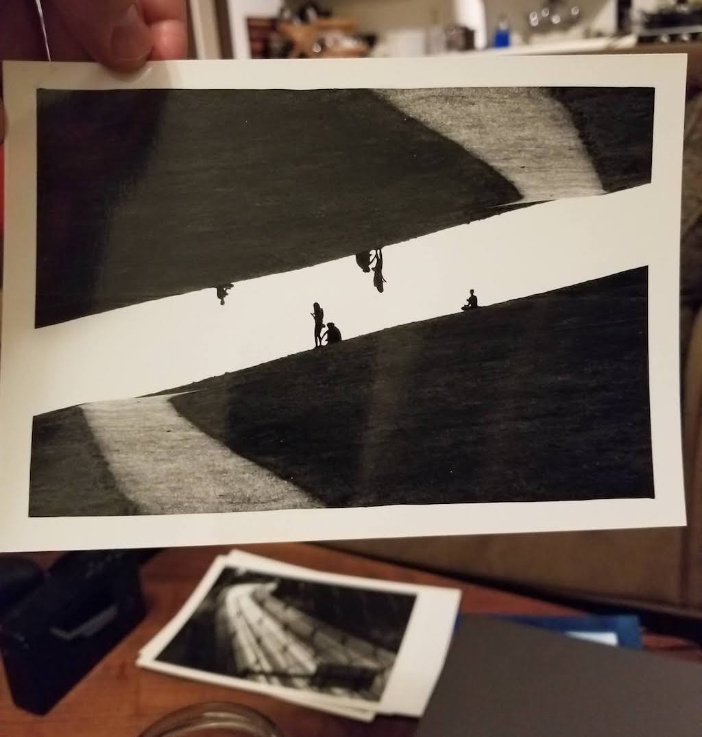

A white sky is just unexposed paper! This was a fun print from last year where I flipped the paper 180 degrees in the easel after the first exposure and re-printed the whole image in the unexposed sky. I did end up having to make a simple mask though. Even though the sky printed totally white, it was enough to pre-flash the paper and the second exposure was significantly darker.
So beautiful! A white sky certainly has its place and you've shown the nice graphic quality it can add. My gripe with it was more related to the lack of sunshine in daily life than with how it shows up in photos (although I much prefer fluffy clouds).

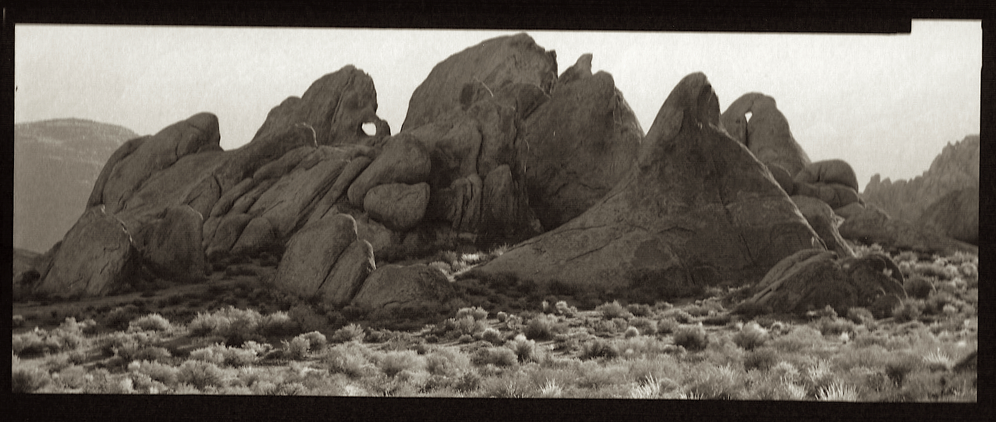

Neither am I. But then, this is the eastside of the Sierras and not the sky...
Alabama Hills, 4x10, 24" lens, platinum/palladium print.
