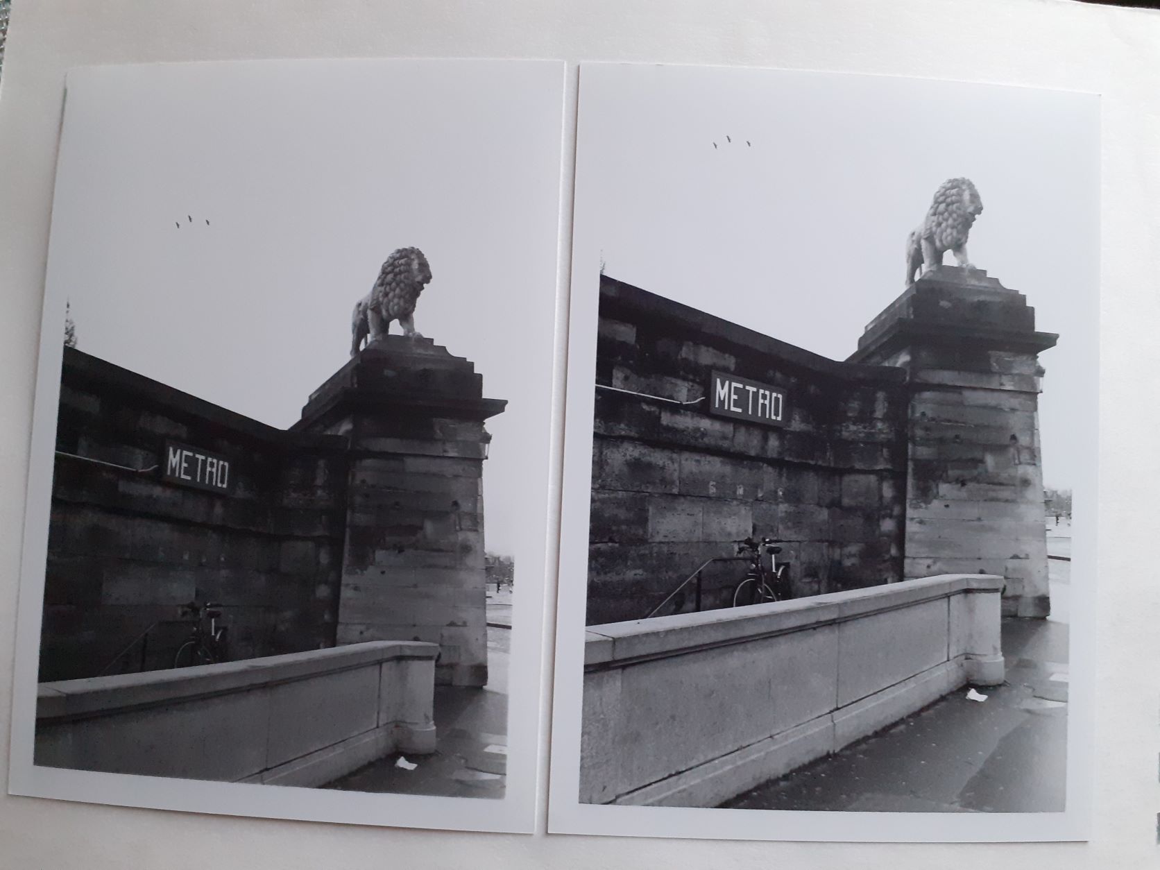

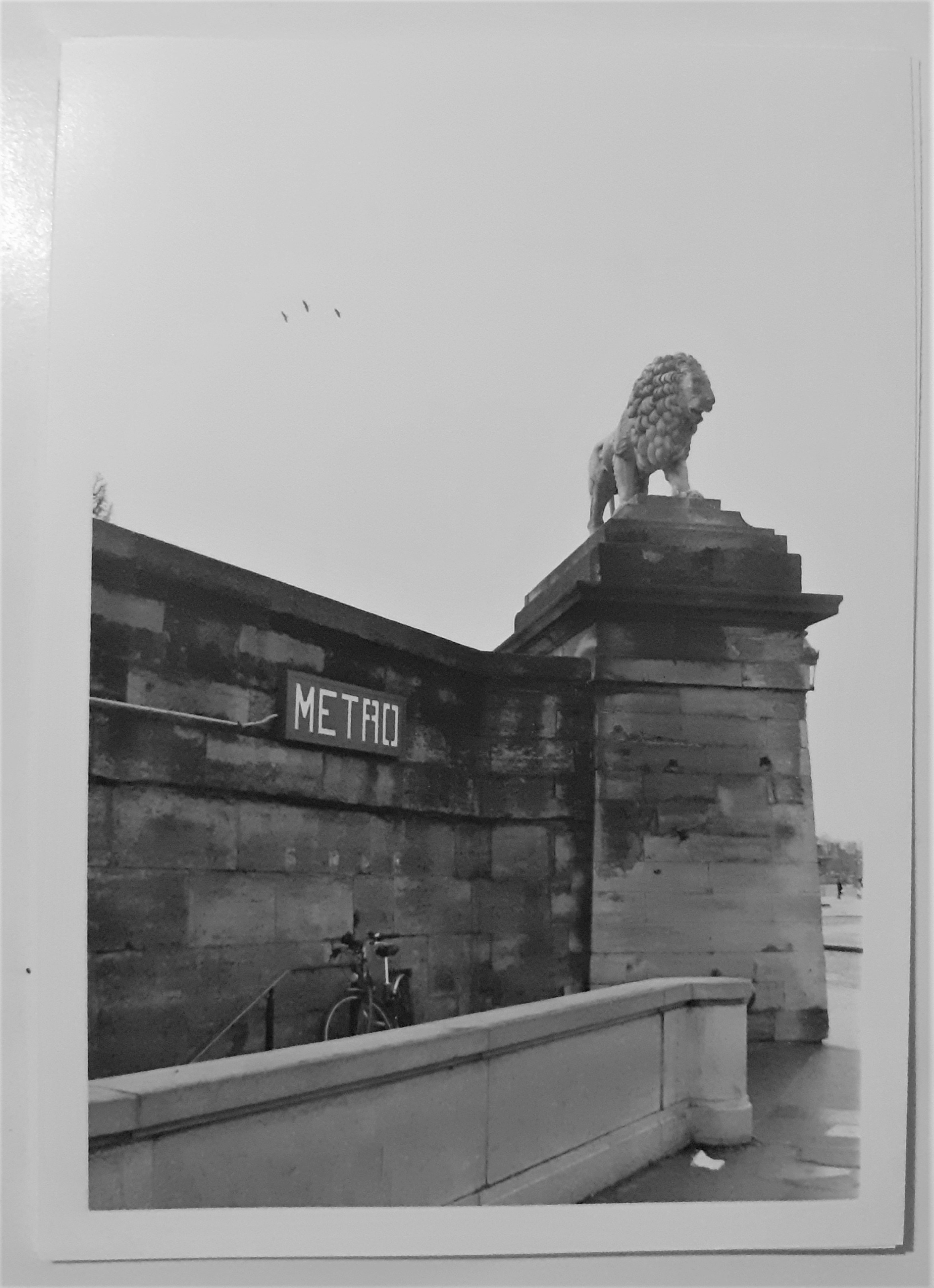

Just printed this one this week. I'm happy with the sky just being white and merging into the margins, even if I know that's not really technically correct.*
I'm wondering what you'd do in regards to the sky if this was your picture. There's info in the negative, some static, amorphous gray clouds...
Also, as a viewer, how do you perceive the picture with a border-less sky? Do you notice it? Does it bother you?
*As a side note, I notice I've been printing crisp white skies a lot recently and I know it's heavily influenced by the endless stretches of gray days we've been having. I miss sunlight!

There is nothing technically incorrect about a print showing a blank white sky if the subject included a blank white sky.
But if you don't like the aesthetics, there are a couple of things you can try.
You could do tests to see how much more printing exposure it takes to reveal the information in the sky area. If it is reasonably accessible, careful localized burning of the sky may add what you want. While the traditional advice is to burn in with a low contrast filter, I might try it with a high contrast filter instead.
You could also consider using a sky from another negative - a really old school technique that used to be considered acceptable, but now is looked at with disfavour by people who dislike "manipulation".
FWIW, I think I might also print the entire image with a bit more contrast.

If you like the white skies, then go with it. Have you tried burning in the top bit of the sky a bit to see what that will give you? Have you considered cropping out that sky? That actually might improve the composition, too.

If I couldn't get any detail in the sky any other way, I'd probably try pre-flashing the paper to see if that would do the trick.

I'd burn it at the edges so it does not merge into the paper. I had one like that recently. I wound up printing it whole frame, however.

I don’t think every sky has to be dramatic, it is what it is. I might try a subtle vignette just to bring out the borders

I'd give it an edge burn, so there's at least a bit of density to define the image on the paper.
There is no right or wrong answer!

Daniela, is the picture of the sky in your small picture what you have achieved. It looks sufficiently grey to me to separate it from the border and correct for the sky you had when taking the photo
If there is some cloud formation in the negative that you want to show then the problem is that you have a lion against the sky and burning in the sky might turn the lion nearly black even if you are very careful with a mask cut out to shield the wall and the lion.
Only you know how good you are with a mask but I fear that with a high contrast filter a halo ( a lighter line around the lion) may show
All you can do is to try logan's suggestion then careful burning in but it may cost you quite a lot of wasted paper to get it as you want it
The paper is only wasted in the sense that you throw it in the bin but the skill gained in the process will not be wasted.
If you have a go let us know how you did it. It will be of benefit to me and maybe others as well

Got a couple of hours in the darkroom today and tried the easiest suggestions given:
-increasing the contrast and cropping the sky a bit to improve the composition. I'm super happy with all the texture the increased contrast has brought forth.
-I also didn't realize how much I had cropped from the bottom and there's still more to the right of the image. I had cropped that side because of a tree. I burned the top quite a bit, but when I got to a burn that was 50% of the original exposure time and saw no change whatsoever, I abandoned it since I like it, need to save paper and most of you said it was ok 😬
Will try the other suggestions in the coming weeks. Thanks again!
Oh, and I found another photo of the same lion in a photo book. Those stairs are still in use, so I might try to recreate it (in the day time, with a random passerby and without cutting the lion's face)
